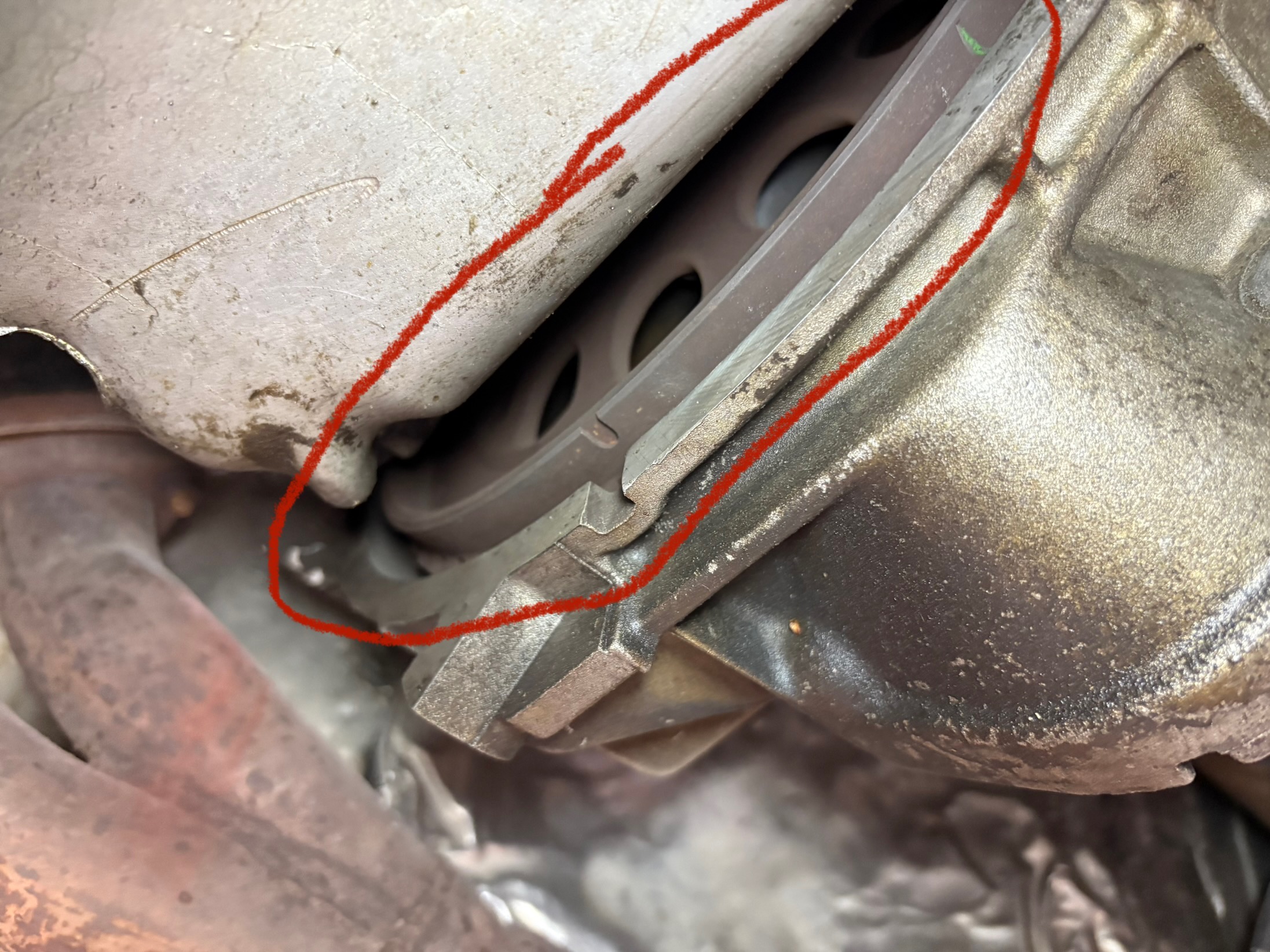

I noticed this gap (see photo) when taking off the starter/installing the flywheel clamp when preparing for the timing belt job. Should there be some type of dust cover/plate?
Thanks

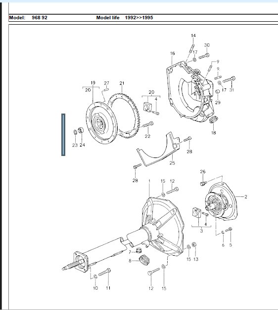

Yes, 944 116 093 01 Protective plate
In the 968 PET, illustration 310-00, part number 25
968 tip torque tube.jpg (46.86 KiB) Viewed 940 times

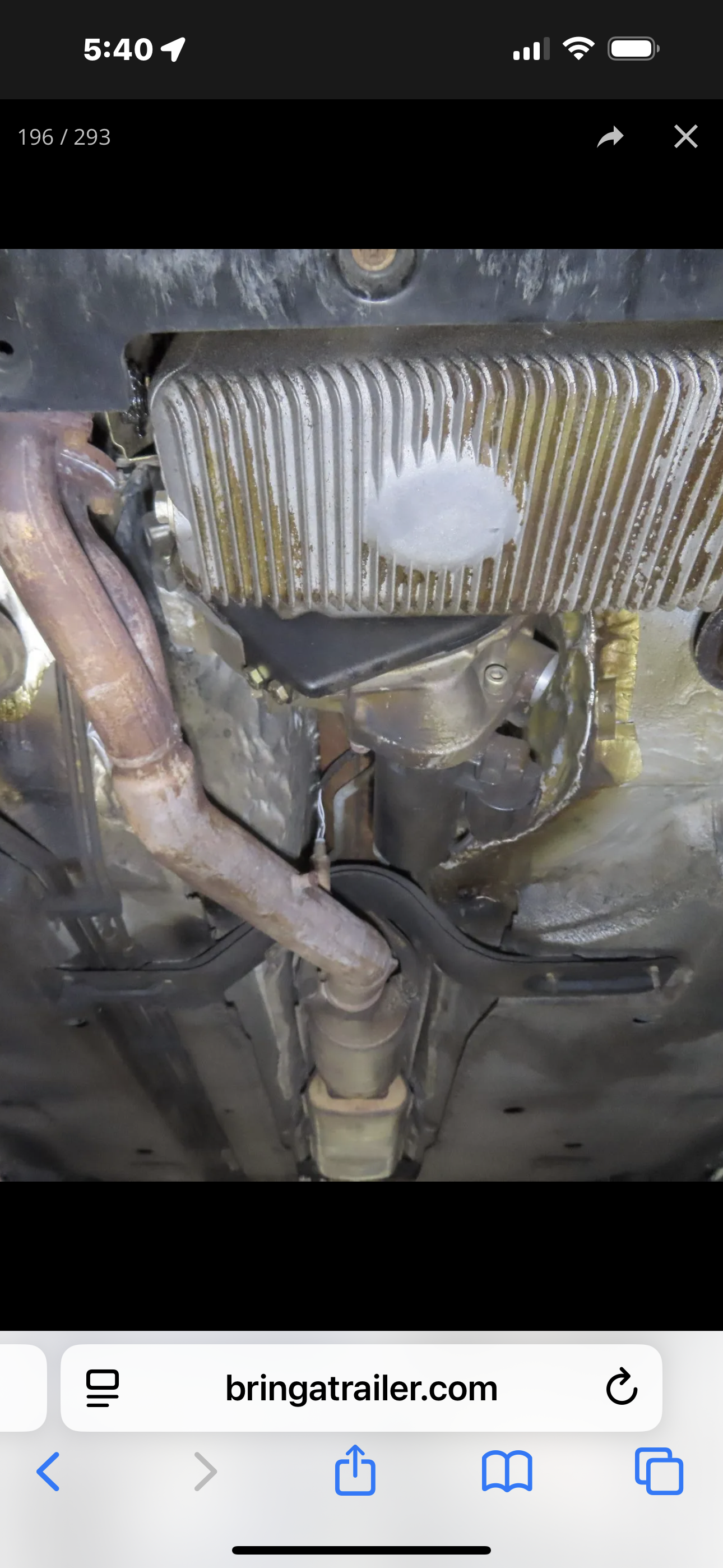

Thank you for the part number and image from PET. After seeing this I went to BaT to see what photos might show. I took a screenshot of the attached photo that shows a shield. Interesting on how it attaches with 2 bolts on the side.
