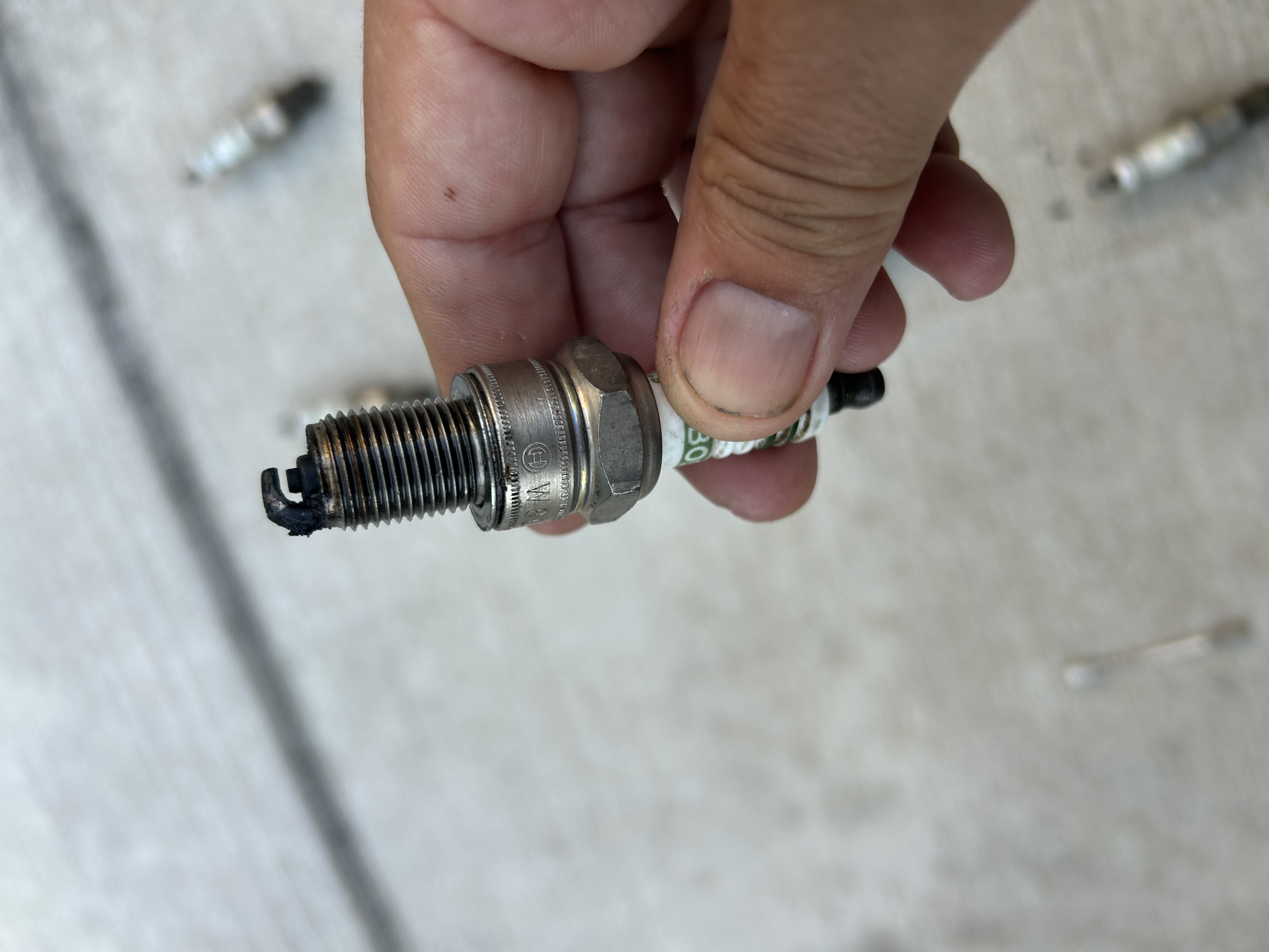

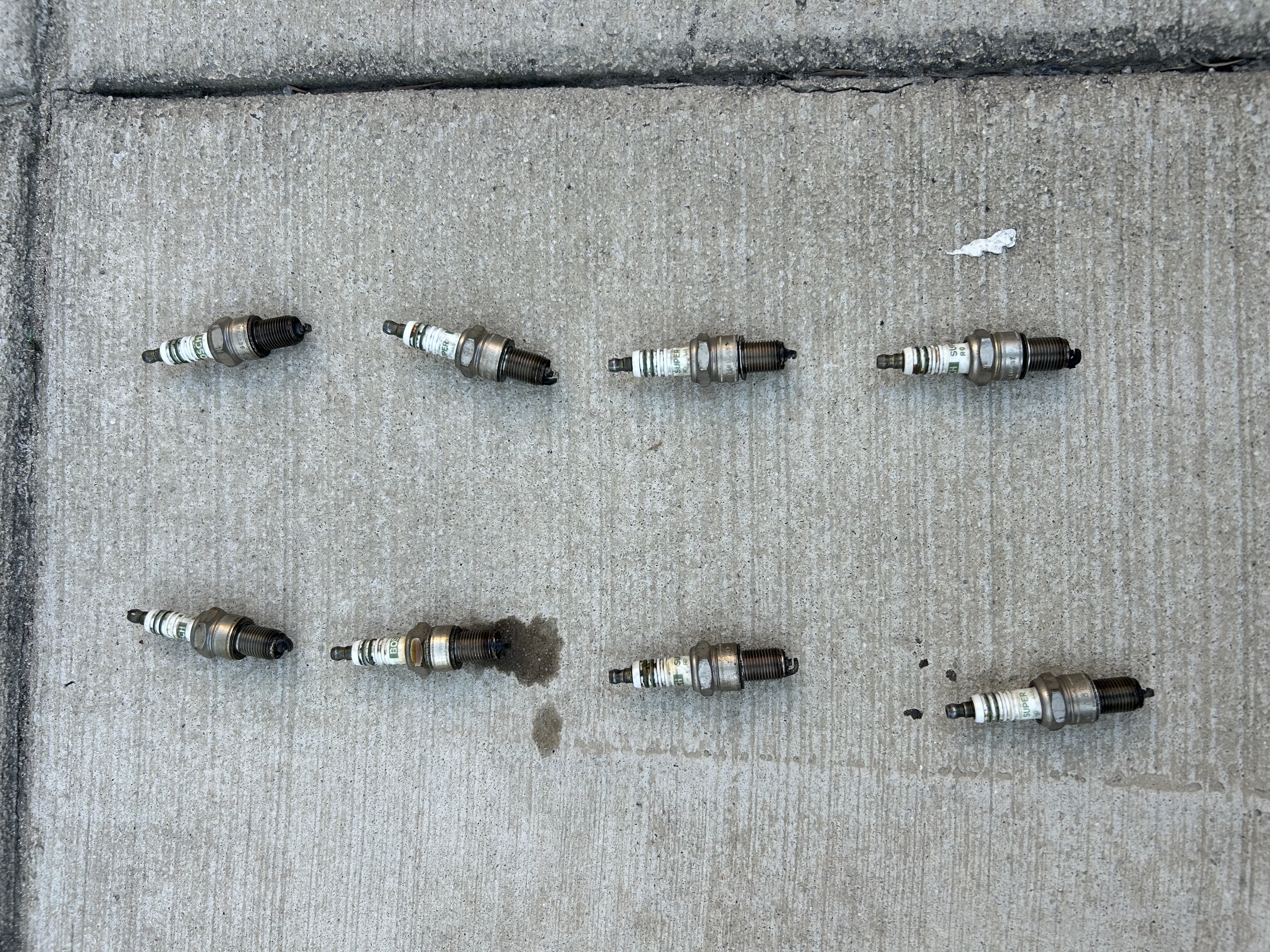

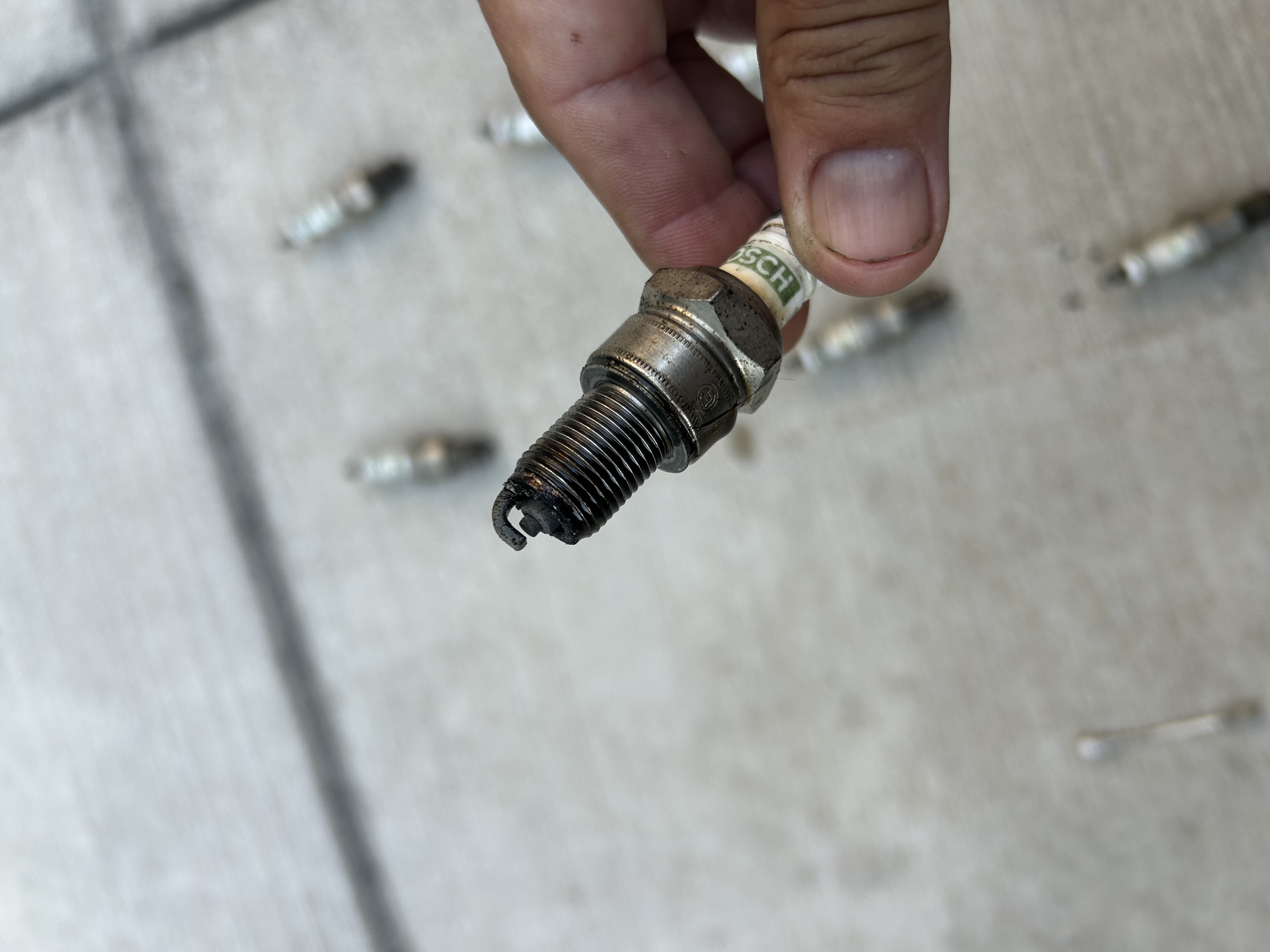

Now that I seem to have the starting resolved I moved on to how it was running. It wasn’t sounding or feeling right and was short on power. After checking and doing a few things I got to the plugs and they looked pretty bad with cylinder 6 and 7 being oily and loaded with deposits.
Changed the plugs and the car totally came back to life, which was exciting however I’m wondering what to do about the leak on those two cylinders. Seems like it could be a few things and I’m wondering which of those are most likely and can I tackle them with the engine in the car?

My 928 experience is much more on the S4+ cars. Still interesting that it's 6 and 7. There's some known history of uneven temps affecting those two, but I have no real understanding of why or how it would affect oil consumption.
If the plugs are just a bit sooty rather than oil coke or ash fouled, it may be a little richer, or suffering from a misfire there. My somewhat old-skuul diagnostic method connects an oscilloscope to a couple ignition wires to watch firing voltage patterns and variations among all the cylinders. With new plugs they should be pretty even. Higher or lower would have me chasing cap and wires on suspect cylinders.
FWIW, I've learned to stick to the factory plug recommendation, and maybe avoid some of the, um, improved plugs. For instance, I thought for sure the Bosch platinum version of the spec plugs might offer longer life. Small firing errors caused a NOx problem identified at annual smog check. A simple swap to the spec copper resistor plugs brought the levels lower, enough to pass.
Let us know what you see as you drive. If you want to try a casual o'scope effort to see the firing voltages, I can share some tips to make it an easy process. I pull mine out a couple times a decade for something. More modern o'scopes are a lot cheaper and a lot better than the dinosaurs I have. Mine are converted from whale oil.

I ended up putting platinum plugs in simply because they didn’t have a full set of copper plugs at the store and I was impatient. The car really came back to life.
I was also suspicious of the fuel filter for various reasons including more noise from the fuel pumps so I changed that today. Feels like a new car. Such smooth easy power. Fuel pumps sound happy again.
With an intermittent cooling fan issue resolved as well we are ready for a short road trip to the mountains!
As far as the oily plugs go I’m going to not worry about that yet, but enjoy how great it’s running and perhaps pull them out in a month or so and see how they look.
