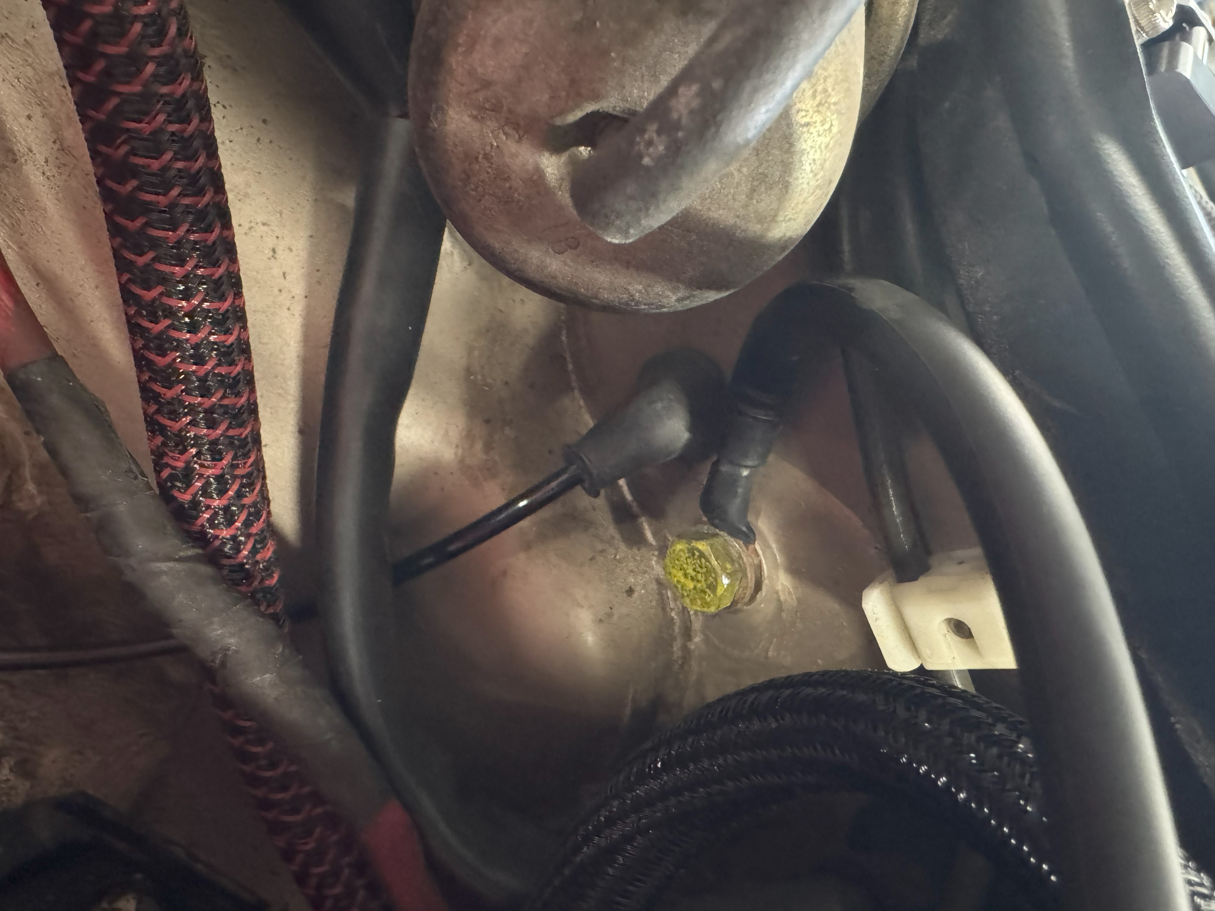

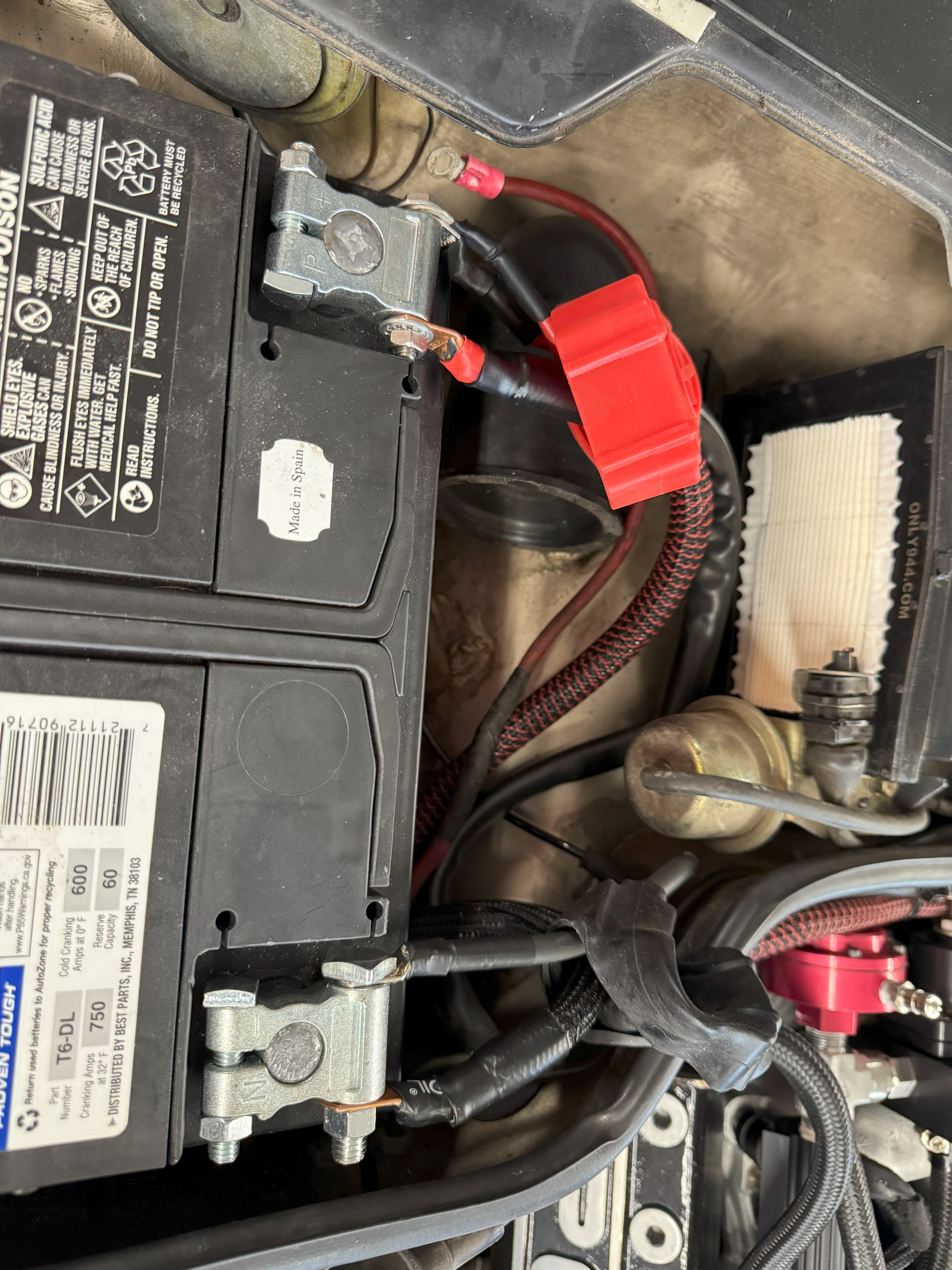

Heres a few pics. I may take the starter back out and clean the surfaces.

On a similar car, the battery negative cable and the separate cable connecting the block to the chassis are both critical. The chassis to block cable in the 928 is an uninsulated copper braid with crimped lugs. The 'uninsulated' is a common feature among many other makes too. As others report, the copper braid is a known weak point as it ages and corrodes, and I'll share some personal experience chasing issues in ground cables that looked and tested great but couldn't keep up. The Good News is that those cables are relatively cheap. I hunted down some marine-rated cables with tinned copper strands in the braiding, less subject to corrosion I hope/plan.

Does the ground wire get hot if you crank the starter without an extra ground strap? It's safe to assume the bell housing is as conductive as any other, so the possibilities seem limited -- either the starter is all but shorted out inside, or there's too much resistance somewhere between the battery post and the starter casing. Might be worth getting out the multimeter and checking the ground at the starter to see if the resistance is obvious, and if so, backing up at every contact point toward the battery to see if you can isolate where it is.
