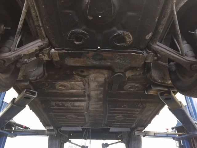

Does anyone have a good visual showing the best points on a 914 frame or jack stands? I'm preparing for some summer time upgrde work and will need the car on stands for some weeks. Surprisingly, not much out there on the internet. Some images there, but somewhat ambiguous. Anyway, wondering if there are any 914 experts out there with some thoughts. thanks a ton

I use pinch weld adapters just inside the wheels. [the image is not my equipment, but what I used for positional reference]
914 lift.png (391.25 KiB) Viewed 751 times

Thank you dmk13. Appreciate the visual. this is quite clear.
