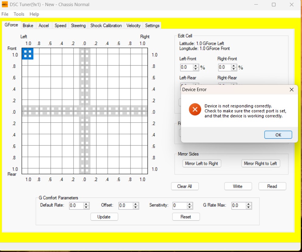

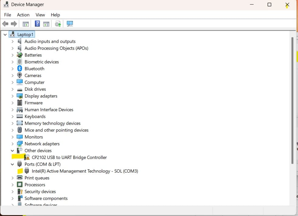

I'm trying to get my DSC tuner to connect to the provided software. I've tried all of the videos, FAQs, and even reached out to them via email. I keep getting a "Device is not responding correctly. Check to make sure the correct port is set, and that the device is working correctly." I've tried re-downloading the bridge controller driver separately. But in the Device Manager, it lists the generic bridge controller under "Other" and Ports doesn't display the expected, "Silicon Labs CP210x......" item.
I'm sure someone on here has installed the DSC Tuner. I'm hoping someone can shed some light, as this is getting extremely frustrating.

Maybe post a screen shot of the error you are getting?

Here's a screenshot of the error, as well as what I'm seeing in device manager
- DSC 2.jpg (81.88 KiB) Viewed 790 times
- DSC1.jpg (132.13 KiB) Viewed 790 times

Long shot, but USB cable could not be communicating correctly. Mini B plugs (male for the DSC) have been known to fail as well as regular Type A.
Another thought is a cable that's too long. I could be wrong but it seems like something was said when I got my DSC 3-years ago about keeping the connect cable as short as possible.
