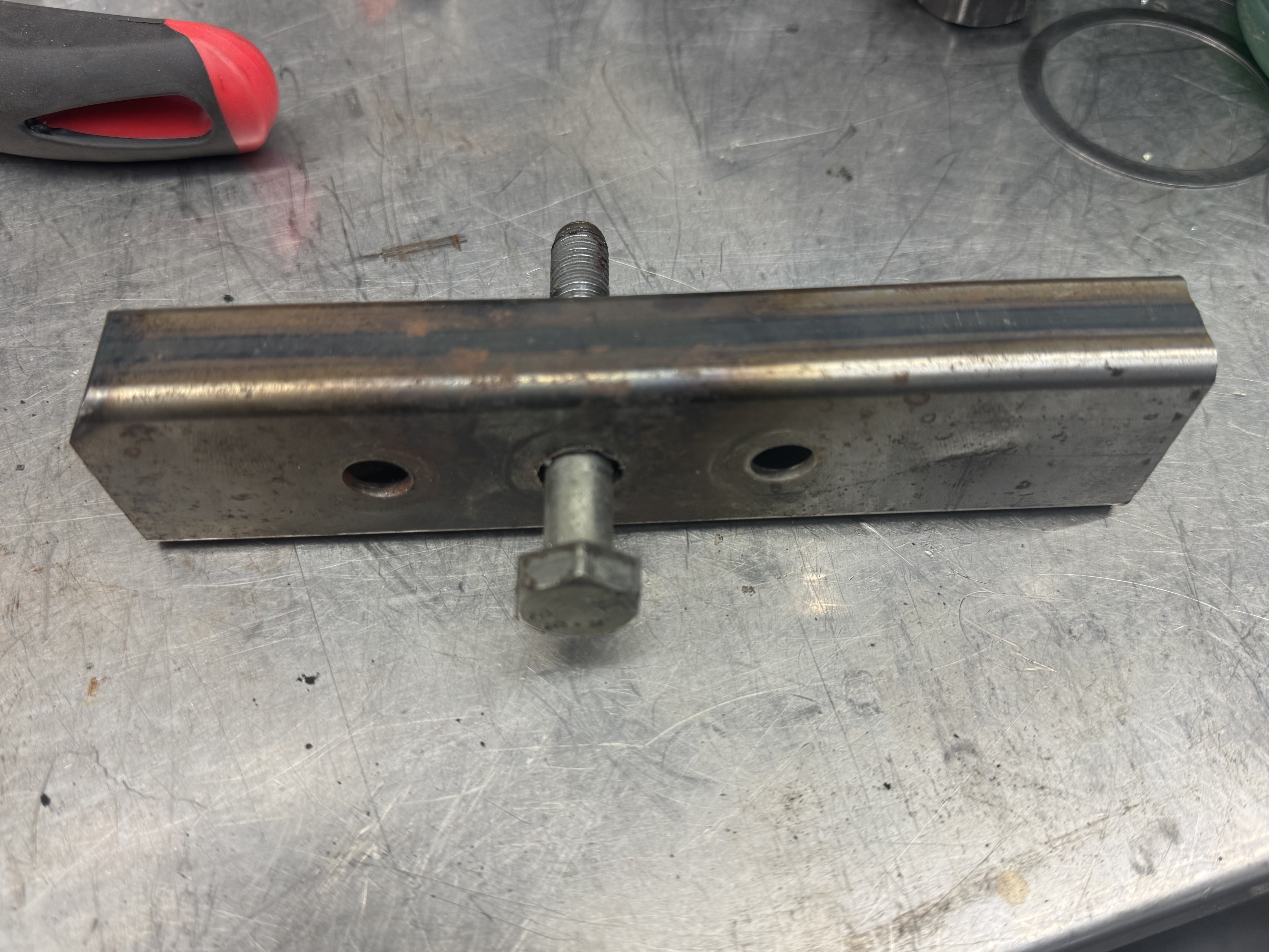

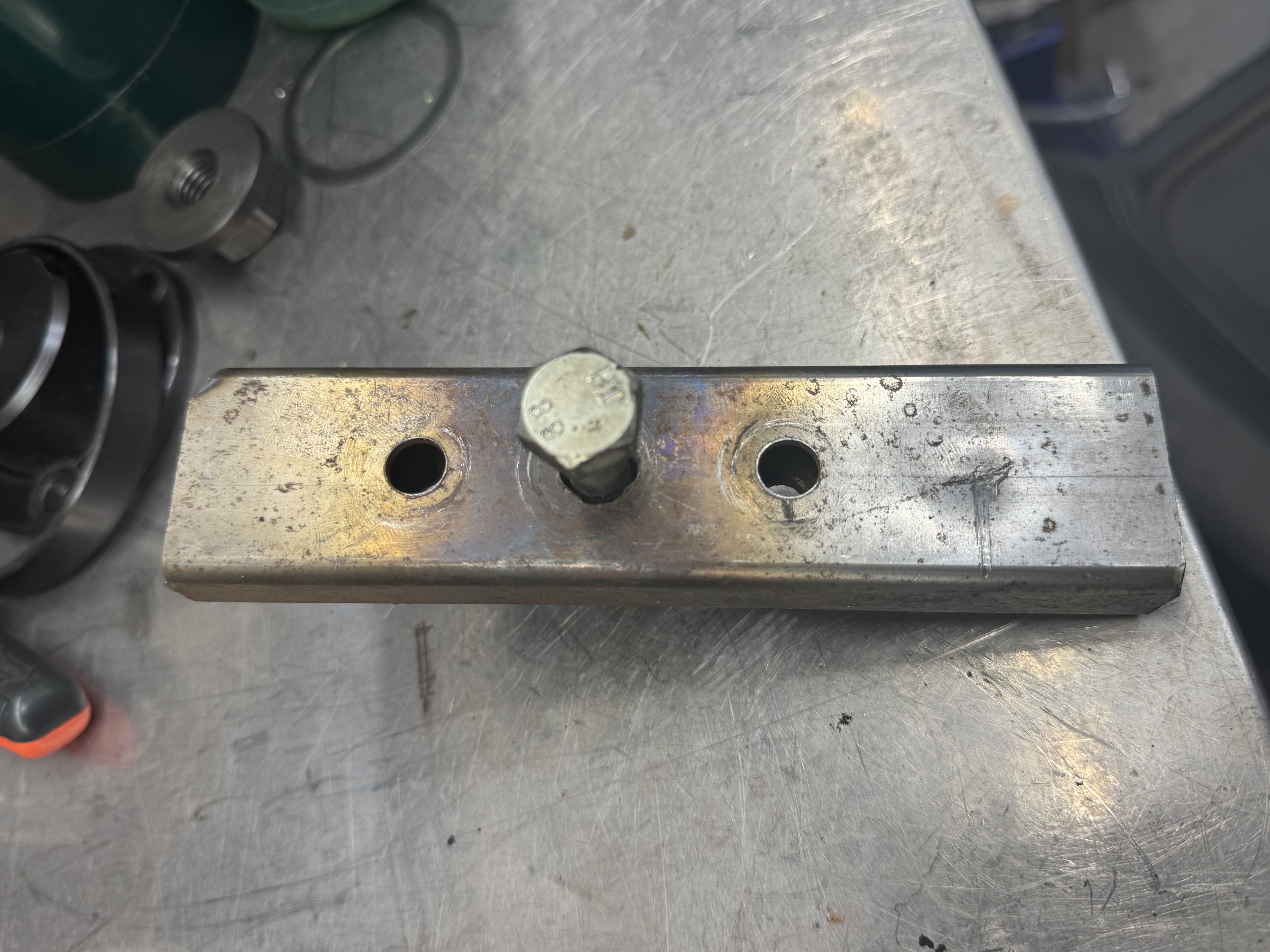

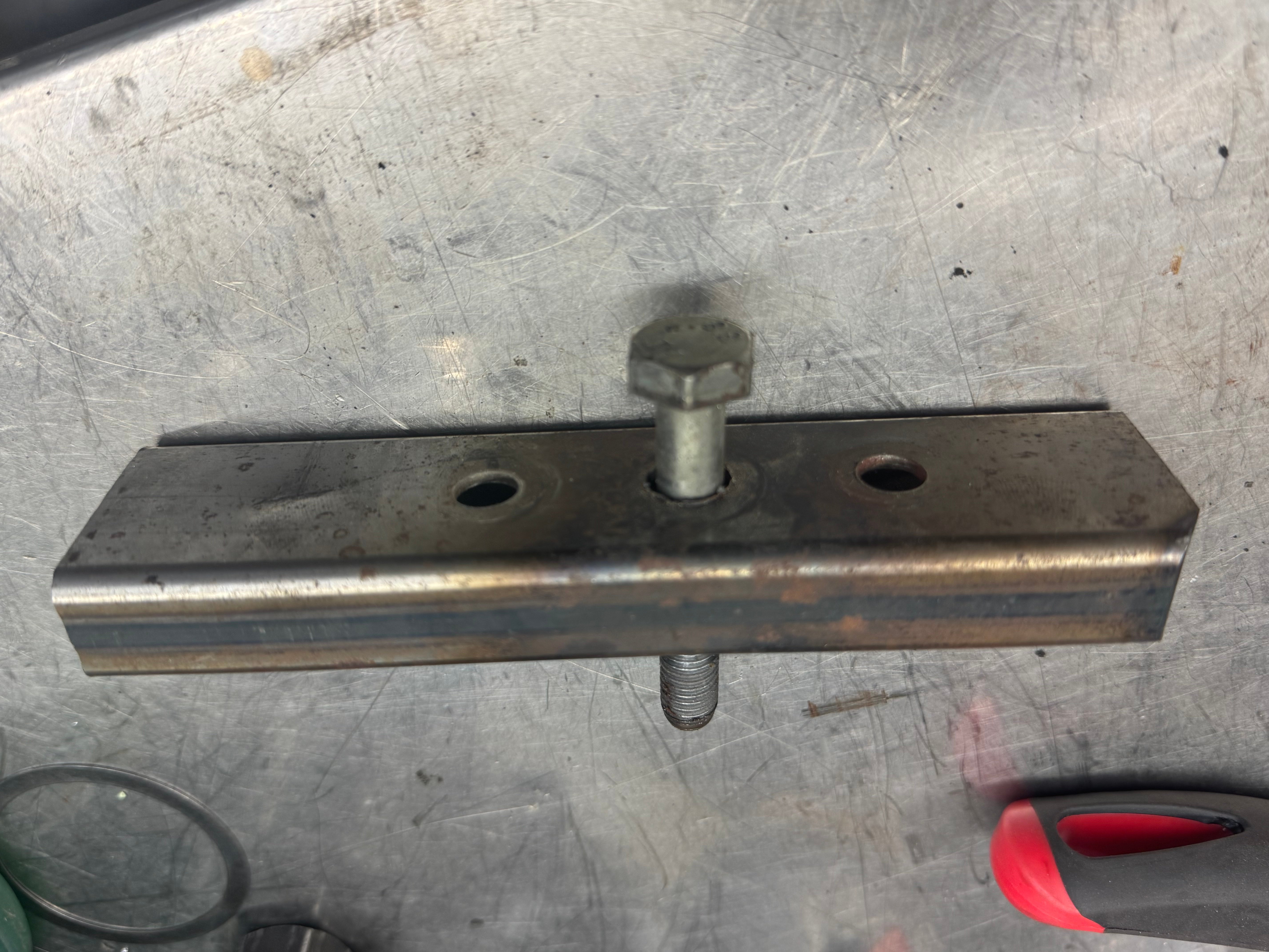

Made many a custom 944 tools over the years. Had to use this one today, made it long time ago. Any guesses?
- IMG_8968.jpeg (3.57 MiB) Viewed 405 times
- IMG_8967.jpeg (3.43 MiB) Viewed 405 times

A puller or press of some kind... but nothing obvious is coming to mind.

when doing a clutch job it can be bolted in place of the slave cylinder and the center bolt screws in to open up the pressure plate so that the torque tube will slip In to place effortlessly. Total cost…about 50 cents!

Very nice!!chris white wrote: Tue May 27, 2025 11:11 am when doing a clutch job it can be bolted in place of the slave cylinder and the center bolt screws in to open up the pressure plate so that the torque tube will slip In to place effortlessly. Total cost…about 50 cents!

I like it! I presume you fit the TT shaft into the clutch, then screw in the bolt to allow the clutch disc to align with the pilot bearing. Yes?
I also used to use a couple of long 12mm bolts with the heads cut off (effectively studs) to get the TT in the right position for the shaft to go home. This, along with your trick tool may also be helpful.

D'oh! Why didn't I think of that! Brilliant.michaelmount123 wrote: Sat May 31, 2025 2:25 pm I also used to use a couple of long 12mm bolts with the heads cut off (effectively studs) to get the TT in the right position for the shaft to go home. This, along with your trick tool may also be helpful.

yes, you will be amazed how easily the TT slips into the last inch or so!michaelmount123 wrote: Sat May 31, 2025 2:25 pm I like it! I presume you fit the TT shaft into the clutch, then screw in the bolt to allow the clutch disc to align with the pilot bearing. Yes?
