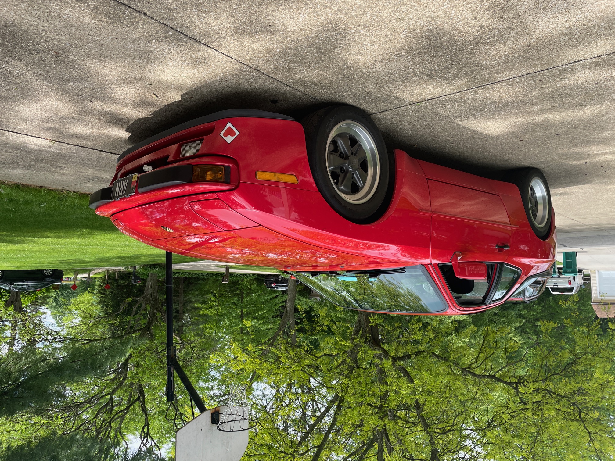

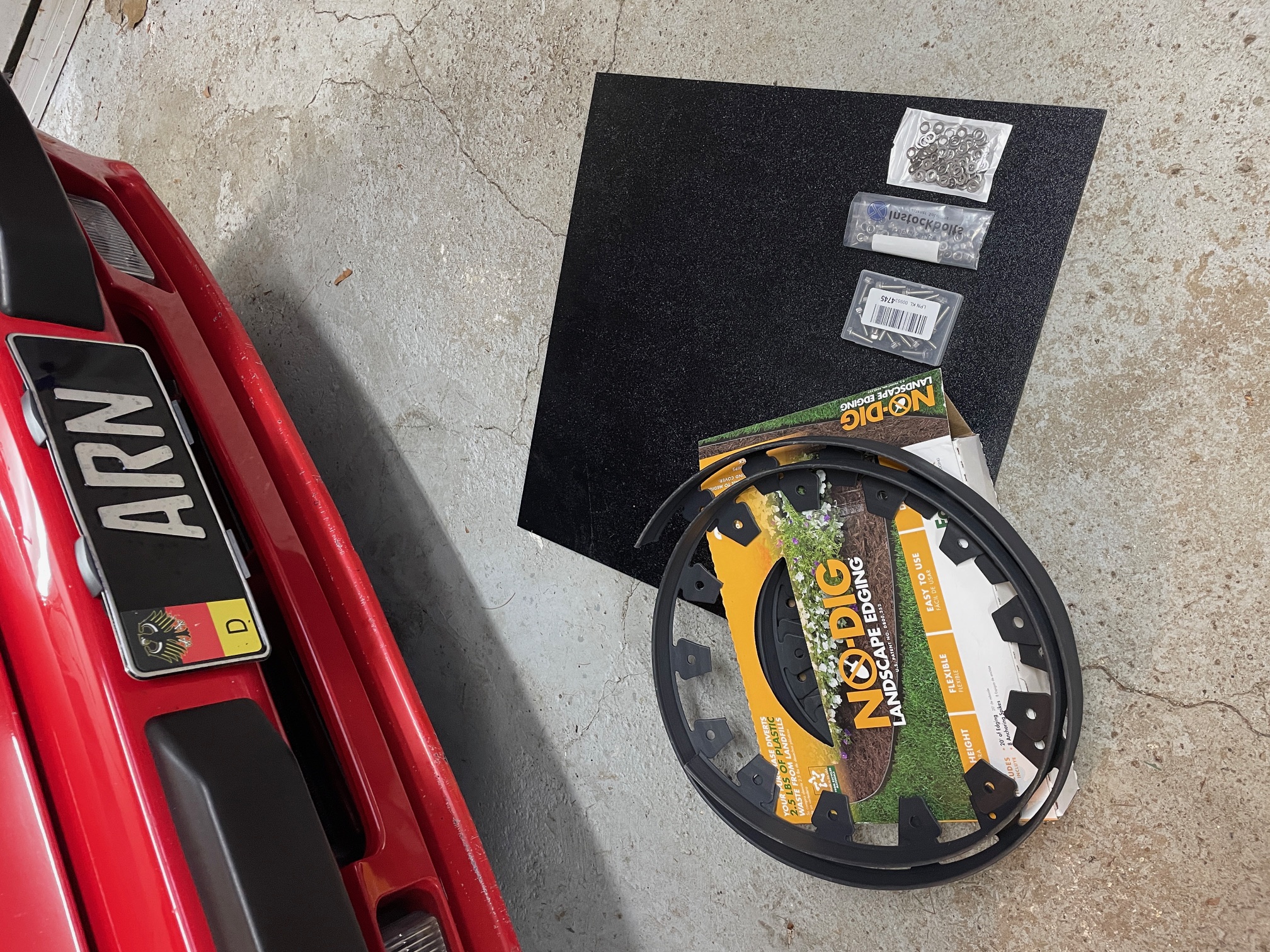

As jinky as it sounds, I managed to turn landscaping edging into a pretty sweet front lip:
Here's what I used:
- Easy Flex edging from Lowes - $20. It's 1.5" high and made in USA from recycled plastic in keeping with my sustainability goals :angel:
- 24x24x1/4" black ABS plastic from Amazon (also made in USA) - $40
- Stainless hardware from Amazon or local hardware shop - $30

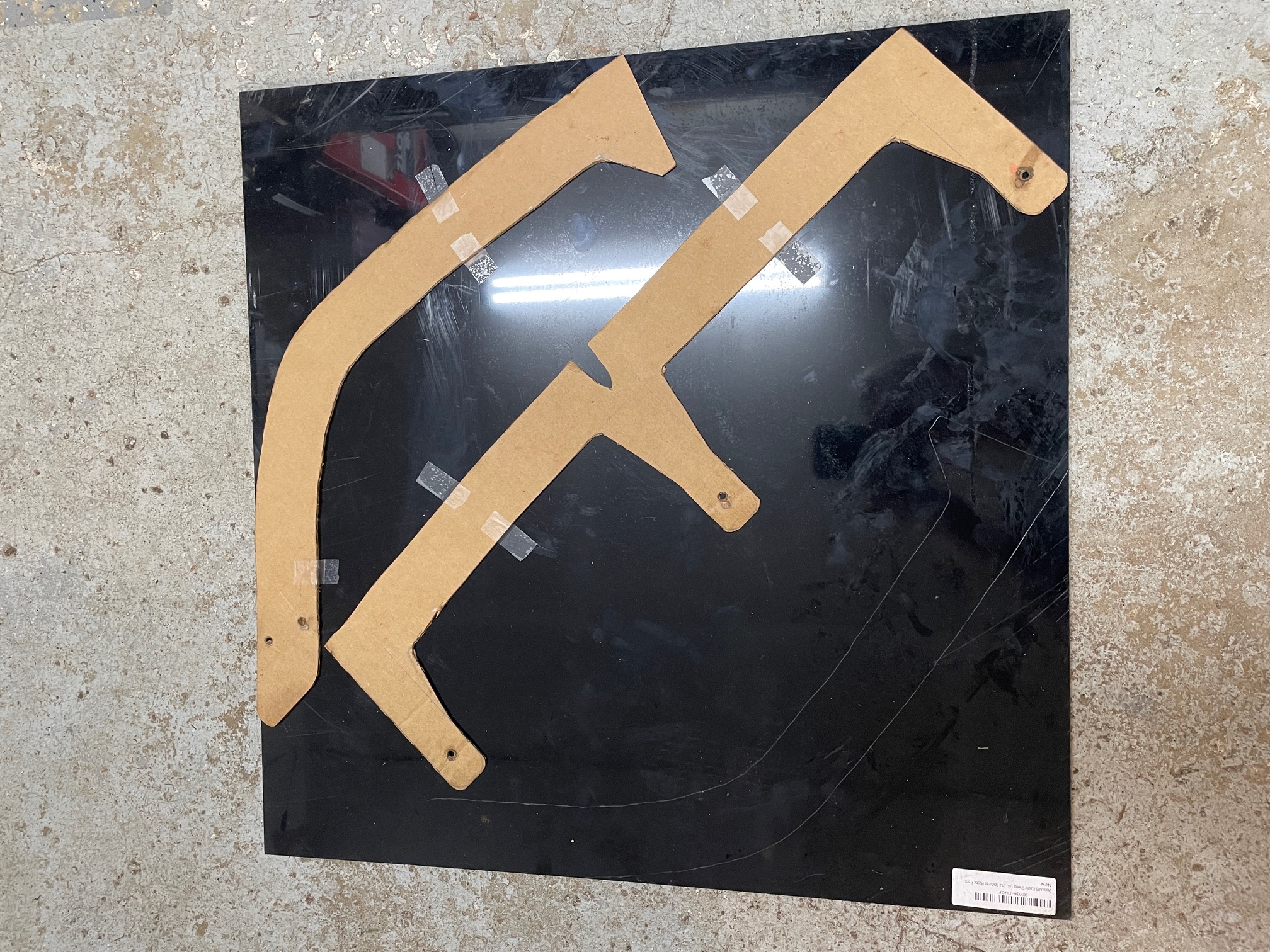

I used cardboard to do a mock up of the underbody attachment pieces:

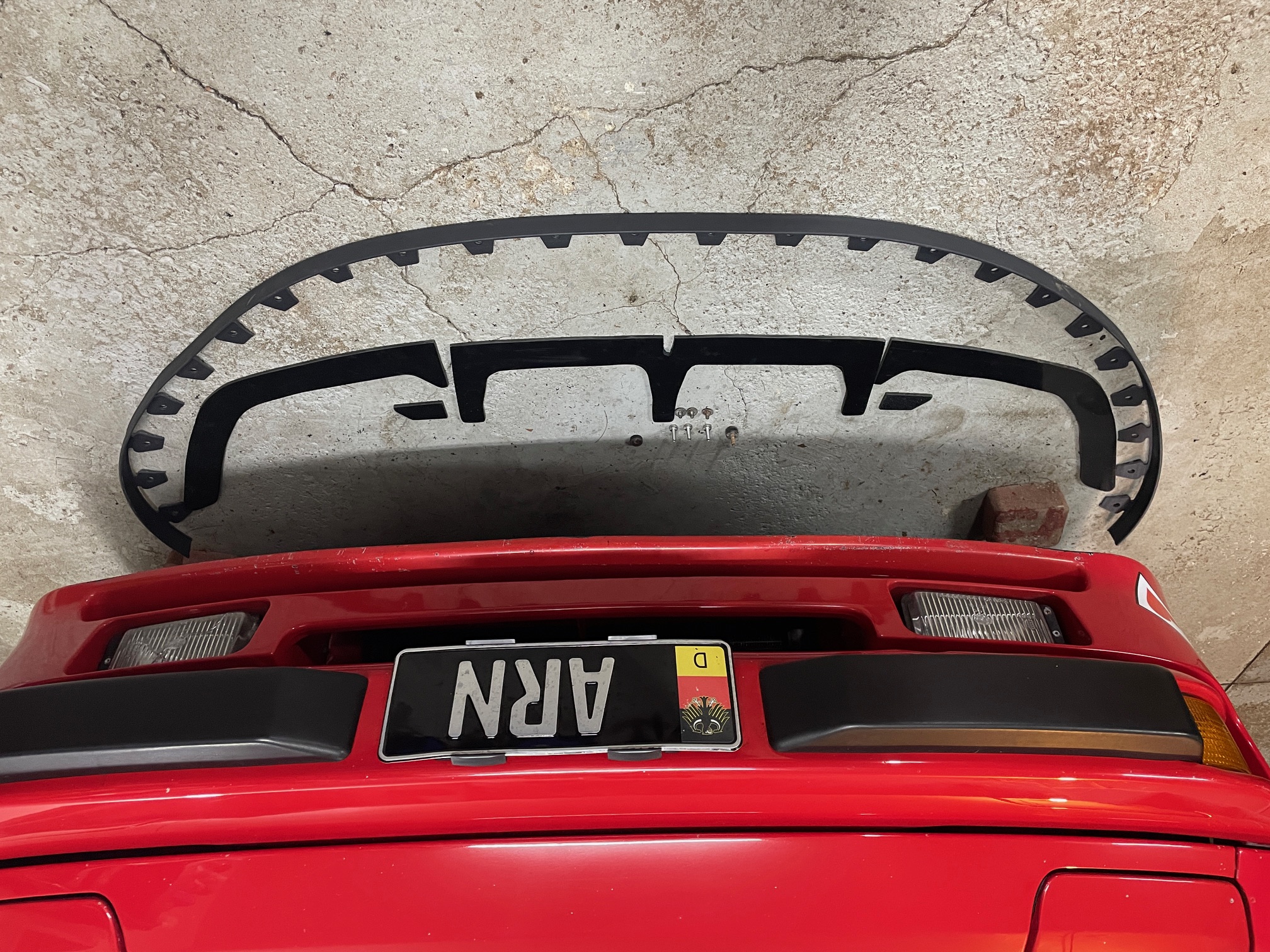

All the pieces:

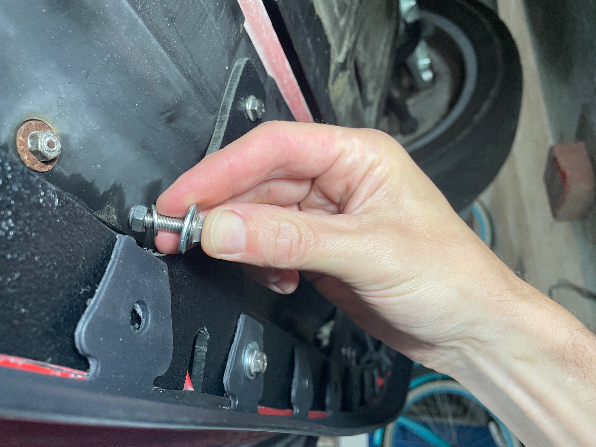

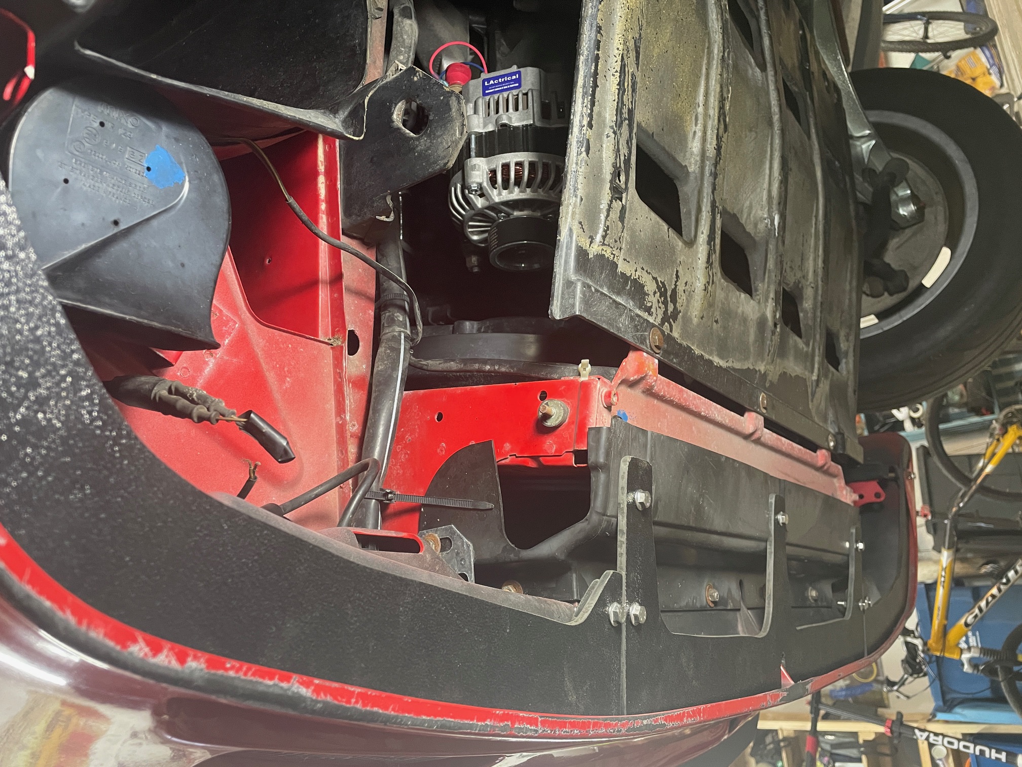

Attachment pieces installed. Uses existing mounting points.
I sandwiched the bottom edge of the front clip between the black ABS plastic pieces and the easyflex edging.

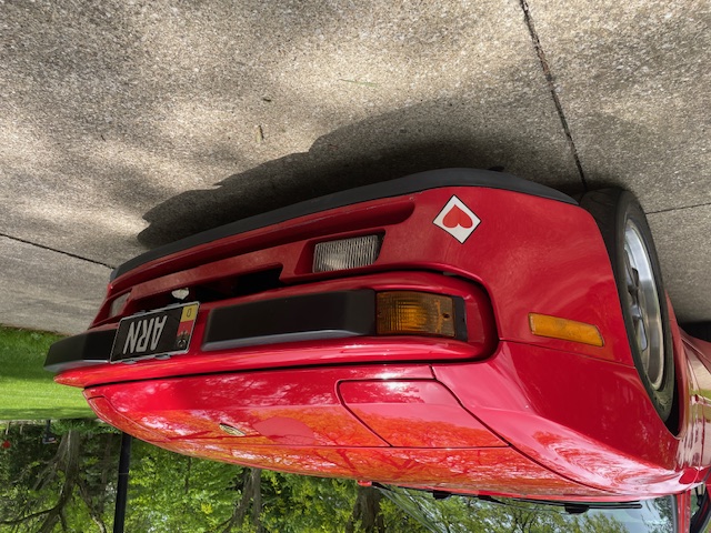

Pleased with the results. I saw a Foha spoiler at the last 944Fest and it was not as awesome as I had imagined it. I actually prefer this look. But it still has shade-tree elements: the easyflex edging has imperfections and the black is not as black as the bumperettes and rear wing. It's a good driver's car solution though.
