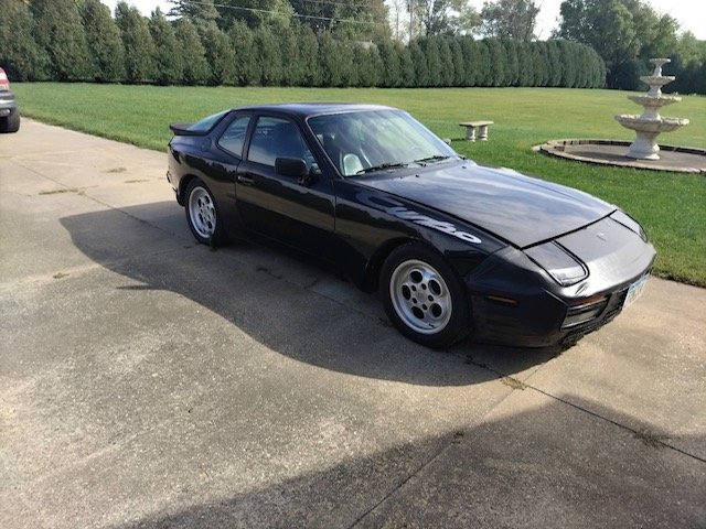

I bought this car a while back out of West Burlington Iowa, for 4750 dollars.
Having had it a few years I have gone though most systems but the motor is really in bad shape.
Really I don't always make the best choices so I have scored bores and a 3.0L crank.
its about to get interesting.

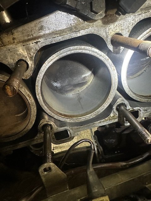

Looks great for a sub-$5k car! Don't let me talk you out of building a 3 liter turbo -- I'm a big fan -- but that scoring doesn't look so bad in the picture. I ran my old 2.5 motor for years with way worse...

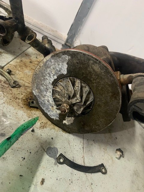

Main issue I see is that its using a quart every 200 miles or less. and if it goes into boost it creates a huge cloud of smoke from oil.

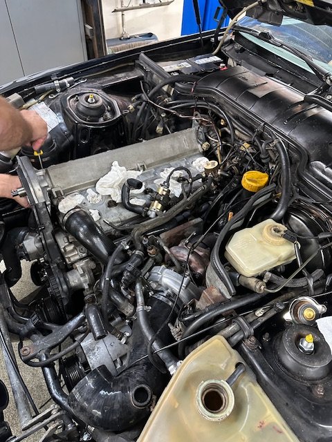

So the turbo got installed while I did the following other things
Koni shocks all around
Front rotors
Fuel pump (more on that later)
Fuel filter
all rubber brake lines, and the clutch line.

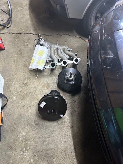

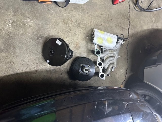

The brake booster went pop one day driving to the airport so that also.
Any seal i could find in the area of the water pump timing belt and front of the motor.
Fabspeed midpipe and downpipe.
venturi delete kit.
new tires.
misc. interior stuff
sport seats.
batwing and under engine tray.
door and hatch seals.
Deleted the light bar.
I also really like having AC so new Shrader valves and a compressor,
then tested to see if it held and filled it with R12 that was cheap and plentiful in MN.
In the process of that i was nearing the end of my time in MN and planned on driving the car home to California.
However when I went to pick up the car from the AC shop it was making a bad knocking sound from the front of the motor. I thought this was a bad ac compressor but ultimately the car quit running. Faced with no time to fix it I shopped the car home.
I wound up pulling the head leading to me finding the scoring.
I also picked up a vems that the jumper harness was a bit of a mess and ive been working on that.

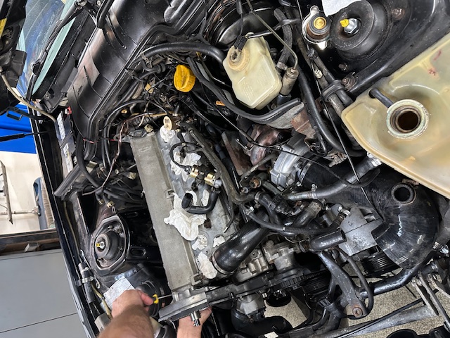

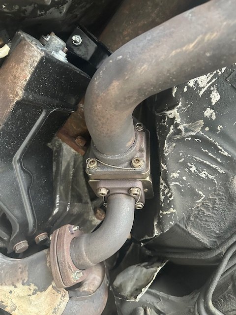

Nice to see the safety wire job. I'm old school and consider safety wire and its proper application an art form.
Looks like you are clearly making progress.

I have worked in aerospace on and off over the years so its a skill I wanted to learn as a engineer to be able to know if it was done right and then be able to do it right rather than just complain about it.
One day the brake booster went pop so it got one of those also.

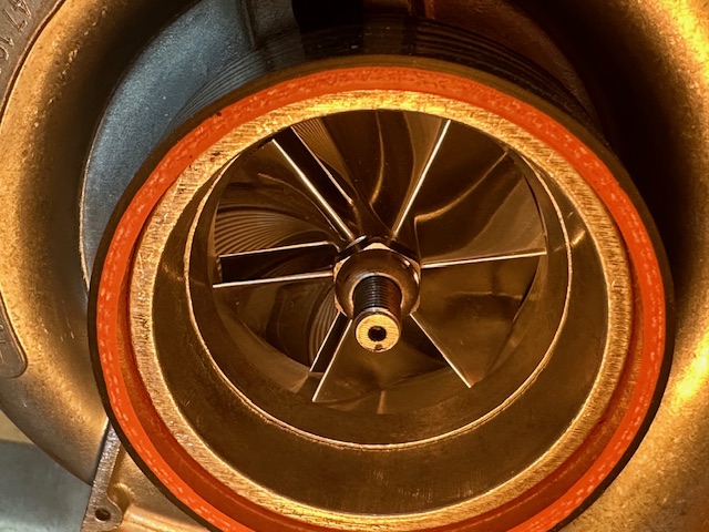

Will be interested to hear what compression ratio you settle on. It seems 9.1 is widely accepted. Wondering what a good compromise is for a fun daily driver that might see a track once a year or so.
