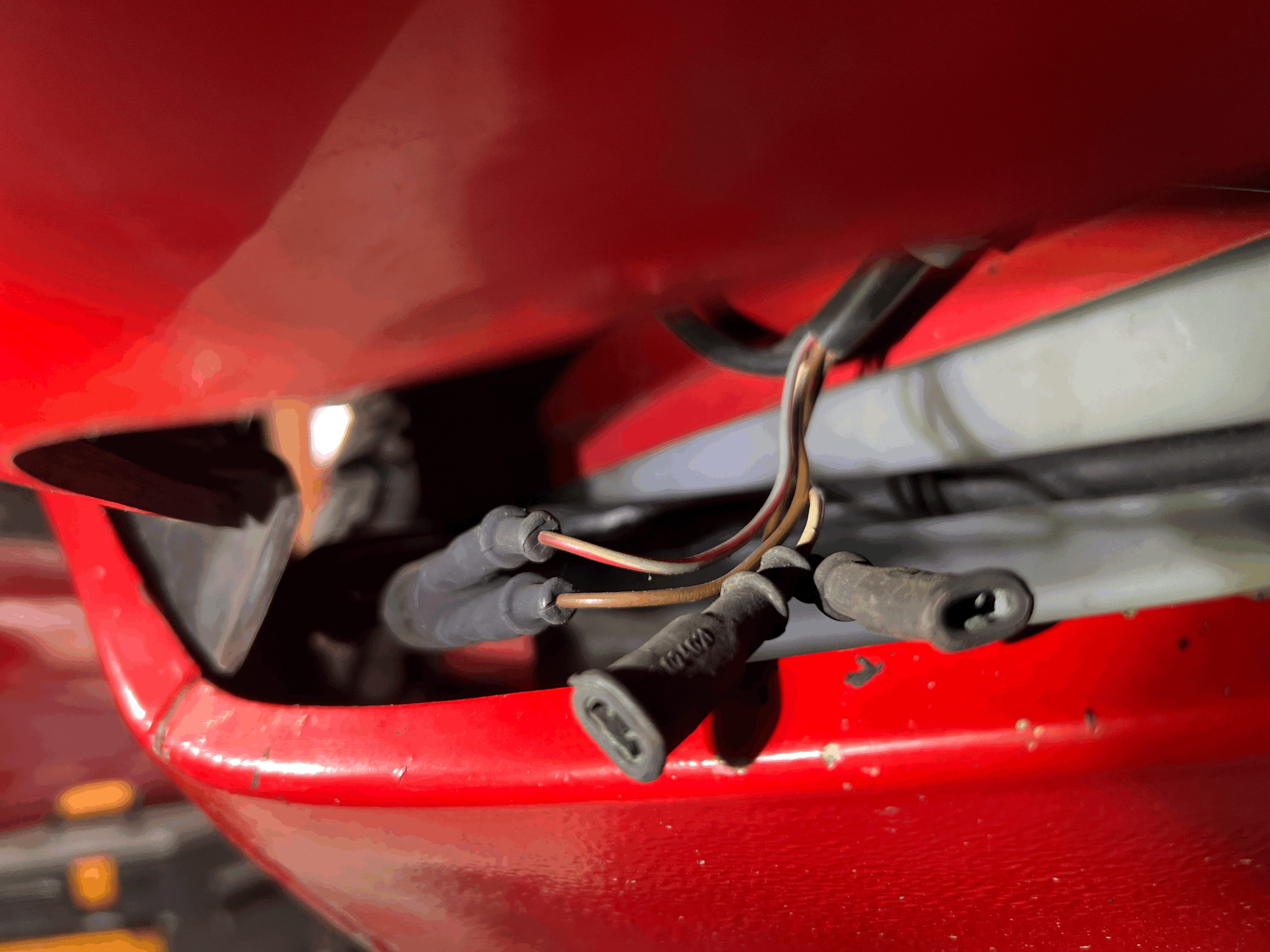

From what I gathered I believe i found the two pre-wired attachments in the front area.

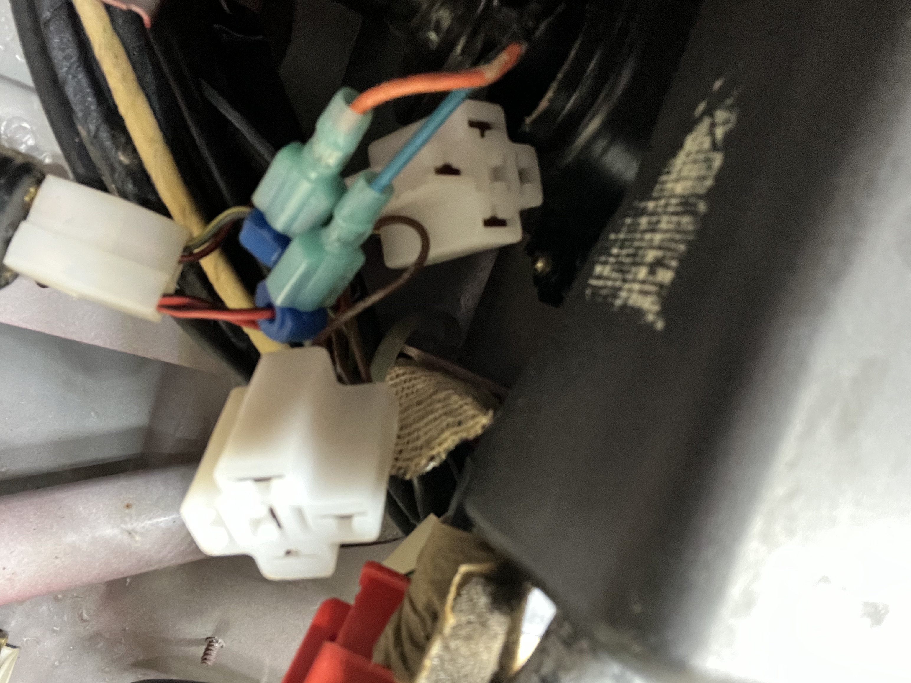

From there i think i am suppose to add two relays- located in the position next to the Sunroof/radio relay under the steering area...
is it these two white ones?
any specific relay needed? can a generic ones be used?
on an aside, the previous owner added trailer brake light hook up... im not sure if that is what those blue attachments are...

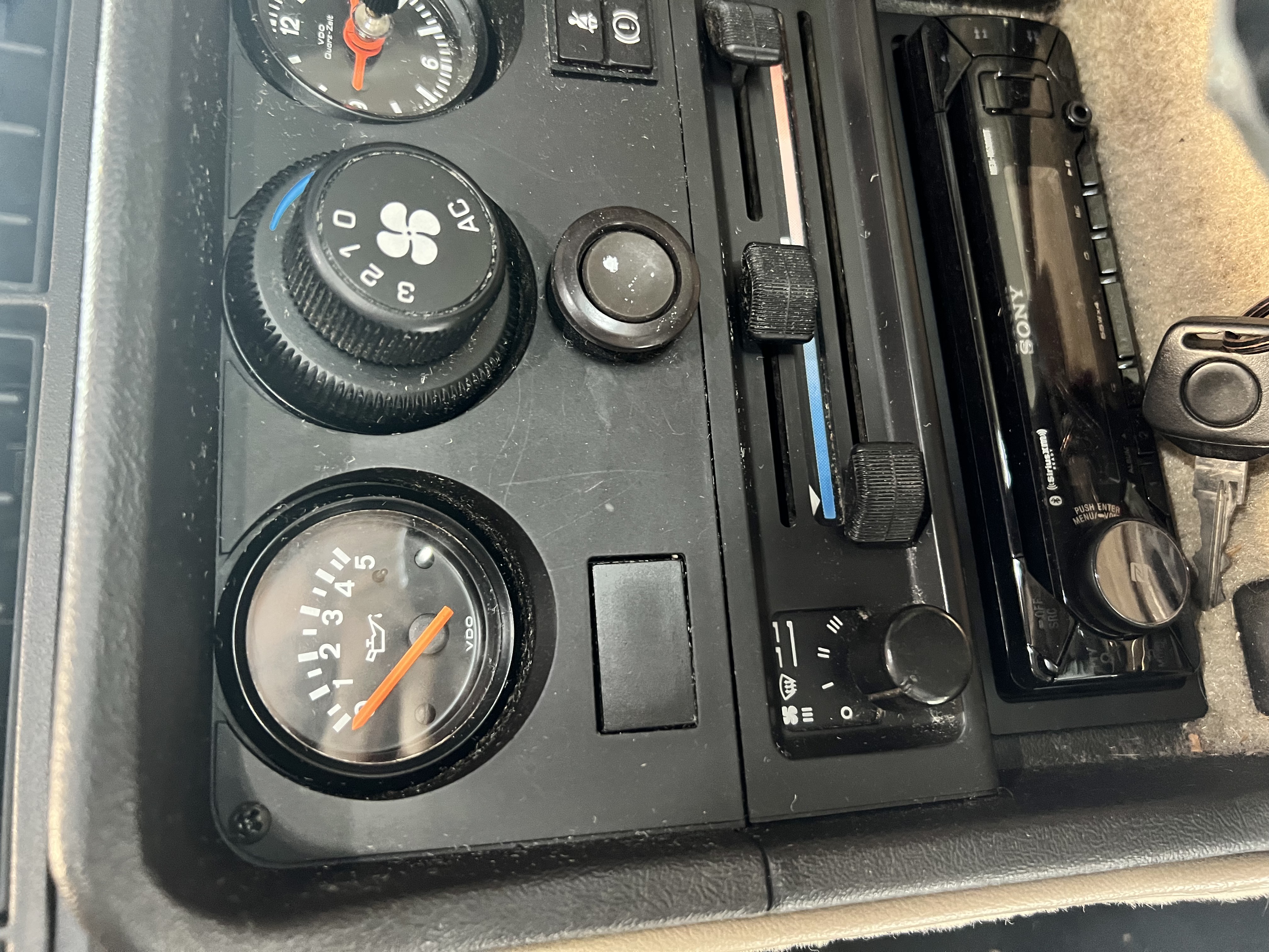

From there: Is there wiring to the spot where the fog light switch would normally go in cars equiped with fog lights?
I see some mentions of a "rear fog light switch" also....

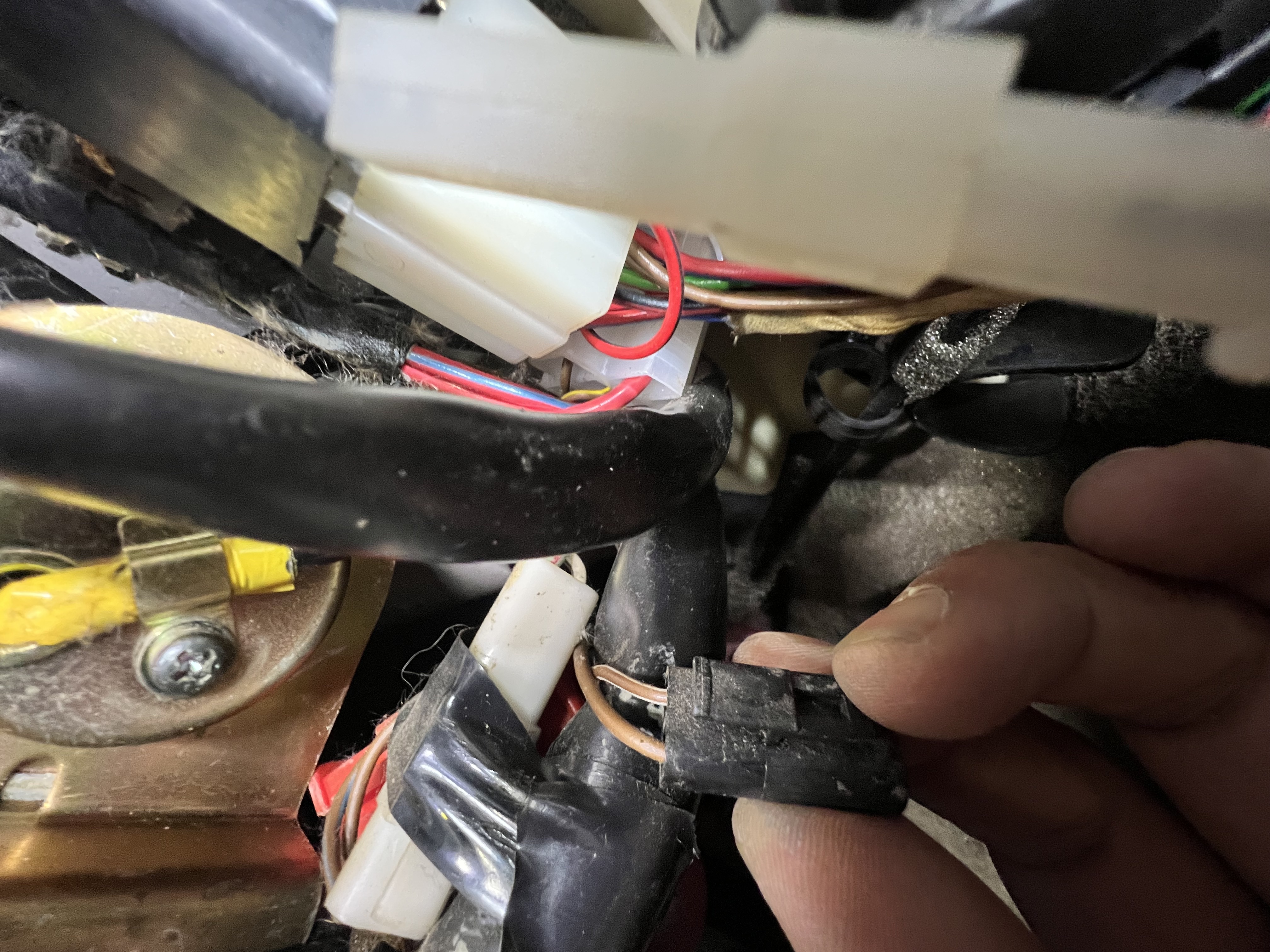

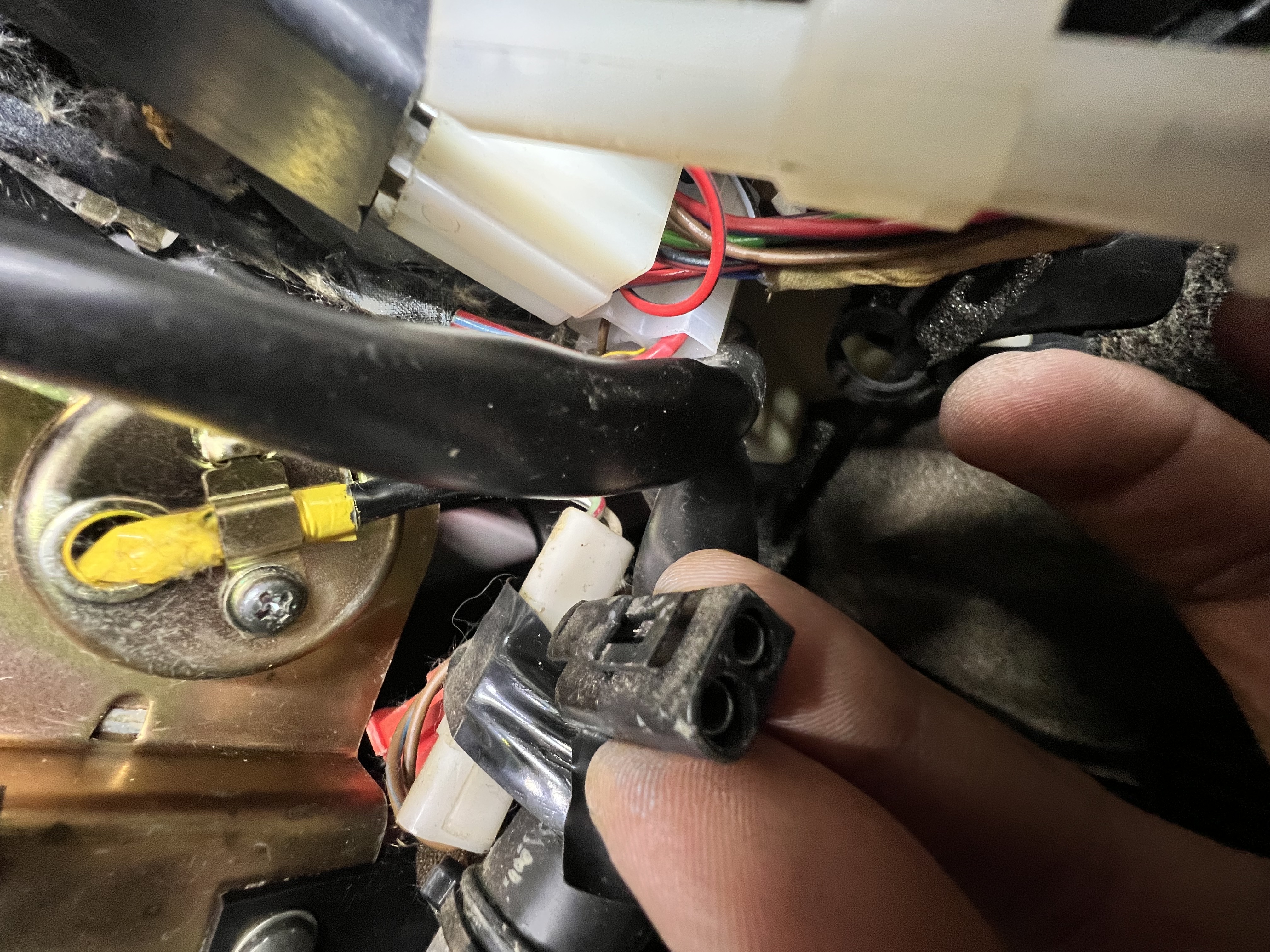

Lastly i found this connection underneath if anyone could tell me what its for just for knowlege sake...

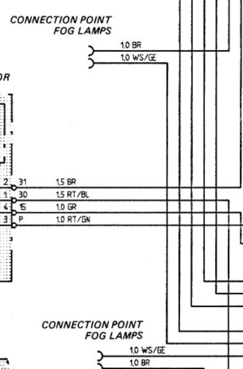

Our cars come pre-wired for just such an option. It's plug 'n' play. The relay should be P/N: 944.615.119.00

so by the diagram it should be two of the same relays? Porsche Multi Purpose Relay?
would this work ? https://www.fcpeuro.com/products/porsch ... 9965701690
