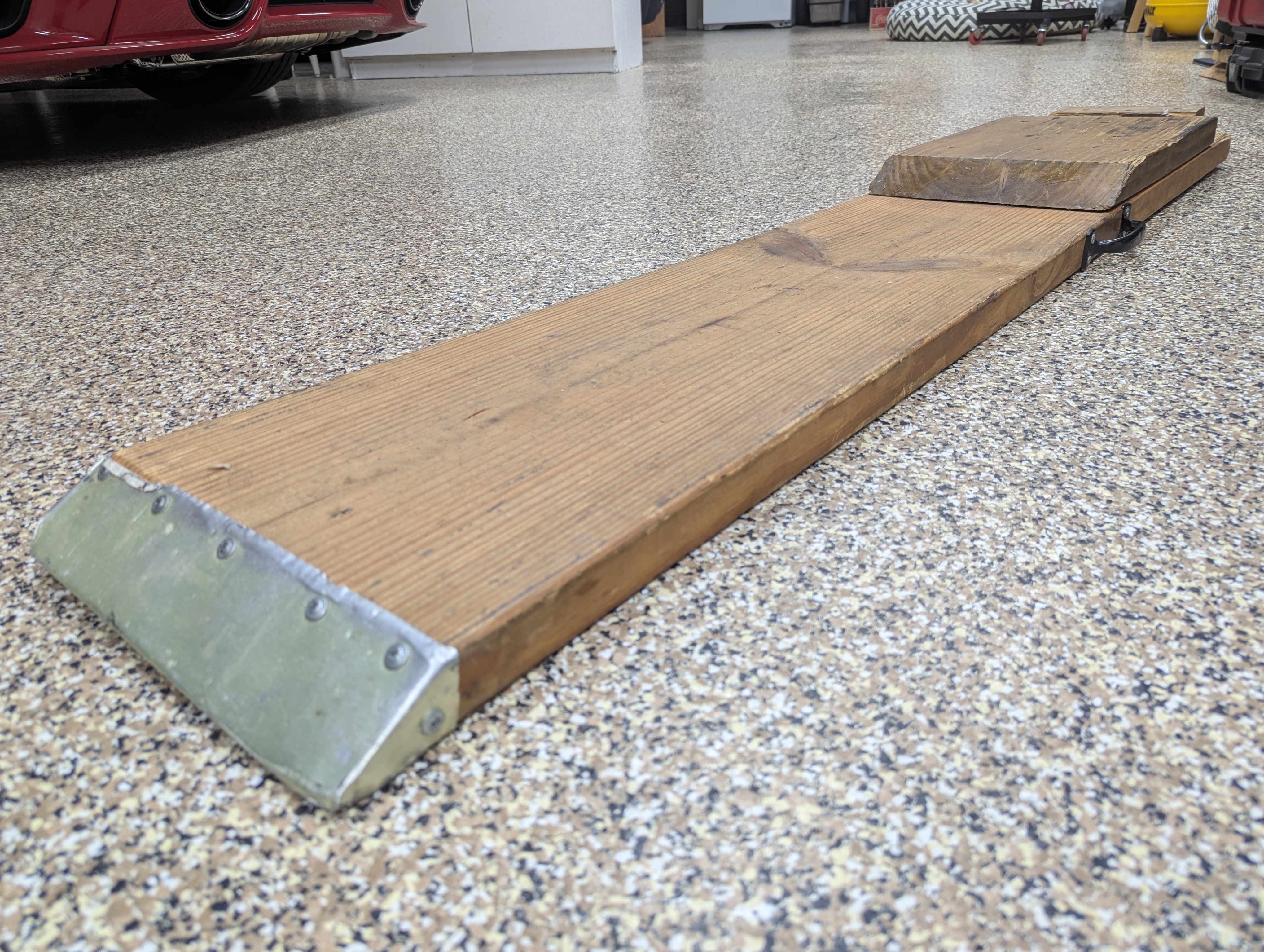

Regarding your bed-lowering trailer, you could rig (or buy) some ramps to ease the transition. Scraping is pretty common for lowered and/or race cars with aggressive spoilers, many of which are hand fabricated with little forethought or concern as to clearance.
For a previous race car, I built a set of wooden ramp extenders that were stepped and they worked beautifully - no issues whatsoever. Have had to do similar for other race or significantly lowered cars. It's something many do (extended ramps), so it shouldn't be a problem to get around unless I'm overlooking something regarding your particular situation.
My ancient homemade ramp extenders - a bit rough after many years but they'll still work!

I currently do have to use the 1.5"h x 10"w x 36"L wood ramps to be able to drive onto trailer, but since I saw Futura's marketing videos showing a GT3 driving straight onto bed without ramps, I thought perhaps the control box brain was not programmed on my trailer correctly.
