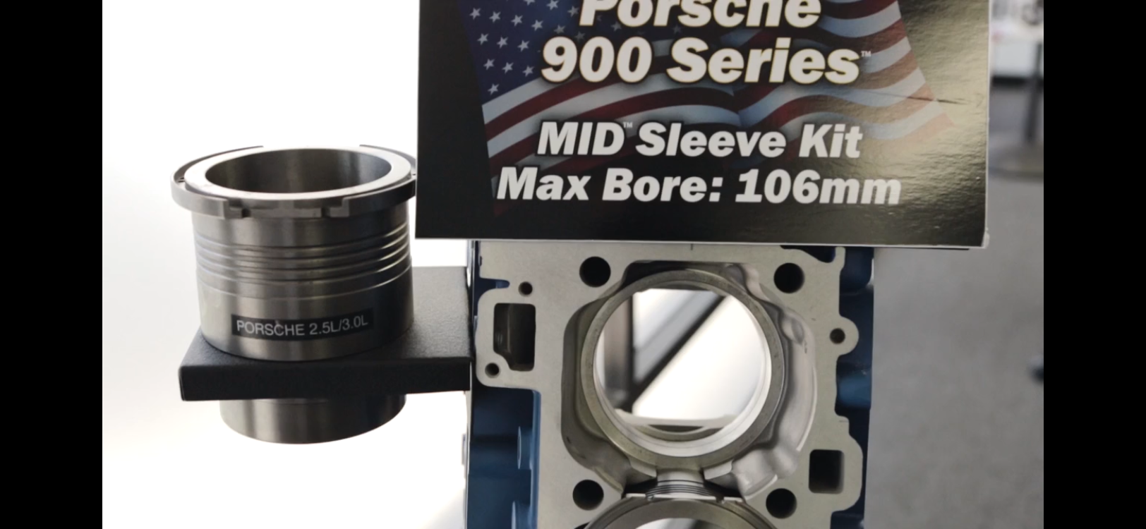

Just wanted to confirm what I am sure is correct.
You can put a 3.0 Mid sleeve into a 2.5 block?
The broken Rage2 2.5 engine block I have is 106mm dry sleeves in a 2.5 block.
Will use a Mahle piston.

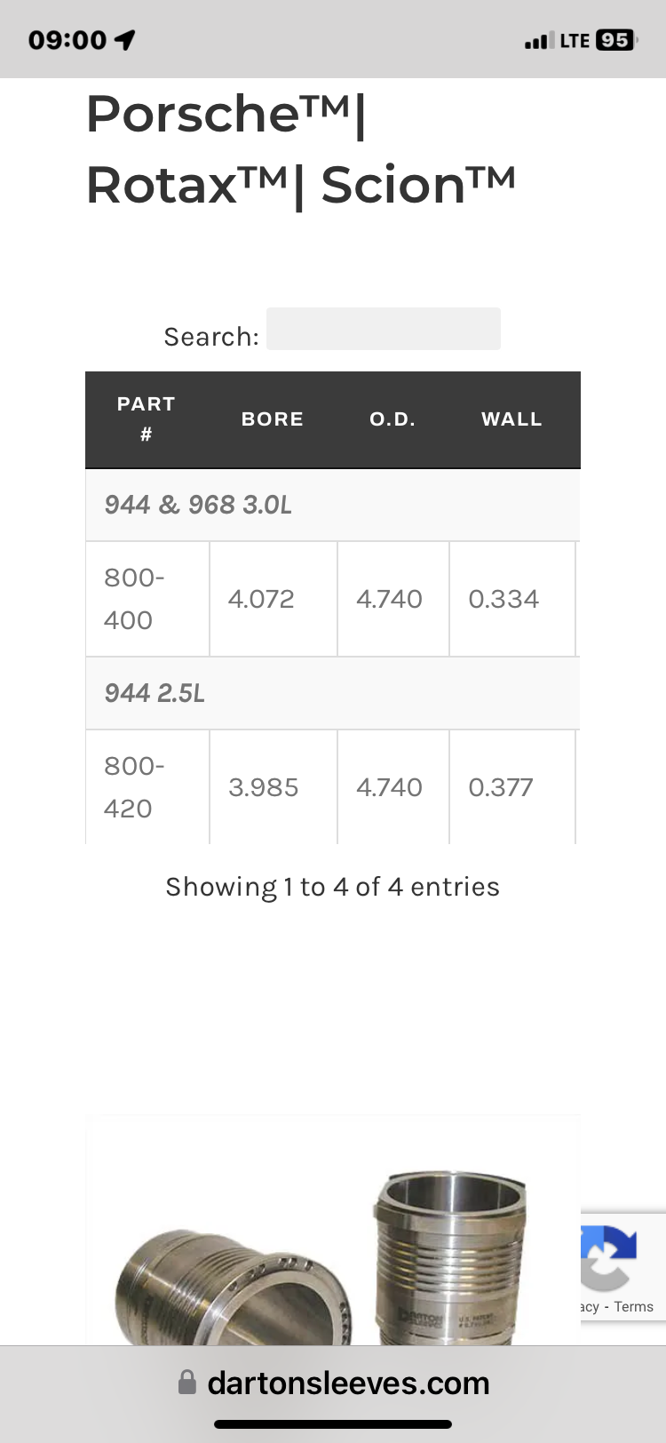

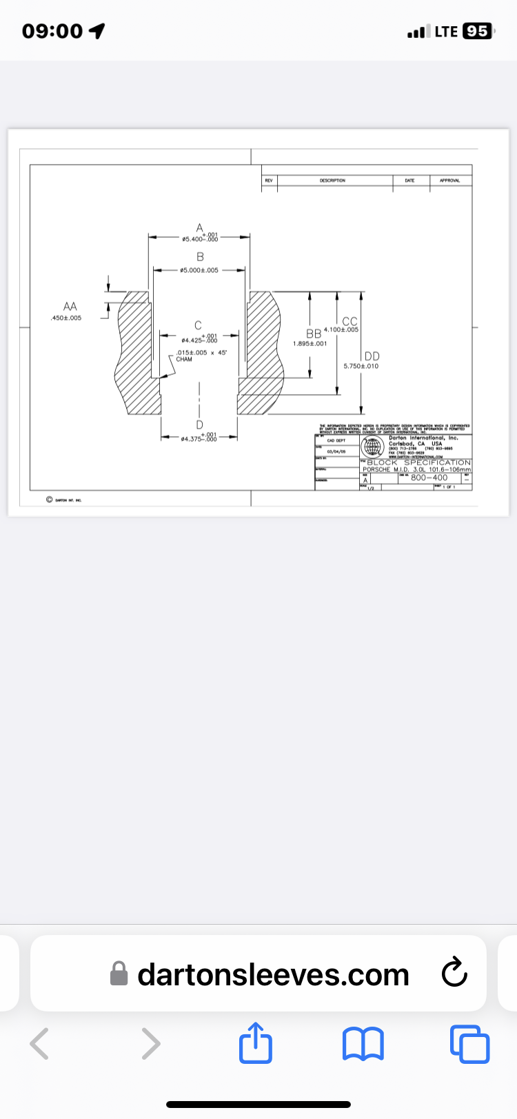

no, not even close. the 'floor' of the blocks are in two very different elevations.

It’s a little confusing as they show the 3.0 sleeve as 944 & 968
Then 944 2.5
Semantics I suppose.
Better if it read 944S2 and 968

Better I think if the distinction were made between original bore size of 104mm or 100mm.
That way, the 104mm, 2.7L 944 would be included with the 968 and 944S2.

the datron 2.5 sleeves start at about 101.5mm (their manufacturing process min limit) but you can bore them out to 104mm max.
