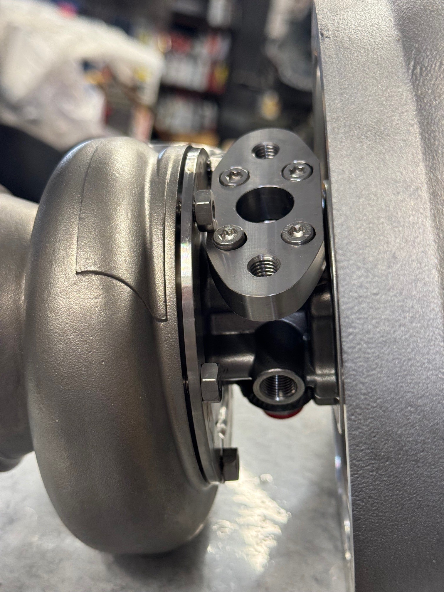

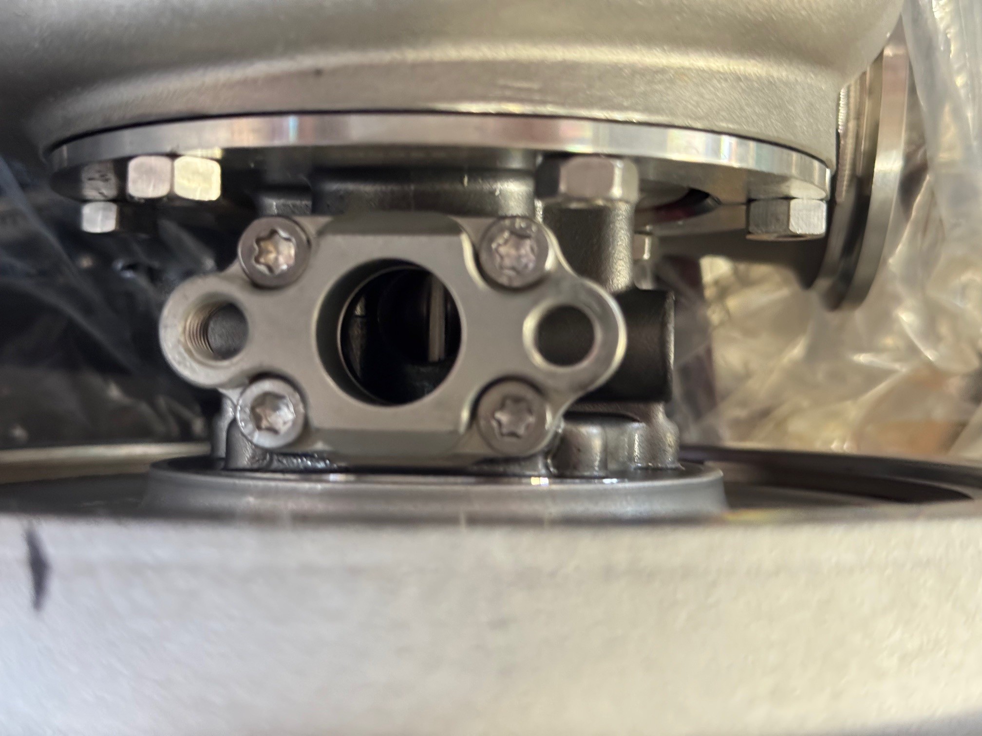

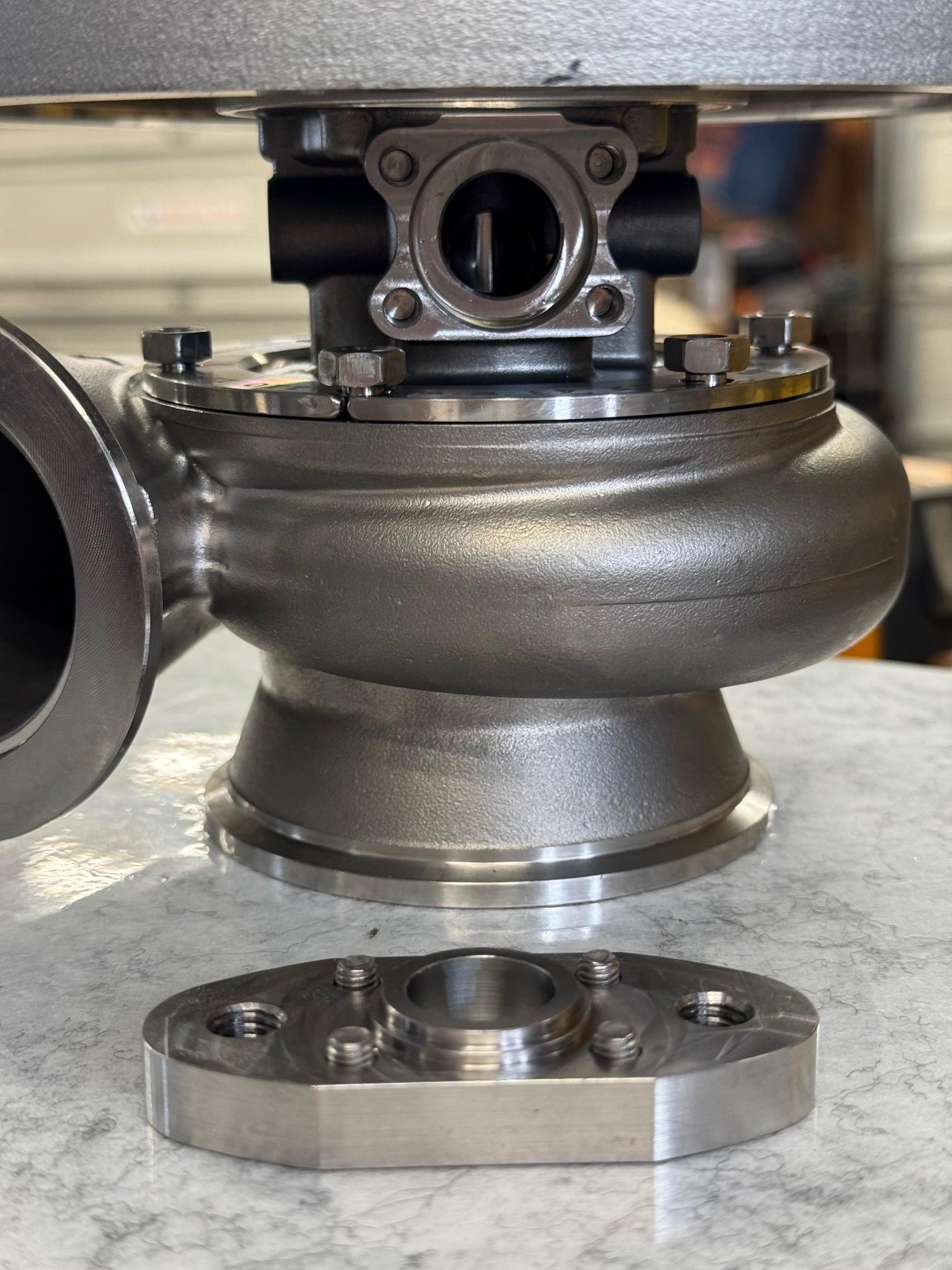

Im a big fan of the Xona rotor turbos, I started using Tial turbos before they spun off that division to Xona rotor. The stainless hot side is precision cast and smaller outside dimensions than a old fashioned iron casting. Makes the fit next to the balance shaft much better.
The compressor sides have been improving all along and there are quite a few choices that are very efficient.
Mounting them has been a little annoying….until now!
I did some CAD work and CNC’ed some mounting plates. The Xona Rotor turbos have a mounting flange bolted to the center section, you can simply remove that flange and bolt on the new one that has 944 mounting pattern. Made out of stainless so there is no way you can strip the mounting hole!
Going to be part of the 944 restomod project
