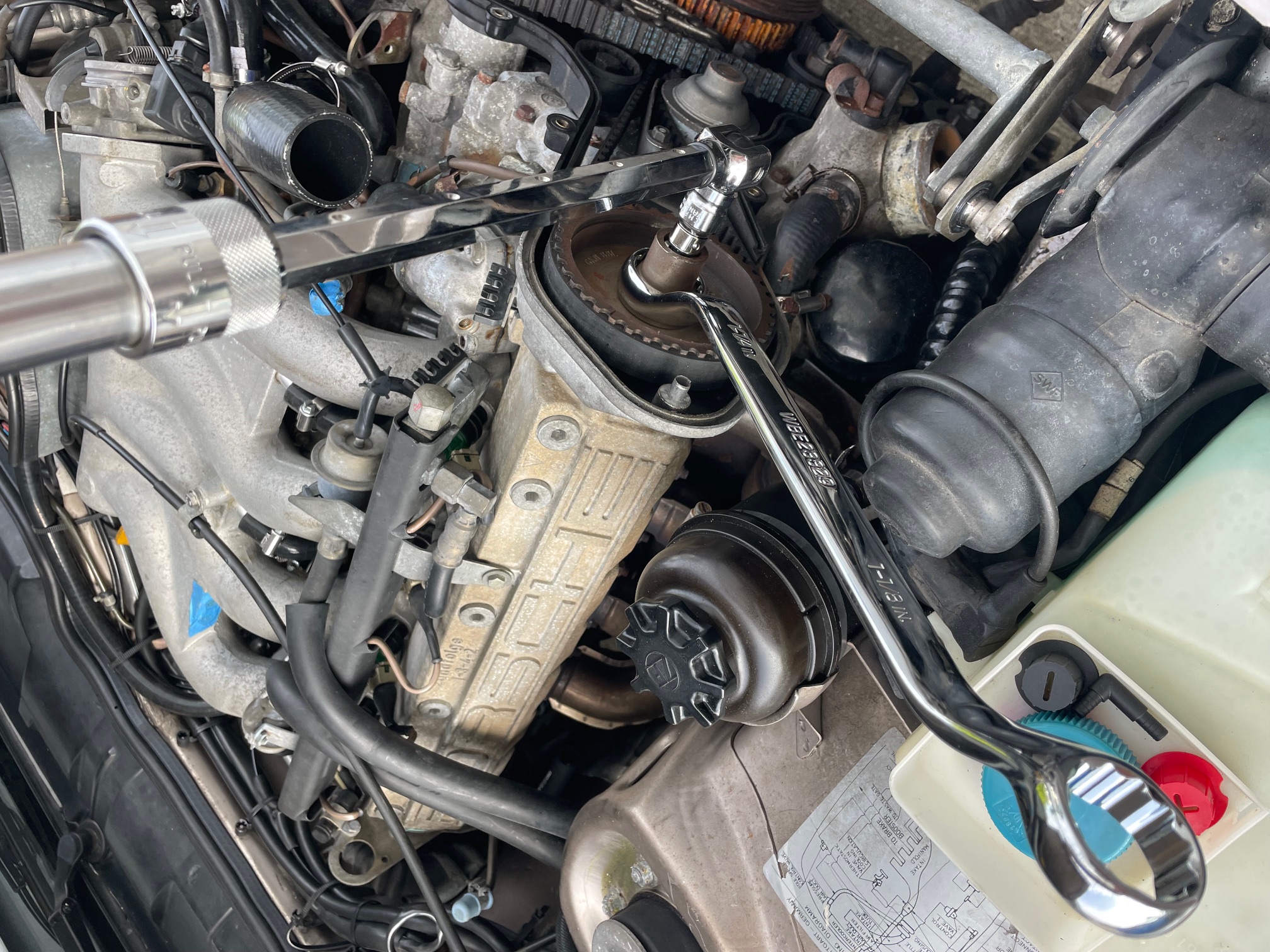

in my quest to change my waterpump , change all the belts and seals and hoses on my 951, I am trying to avoid having to pull the camshaft housing with tappets just to replace the camshaft seals. Most people seem to recommend pulling the camshaft housing to avoid any chance of damaging the pistons when trying to remove the camshaft gear/sprocket with an engine locked in place with with a flywheel lock.
So here my, maybe naïve question. Would there be a problem if the M10 x 65 mm bolt cheesehead screw which holds the retaining collar and the camshaft sprocket to the end of the camshaft is loosened BEFORE locking the flywheel and BEFORE removing the timing belt. This way you can hold the retaining collar with an 1-1/4 offset wrench and the 10 mm cheesehead tool without worrying about hitting cylinder tops with the valves because the timing belt is still in place and moves the pistons accordingly. Once the cheesehead bolt is loose, I would tighten it lightly and revert back to the normal procedure-locking flywheel @ TDC, de-tensioning the timing belt, removing timing belt, etc. Once you get to the part of having to remove the sprocket camshaft, now you can easily hold the sprocket steady when removing the cheesehead screw because you have already broken loose the previously 50 ft-lb torqued screw which has been in there maybe over 30 years.
My question is, whether my procedure can be done or would it run afoul of something I am unaware of....

You're over thinking this. I have not heard of removing the cam housing in order to change front seals before. If you lock the crankshaft with the cam pulley around 10 teeth before TDC, the pistons will be down and offer no risk of contact with valves. Be sure to use a puller, not prybars to remove the cam pulley. There is risk of breaking the camshaft if the pulley is pried or hit unevenly.
Thank you for tip on gear instead of a prybar.
Loosening the cheesehead screw before removing the timing belt is removed just to break the 30+ year hold, was a good idea....
- Cheesehead_1.jpg (1.12 MiB) Viewed 1237 times
