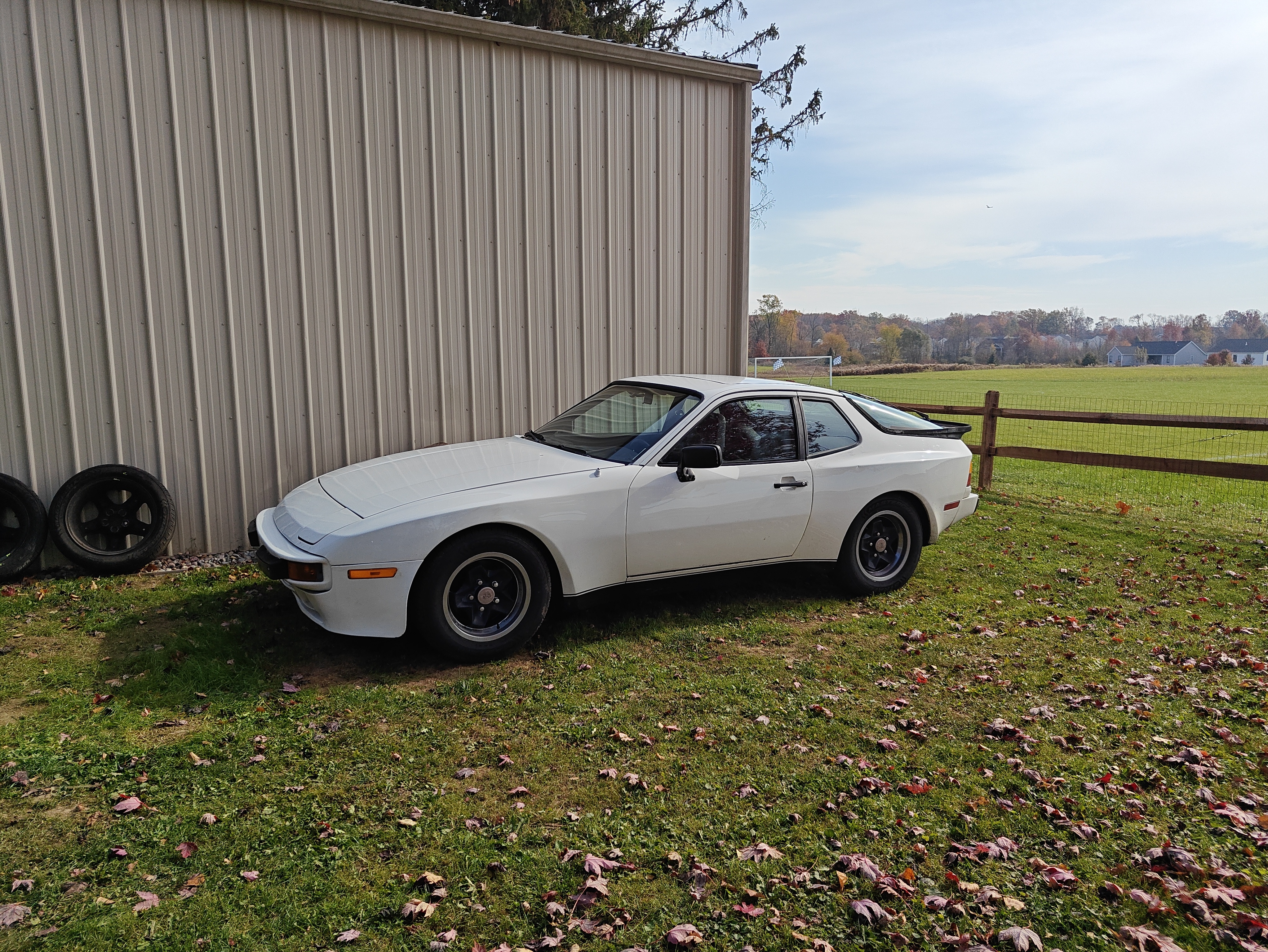

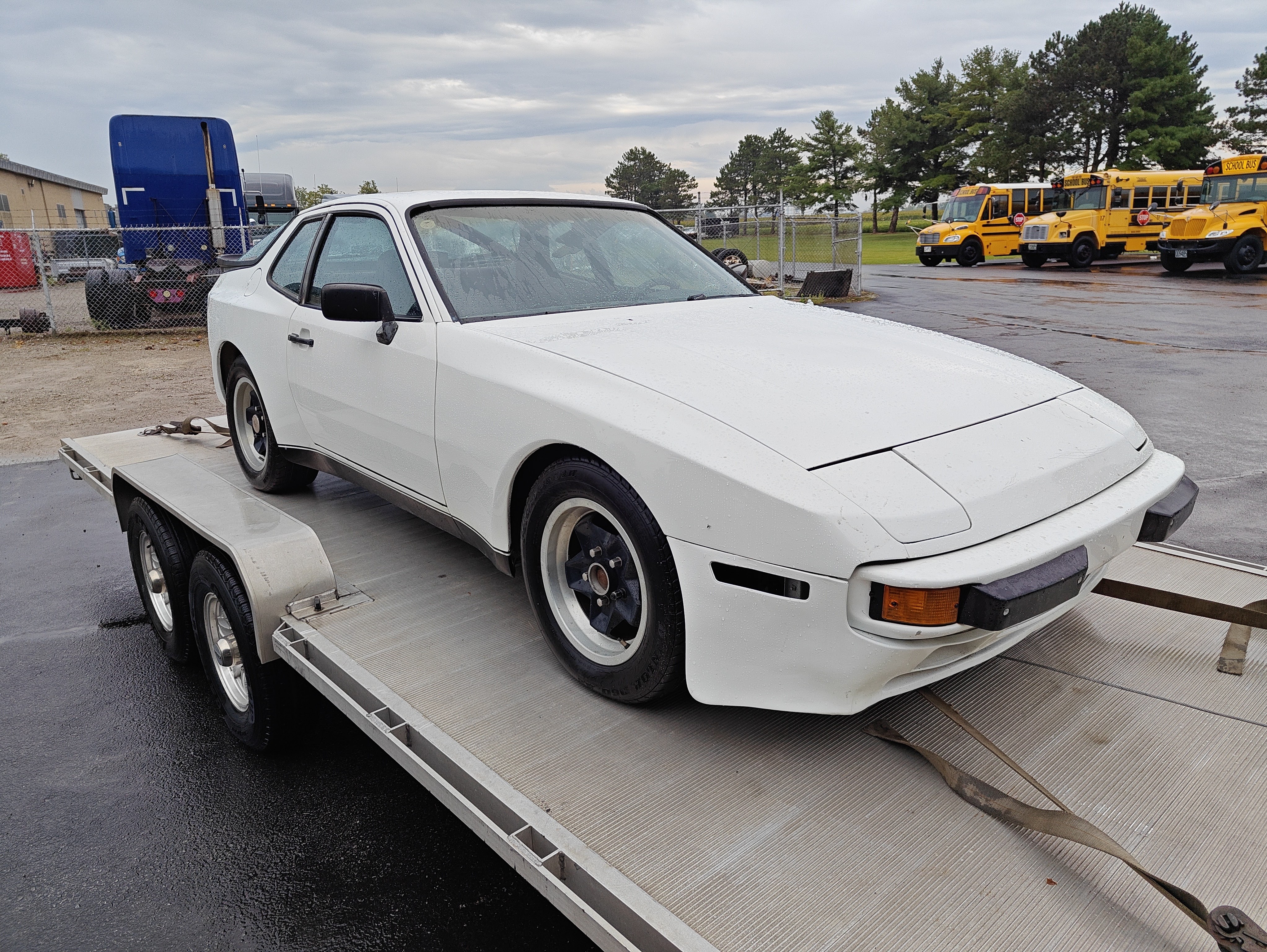

Idly browsing auction sites carries with it serious risk: In September I became the proud(?) owner of a "1985 Porsche" being sold by a nearby trade school. I purchased it sight unseen based on a terse 6 word description and five blurry photos. After that sank in I made the pickup arrangements, roped in a couple friends, borrowed a trailer, and went to claim my prize. Despite the tow rig topping out at 9 PSI of oil pressure and a few rain clouds, the car was now in hand.
Upon further inspection I now owned a sun-baked early 1985 944, 8V, 5 speed, clocking in at 138k miles. It has option code M456 meaning Koni shocks and big swaybars from factory. Running the VIN showed it was last registered around 2003. The chassis is seemingly straight, the car is virtually rust free, and all the mechanicals look to be intact. The car was originally Zermatt silver, then it was black, and now it's white. The student's masking job left a little to be desired but the paint job is overall fine.

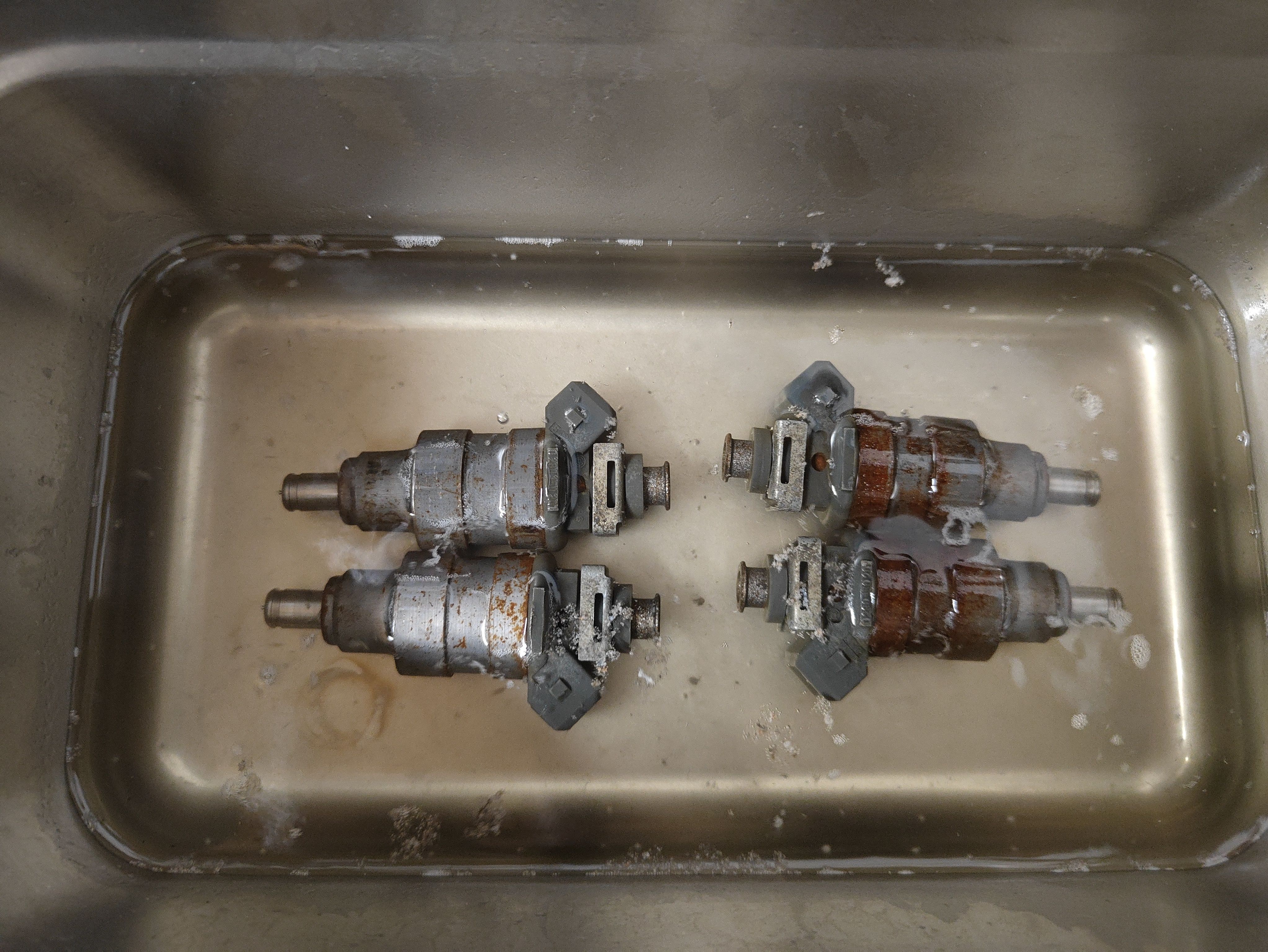

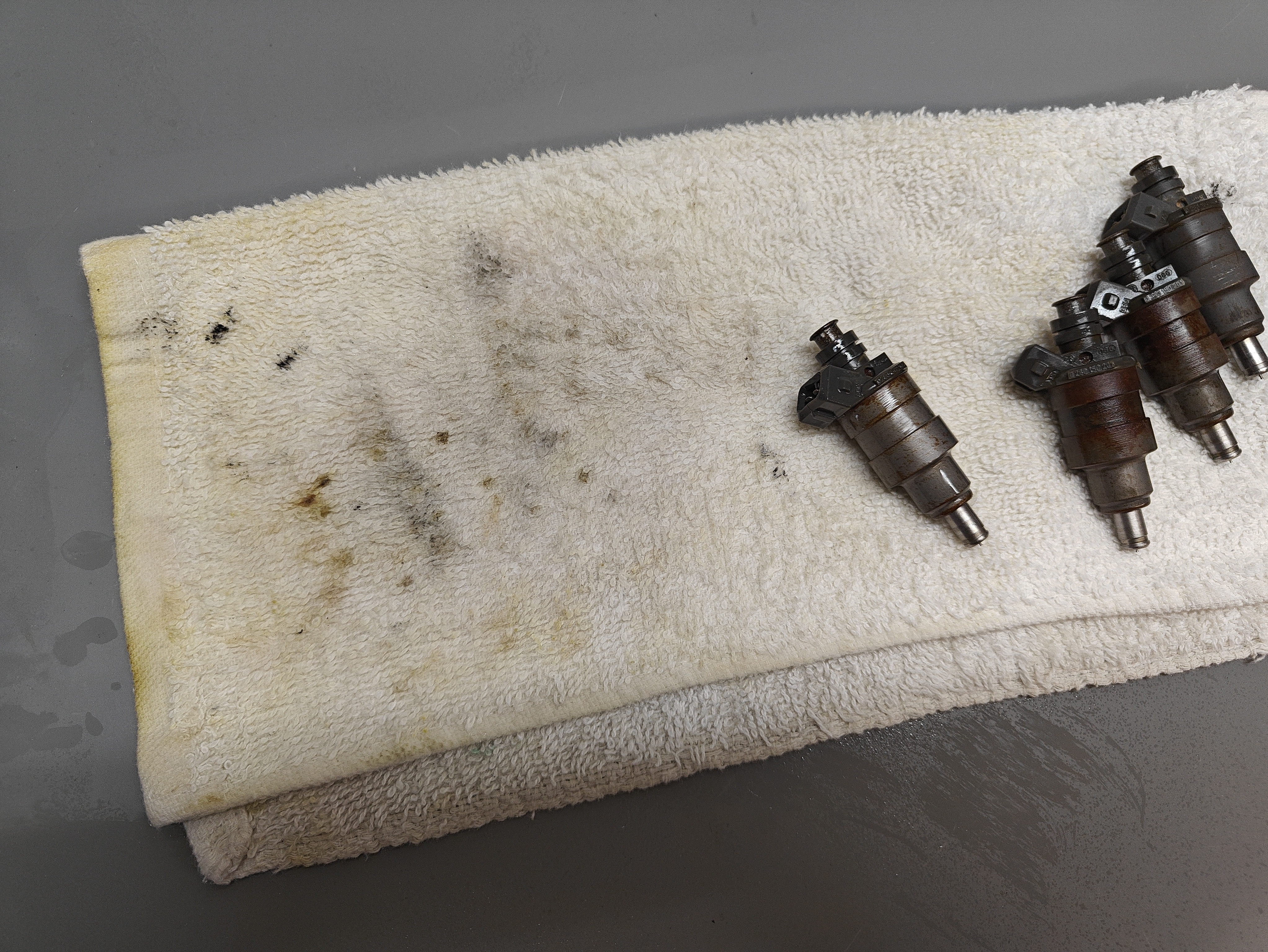

The engine had oil so we of course popped it on the charger and tried to fire it up. Amazingly the engine ran but only on the fumes of brake cleaner. Some percussion brought the fuel pump back to life but the injectors were totally unresponsive. Taking a closer look revealed they were plugged solid with mystery brown crystals. Draining the fuel tank seemed to corroborate a vehicle that had not run in 20 years.

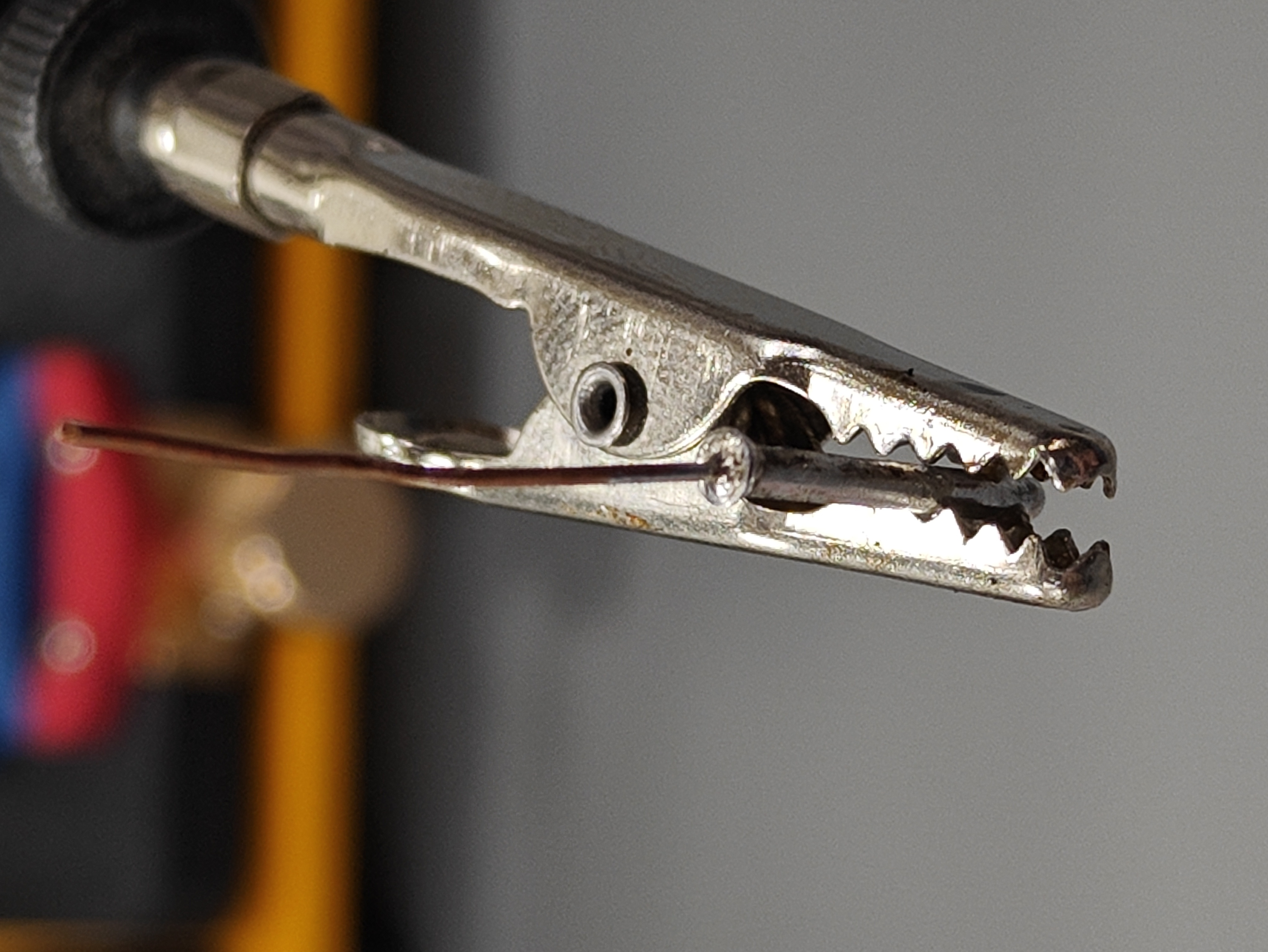

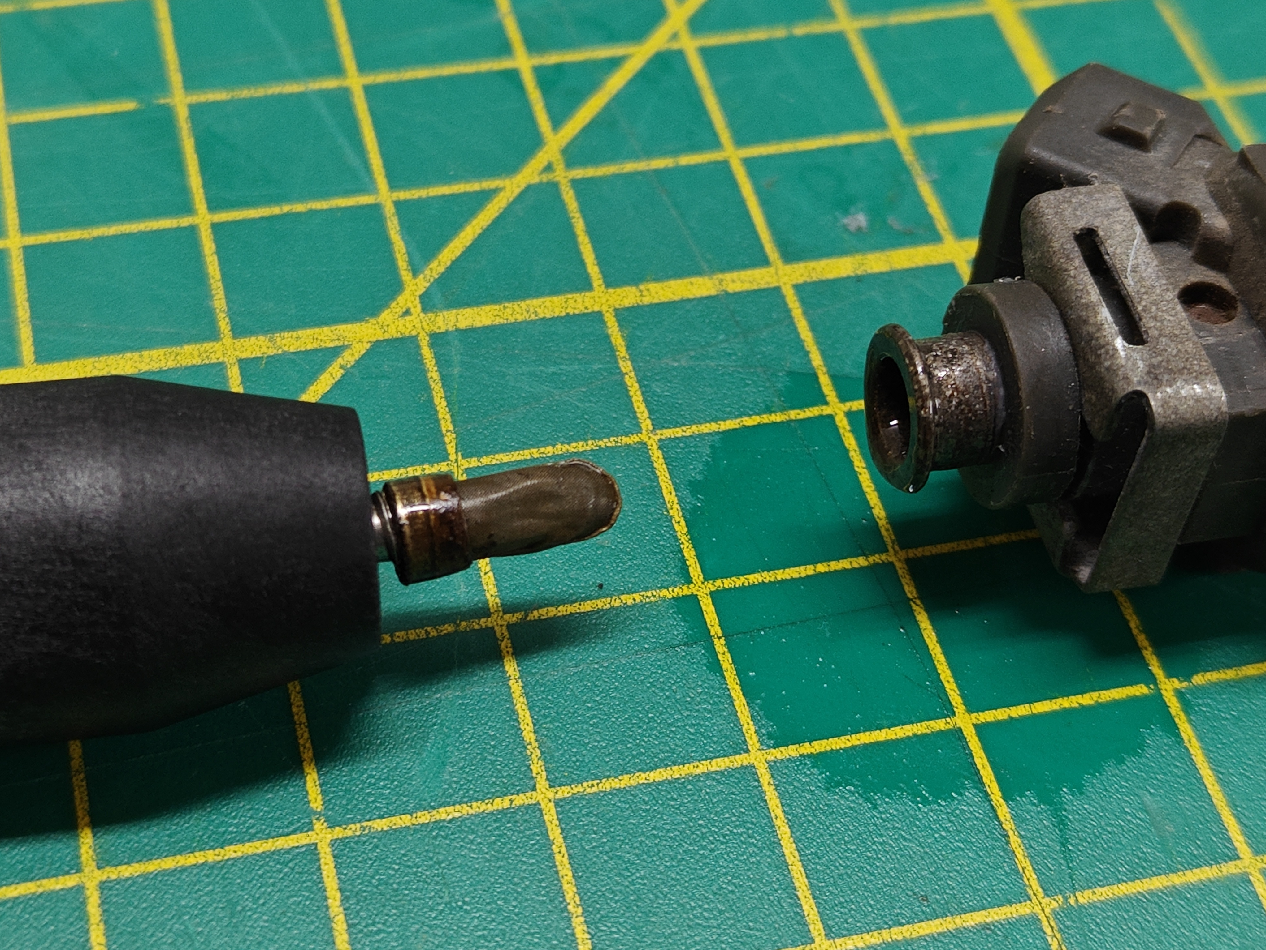

I let the injectors buzz in an ultrasonic bath for a few hours with a noxious brew of solvents, force fed a square wave driver signal, smacked some sense into them, and eventually they all freed up. Popping them back in and hitting the key let the car idle for the first time in seemingly two decades. The coolant system was bone dry and filling it revealed a small radiator leak. Despite that the car had no problem putting up and down the street.

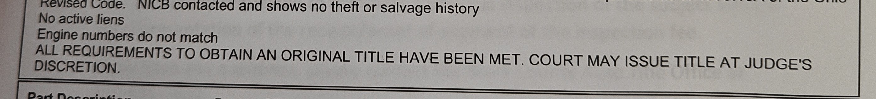

When someone buys a car they must always get the title - or so the title office man tells me. Having just a bill of sale left me in a tough spot with only a few routes out. If you ask very nicely the title office will give you a super secret instruction packet describing how to persue a 'court ordered title'. The process varies state to state and even county to county but the general idea is that you need to:
  • Prove you now have possession of the car, that it has no leans, wasn't supposed to have been crushed, and isn't reported stolen
  • Prove you tried to contact the last title holder on record
  • Prove that it's a road legal and roadworthy car
  • Beg a common pleas court judge to sign off on everything
Most of the steps are just legwork: printing receipts, going to various offices, filling out forms, sending letters via certified mail, and getting things notarized. The road legal part involves having it inspected by the state highway patrol which meant I actually needed to make the damn thing road legal.

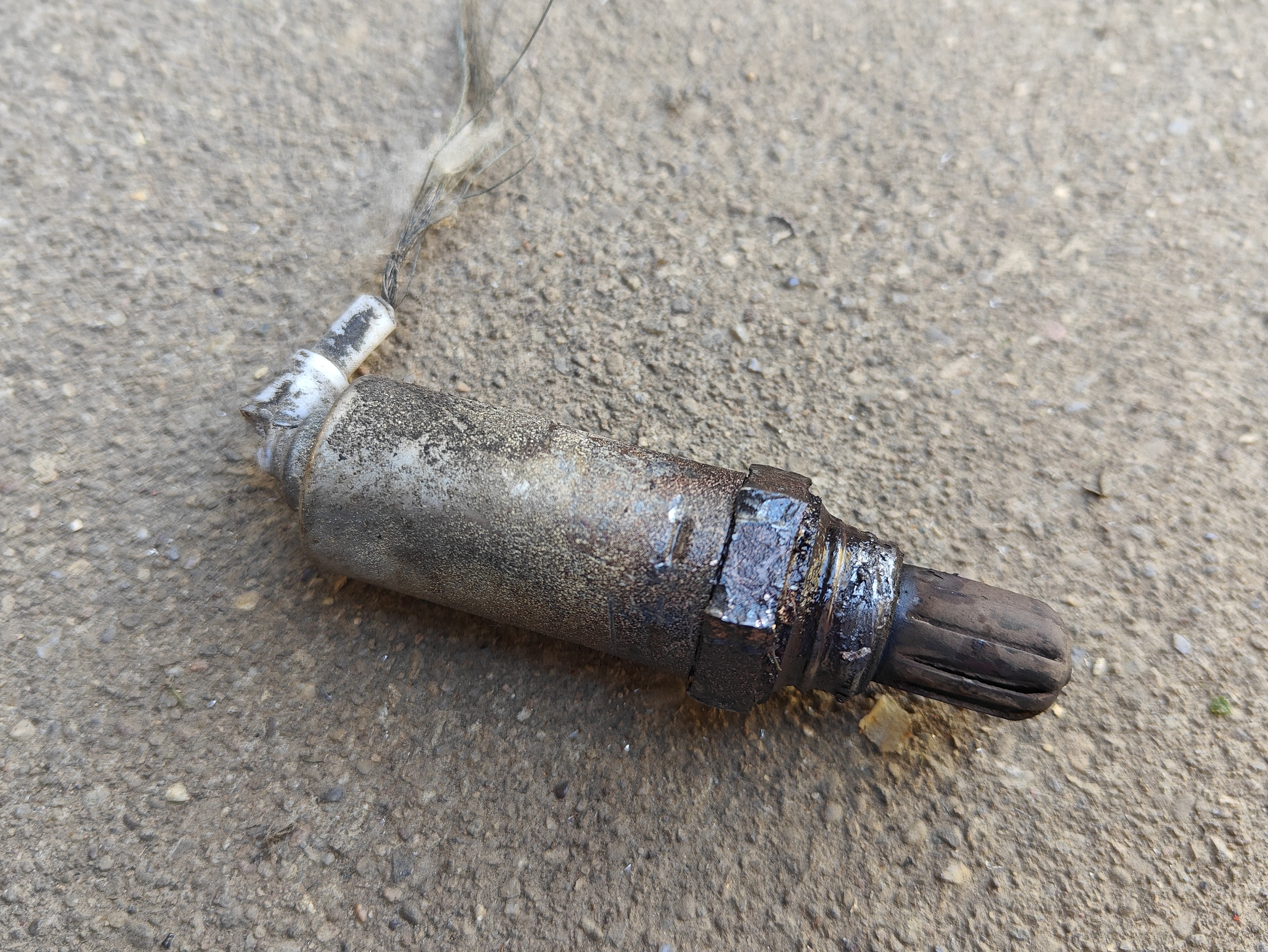

The O2 sensor was in a sorry state and attempting to remove it destroyed my bunghole. It was a pretty quick job to drop the exhaust and weld in a fresh one.

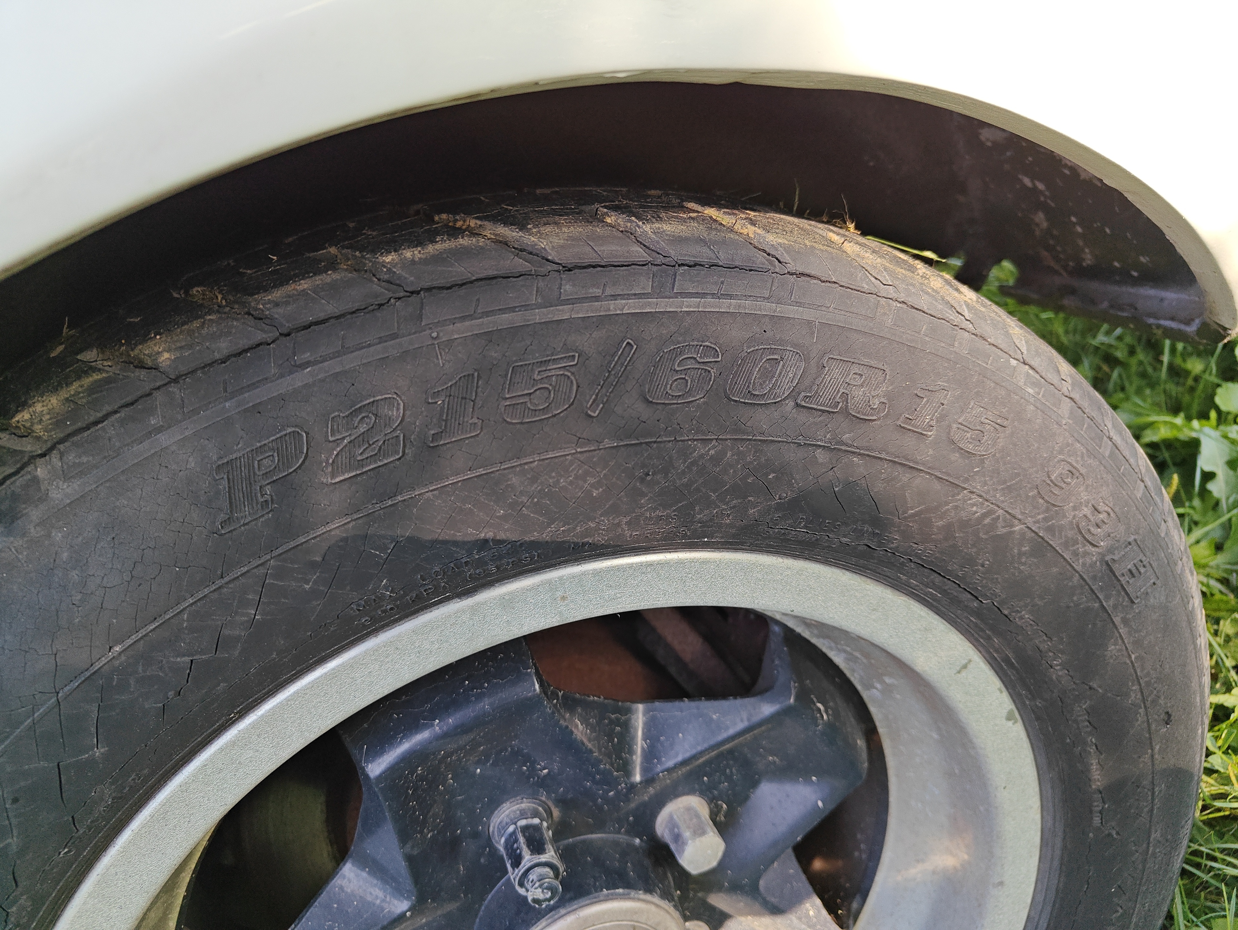

The tires on the car were a bit past their prime so they were replaced with the cheapest ones available. I took the opportunity to scrub off the rest of the flaking clearcoat. Hopefully the bare alu doesn't corrode.

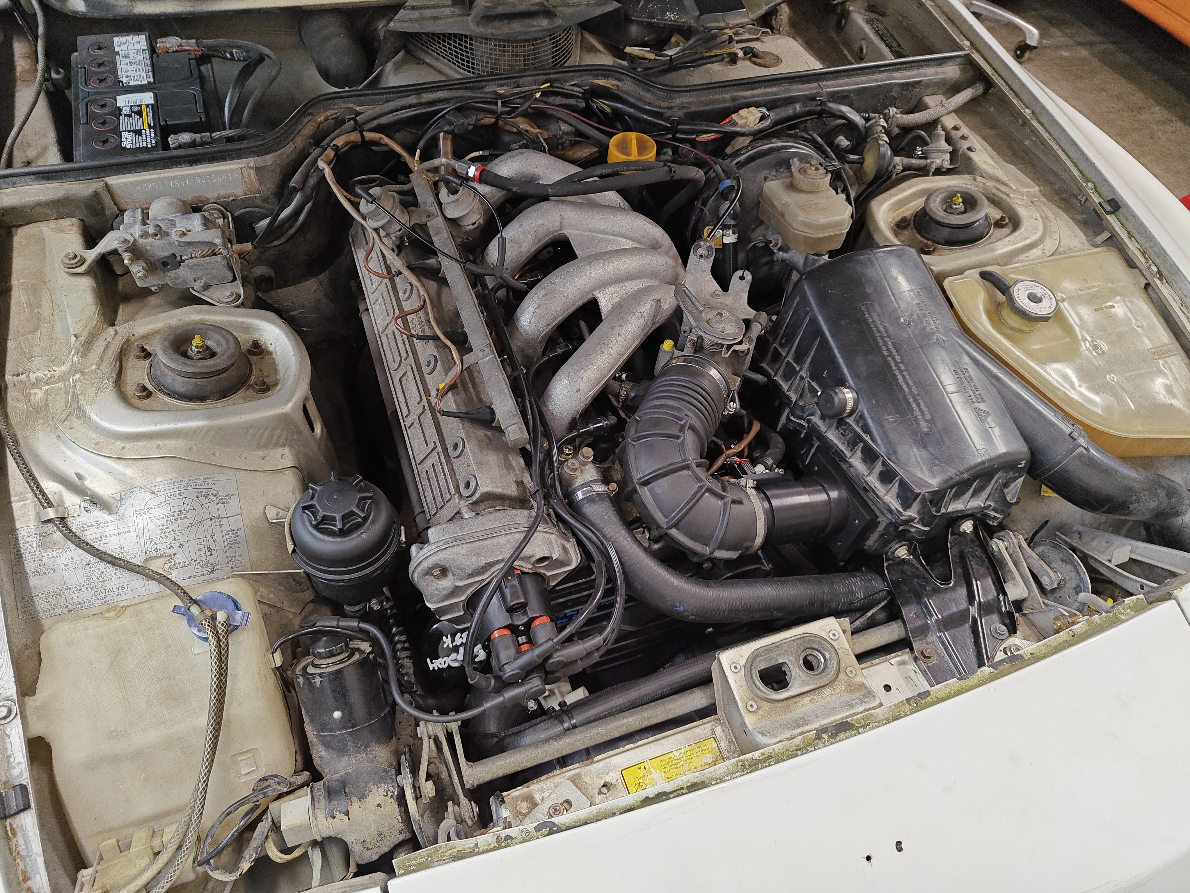

An eBay aluminum radiator was installed with a couple new coolant hoses. I burped the system a couple times but I don't have any fancy vacuum bleeder. The fans kick on and off and all seems perfectly happy but the gauge consistently reads between 1/2 and 3/4 temp. Is that a normal temperature reading on these things?

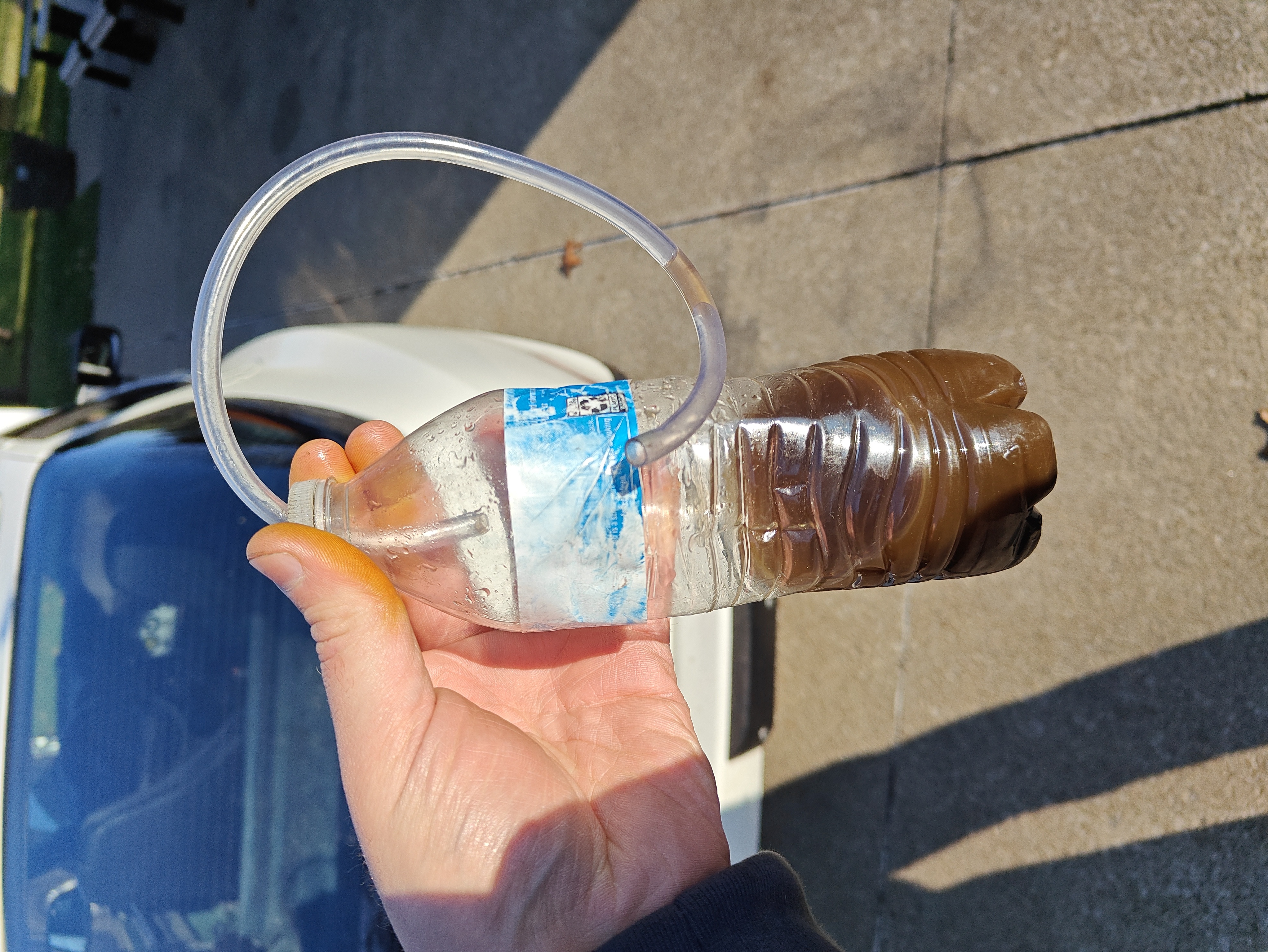

I changed the engine oil, gearbox oil, and topped off the power steering fluid. This revealed a leaky steering rack which I decided to ignore. The brake fluid is very dark so I decided to flush the system. After immediately snapping off a bleeder I decided to worry about that later.

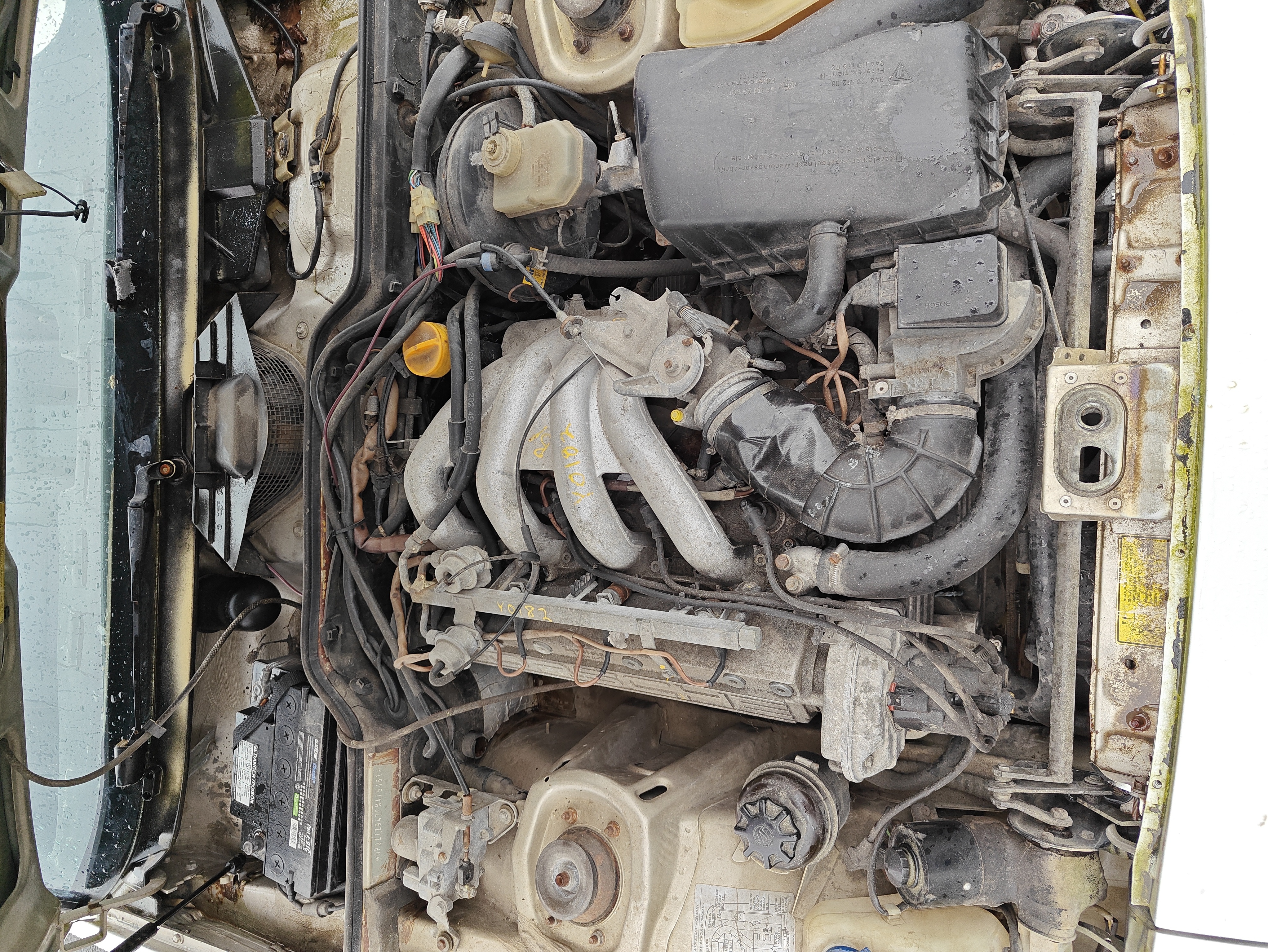

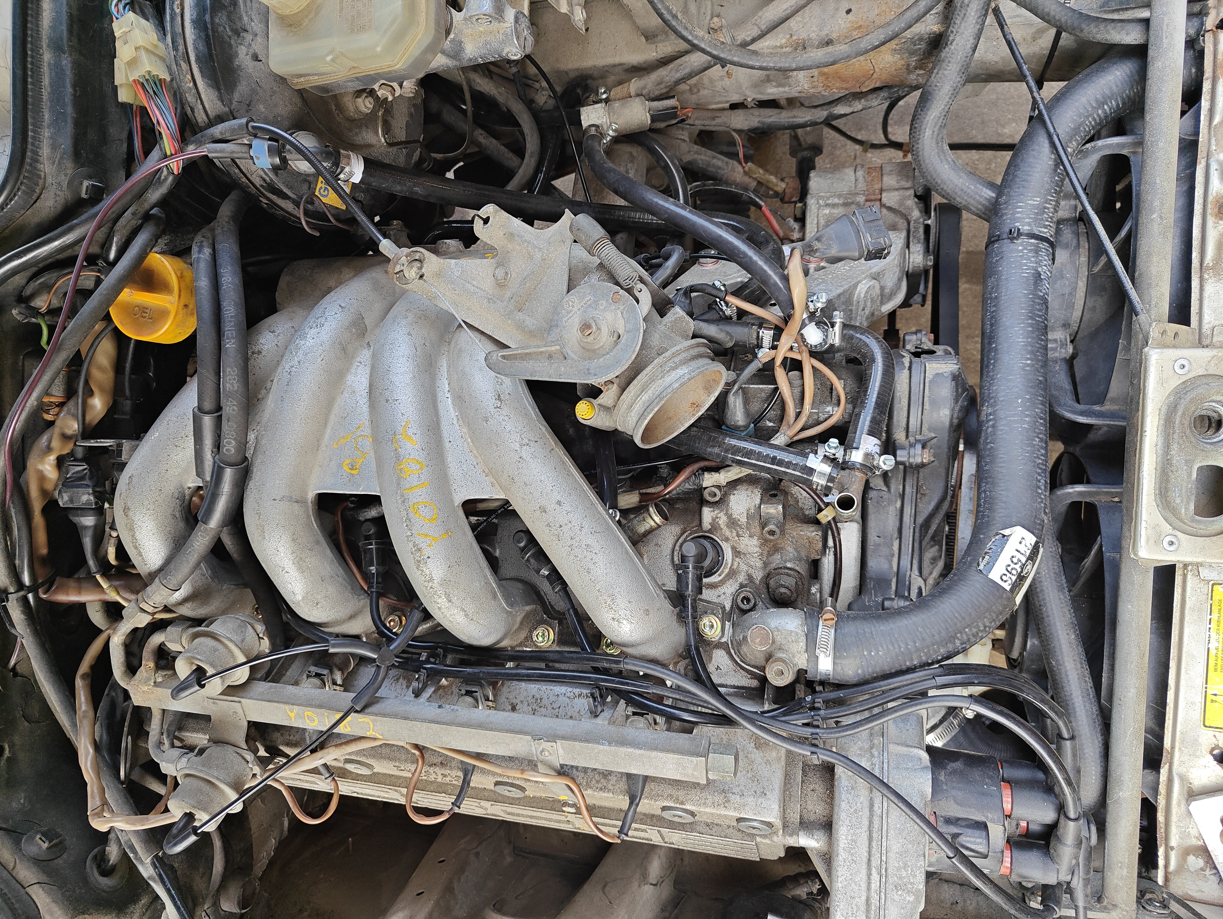

Although the engine certainly ran it was quite unhappy at idle. Taking a closer look revealed every last vacuum line was cracked and split. I decided to bite the bullet and overhaul the whole vacuum system with a nice silicone replacement kit. With all that sorted it purrs beautifully.

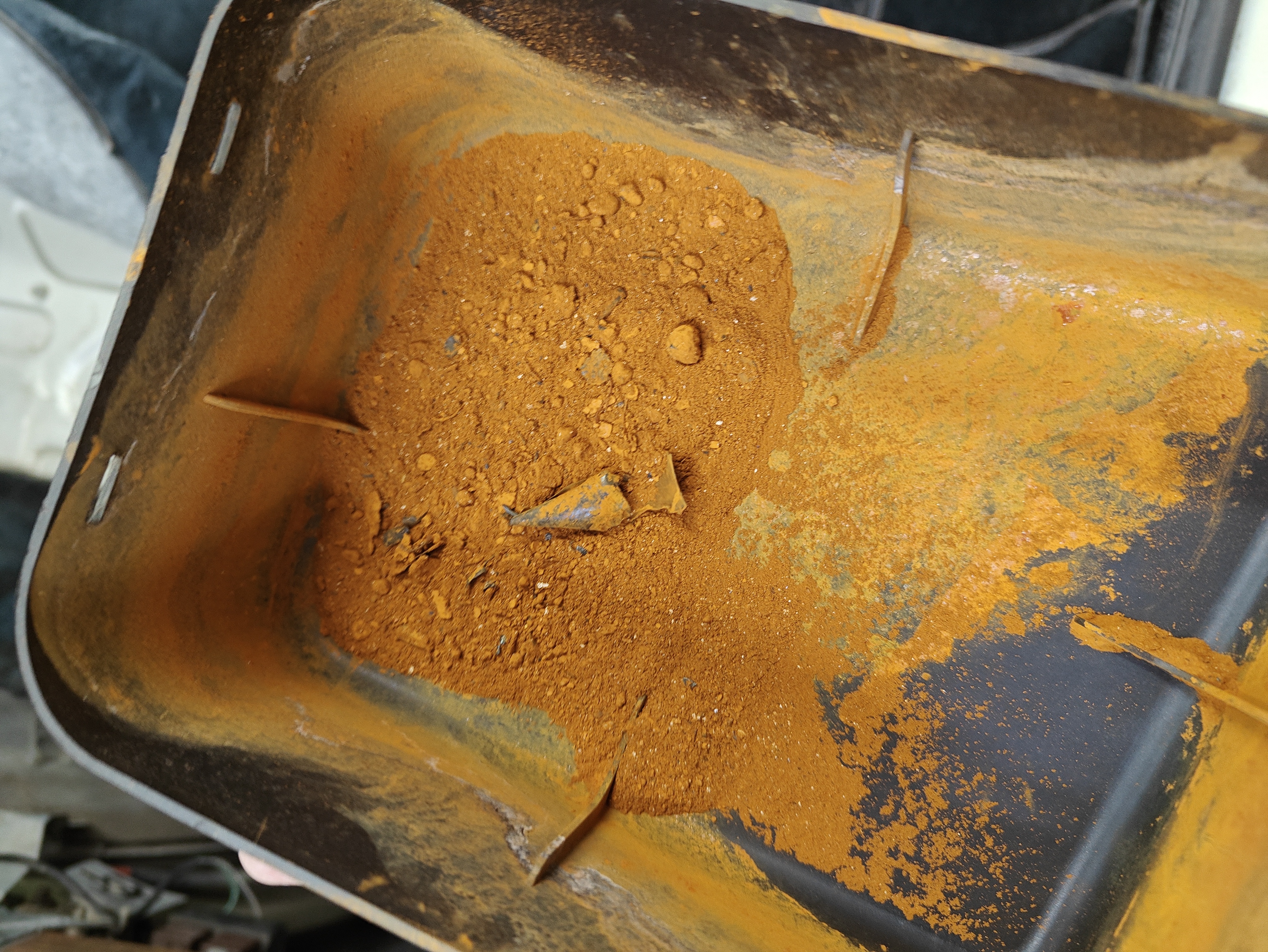

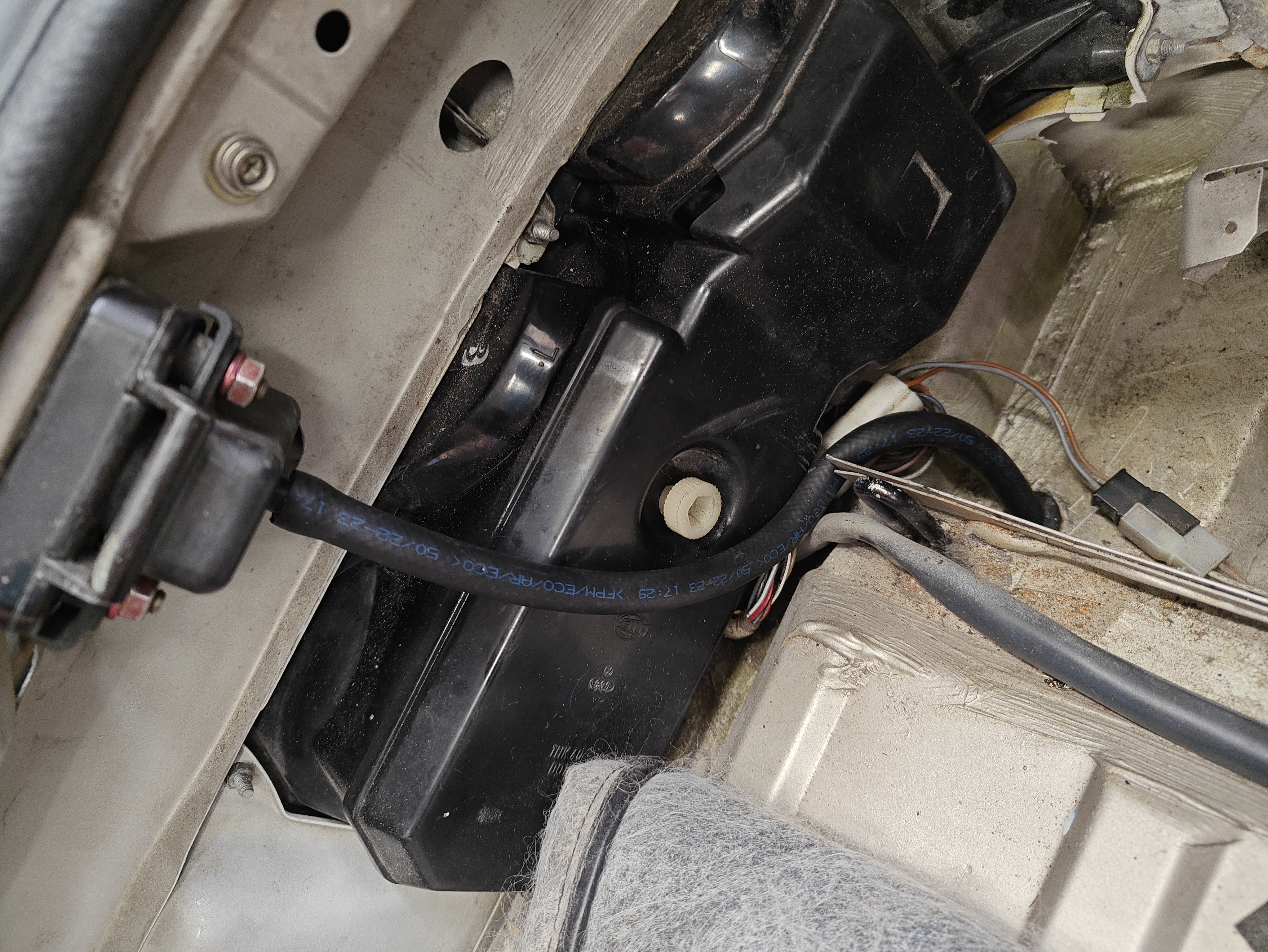

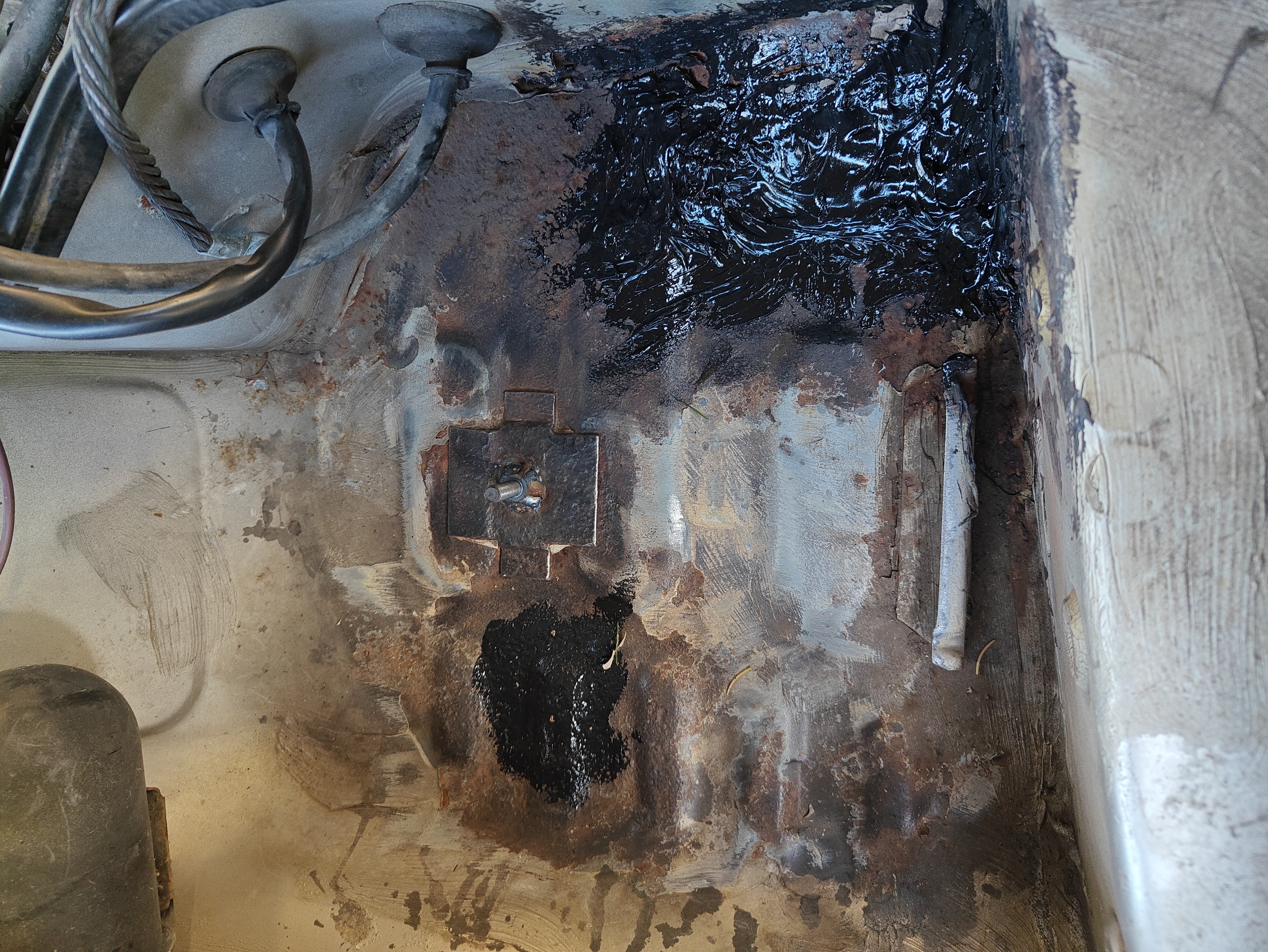

The interior was aromatic and the seats did not move no matter how much you scooted your butt. I traced these issues down to a leaky sunroof seal and a gaping hole in the battery tray. One day I'll come back in and fix it properly (or so I tell myself). Given the amount of moisture I decided to rip out the carpet and see what I was in for. Amazingly there's just a whiff of surface rust. A hammer and some penetrating oil was enough to free up the seat sliders.

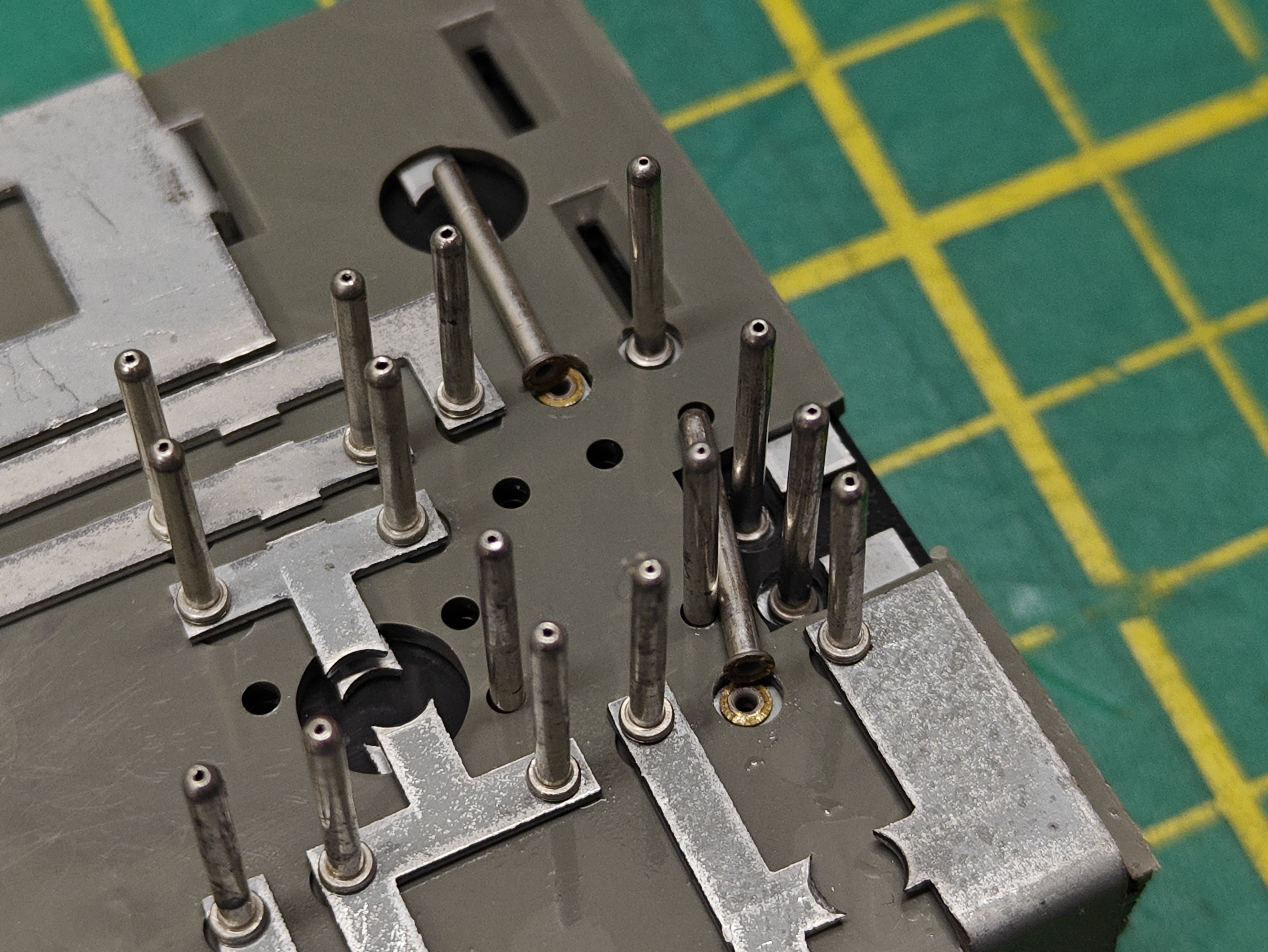

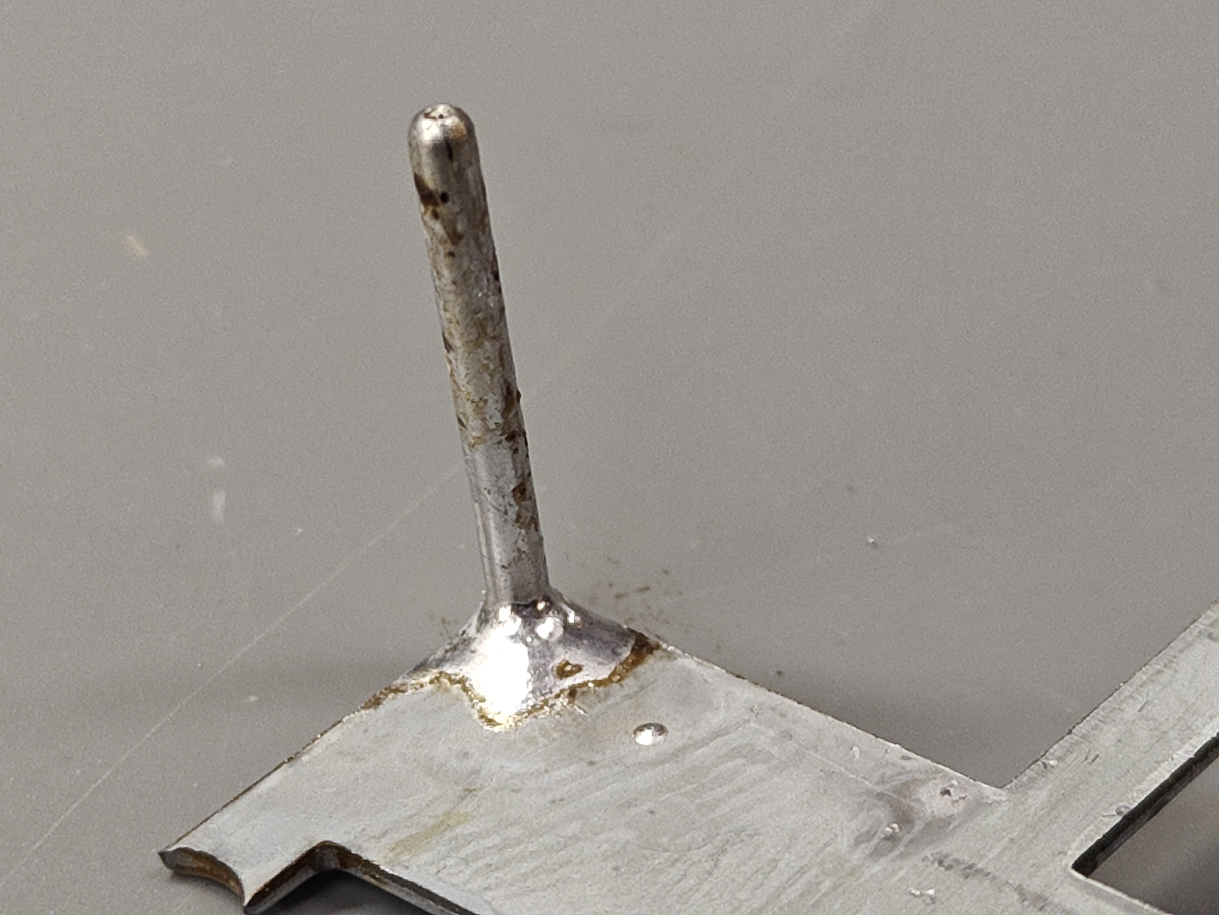

I now set my sights on the infamous German electrical systems. The car had a handful of unrelated issues which I tackled one at a time with the help of the service manual schematics and patience. No running lights on the left side of the car was caused by a blown fuse, the result of a pinched wire. No reverse light was caused by a bad switch on the transmission. The car had no high beams which was caused by a shattered high/low beam switch on the steering column. After replacing this switch the car only had a right high beam. The horn also did not work. Both of these ended up being the result of broken pins within the fuse box. I repaired it by threading through some wire and soldering it up. Various other small issues were the result of crusty switches and connectors. All-in I strategically applied full can of Deoxit contact cleaner and wore out a few toothbrushes but everything came back to life. Even the Blaupunkt radio works.

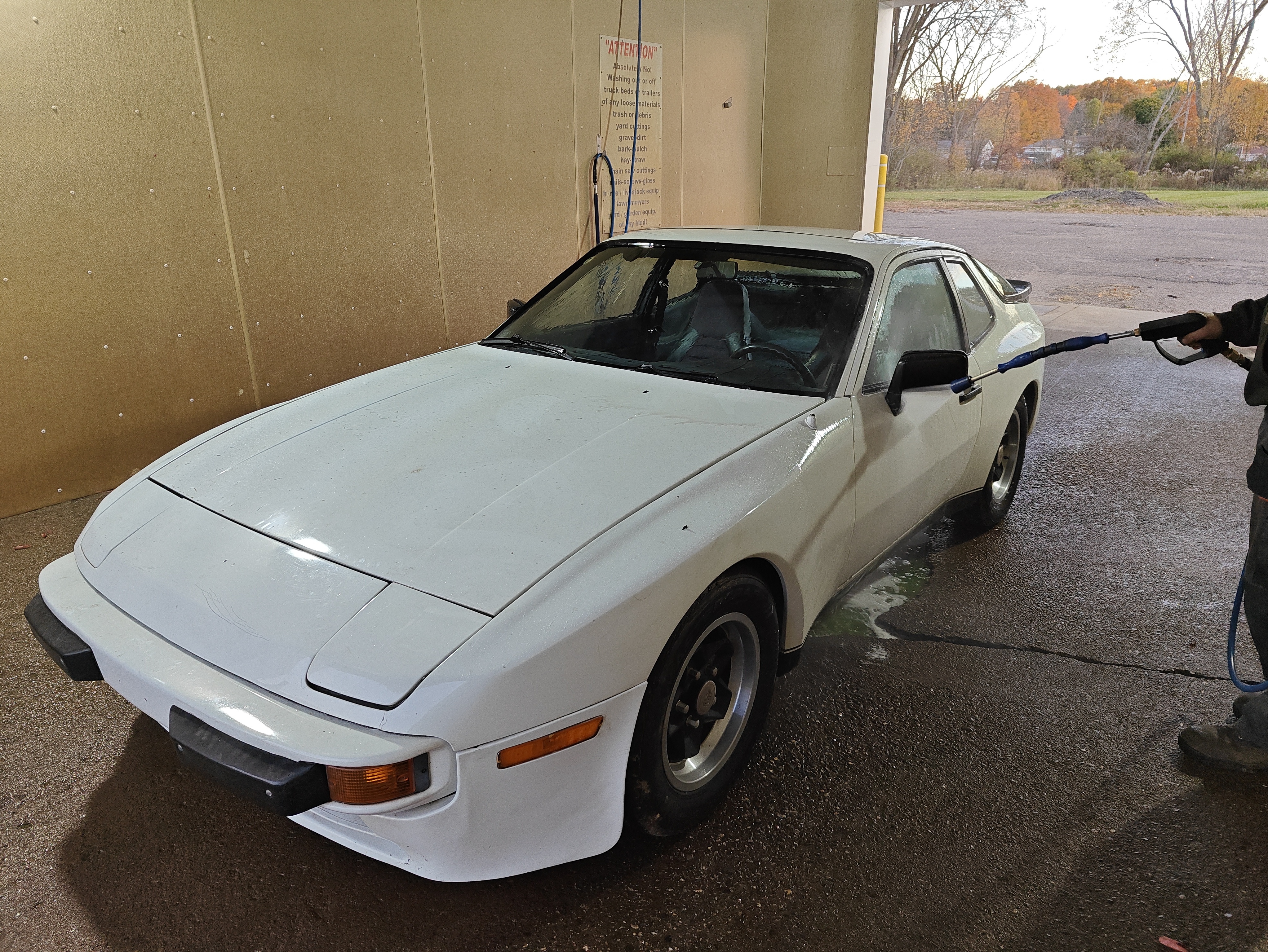

A buddy and I put a few shakedown miles onto it prior to the big day. I treated it to a full tank of premium with a can of Berryman for good measure before swinging through the pay & spray wash. The voyage was a success but revealed a groaning wheel bearing and a sticking caliper. The caliper turned out to be the result of some crusty hardware. A quick treatment with the wire wheel got it all freed up. Amazingly NAPA had the wheel bearings in stock so the left rear got a new inner, outer, and a repacked CV. A few more shakedown miles were put on with several hard stops to clean up the crusty rotors. A few flat out rips made sure the whole speedometer works.

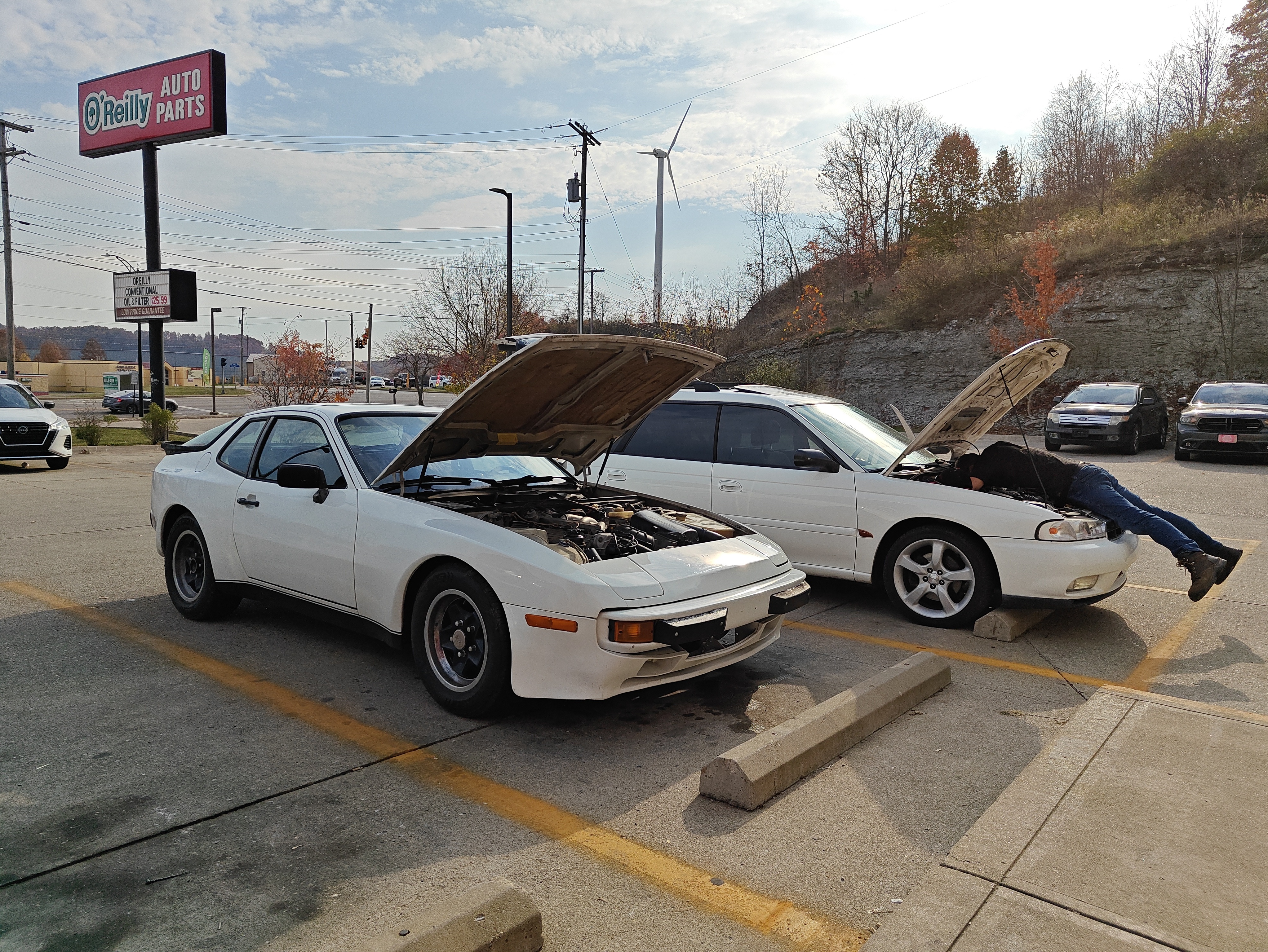

The day finally came to make the 4 hour round trip journey. A good buddy tailed me in his JDM WRX swapped wagon packed with tools and fluids. Despite being off the road for two whole decades it made the trek with absolutely zero hiccups. The Highway Patrol officer snooped and inspected, scrubbing for various serial numbers, working their way through a checklist. After yet more paperwork and a couple raised eyebrows I was given the thumbs up - inspection passed.
The 944 was running so well that on the way back my buddy decided to go and break the Subaru's clutch fork just for fun. Two hours of gear grinding later and both cars were back to home base. She did not skip a beat the whole trip. The ol' girl was officially alive again.

The pictures of the pins in the fusebox is fascinating me, I have never worked with a fusebox of that style. Nice that it can be repaired with common tools.

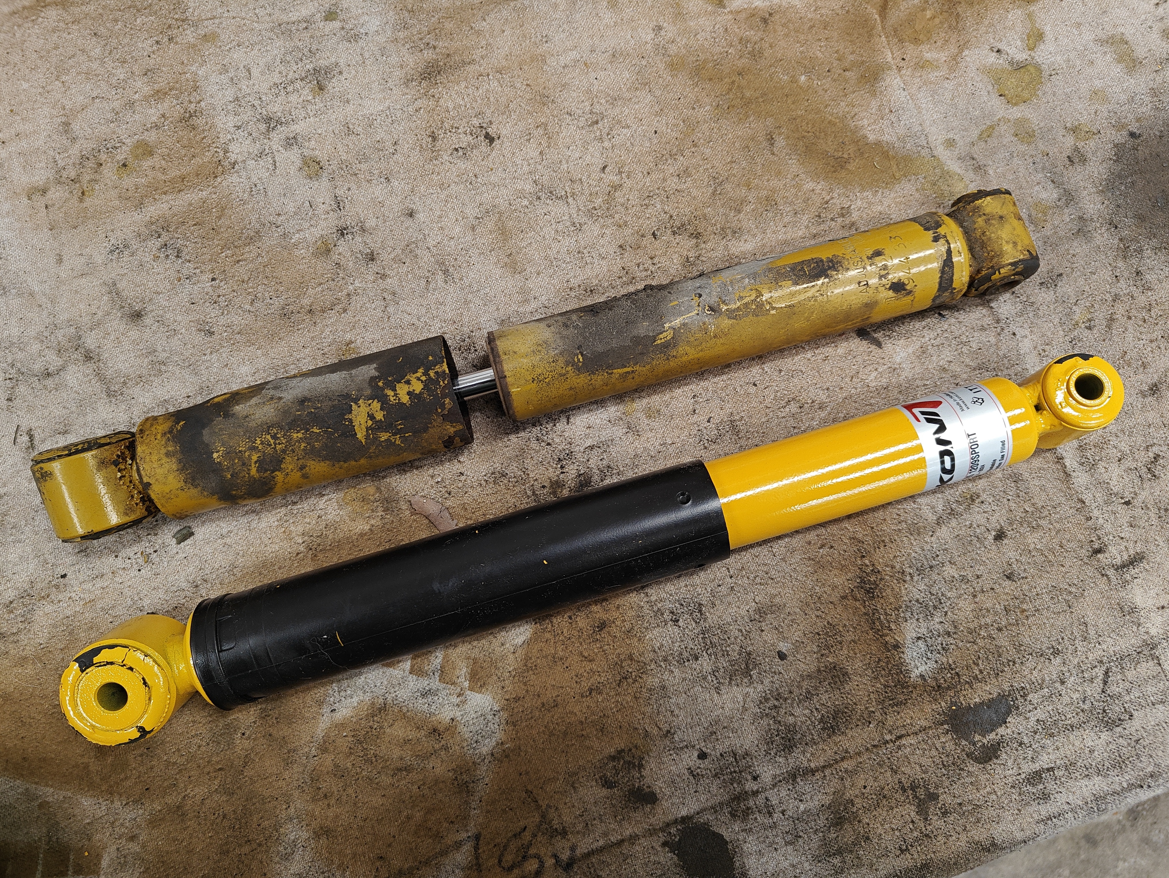

  • New Koni struts and matching rear shocks

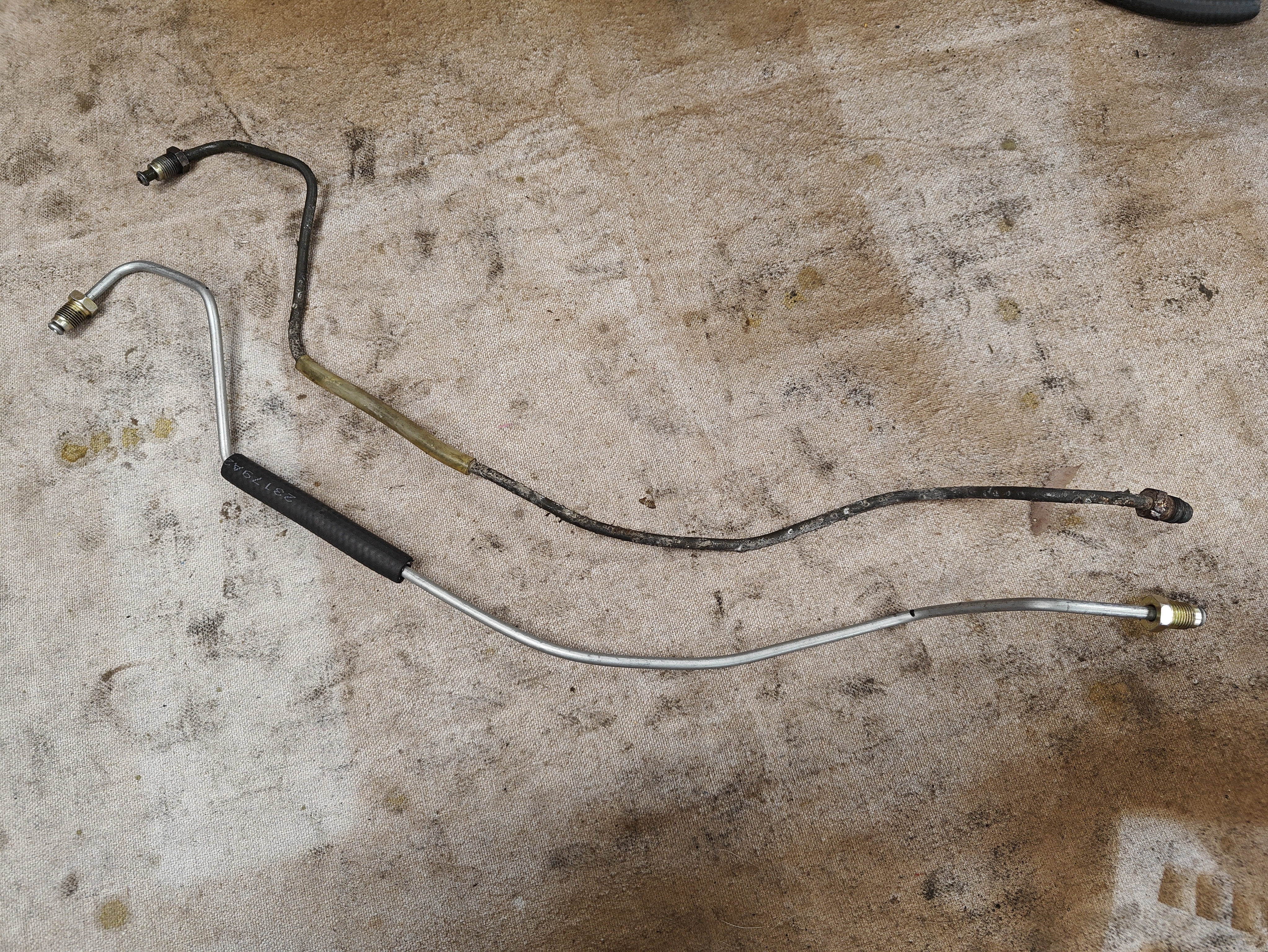

  • Made new trailing arm hard lines - old ones didn't come off without a fight

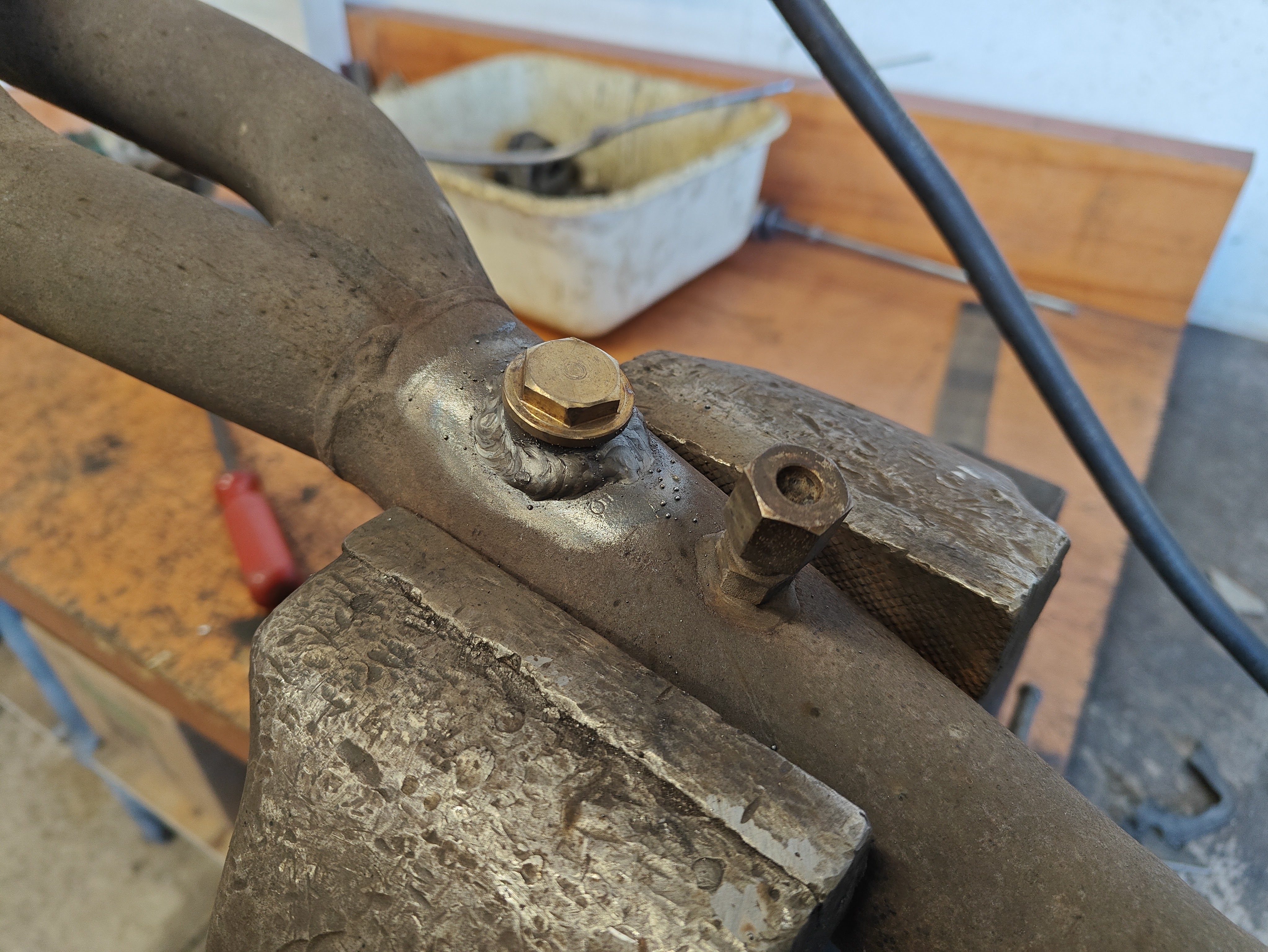

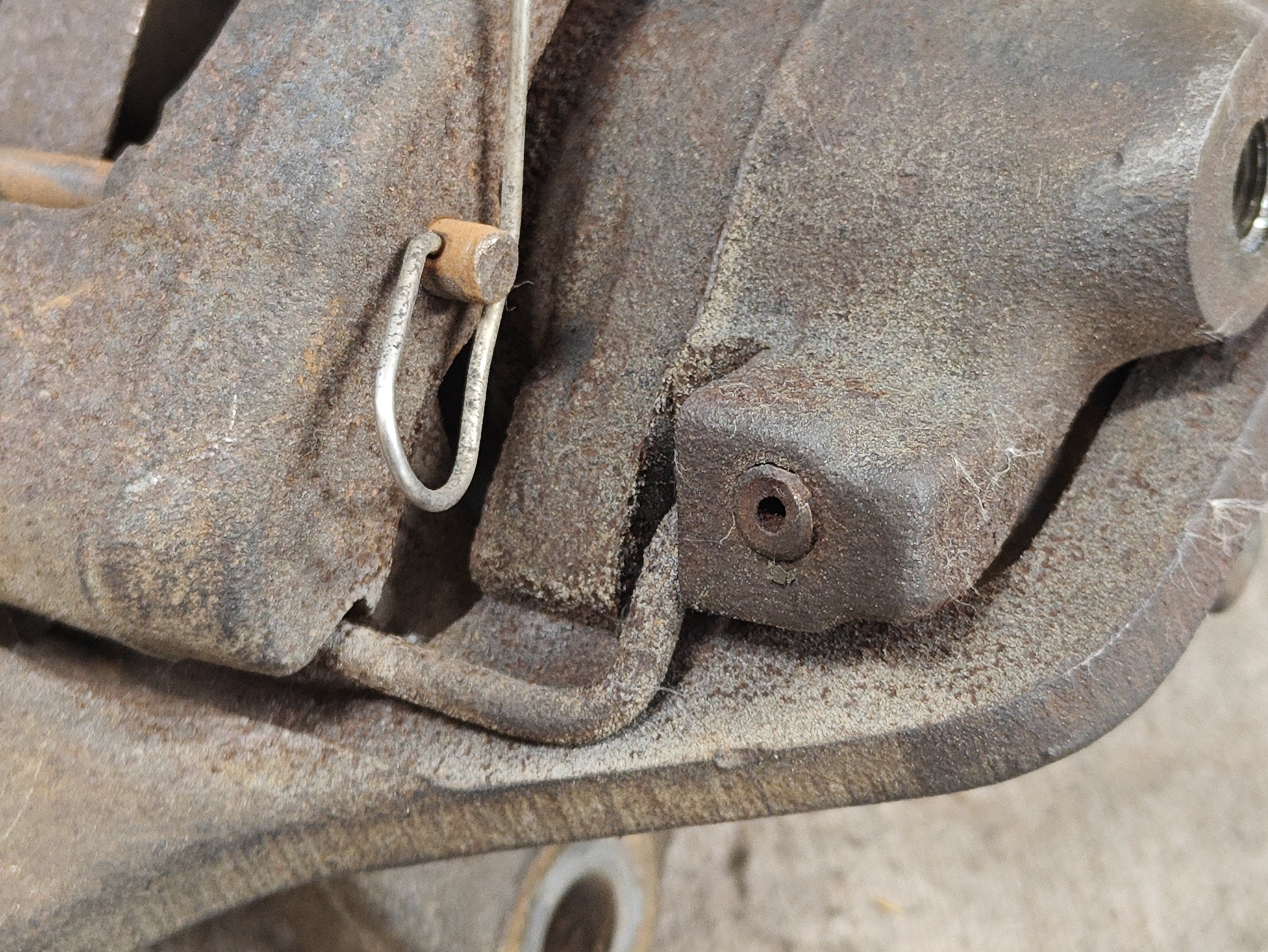

  • Replaced the snapped brake bleeder
  • Flushed the brakes and clutch

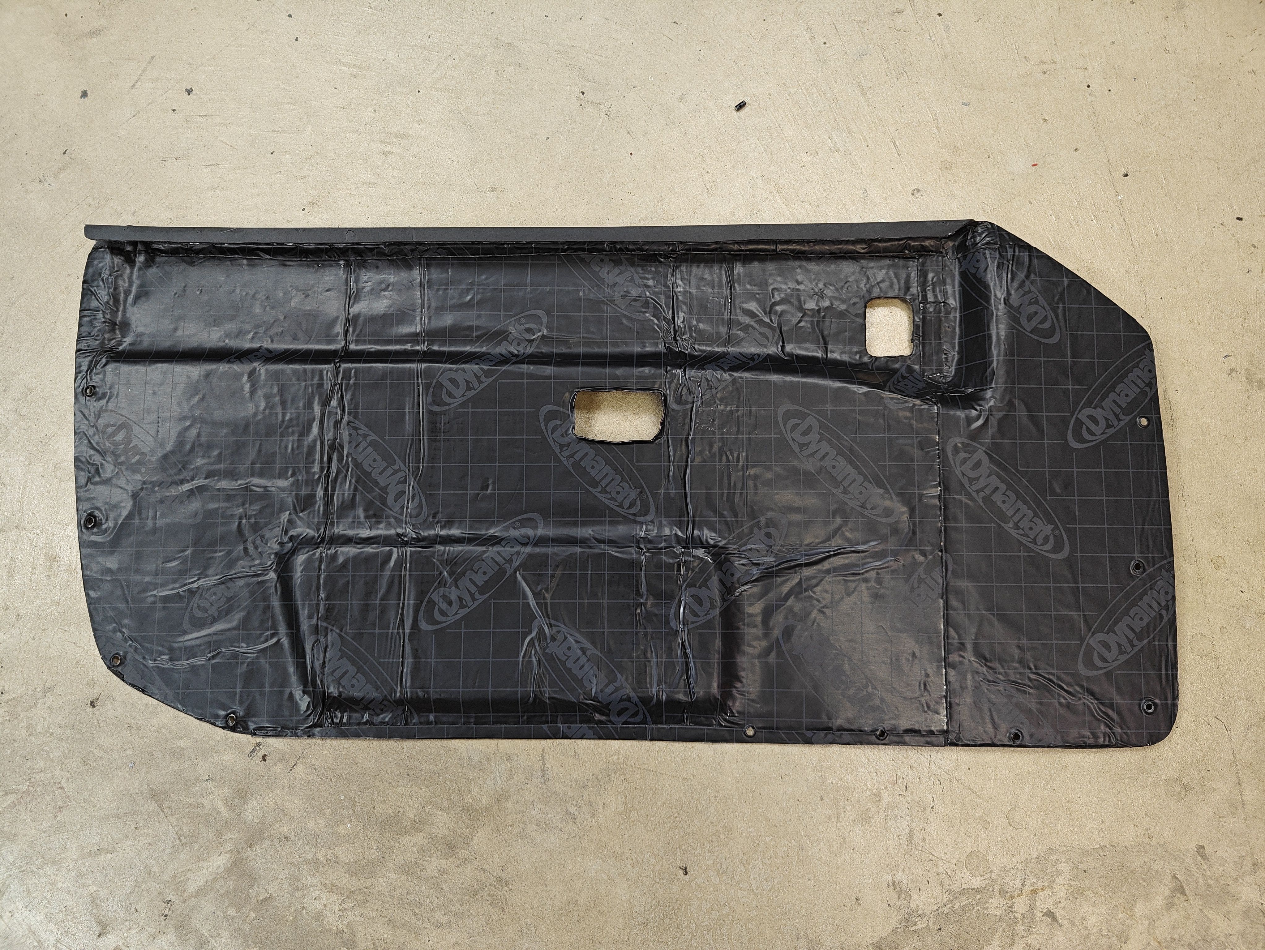

  • Installed some fiberglass door cards

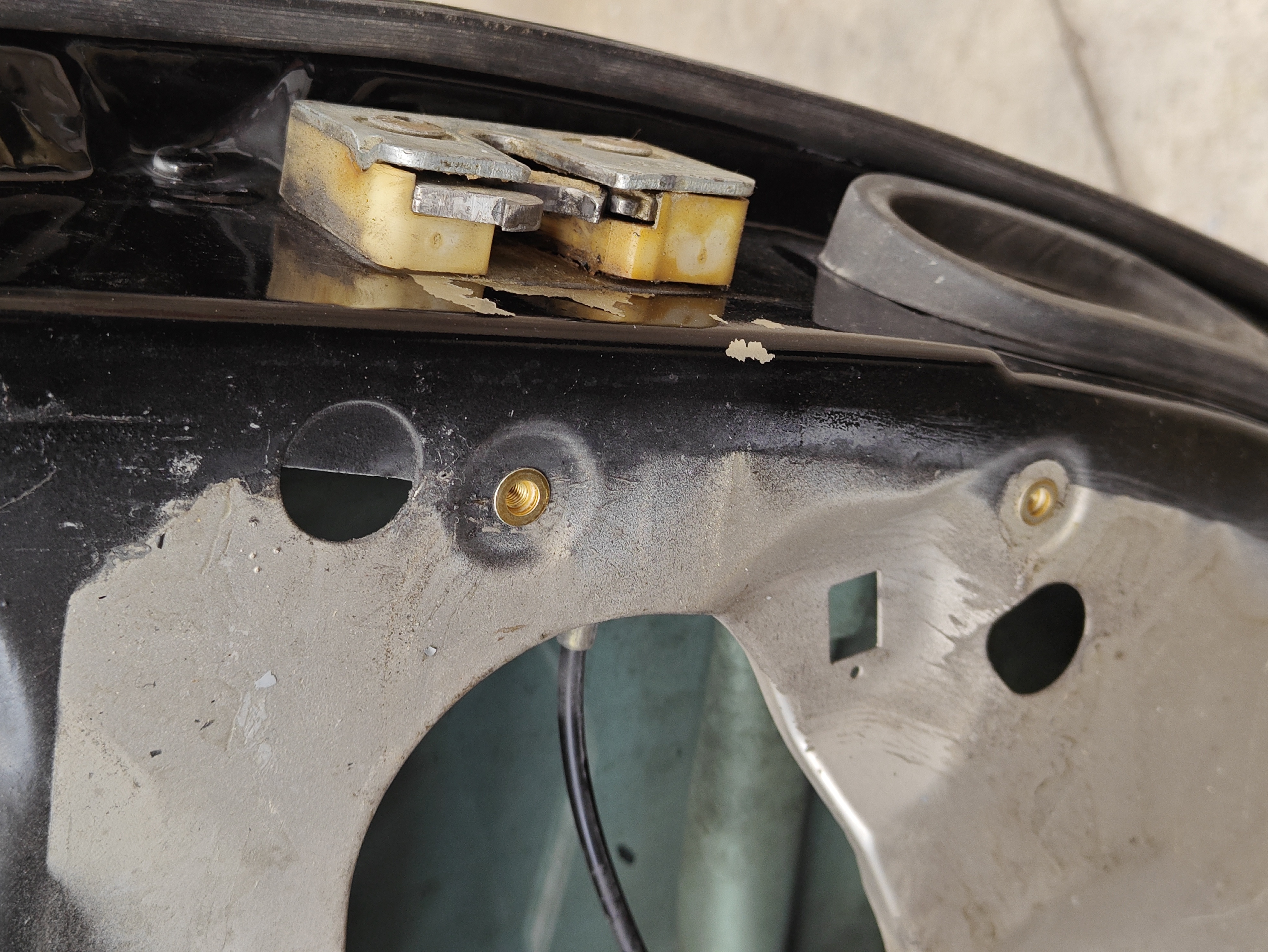

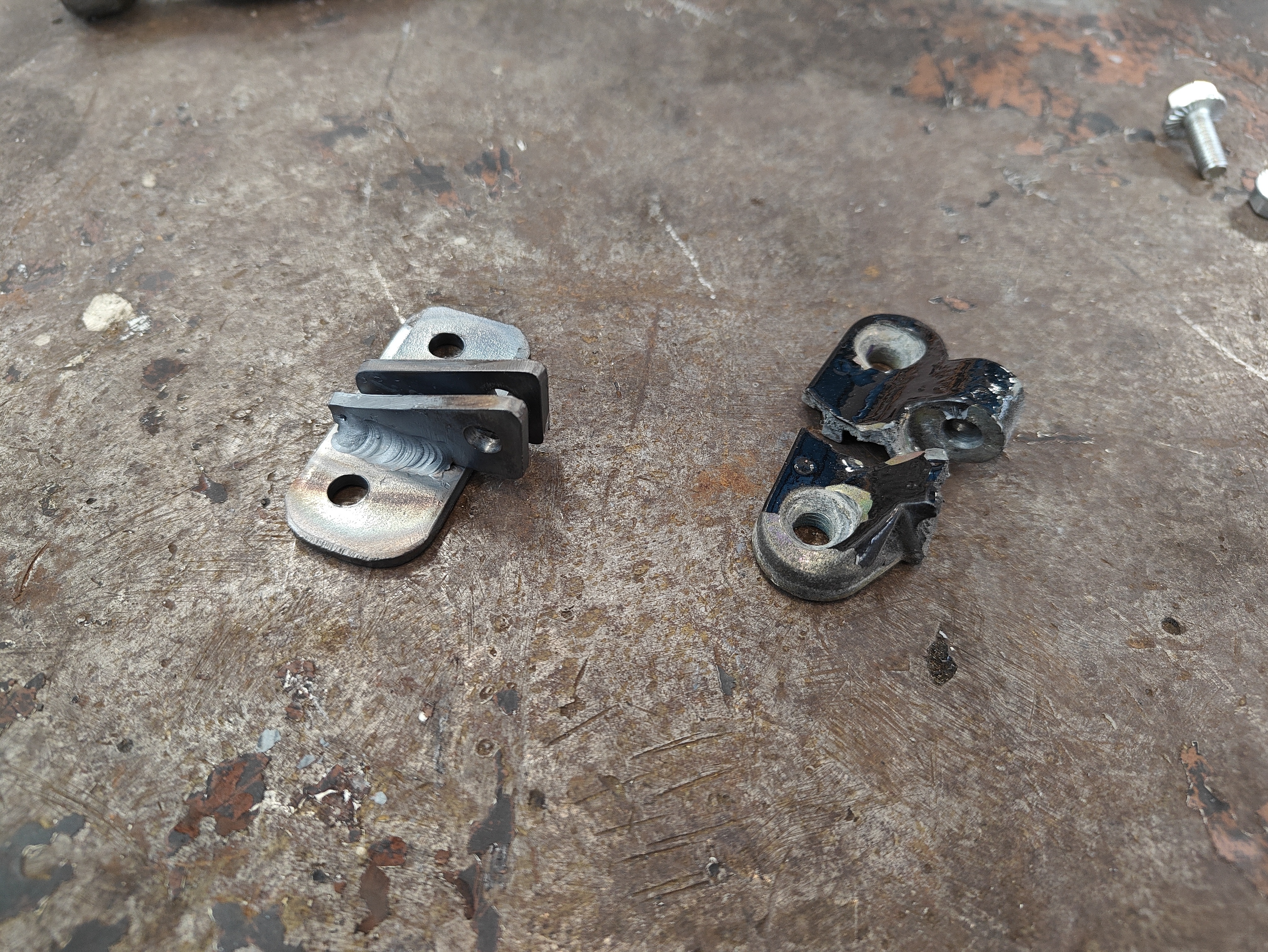

Door stop was shattered.

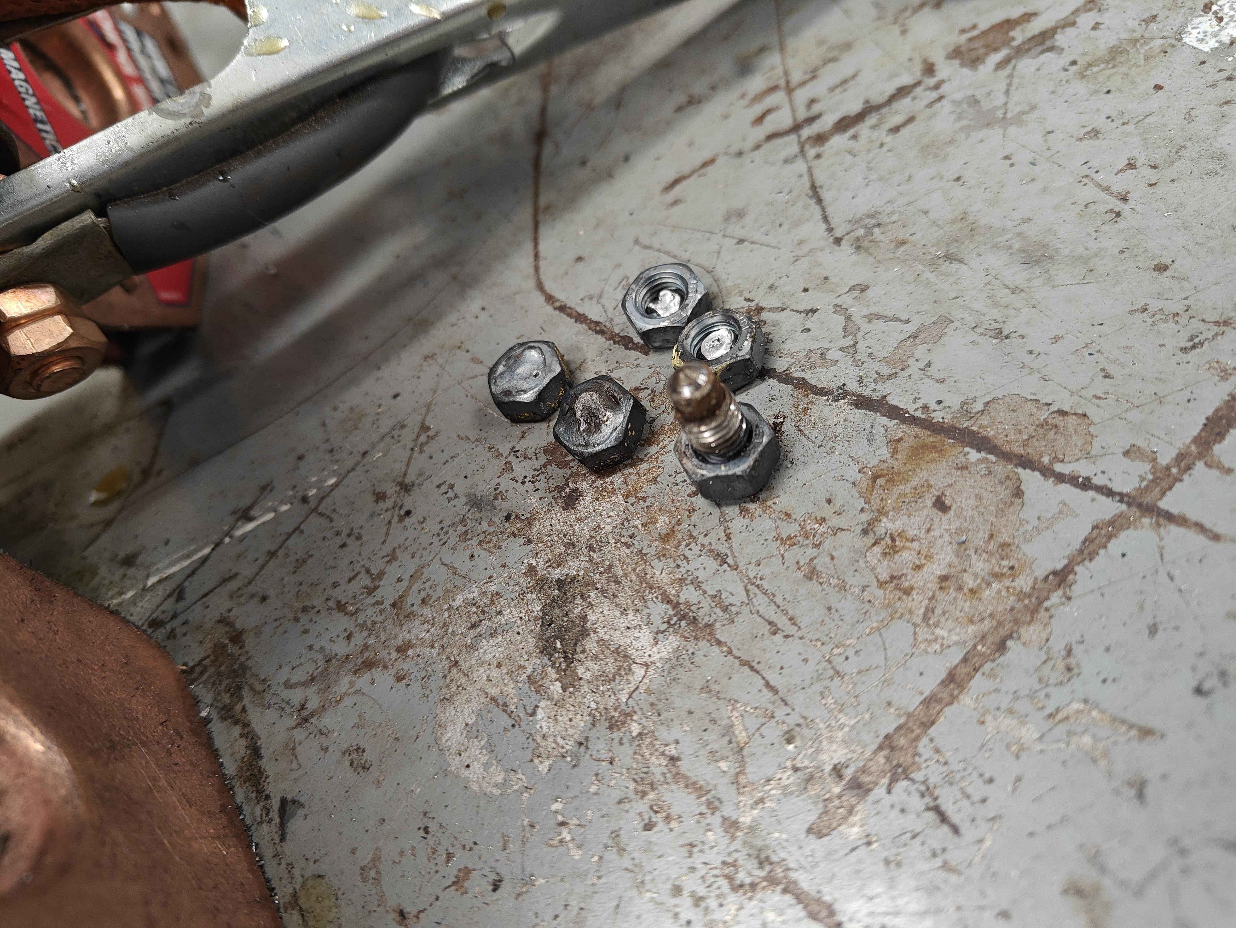

Managed to get the old bleeder out by welding a nut to it. Took a few attempts but it finally came free.

Took quite a bit of flushing for everything to bleed clear. This made a huge improvement to the clutch feel but the brakes are still a little spongy.

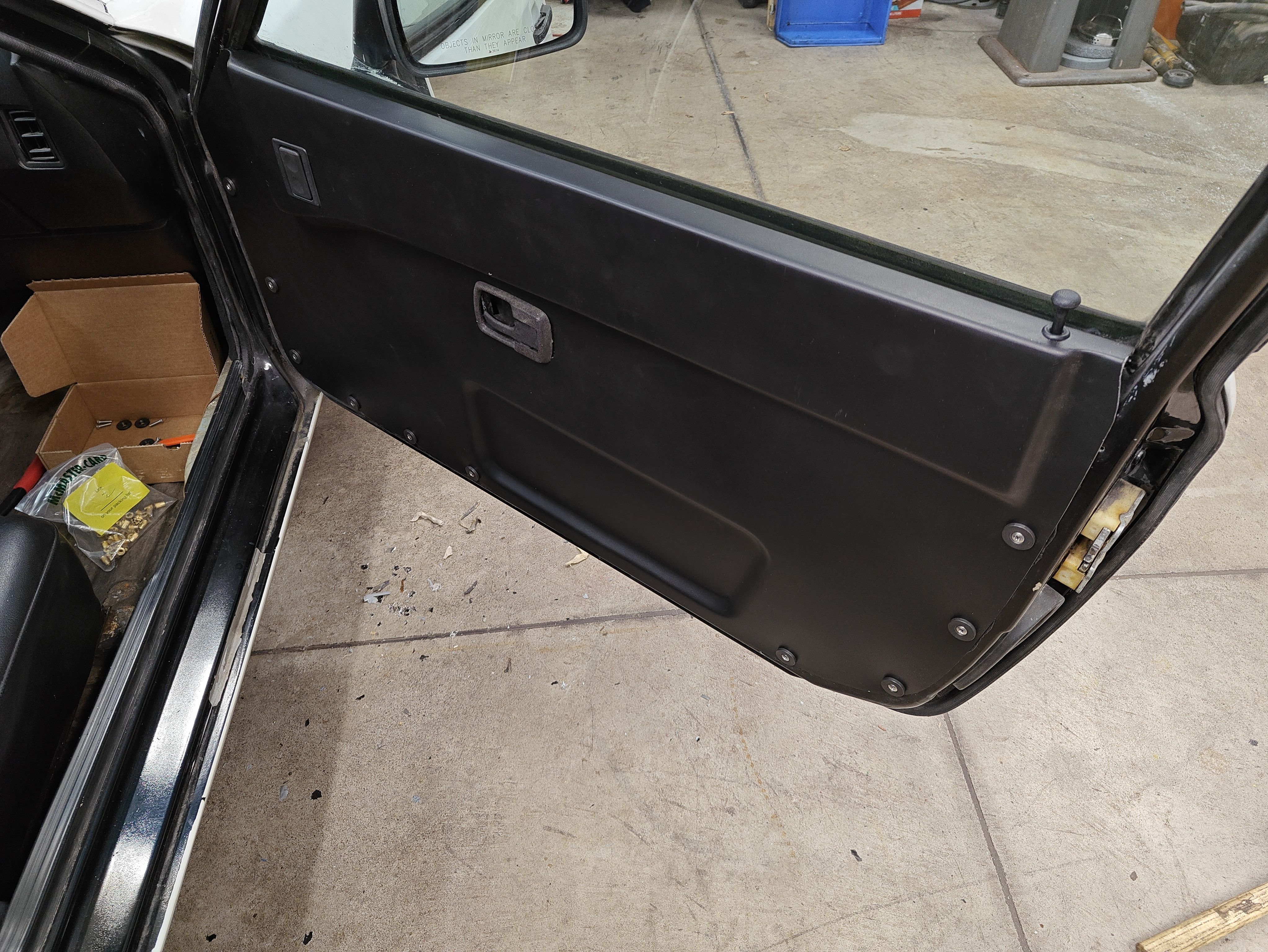

Ended up going with some gel-coated fiberglass door cards. They were a bit DIY and I'm not too experienced trimming and fitting fiberglass but I think they turned out presentable.

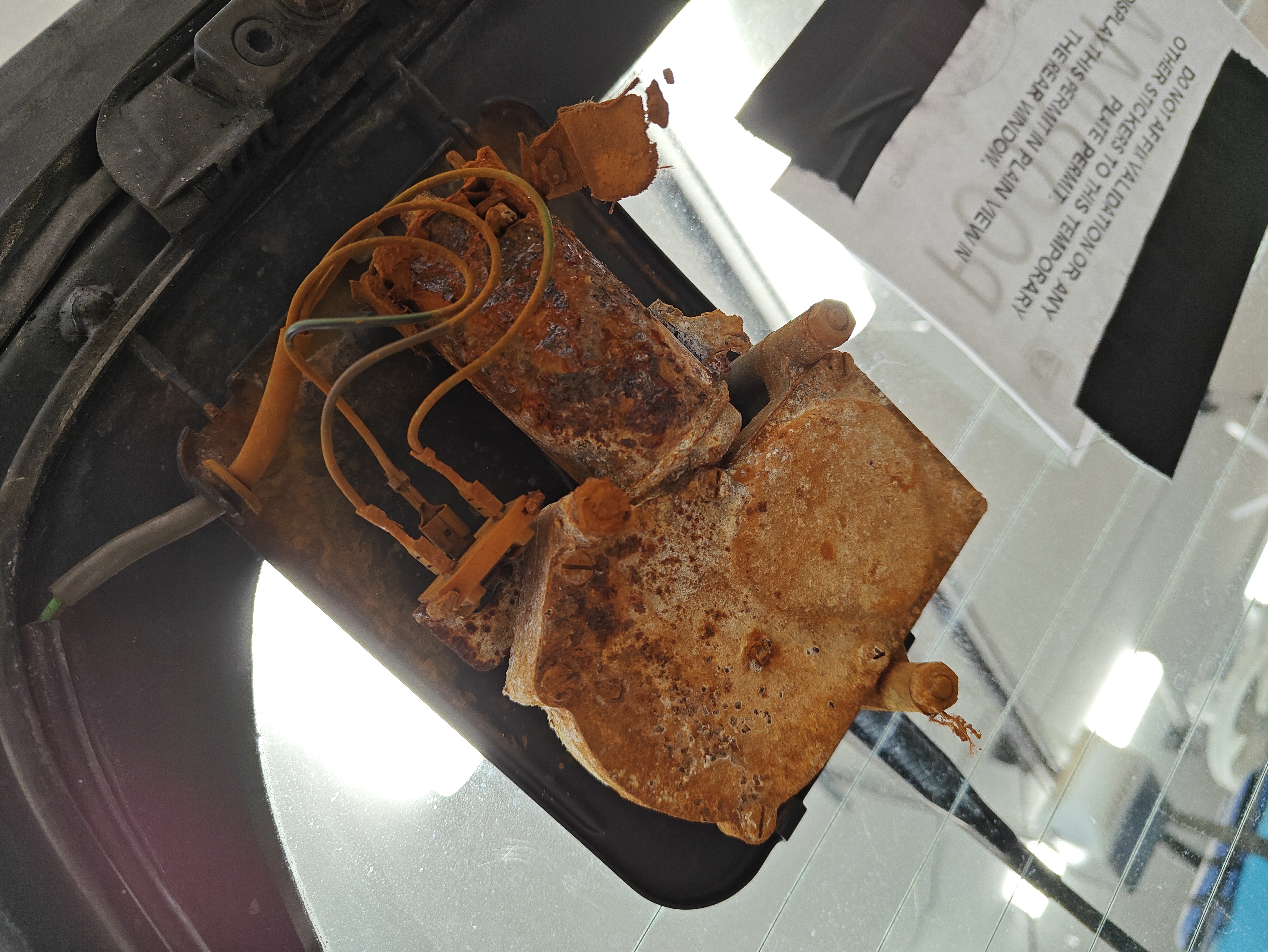

Next I investigated why the rear wiper wasn't working. Upon a brief glance I ordered and installed a tidy wiper delete from 944online.

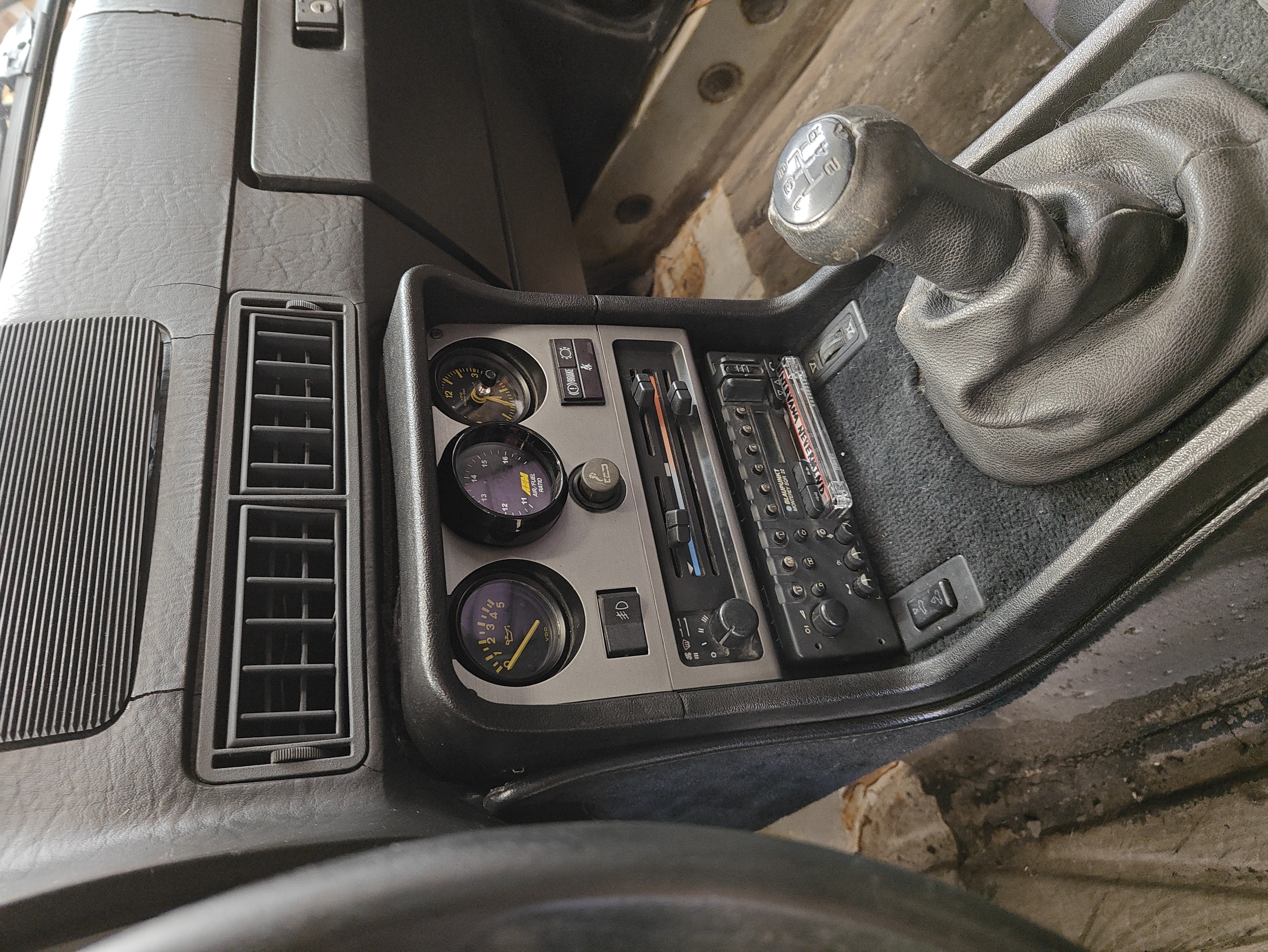

To keep an eye on things I dropped the exhaust and added another bung for a wide-band AFR sensor. Since the AC control was now vestigial I figured it was the logical spot to stuff the gauge. Some day I'll come back and work out how to recess it to better match the other gauges.

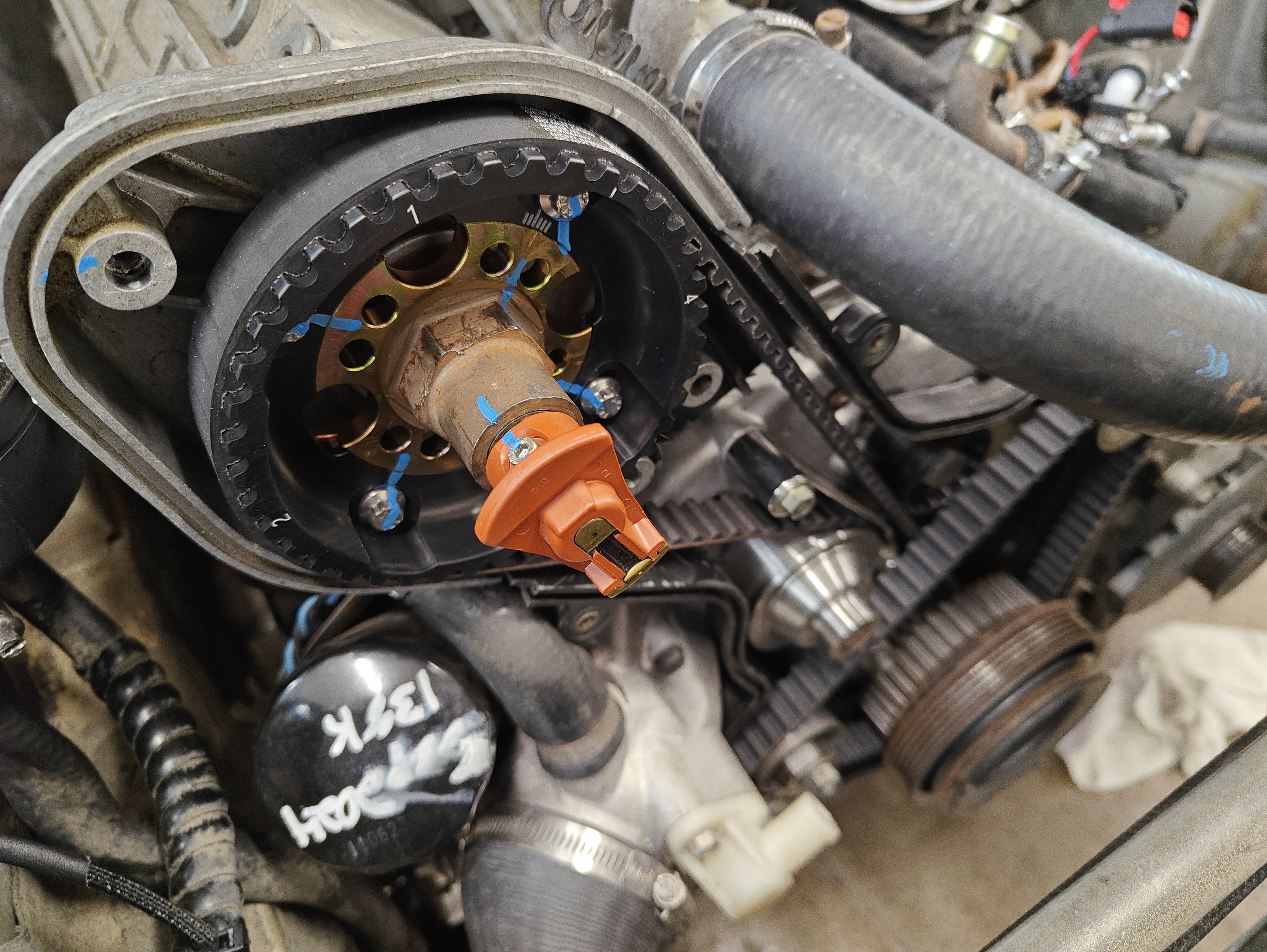

Having previously sorted out the power steering leak I now noticed a variety of oil drips from the front. Following the sludge showed the balance shafts were leaking out the front seals. I got a reseal kit for both balance shafts and the cam housing which meant the timing set had to come off again. Since I was in there anyways the logical thing to do was install an adjustable cam gear.

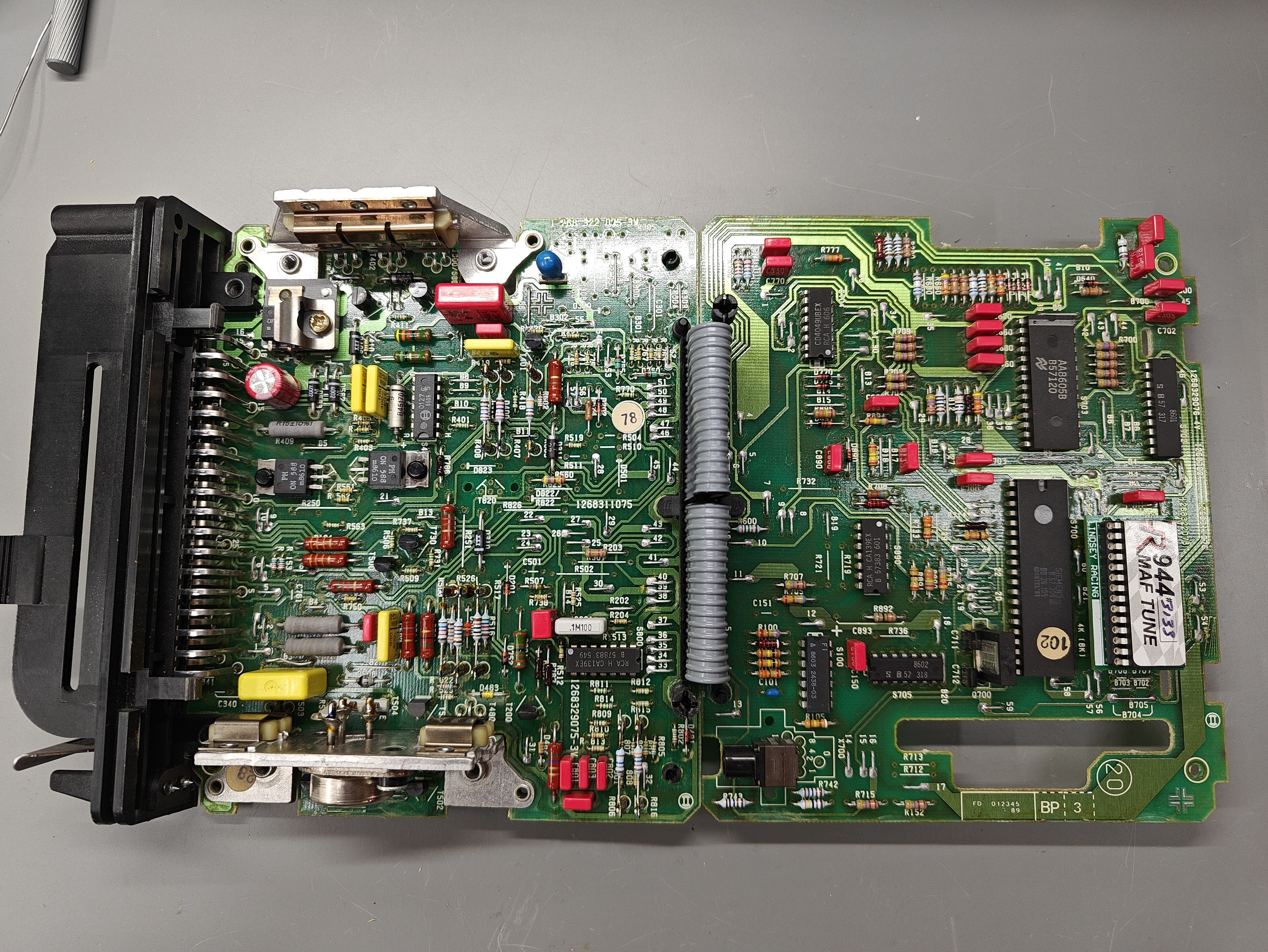

Lastly as a birthday present for the car (MFR date is 12/84) I got a later DME and a MAF kit. The DME had a bad electrolytic cap which I swapped out for a fresh one while doing the 28 pin conversion.
