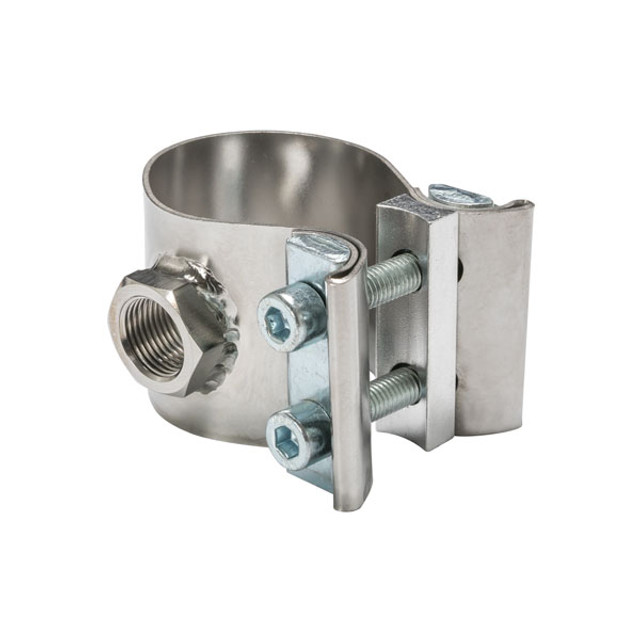

Subsequent to both Tom's and J-Dub's inputs on carburetor adjustment possible 'fixes', if the idea of fabricating a commoniser pipe with a sensor fitment port ('bung') is a bit too much work, there are some innovative 'clamp-on' type-02 sensor bungs that require simply a hole drilled into an existing pipe and fitment of a stainless steel 'clamp-on' bung. Since all such 02 sensor bungs are of an automotive standard size, such a quick-fix approach will accommodate any wide-spectrum 02 exhaust gas sensor you care to use/install. One such accessory may be found here: https://www.glowshiftdirect.com/1-3-4-2 ... g-adapter/ and it is a reasonably priced thingie, too. Then, you may install your 02 sensor of choice, hook it up to a gauge (mounting it remotely, such as on the car's instrument panel, if preferred) and Bob's your Auto Mechanic! (NOTE: for the non-Anglos amongst us, look up 'Bob's your uncle' on WIKI, if unfamiliar with this term).
Six previous 914-4s
One superb 914-6
Six previous 914-4s
One superb 914-6
- Posts: 9208
- Has thanked: 961 times
- Been thanked: 4160 times
I've seen those advertised and assume they work. They may leak a tiny bit, but probably no harm done. Assuming you have no catalytic converters or thermal reactor thingies, and no exhaust leaks, you can also just put the sensor up the tailpipe -- like they do on smog tests -- for a 'good enough' reading. A coat hanger could probably do the trick, but they also make fancy tailpipe fixtures like the one below. No need to make any changes to the exhaust that way.
- 914PUTSCH
- Posts: 105
- Joined: Thu Oct 31, 2024 1:54 pm
- Location: Sacramento, CA (USA)
- Has thanked: 42 times
- Been thanked: 95 times
Good to know about, Tom. Beats drilling a hope in some exhaust pipe and clamping a bung on. Thanks. Just hope my Jezibel doesn't resent having something gracelessly shoved up her...er, ahem..posterior extremity! Gives a whole new meaning to the expression 'bung hole.' Jez is already somewhat resentful of my occasional reference to her having an air-sucker tucked away, up that extremity, LoL, but I am guessing I'm not the only 914 owner who has a sensitive car!Tom wrote: Thu Nov 07, 2024 9:42 am I've seen those advertised and assume they work. They may leak a tiny bit, but probably no harm done. Assuming you have no catalytic converters or thermal reactor thingies, and no exhaust leaks, you can also just put the sensor up the tailpipe -- like they do on smog tests -- for a 'good enough' reading. A coat hanger could probably do the trick, but they also make fancy tailpipe fixtures like the one below. No need to make any changes to the exhaust that way.
