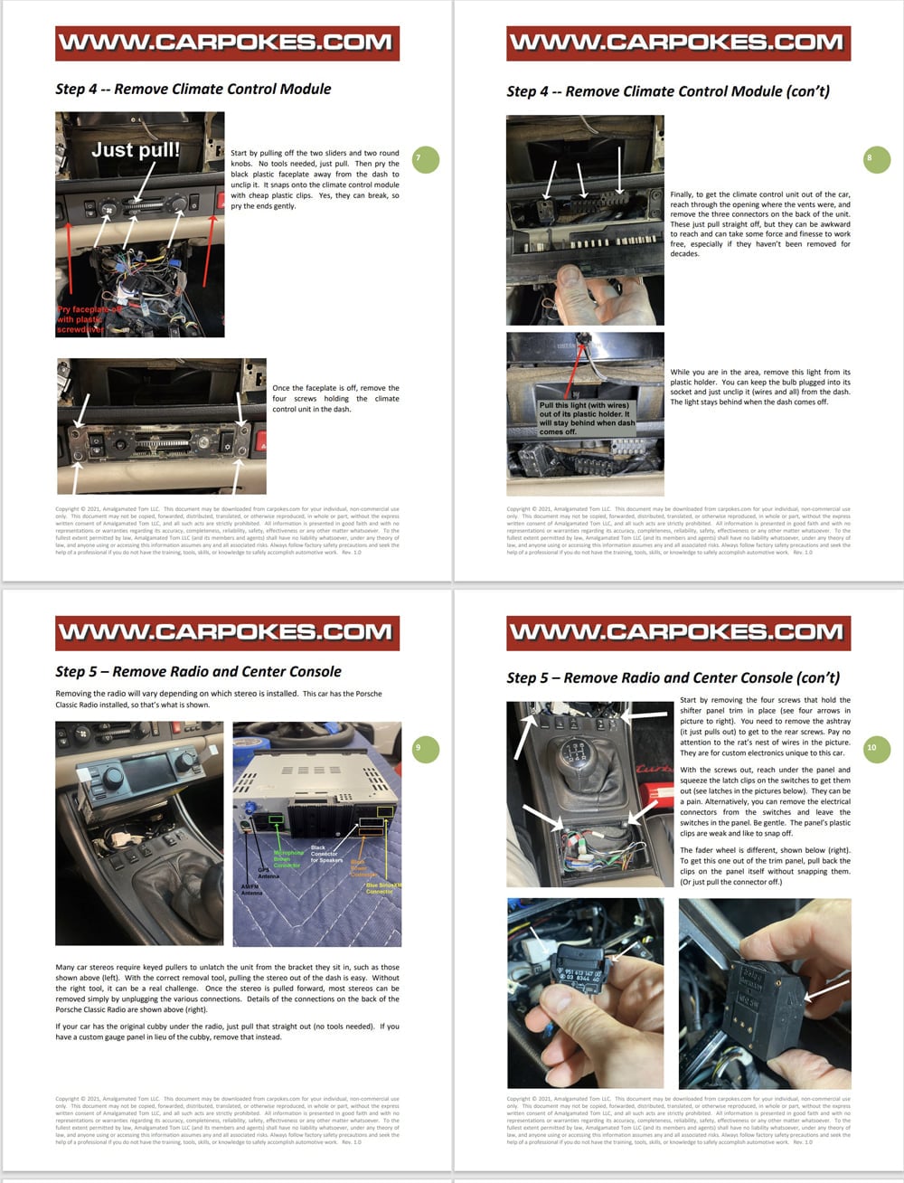

I know there are other guides out there, but some are very old with grainy photos, and each new guide tends to offer its own details that may not be covered as well in others. The PDF is attached for download at the bottom of the post. Picture is just to lure you in. :) If you see anything I should change, just let me know. :)
Edit: This PDF was updated on Feb. 1, 2022, to include an additional step (turn-signal removal) and to clean up some wording. The most current version says "Version 2" on the title page (as posted below).

I used the instructions. I am a newbie to 944 and I did not see how to remove the indicator stalk assembly.
I took some pictures to maybe update the manual u created.
