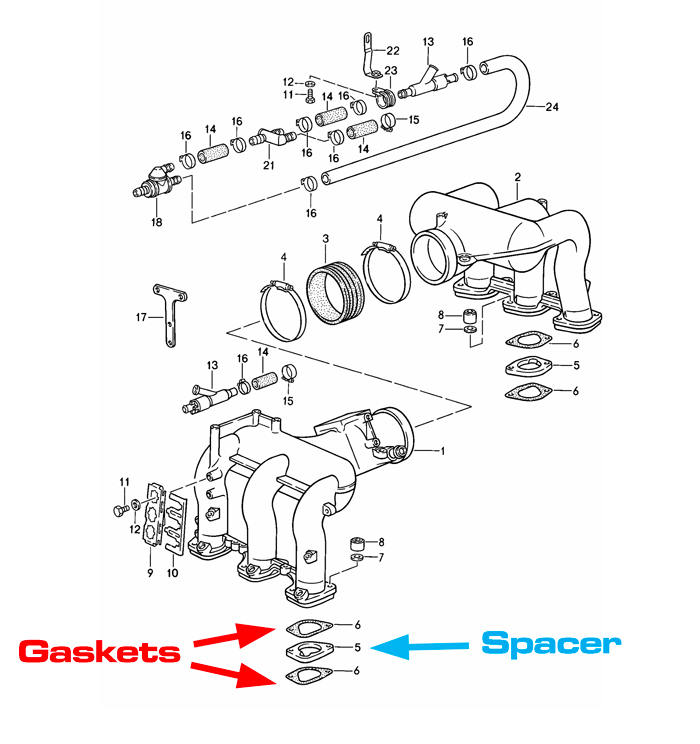

1. Why 'spacers' ? help me on the spacers?- gaskets I get - don't want intake manifold leaks.
2. So for anyone who has done this; how are these two different parts ie spacers and gaskets -used
together on reassembly?

1. The spacers are said to isolate the intake from engine heat and increase the runner length a smidge. Hot rodders often add them to other motors for the same reason.
2. There's a gasket on both sides of the spacer to make a little spacer sandwich. See diagram below.
3. I couldn't find a picture like that, but the spacers are thick, maybe 5-10mm, whereas the gaskets are just a thin piece of gasket material. See the Pelican Parts links below with pictures of both.
4. I had the same experience with Griffiths recently with their 944 condenser. Makes me wonder if he is scaling down his business/inventory.
5. Looks like the gaskets are part number 930-110-197-14 (12 needed), and the spacers are part number 930 110 459 00 (6 needed). See links below.
