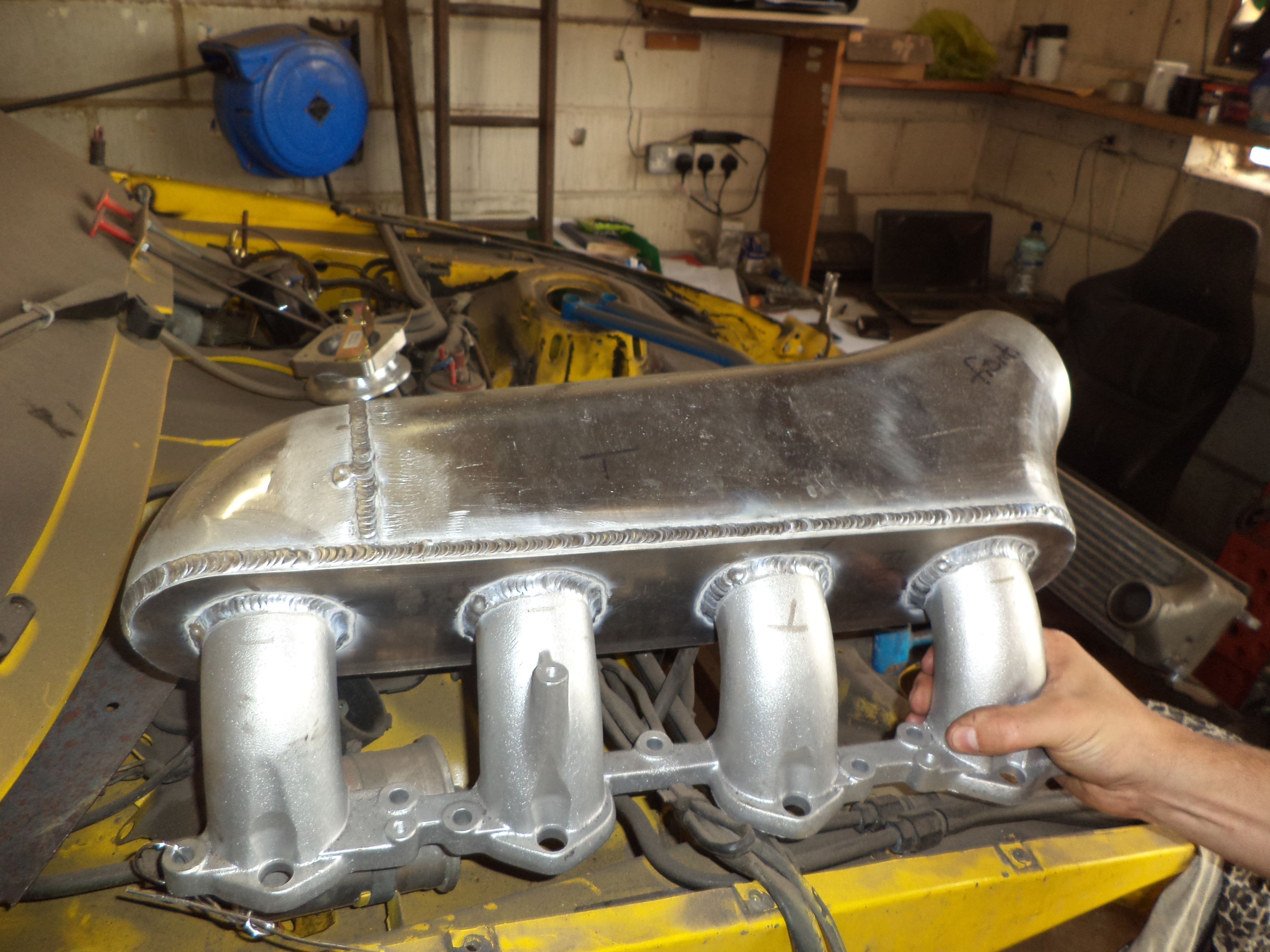

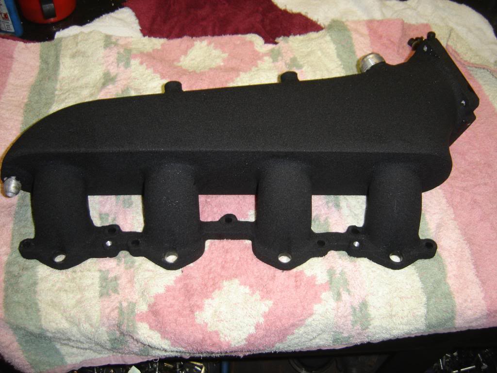

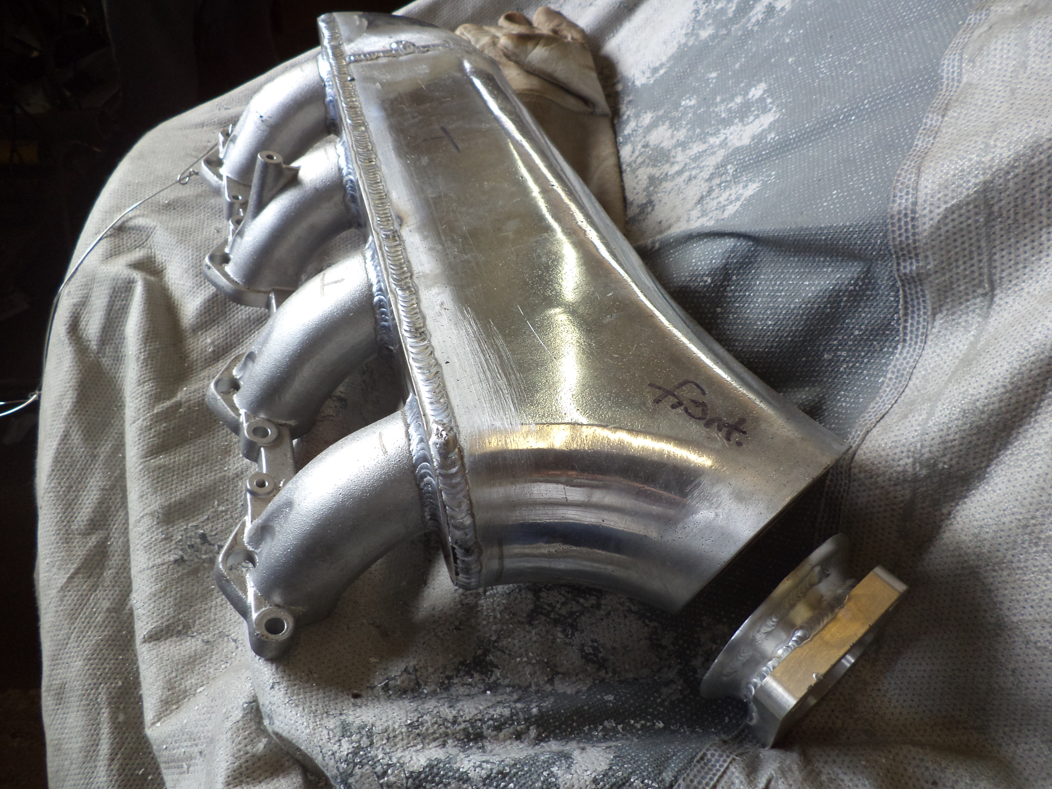

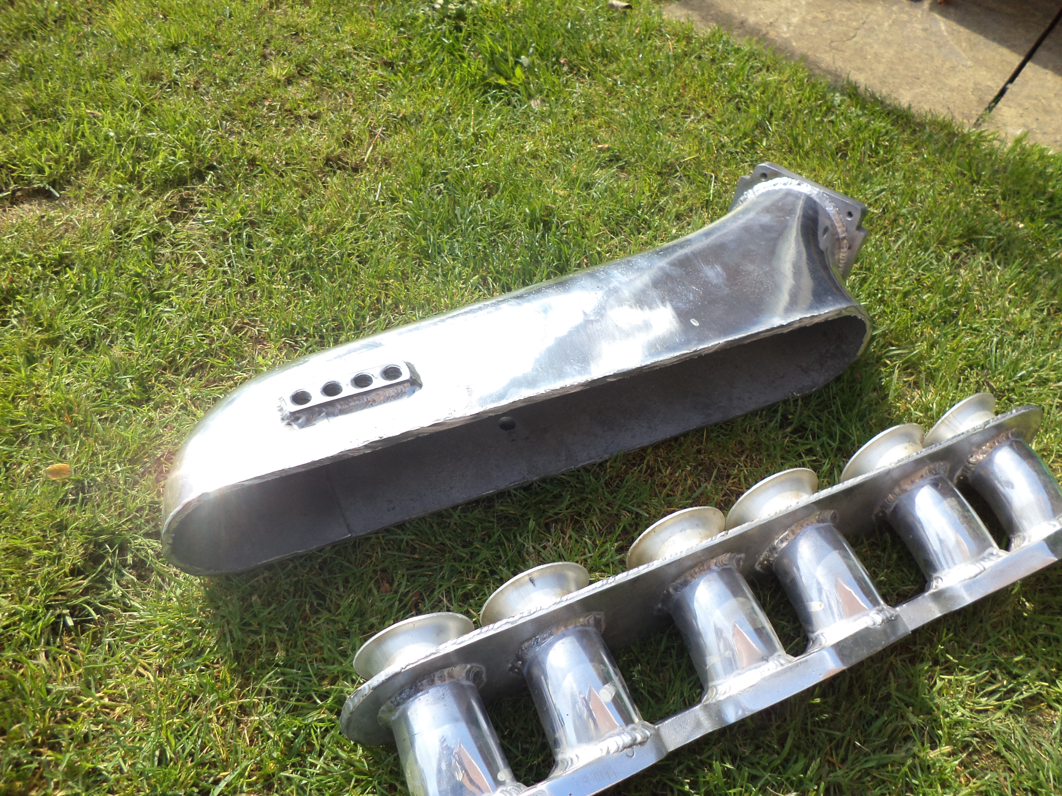

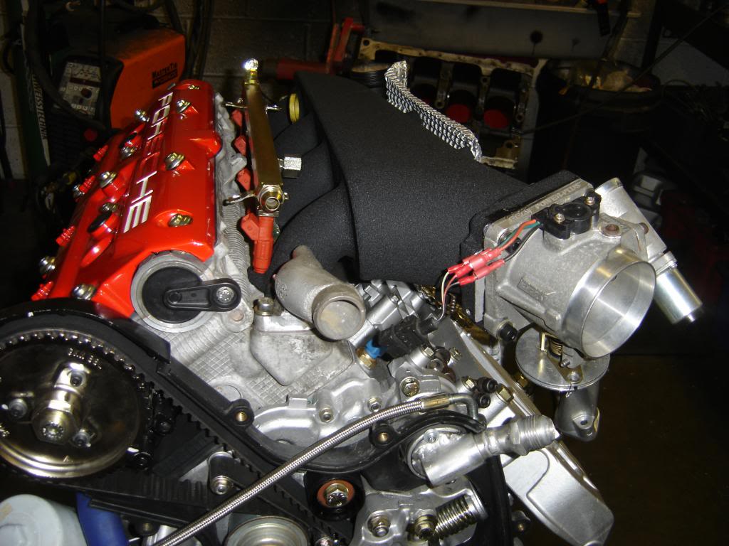

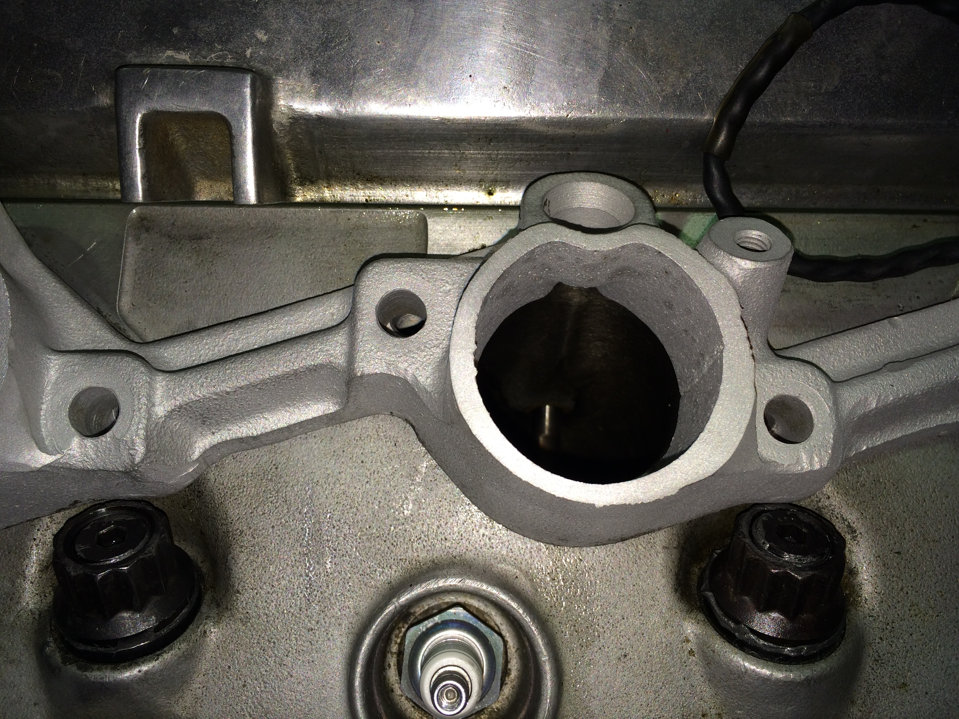

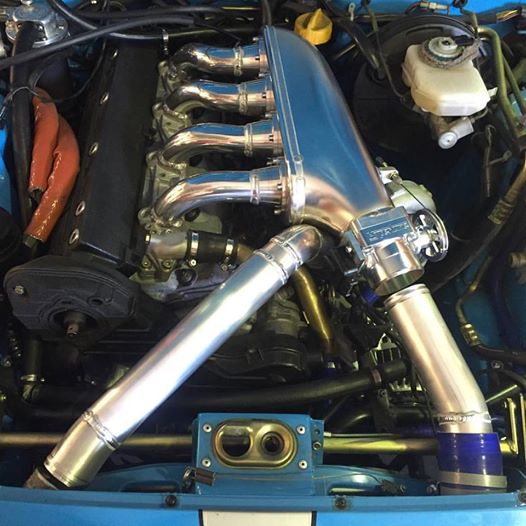

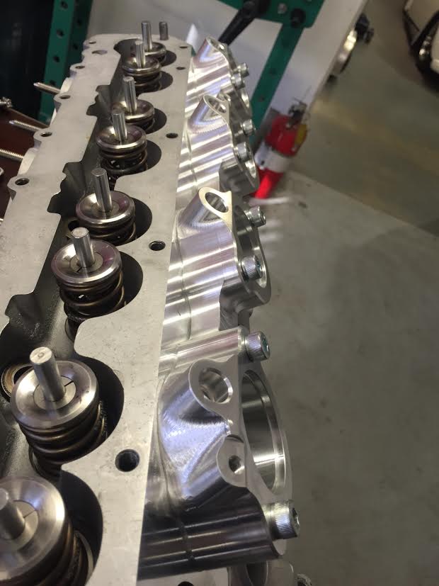

As to headers / X-over, I'd be inclined to find a shop in your area that you can get recommendations for and have them make a bespoke set. I've done this a few times and it's worked out well.
Same with intake if you want. Unless you are prepared to pay crazy big money for CNC'd billet stuff, the welded versions can work efficiently but just don't look quite as smart. Another option is to take an already existing plenum and have them port match some runners up to it. I remember Tim, one of the UK guys doing this with an aftermarket Supra plenum (cutting it down a little) and finishing up with a decent looking and working product.

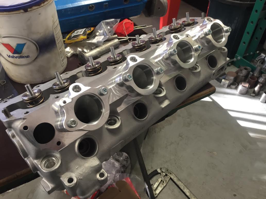

You can use a stock flange and cut it back to then fit runners or get some cnc'd up. We did both for 2 different intakes. You can buy generic runners and weld them to suit packaging and performance intentions.
