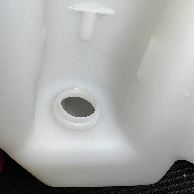

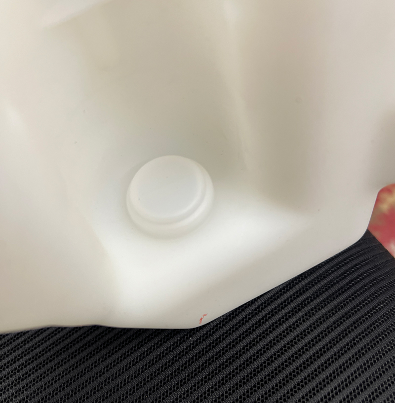

I had to replace my entire windshield washer tank to do this, because my old one was in very bad shape. First thing I discovered is that Porsche has superseded all the old tanks to Part # 477955451F. This tank comes with a port for the headlight washer pump that needs to be drilled out for the pump. Presumably, one tank fits all this way, whether your car came with headlight washers or not. Here's the port.

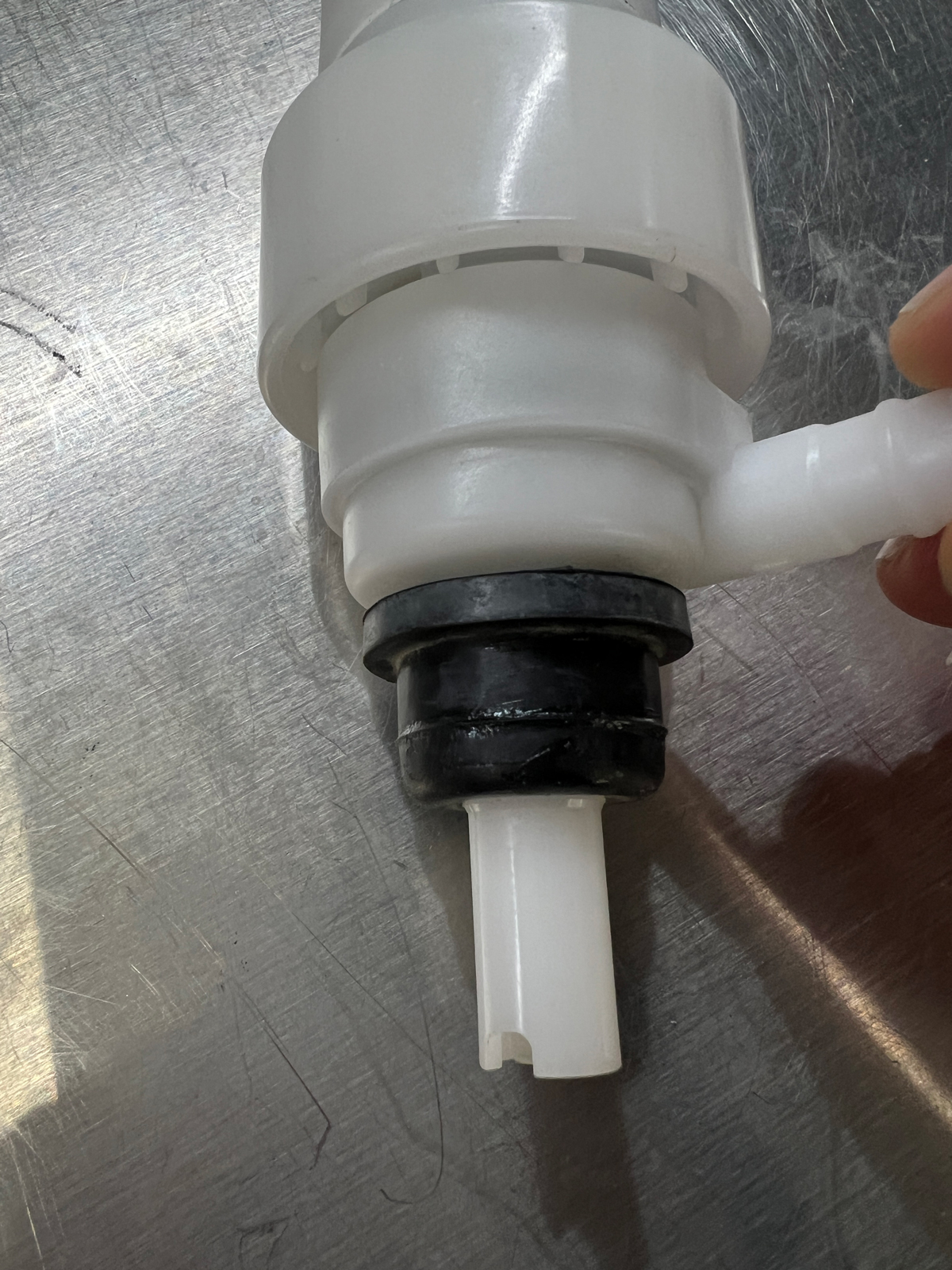

I could not find anything from Porsche about drilling the hole. Instead, I measured the pump's seal that plugs into the tank, subtracted a mm or two, and came up with a hole size of 20mm (with is exactly 25/32"). I went with the pump that comes in the Hella box, rather than the seemingly identical pump that comes in a Porsche box for an extra $100... Here's the seal (part # 92862819300) on the pump (part # 191955681).

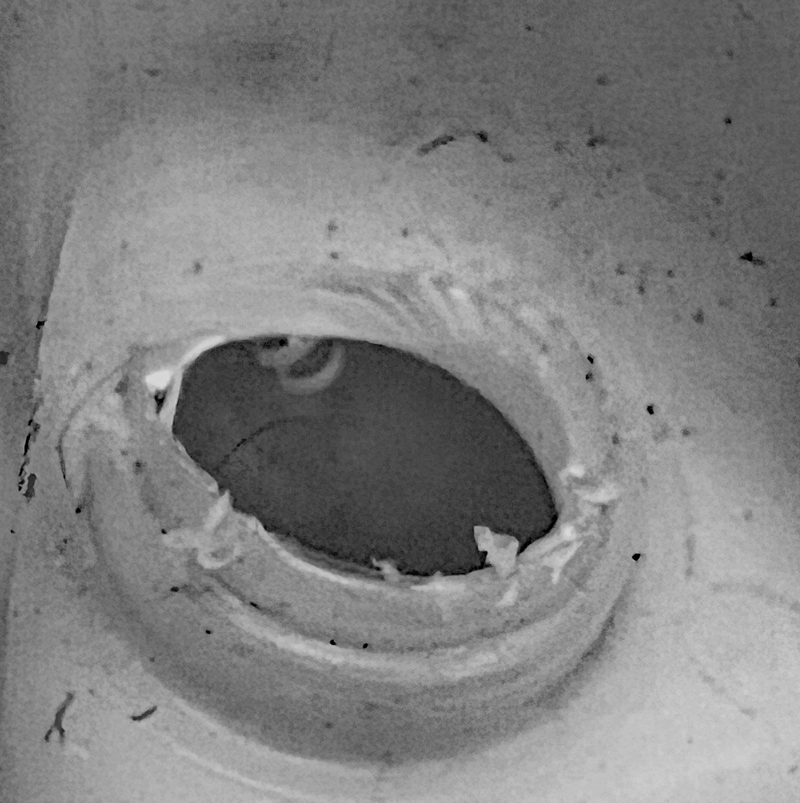

My old tank was riddled with holes, but ironically the headlight pump port had never been drilled, so I did a practice hole in it. I very carefully center punched the port, did a pilot hole, and then used a 25/32" hole saw on the end of a drill bit extension to drill the hole. It didn't go so well. There's no room for error. The hole saw walked a little on me, and I ended up with this.

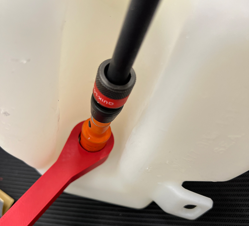

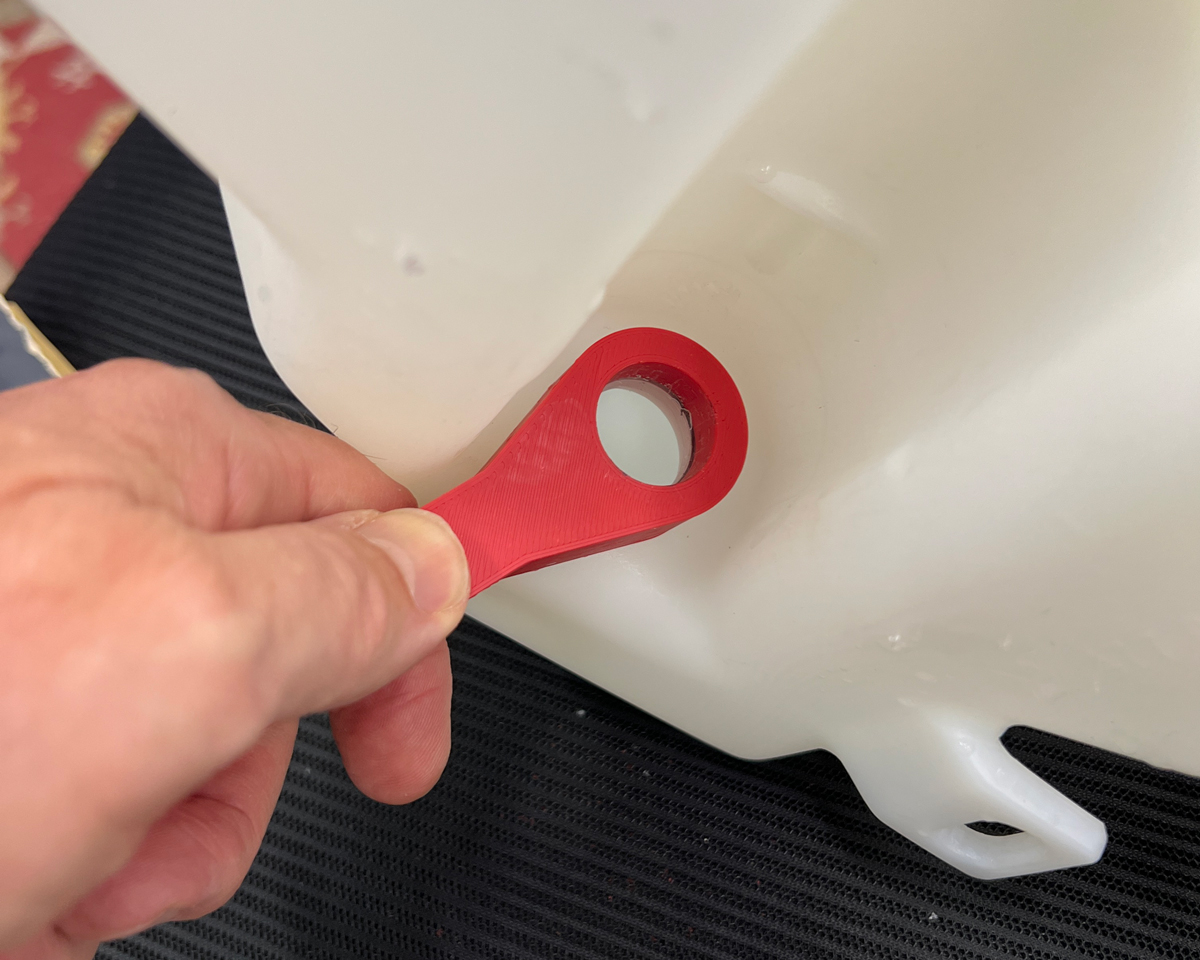

I was tempted to cut that the entire upper lip off the port to see if that's what Porsche had in mind, but as best I could tell the hole below measured a little bigger than the seal, and didn't want to risk a leak. So, I did my thing and made a 3D-printed drill jig. It fits around the port snugly and keeps the hole saw exactly on center. I drilled an over size pilot hole first, so the hole would be placed entirely by the tool (and not the bit in the hole saw). I'll post the tool here on Carpokes for anyone looking to do this down the road. It worked like a champ. :)

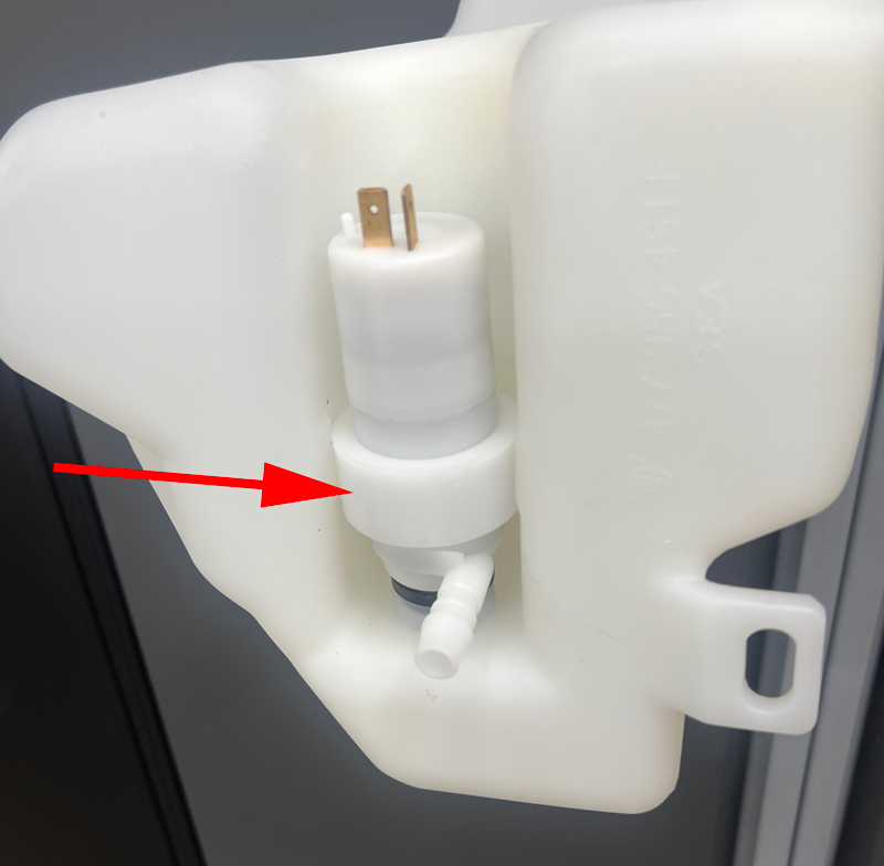

Getting the pump sealed in the hole took a little effort too. The pump has a spacer sleeve on it that forces the pump into an awkward angle when trying to insert it into the tank, making it nearly impossible to push in. The instructions that came with the pump point out that this sleeve needs to be removed to fit some cars. So what I did was remove the sleeve in order to push the pump straight into the hole (after lubricating the seal with Krytox). It was a tight fit, making me again wonder if Porsche intends for people to cut off that entire upper section of the port, but my approach fits nice and tight with zero leaks, so I'm sticking with it. Once the pump/seal was fully seated, I was then able to put the sleeve back on to brace the pump in the tank as intended. The arrow points to the sleeve below.
With that, I tested the pump and it was a nice water-tight seal. I'll post more when I get the nozzles plumbed in, but didn't want to go to all the trouble without first testing the system. And without further ado, check it out!

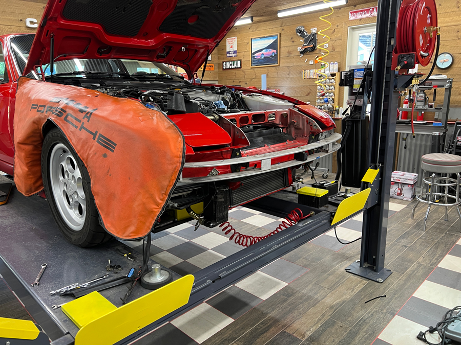

This whole project is an exercise in scope creep to the extreme. Originally, my A/C condenser was leaking. So I took that out. The new eBay one seems to fit like stock but, like the old one, butts up against the bottom of the SFR bigger intercooler. Since I'm trying to simplify this car and make it more 'normal' anyway, I opted to pull that intercooler out and go back to stock -- so off went the header panel and intercooler. Since I was in that area, I also decided to remove the water injection system I had installed years ago, since I no longer use it. The system was an octopus of harnesses, pumps, valves, and hoses that had me tearing half the car apart to remove. I was using the washer tank for that system, and had drilled several holes in the old tank for level sensors and feed lines, etc. So I figured I'd have to change the tank. That's when I realized the entire headlight washer system had been stripped out by some lazy body shop. So then I was off on this quest to drill the perfect hole. Once I got all that working, I realized the same shop put the headlight washer nozzles in the bumper with hose ends cut off and facing the wrong direction. I thought about just packing it in, since I will never ever need headlight washers, but perfectionism got the better of me today, and here we are now....

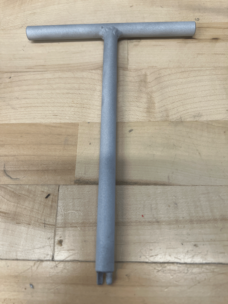

I'll be posting plans for this headlight washer aiming tool in the next few days, along with the STL for the wrench, but thought I'd share a quick peek in the meantime.
