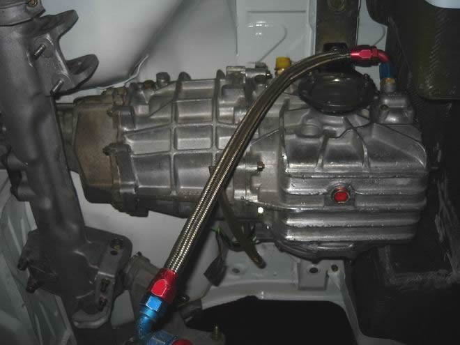

This is an old Heimrath 924GTR that I restored, converted to a 944 3L NA 4V engine and raced in PCA and HSR for years. Its current owner put Darren Law in it at Sebring and I recently ran across this video. It was a good car, and Darren shows it can perform once tires are up to temp. It appears to be an old video that lacks quality, but I thought the racers on here may find it interesting. PS: Even a pro can miss gears!

That's great Michael! Car has a lot of gumbo for a 944 n/a competing against higher powered 911s. Was that a modified 924 gearbox?

333pg333 wrote: Tue Jul 02, 2024 5:47 pm That's great Michael! Car has a lot of gumbo for a 944 n/a competing against higher powered 911s. Was that a modified 924 gearbox?
I used the 924 GTR transaxle, Patrick. It was based on the 924T G-31 dog-leg box, but with several interesting features. It had a larger sump, internal pump and bungs for a cooler, spray bars on each gear, and a clever internal lockout to protect against inadvertent shifting into first gear without going to 2nd gear first. Although it was a syncro box, it shifted quickly and positively. I loved it and found it very reliable.

I thought it must be some derivation of a G-31 Michael. The shifting looked really nice and snappy for an old H pattern. Looks more precise than my 968 trans. Do you remember the power / weight of the car?
