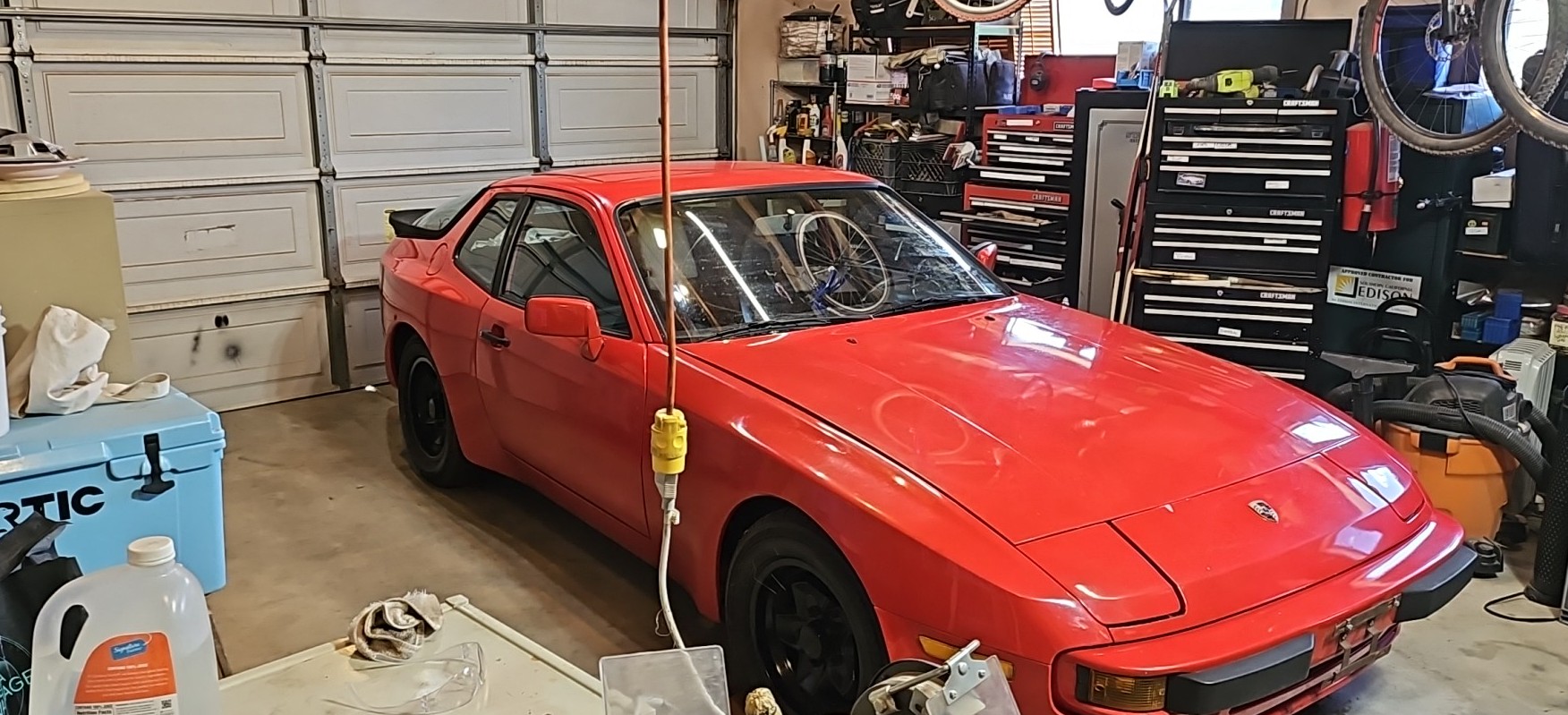

WEnt out to look at a Suburban, I passed on it as the wife was not interested in another BIG car. The owner said he had a 944, well his son did, for sale. Said he got it on a ebay auction and arrived with blown headgasket (undisclosed).
Well, it followed me home and I started investigating, and ordering parts too early.
Just as an fyi, there is always someone out there selling parts on ebay that is way below typical retail, you just have to look.
I mention this cuz I bought the victor rienz head gasket kit for 65 bucks, but I might not even need it.
The previous owner said he tried to run the car, but it would start to overheat all the time. It had coolant in tthe oil.
At worst I figured I would pull the engine, and still be ok on this car. THe interior is as good as any unrestored 40 year old car can be. Leather, perfet condition, sport seats. Exterior and body are good, with terrible repaint and minimal dings. Looks fine from 10 feet, but up close is not so great. No, rust, at ALL. Mostly original. Sport package, sunroof, P/S, power windows, Guards red on black leather. Cookie cutters with good tires. Got it for 3500. Clean title so no DMV shenanigans.
Pulled the intake off, and the boot fell apart from the oil buildup, and a bit of oil in the air cleaner housing. pulled the AOS, bad seals (original). Pulled the manifold. pulled the plugs, they are fine but its burning that oil. Sope the pistons, no steam cleaning. So I'm thinking its just the oil leaking problems. Then I drain the radiator. But there is almost nothing in there. Like a pint of oil/green coolant. So I found why it overheats, as coolant is a requirement in most vehicles for proper function.
So the indicated mileage on this 944 is 28k and change. And the sale history shows that too. The interior NO WAY has 128k, its just too original and clean. The dealer service record stops at 24k miles, then it got sold to the 2nd owner. The second owner did some maintenance (assumed as I only have the parts receipts - no labor receipts). The second owner sold it on ebay, to the 3rd owner. That guy started it up for 2 years and never drove it as it overheated quickly. He sold it to me.
It never moved for the last 2 years, and for 35 years only saw 4k miles.
My goal is to get it running. I might keep it. I might sell it. Hard to say right now.
I've decided to NOT pull the engine. It only has 28k on it, and I think it never got real hot. And I think the issue is really the oil cooler, and AOS seals. And I think I'll not pul the head unless I absolutely have to, and I'll pull the engine at that point.

I've been keeping this project going for a while, and here are the results and findings.Fixed issues:
Oil cooler seals.
incorrectly installed rad hose.
vacuum leak in the AOS.
leaking master cylinder.
old brake fluid.
old transaxle oil.
2 oil changes to clear goo.
6 or 7 rad flushes to clear goo.
faulty rad cap.
dried up injector o-rings
variety of loose bolts.
replaced rear headliner
recharged A/C with 12a
new A.C belt
new A.C relay
new DME relay
headlight fuse
new rear lock grommet
new hood latch
Adjusted front wheel bearings.
Still needs:
Tires are still flatspotted. I'm going to run this to the office - 2 hour drive in AZ sun - to see it if the sustained heat will round them out. Seems like a waste to scrap v rated 15" tires (hat don't exist any more), they have less than 1000 miles on them!
A/C needs a bit more charge.
Sunroof - still looking for manual latches in the rear. The drive cable was stripped and all the little plastic bits broken.
Clean out the Cat, I think its clogged up, but unsure at this point.
The orginal stereo just barely works.
The clock needs a refurbish.
The Odometer is, well, unhappy.
The paint is oh-my-god terrible when you see this close up. Need to color sand and maybe a whole new paint job its that bad.
