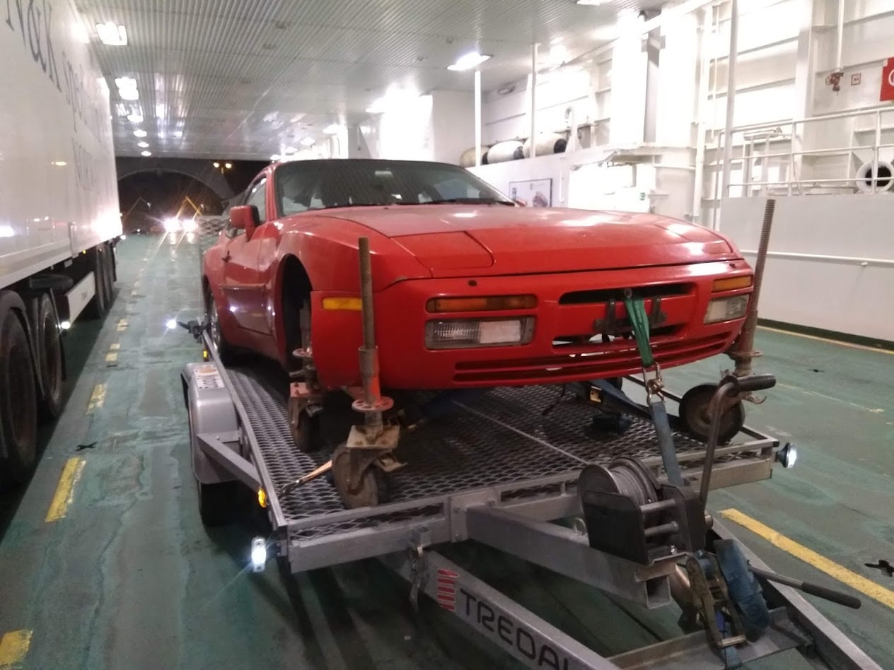

My car is a 1986 US spec Turbo that has been standing still since 2018 when it broke down with its 3rd engine due to cylinder wall scoring . I Left the car for a while and long story short more or less the whole front end got stolen before i transported the car car home and started a slow rebuild.

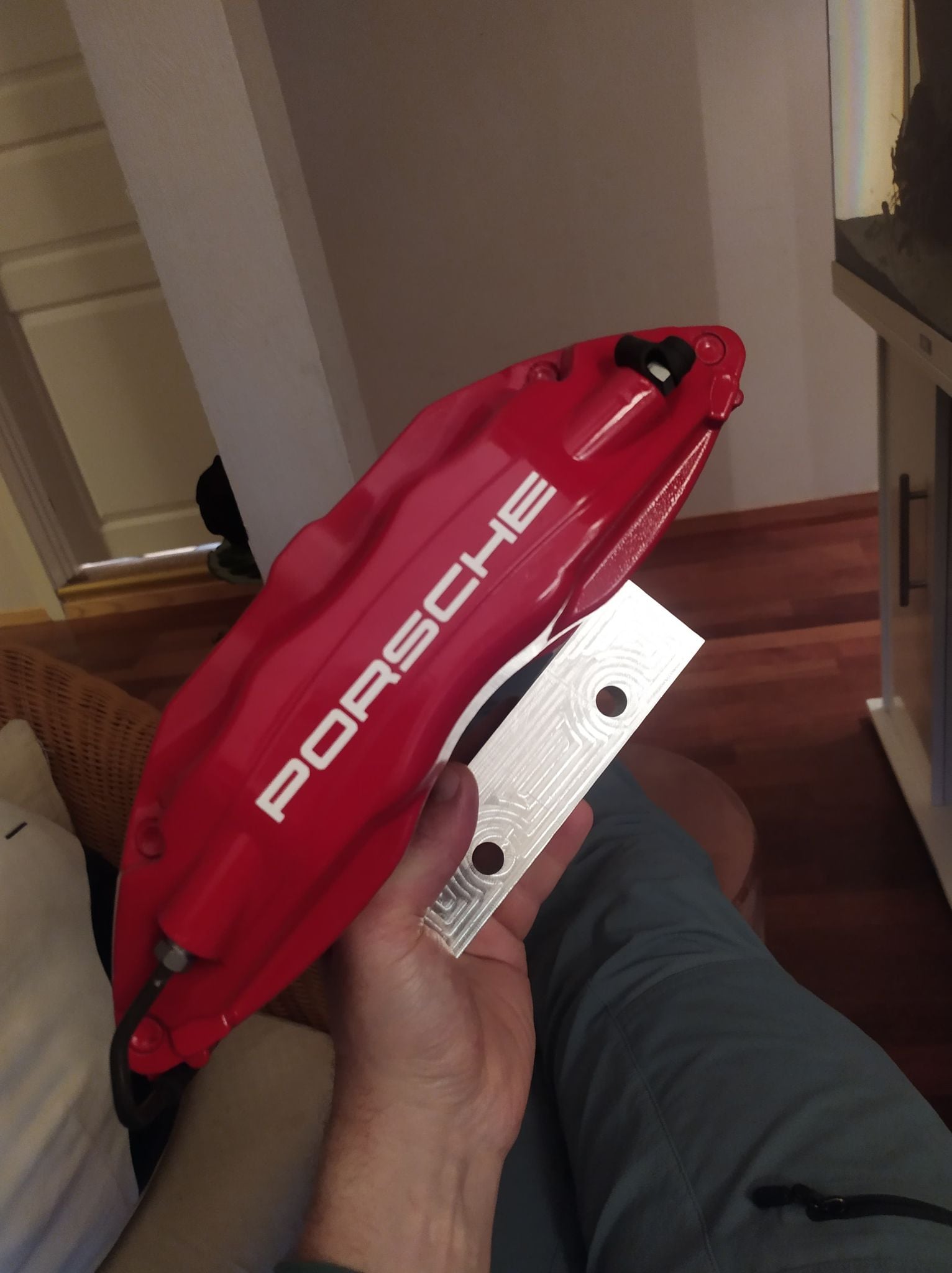

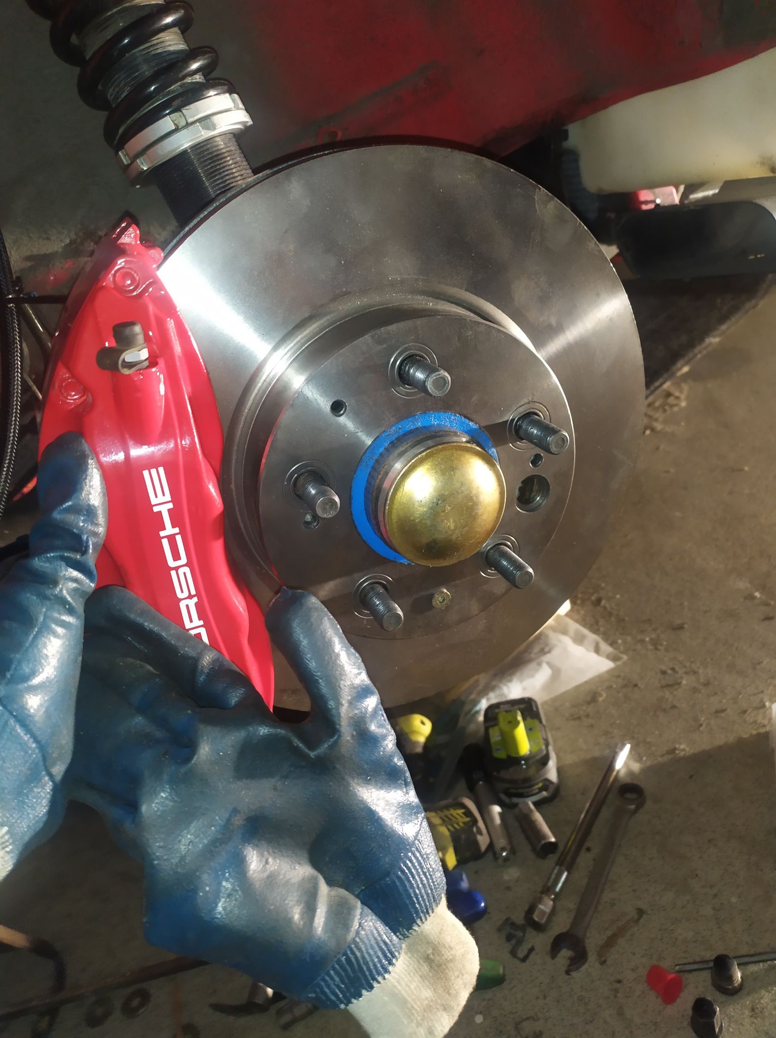

I spent some time in a tiny garage at home and got the front lower end rebuilt with a strange combination of early and late offset components . Suspension i choose was a set of lightly used Gaz gold coil overs. I converted to a mechanical steering setup and Late NA spindles and hubs. Since i no longer had any front brakes i got some cayenne rotors and big reds mounted with some adapters i made. The car got moved to a bigger garage were more serious work could be done more easy.

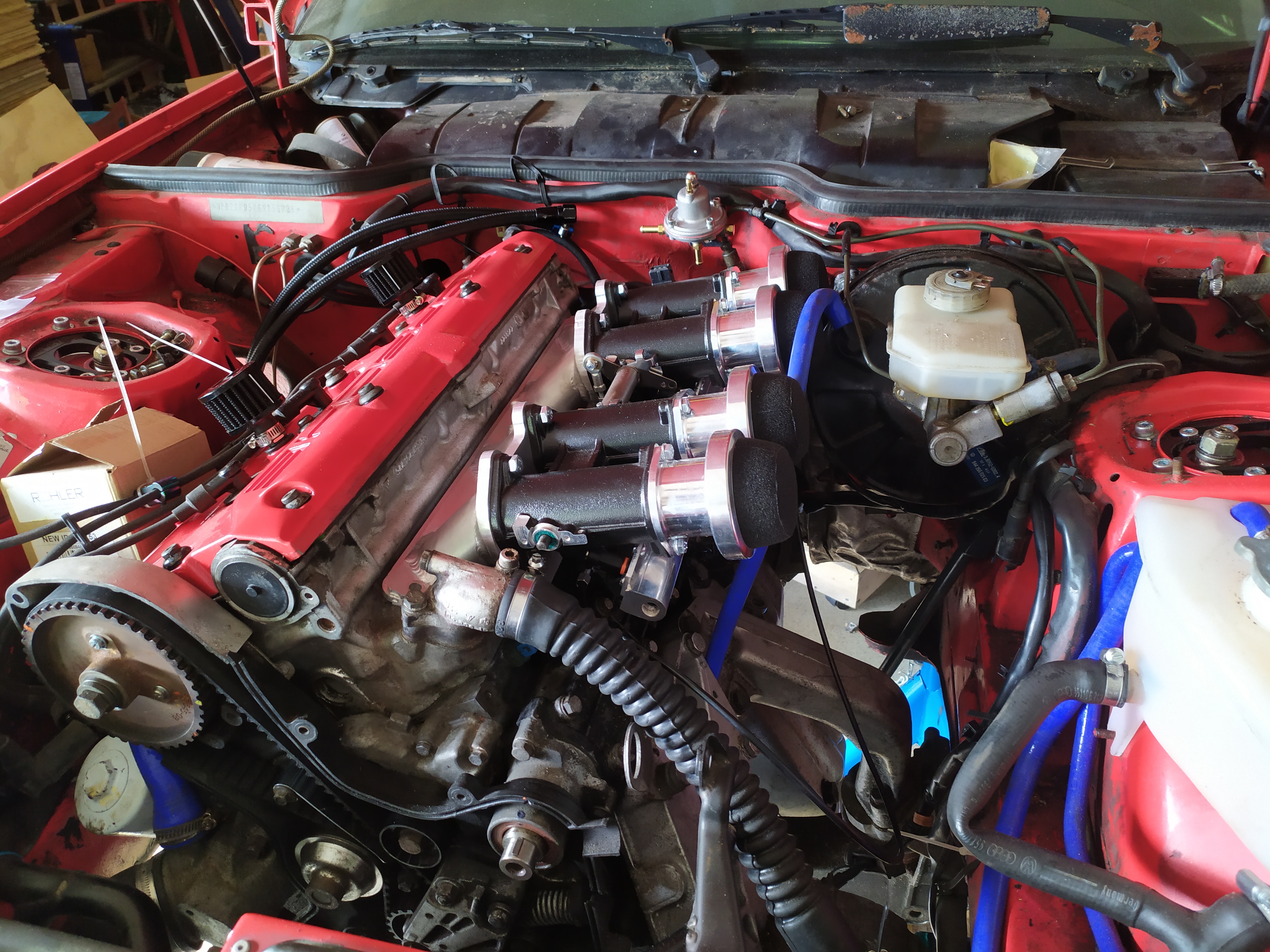

The new Intake and Fuel setup really cleans up the whole engine bay. 1 vacuum line going to the booster and a nice new plug and play wire harness is going in. Balance shaft delete will be done to further remove parasitic loss from the crank. I had to remove the AOS and oil filler neck as this hits the ITB manifold. Also since there is now no vacuum being pulled into the intake from crank case ventilation i opted to vent the top aos port and camcover with filters. I will eventually install an electric vacuum pump and route it all through a catch tank unless this solution is acceptable.

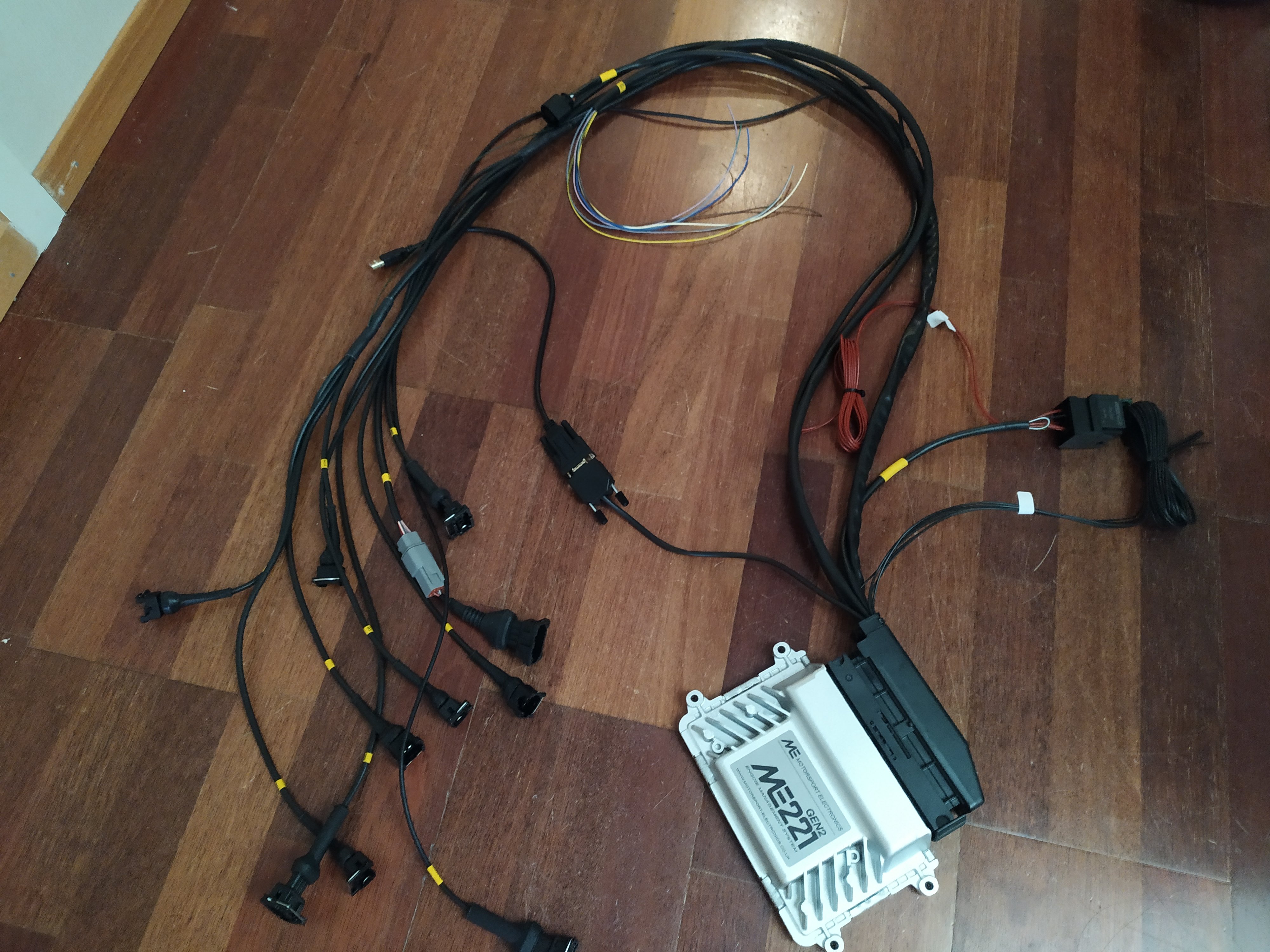

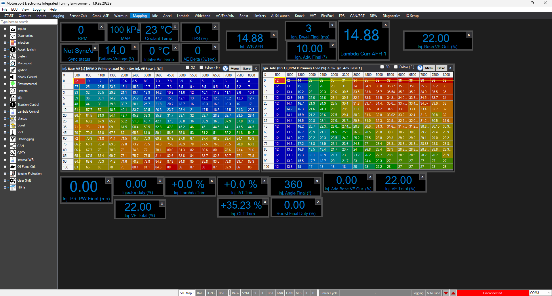

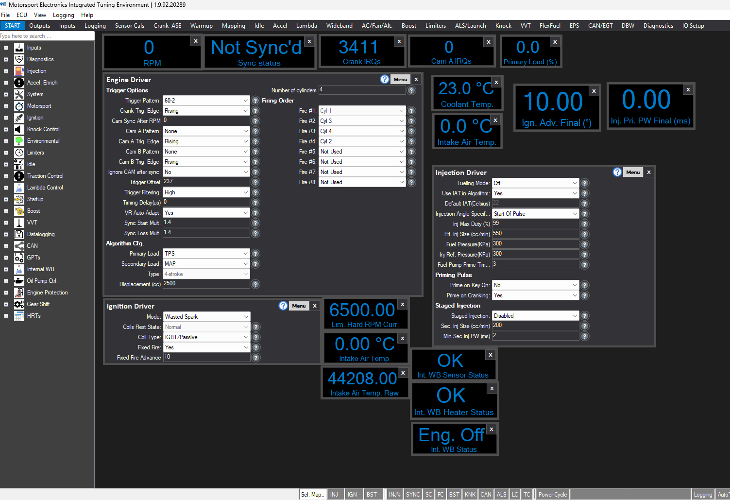

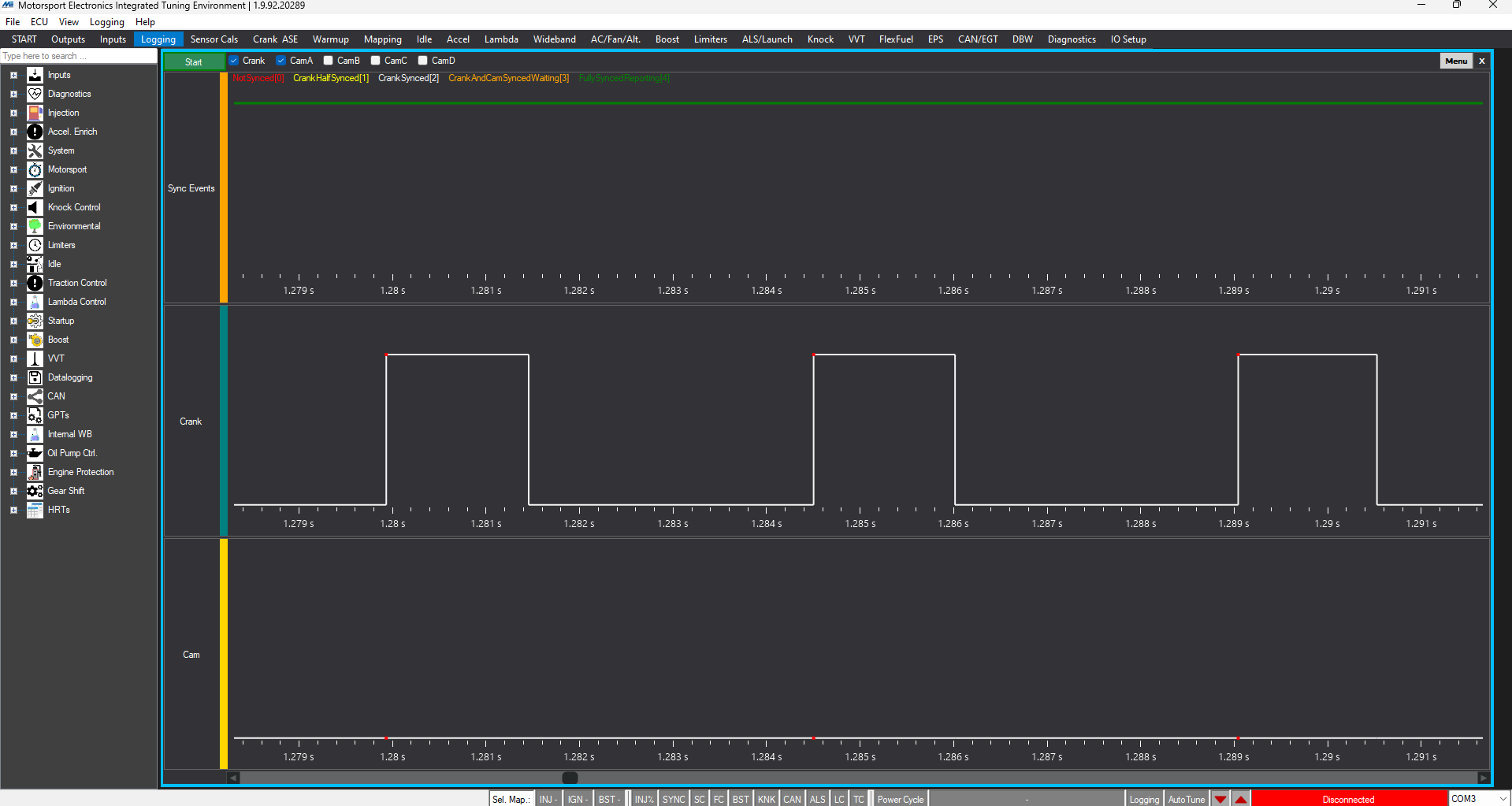

Getting ready to fire up my car done going trough the base map and calibrating the sensors Trigger in sync as shown above. Only now to find out my 044 pump in the back is now broken (probably due to alcohol content in the fuel.) This was a new pump purchased last year as the one before that got stuck as well due to long storage time and I didn't drain the tank. Guess i will have to head out tomorrow and get a pump.
Lesson learned .
So far i am happy with the Motorsports Electronics ECU . The ME221 is easy to setup and configure and has a great manual. The wire loom it came with is good quality with great labels. And to me seeing people paying 1700usd for a wire loom for a 30 year old ECU when you can get a brand new ECU ,injectors and a factory crimped loom for the same price is mind boggling. As far as i can see the only missing connector on it was Knock sensor I will splice in knock sensor before i start tuning- Do think i will change for a modern sensor though. The MAP sensor plug will not be used yet maybe later for barometric correction but i mainly drive close to sea level so we will see. Another issue i had was to find the correct calibration chart for the IAT sensor after manually plotting 5 different charts it shows real temperatures tested with an electric fan oven that can adjust cold and hot on a knob and a handheld thermometer with a probe dangling next to the IAT sensor
Lesson learned .
