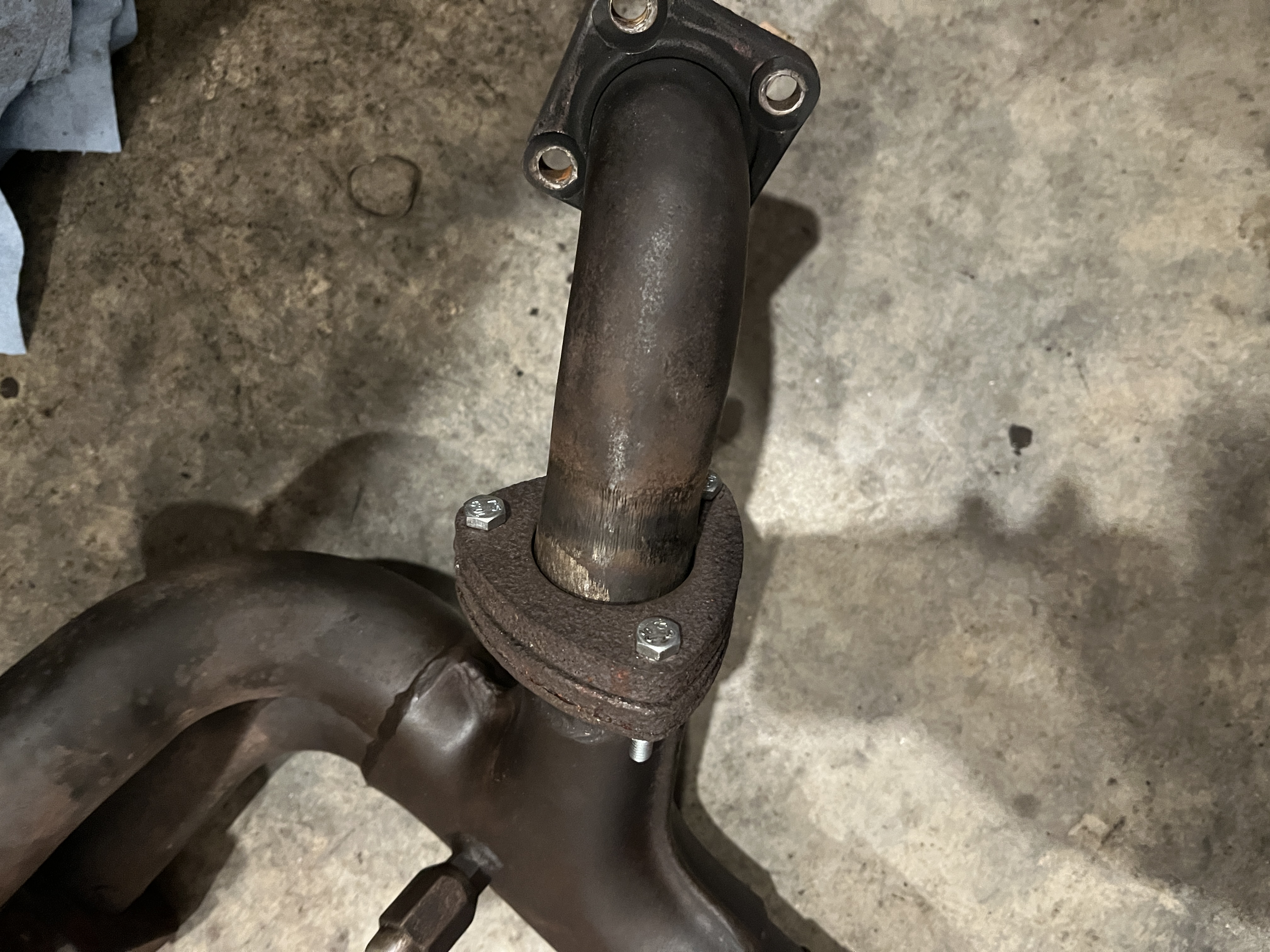

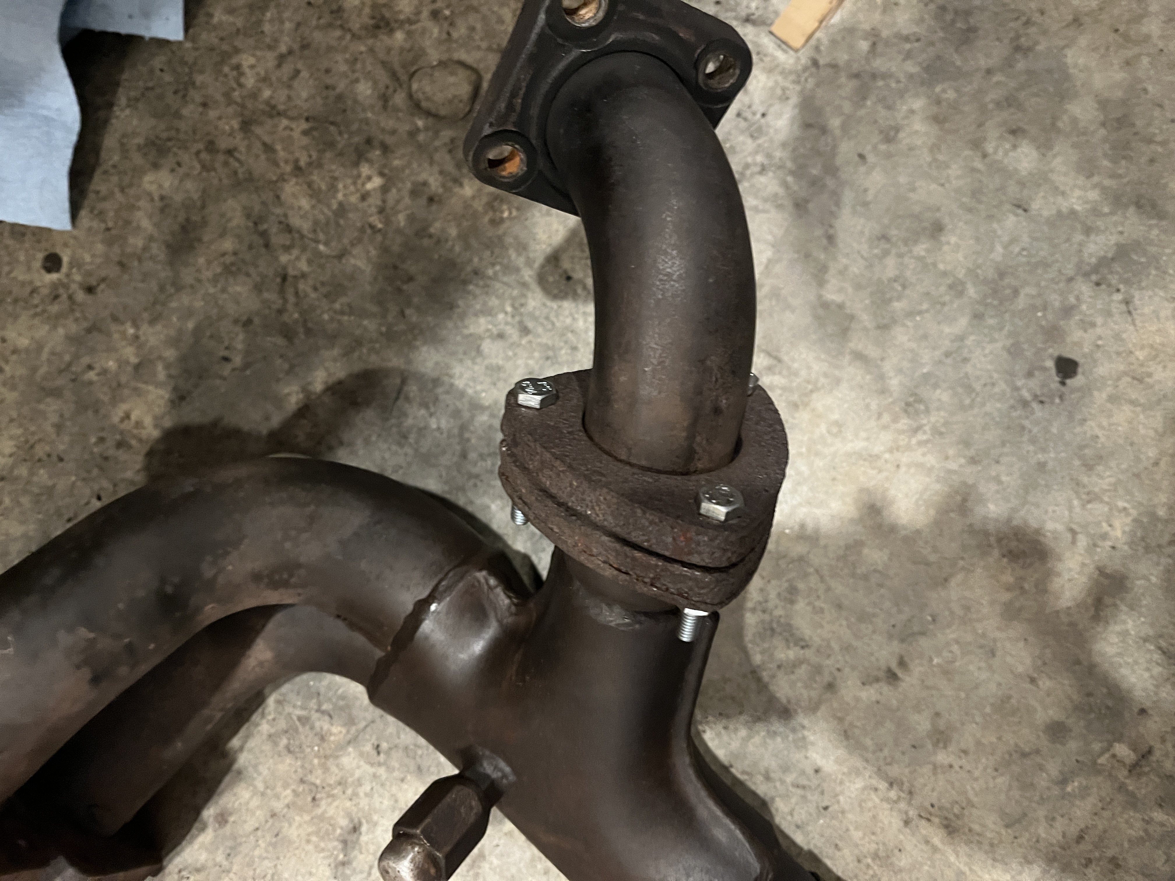

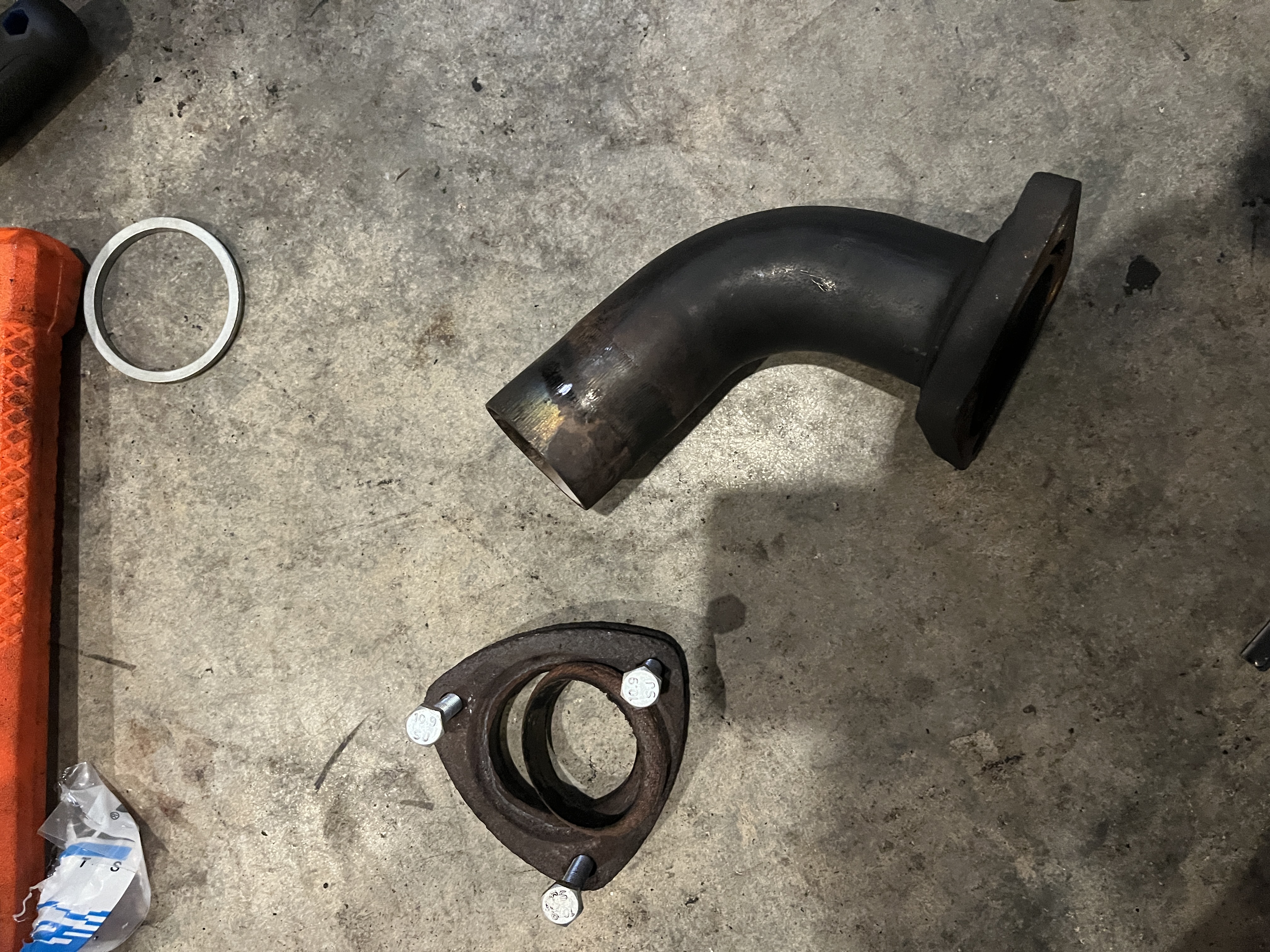

2 piece crossover pipe - the elbow to the waste gate inlet, I don’t understand how this forms a seal ? It seems to be a slip fit, but there’s nothing to apply tension to the cross over pipe? Am I missing a piece? It seems like the opening should be flared, then i could put the metal donut between the two flares and screw it together, but as it sits the donut and the flange slip over the elbow and just slides in and out on the crossover pipe, almost seems like I’m missing a spot weld or something on the pipe.
944online sells a new pipe but again… how does this form a seal?

To clarify. With the flange and donut tightened . The elbow can slip in and out without too effort. Verify this is normal ? Seems like if the pipe can move in and out then so could exhaust gases ?

My guess is you just need a new donut. Yours looks pretty worn out....

How would a new donut tighten down the pipe any more? It seems to be used to seal the two flanges. But my issue is the elbow itself physically can come completely out from the crossover, regardless of how well the flanges are sealed together. Should there be a spot weld on the elbow to prevent the flange from getting separated from the elbow ?
Unless when installed on the car there's a side force on the tube? Such that it's not moving or tightened straight forward/back out of the slip fit, but rather at an angle?

The fresh donut has a little more meat to it - it expands radially (inward) when squeezed by the flanges. A fresh one should make that joint pretty stiff when tightened up.

Ahhhh that makes a lot more sense thanks for the explanation
