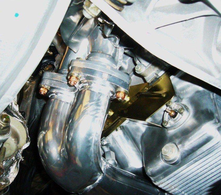

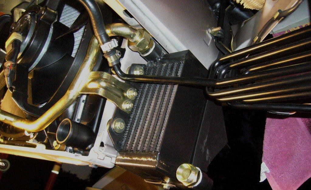

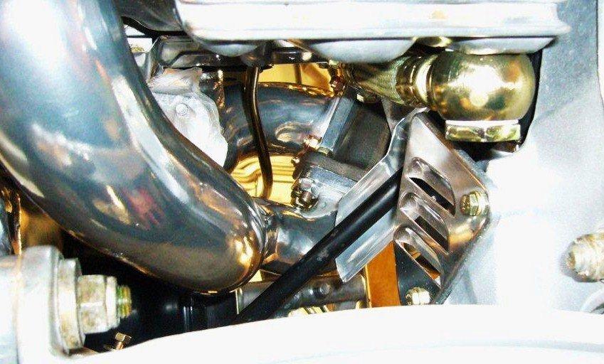

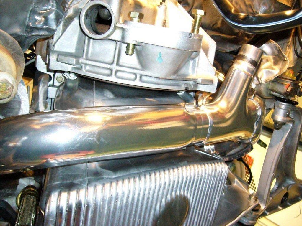

Here are some pics … most of these I don’t have on my iPhone. I had to go searching for them.
- IMG_0696.jpeg (138.62 KiB) Viewed 1467 times
- IMG_0694.jpeg (111.12 KiB) Viewed 1467 times
- IMG_0693.jpeg (158.27 KiB) Viewed 1467 times
- IMG_0692.jpeg (172.21 KiB) Viewed 1467 times
