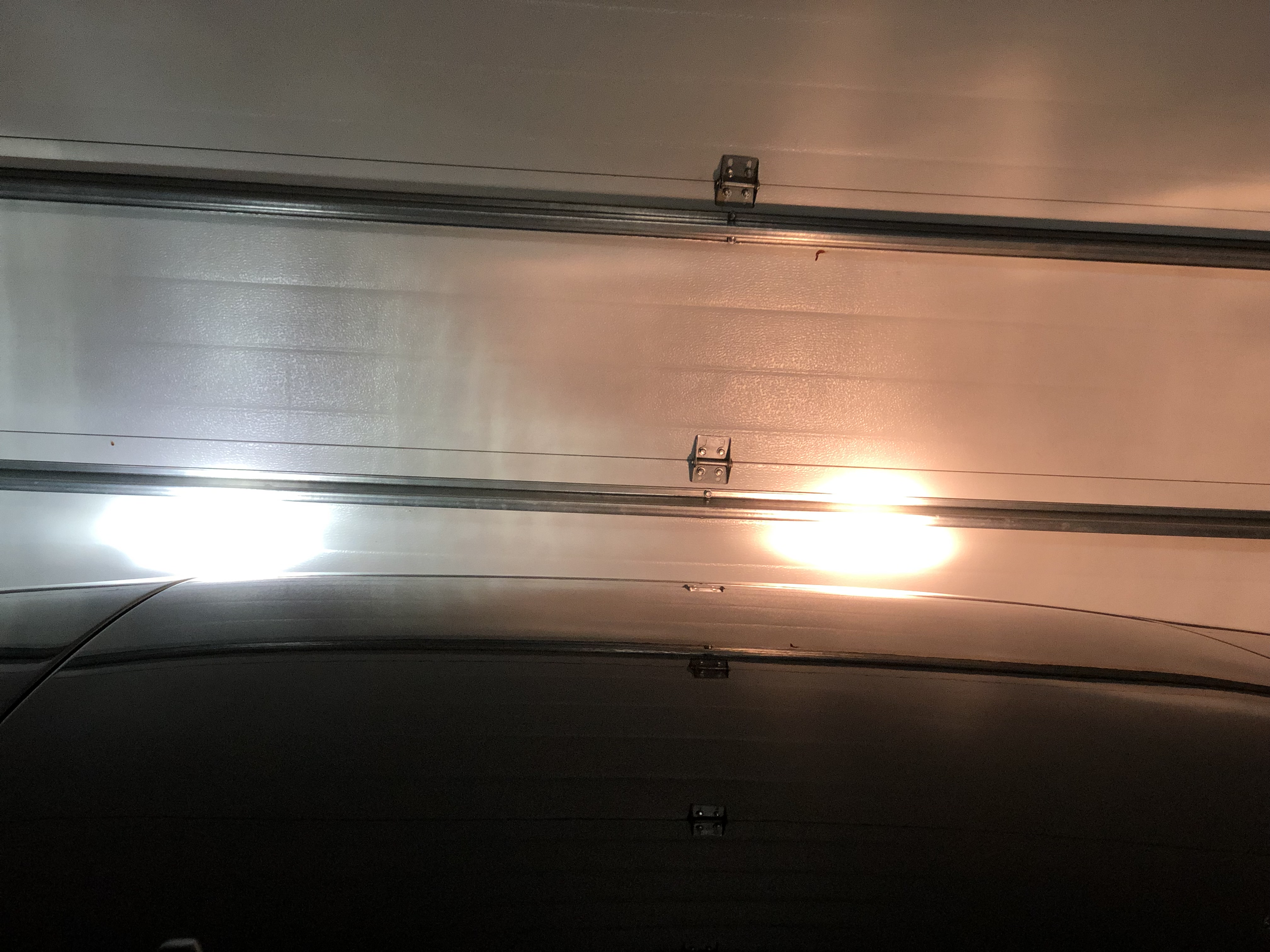

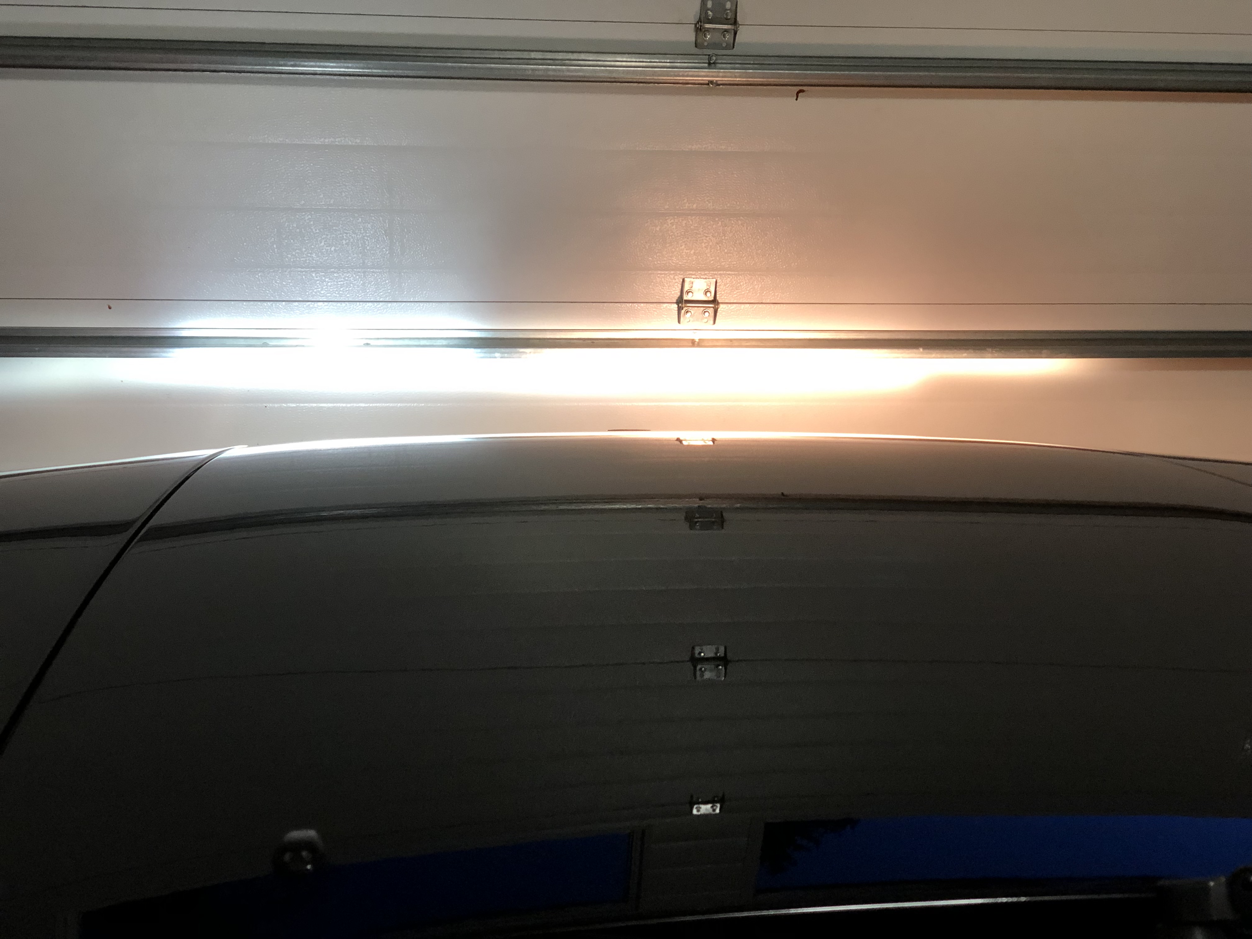

I swapped in some LED headlight bulbs on a whim, after seeing how they improved the lighting in our other cars. Of course the halogen H3's look like yellow candle light now, even with the 100W H3's in both fog and aux main beam sections. I grabbed a couple different extra-bright H3 LED pairs for evaluation on Amazon, installed them on the driver's side but left the halogens in the passenger side. Took the following pictures against the garage door to show the beam pattern (great) and whiter color (great) in comparison, and show the similar total light levels. Again, LED's on the left, 100W halogens on the right. Fogs, then the aux main beams (high beams).

I have not yet found the perfect option, unfortunately. I've tried four different versions so far, and decided on the least-poor of the presented option. The challenges, as you may already know, include the shape and alignment of a filament vs. the LED emitters. The lamp reflectors are relatively small, so even small differences dramatically change the shape of the light pattern coming out. I use the fog lights as pseudo DRL's, and the larger scatter for those is actually desirable for that duty. For the aux main beams/high beams, the LED's I've tried so far offer no direct forward emissions, so the quality of the reflected light beam is completely dependent on the correct emitter alignment. The LED's aren't really cutting it there compared with what they replaced, but are acceptable especially considering the limited duty the car sees these days. They work fine for flash-to-pass duty though.
