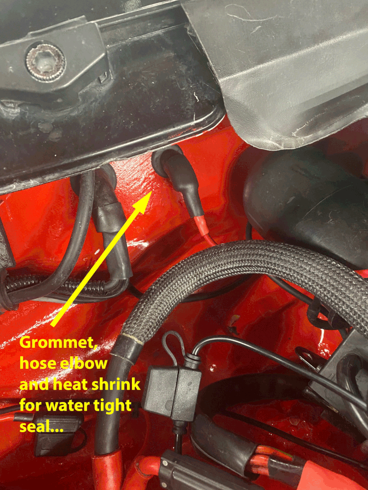

I attached a 10g wire to the positive battery post via a 30 amp inline fuse. I put a tight-fitting piece of curved hose in the grommet, ran the wire(s) through that, and then used heat shrink to seal it all. Had to remove the glove box to get to the other side, and routed the cable down the passenger side of the car...

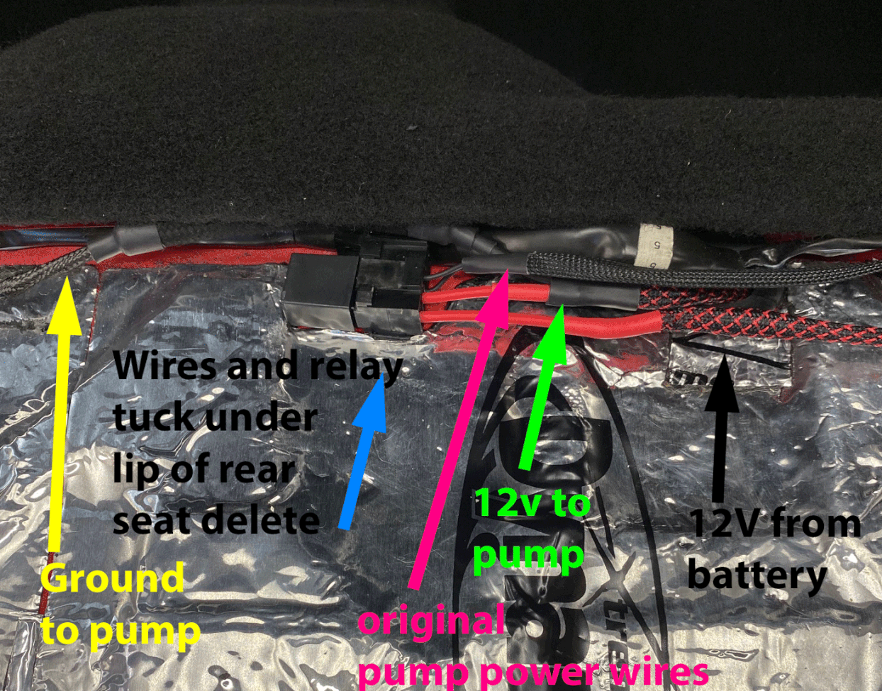

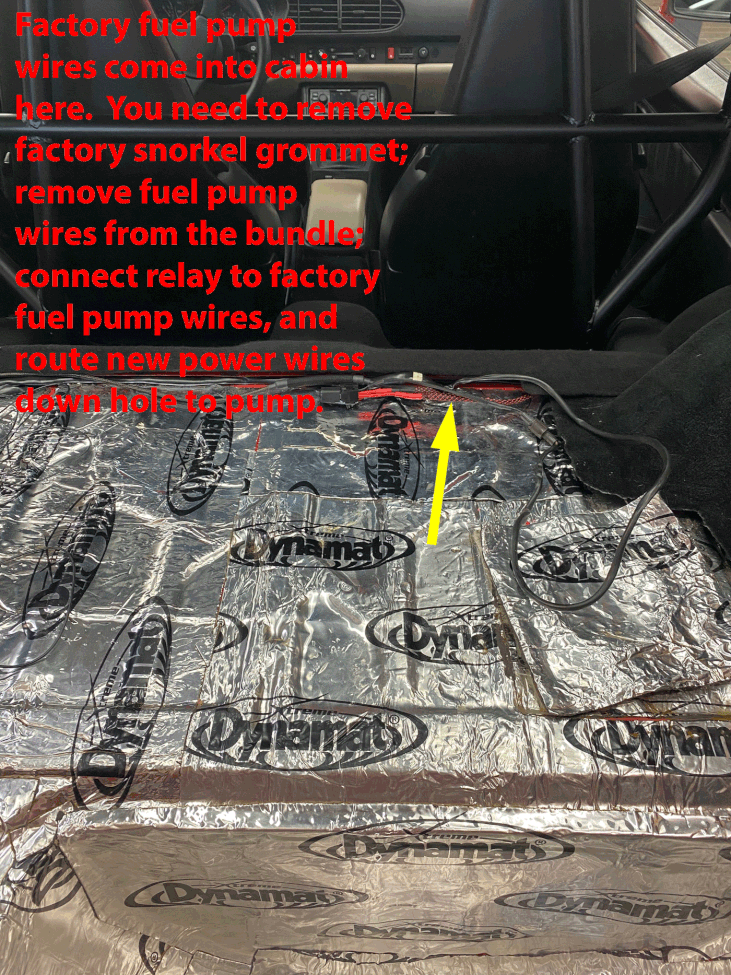

The factory wires to the fuel pump come up through this hole in the hatch floor. I had to remove the grommet that was there, strip away some of the harness sleeve to free the fuel pump harness from the bundle of wires and pull it up into the cabin, so I could use it to trigger the relay...

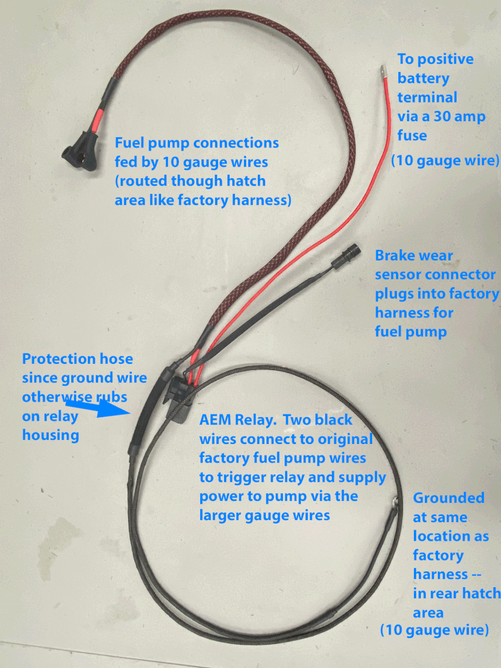

Here's the harness I made. The factory fuel pump harness has a connector under the car. I discovered this is the same connector used on the brake wear sensors, so i found an old brake wear sensor and soldered its connector to the control wires on the relay so that I could connect it all without cutting the factory harness. Sheathing is just what I had handy, with dual wall adhesive-lined heat shrink where needed.

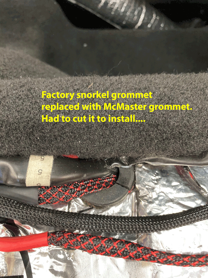

Rather than try to pull the entire cable, I cut a grommet and worked it into place in lieu of the factory snorkel-style grommet. It's reasonably well sealed as is, but I'll likely cover it all in duck tape or silicon...
