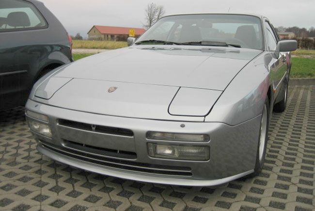

I've been wanting to add a front splitter to my 951 for a while now.
Really looking for a mild splitter like the picture attached. Does anyone have experience FSH out of Germany?

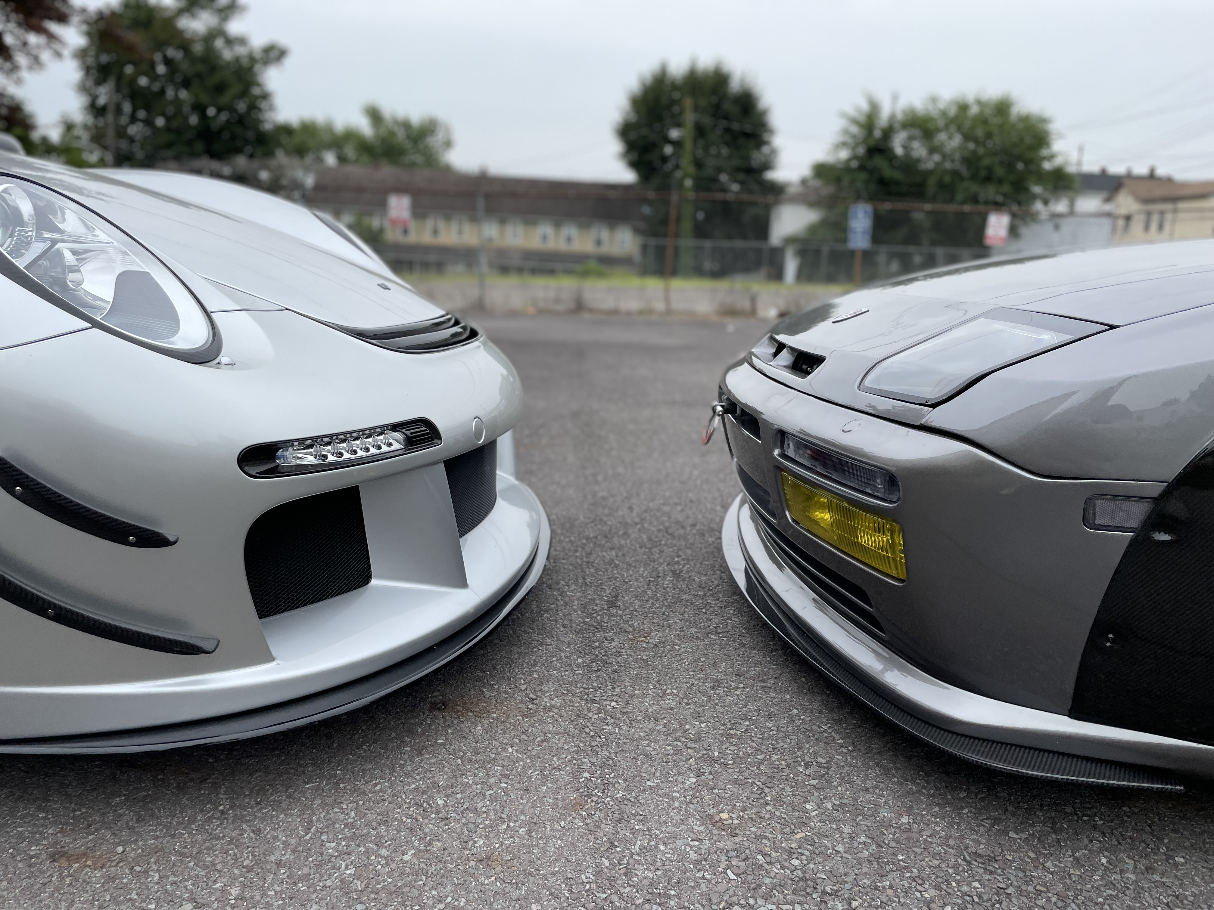

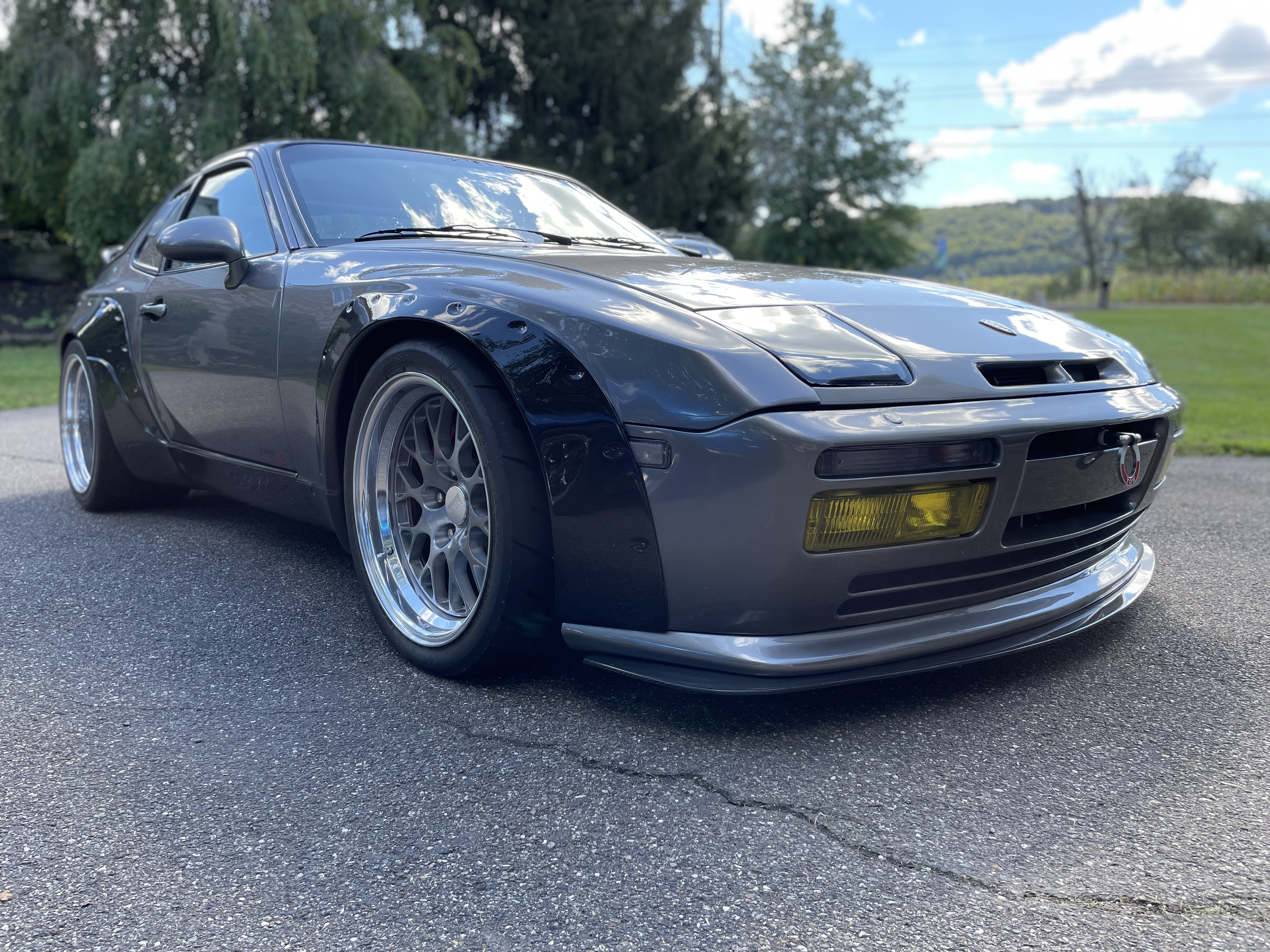

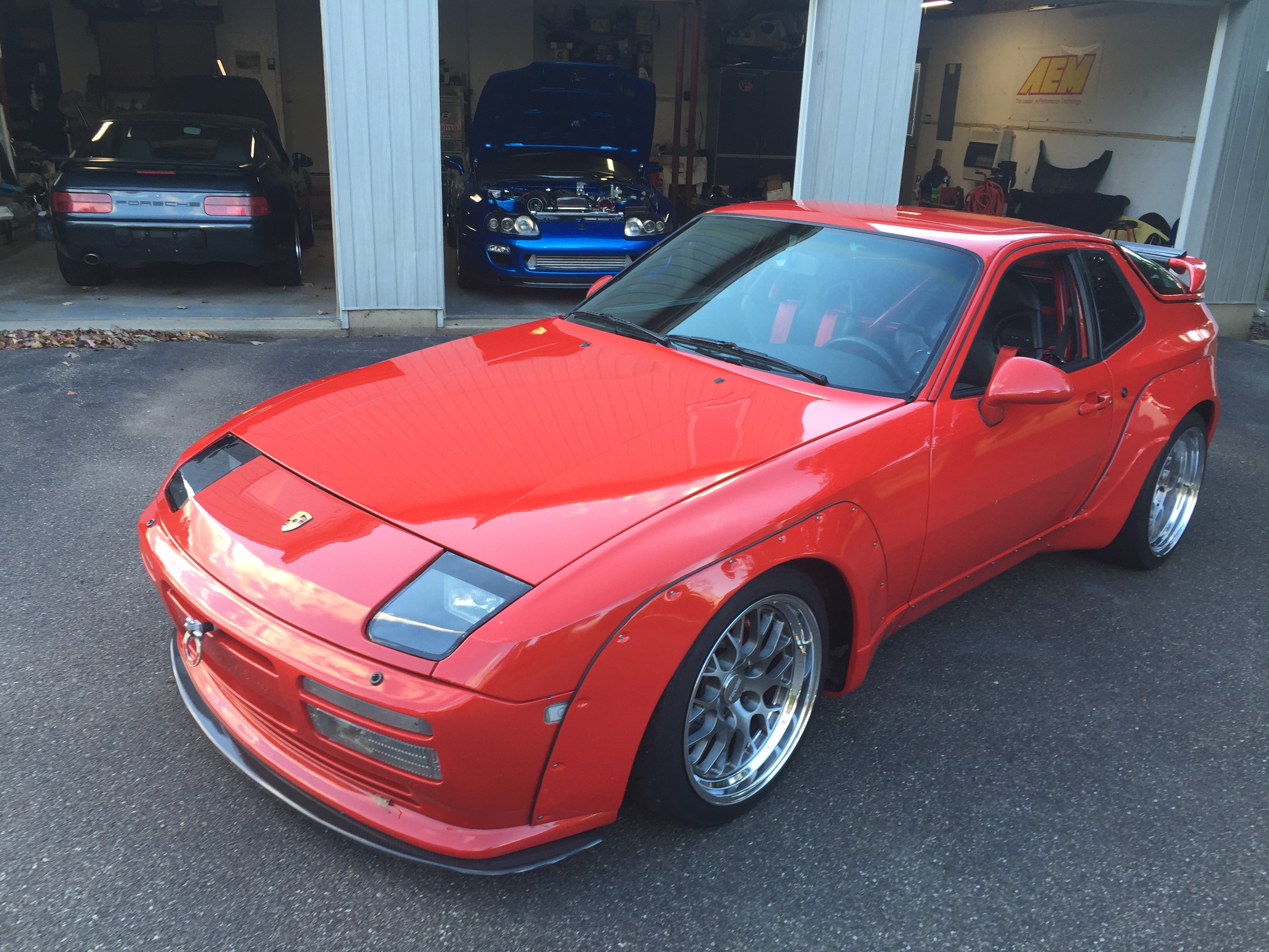

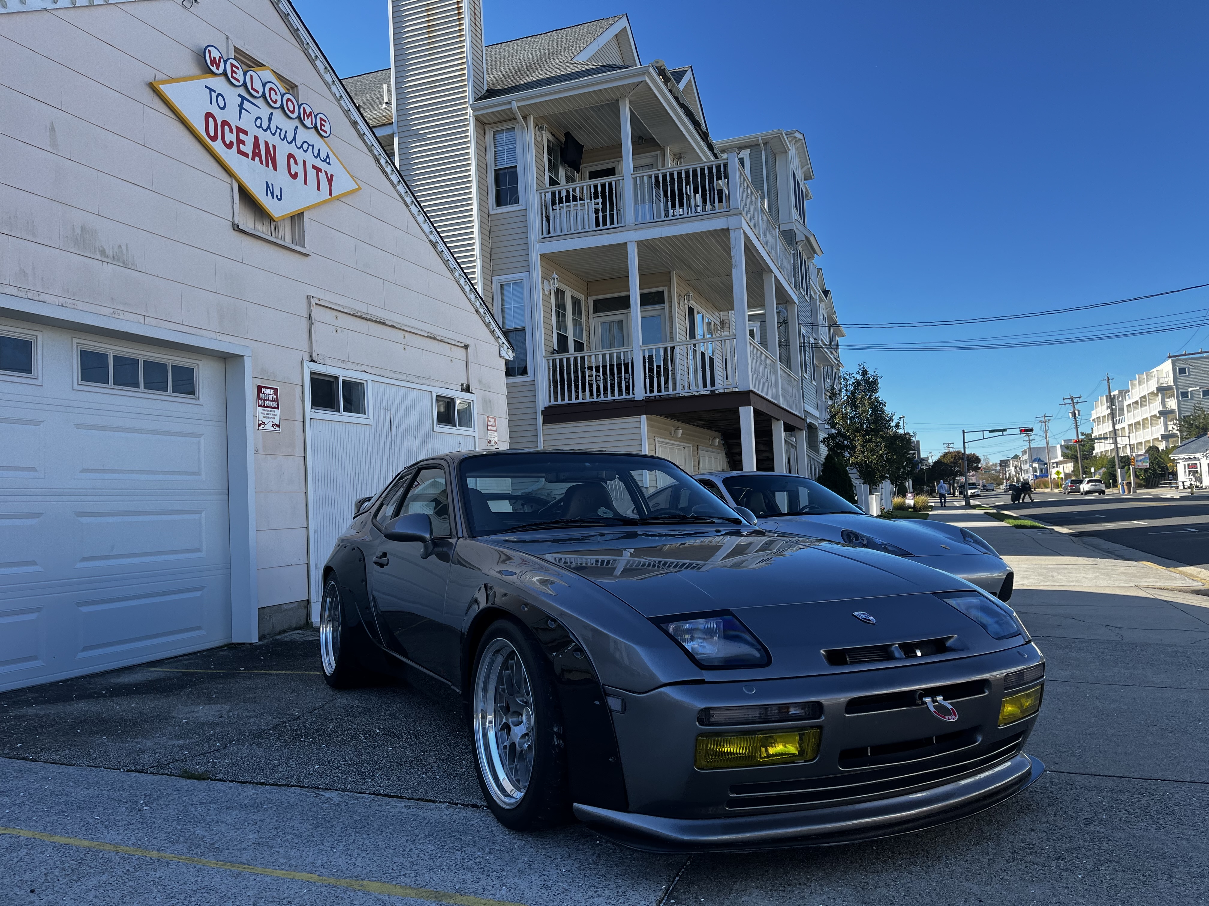

I have never personally dealt wirh FHS. My front splitter is similar to the one you posted but was from a company called Advanced Composites. I dont think he makes them anymore but i believe someone bought his molds. I have used this same lip on a couple previous cars and added a carbon fiber diffuser. Here are some pics of my old red car and current grey car for reference.
