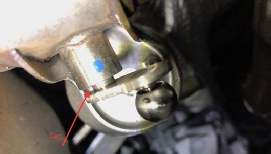

Hey everyone... I recently took delivery of my new 718 Cayman Style, and as anticipated, the PSE exhaust valve started rattling. Apparently it's a VERY common issue... Some people can't hear it, but I am annoyingly ultra sensitive to rattles and squeaks, so I knew this would be an issue I would face.
Here is a video of the rattle:
The issue: Look at the following image: There is a gap that gives lateral movement, which is causing this annoying rattle anytime the value opens (which is at 2000rpm, or when you manually open/close the valve).
Photo thanks to 718s From 718Forum

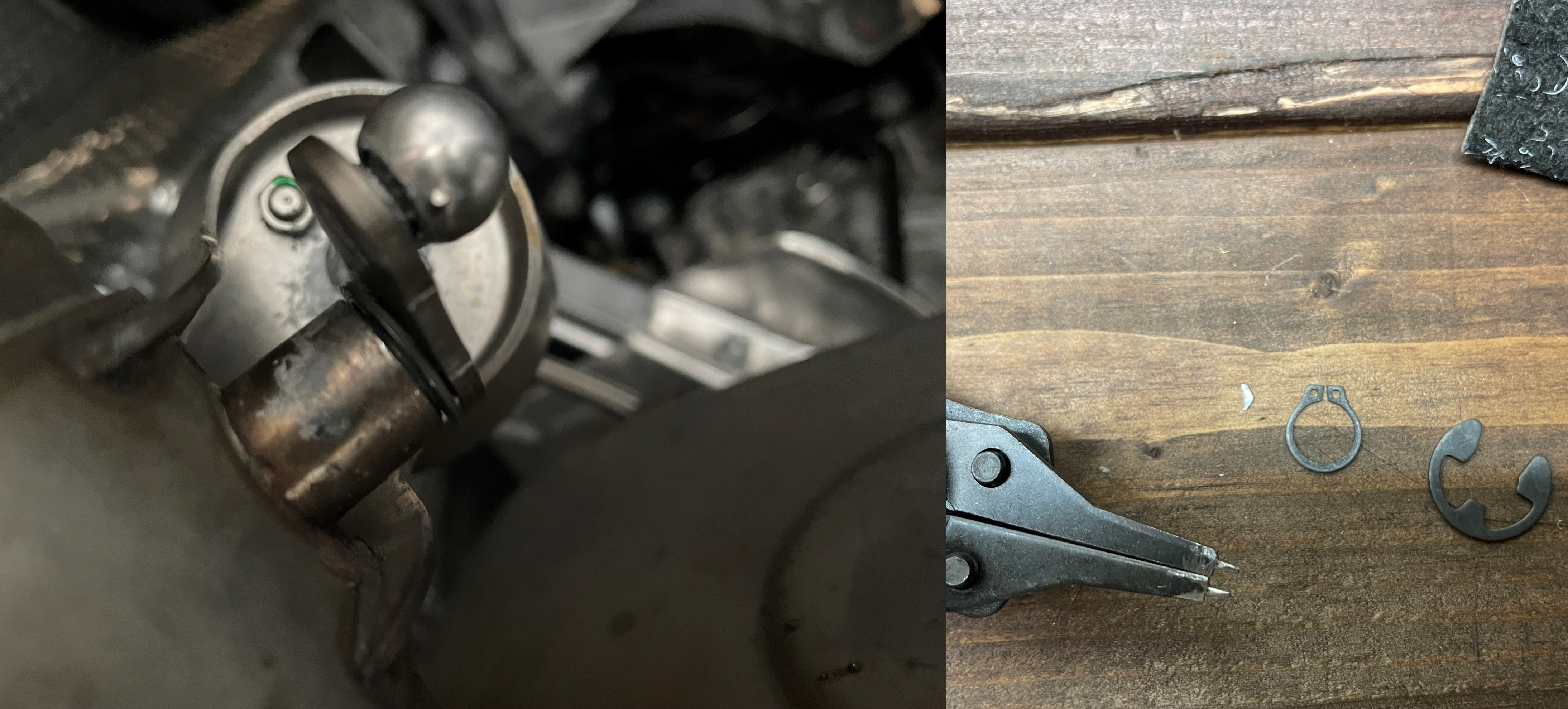

Today I found a solution that has worked so far! And it cost less than $5.00
The idea is to close that gap so it can still freely move, but is tight enough so there is no longer any lateral movement.
I bought 2 clips from Lowe's (99 cents each), and some anti-seize metal grease).
Slid them on, greased em' up just to make sure they move freely, and BAM! No more rattle! Quiet as a mouse!

Hey, great solution. I saw on a another forum people used a different style clip, it is a wire clip called a hairpin. I bought some and they broke as I was pressing them over the shaft. So I did the high temp ceramic brake parts grease. That helped but did not solve.
There is a Lowes a mile from my house, mind sharing the part name/number from Lowes so I can duplicate your results? The car is on jack stands right now since I am getting new track tires mounted.
From you picture, I assume it is the "E" clip and not the cir-clip.

For sure. When I get home I will post a picture of the plastic baggy they came in. I ended up using the E-clips. Much easier to get on lol, and they just have a better fit.J-Dub wrote: Mon Mar 11, 2024 8:20 am Hey, great solution. I saw on a another forum people used a different style clip, it is a wire clip called a hairpin. I bought some and they broke as I was pressing them over the shaft. So I did the high temp ceramic brake parts grease. That helped but did not solve.

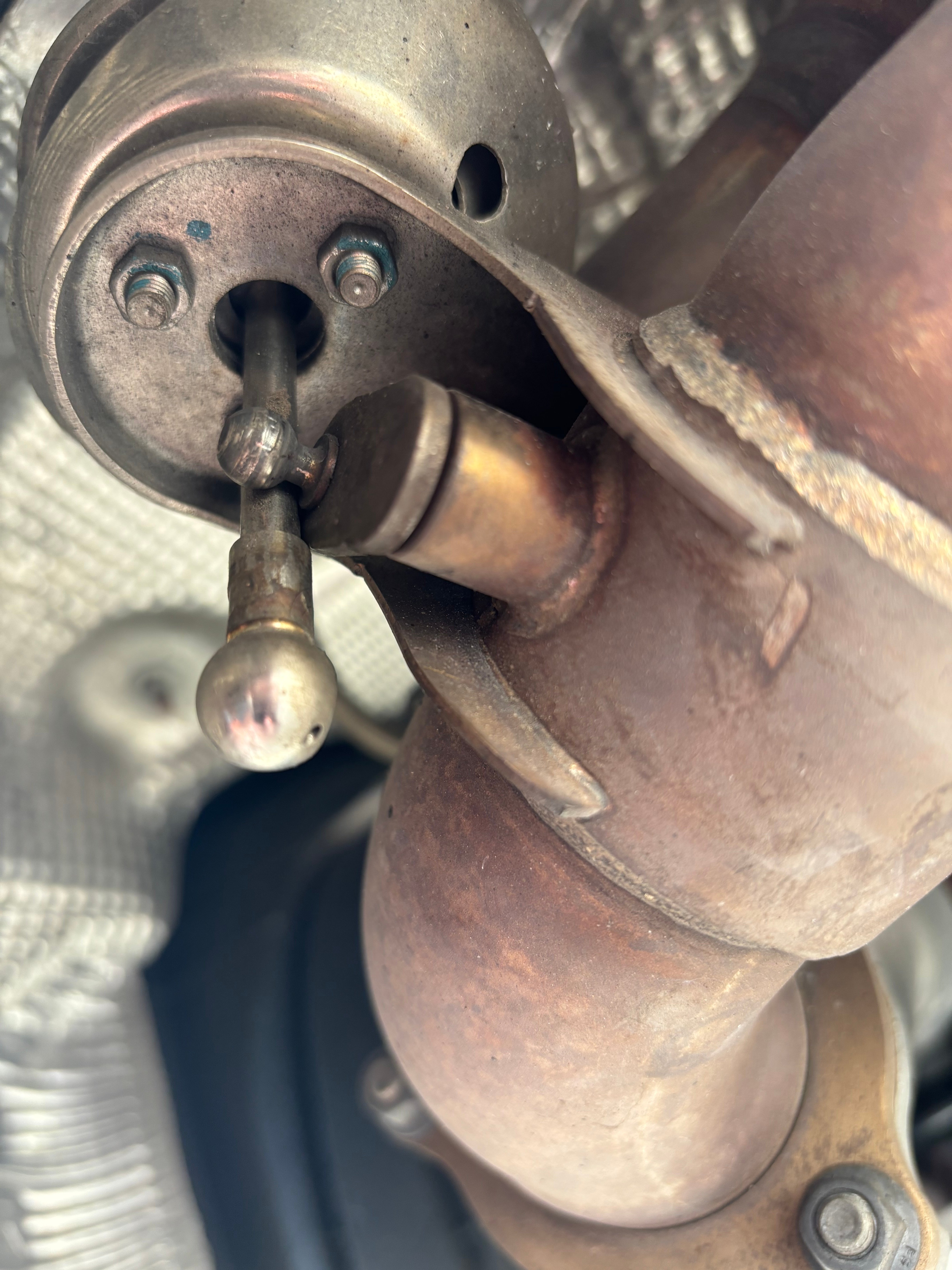

Solutions to disable PSE, not nearly as slick and sophisticated as Tom has shown.
Always Loud: unplug the vacuum line from the actuator and plug the end of the line with a golf tee or whatever you have around.
Always Quiet: hold the linkage closed with safety wire or like I did here:
Partial loud: google the "collar mod", essentially this limits the travel of the servo arm so that it cannot close all the way.

Here are the ones I bought....J-Dub wrote: Mon Mar 11, 2024 8:20 am Hey, great solution. I saw on a another forum people used a different style clip, it is a wire clip called a hairpin. I bought some and they broke as I was pressing them over the shaft. So I did the high temp ceramic brake parts grease. That helped but did not solve.
https://www.lowes.com/pd/Hillman-1-4-in-E-Clips/3050745
The tricky part is, just 1 won't work. You have to mess around with different sizes. I found that 2 clips, 3/8 inch, fit... I am going to try to find 1 really thin one, because there is the slightest play with 2 E-clips on it. If I can fit 1 thin one on and it moves freely, then perfect.
I am finding these are the best solution, as they stay on, and will never break. Just need to get the sizing right.
