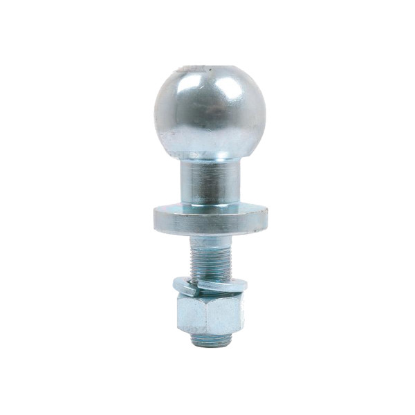

I have to fit a stud through a hole, but I believe the hole is bigger than M6, yet smaller than M8. This means a M7 stud would be my best bet, but I can't find this specific ball stud size it seems. Is it possible to fit a M6 bolt in the hole, even if it's bigger? My idea would be to use a washer on each side and a lock nut from behind.

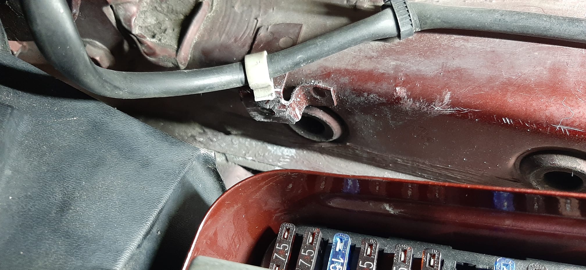

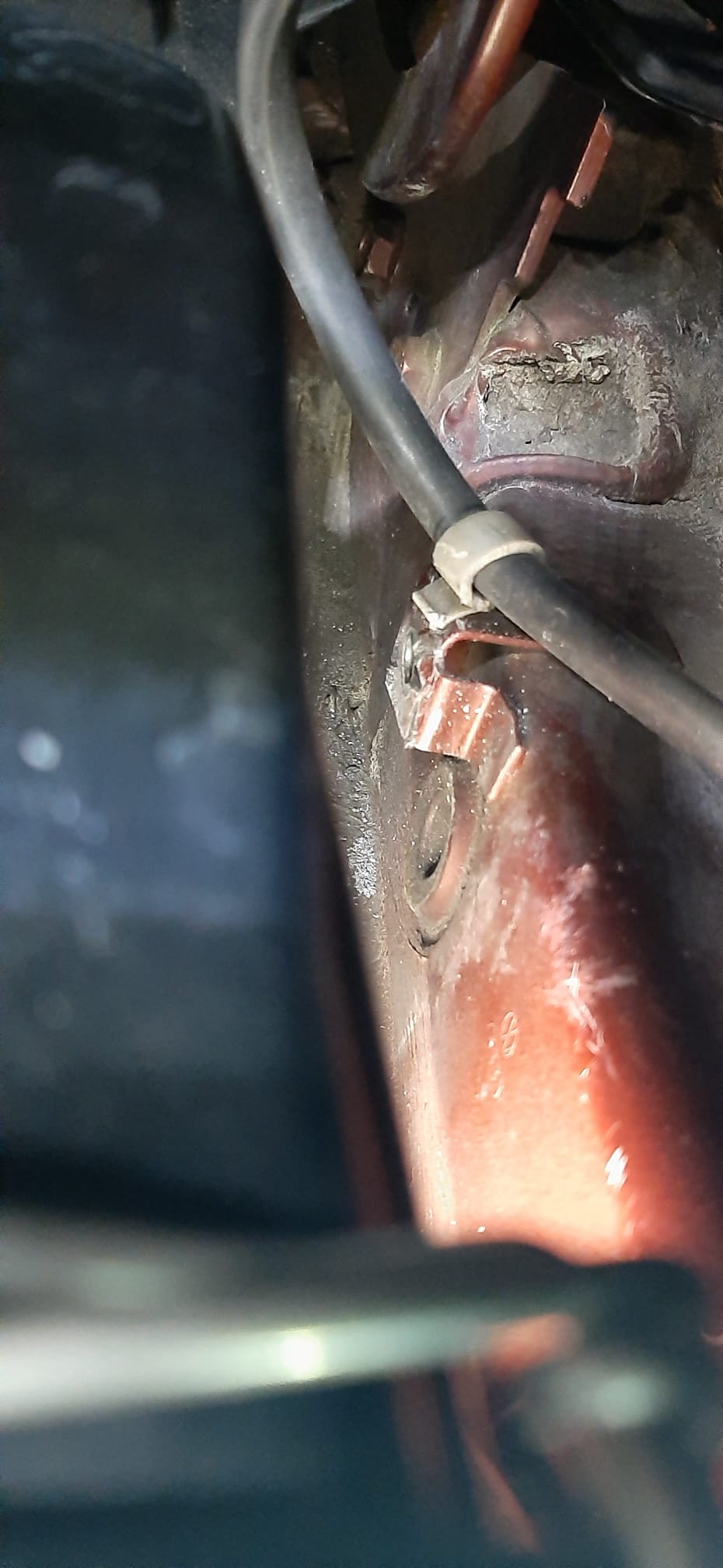

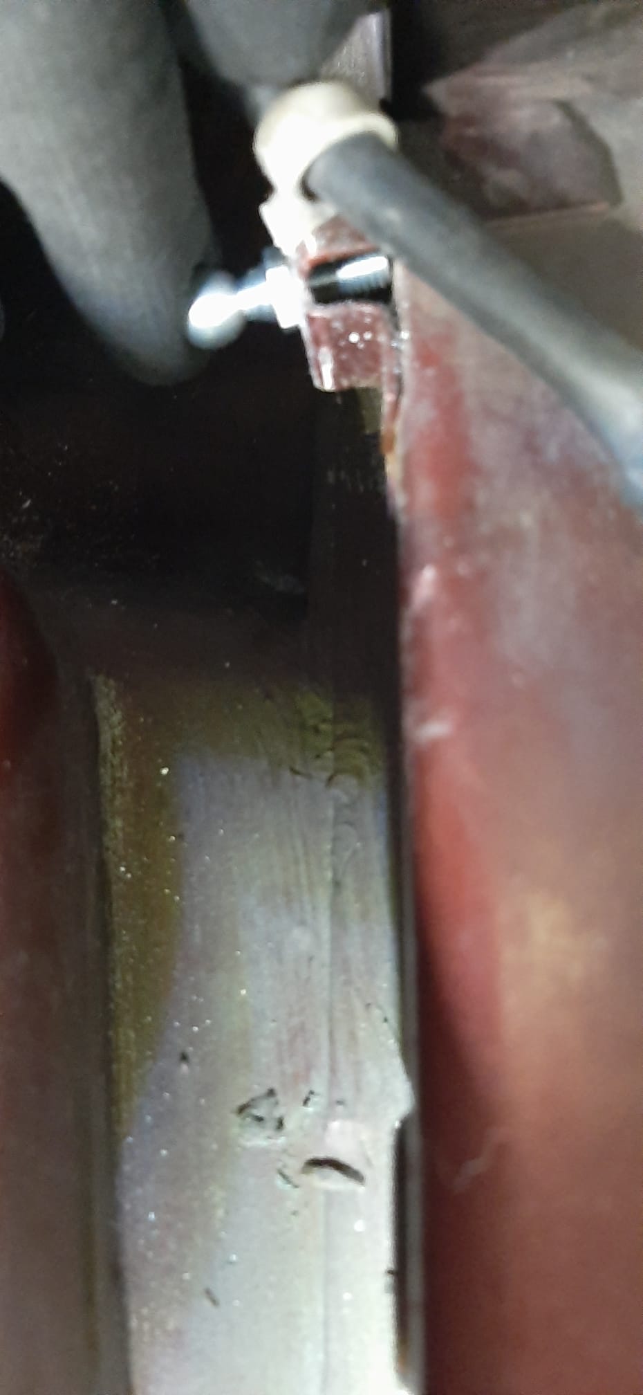

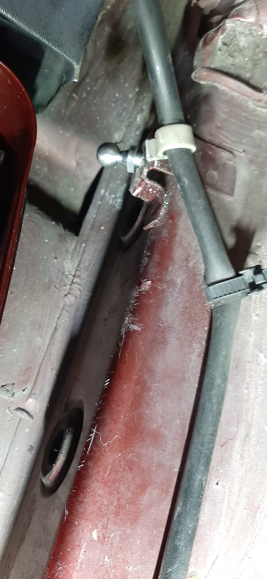

The ball mount was broken and the strut pushed it down. By removing it, I hope to replace the ball mount with a ball stud, using the original mount (sans ball) which is intact.
Here are some clarifying pictures. You can also see me trying to fit a M6 ball stud, which is a bit too small and thus sits crooked in the hole. My question is: should I add two washers (on each side of the original mount) and a lock nut, and will this be strong enough to keep the strut in place forever? Or should I try a M8 ball stud, again with washers and a lock nut - for which I may have to drill out the hole a bit.
Getting a nut on the stud will prove to be difficult too, but with a lot of cursing, I think it will be possible.

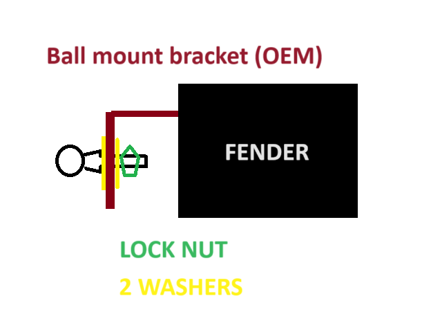

Drilling out the spot welds would be my last resort, and would be combined with replacing the whole mount with OEM parts.
A rivnut is indeed an option, one that I will definitely try when the stud and lock nut fails. I wanted to try this first because a rivnut would be weaker, although probably way easier to install.
This is a picture of how I want to approach it (M6 ball stud or M8).

Yes, that approach seems worth a try. I think I misunderstood your "crooked in the hole' comment above. I thought the hole was too small, which is why I suggested drilling it a little. If the hole is too big, then a couple of washers might hold everything in place. Hard to know how strong all of this will be but can't hurt to try. None of that will prevent you from popping off that little stanchion and welding on a replacement with ball from another car, which ultimately would be the best solution I'm sure.
