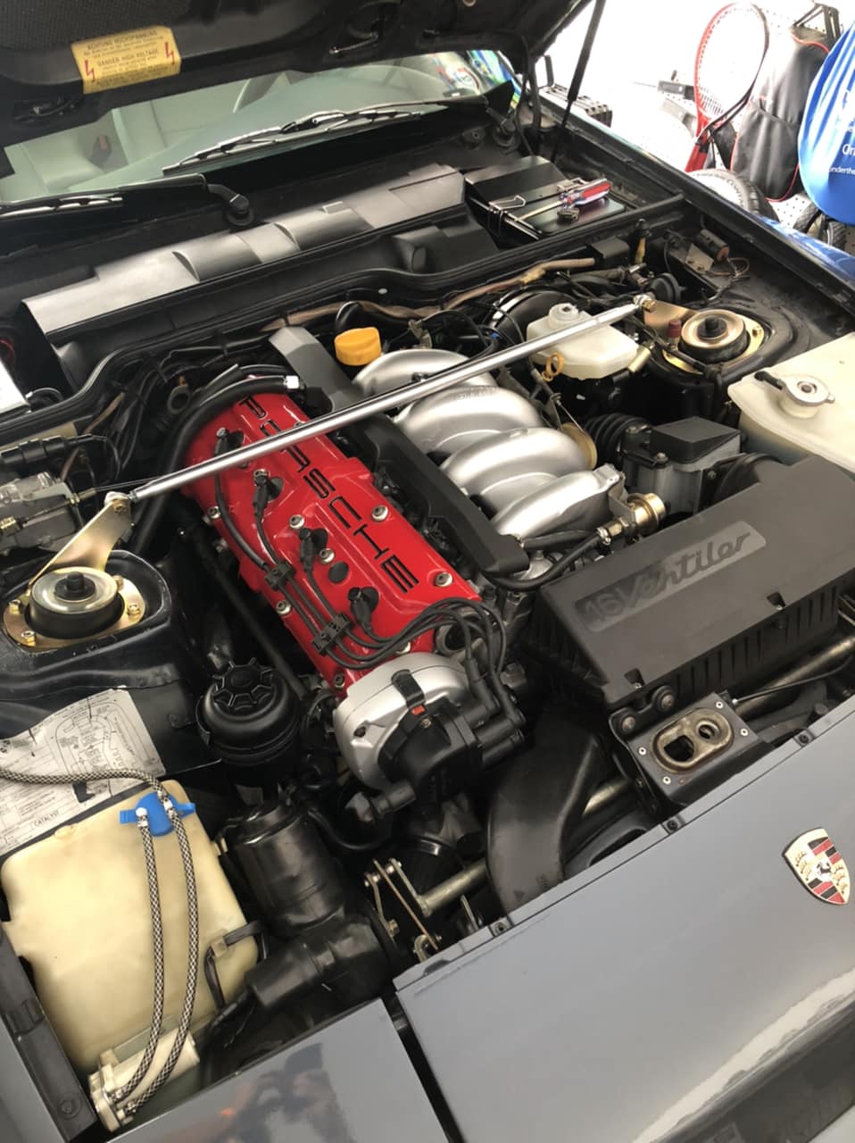

Hey Everyone! I thought it would be interesting to have a dedicated thread on the debated topic of swapping an S2 intake manifold onto an S. There are threads on other forums, FB, etc of people that have successfully completed this swap, but unfortunately, there are no hard numbers to support any HP gains.
I had gone through the process of collecting all parts and installing then on my 1987 944 S. Unfortunately, I couldn't get the car to run right, which I believe to be the result of an aftermarket TPS and ICV. Had I used Bosch parts, I'm confident the swap would have been successful. I ended up going back to the factory S intake manifold. Nevertheless, I'll share the information here for those that want to explore this option.

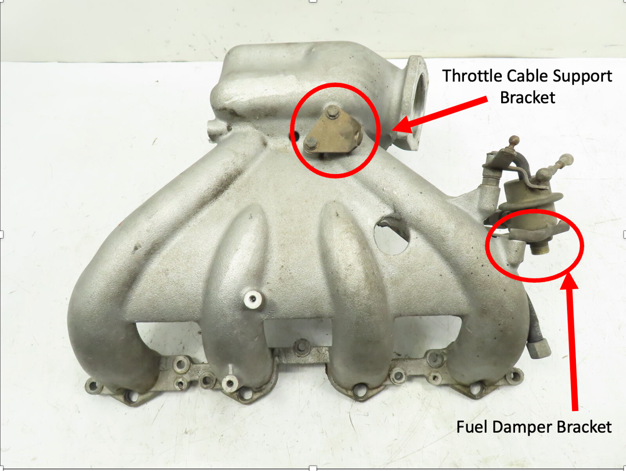

-S2 intake manifold with throttle cable linkage
**VERY IMPORTANT - make sure all brackets on the IM are included (throttle cable support, Fuel Damper support). If you are missing those, it's VERY difficult to find those parts as most are with another intake manifold and won't be sold separately - they are also NLA from Porsche
S2 IM Brackets.png (1.22 MiB) Viewed 2751 times

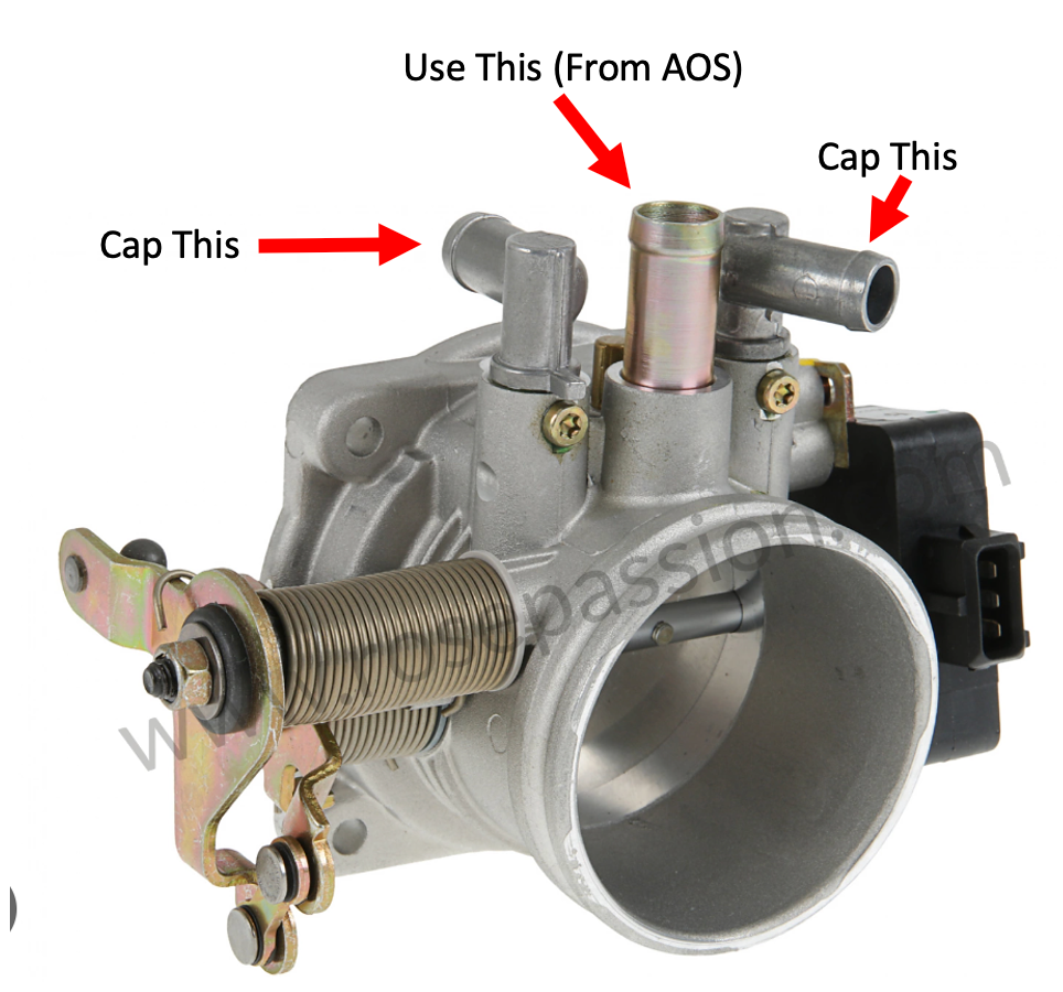

-S2 Throttle body

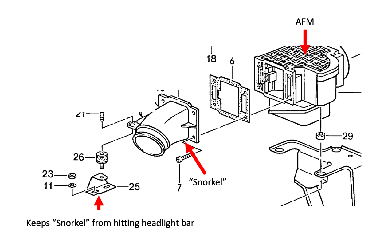

-S2 AFM "Snorkel" and gasket (Connects AFM to airbox under header panel)

Note 1: The S2 throttle body has coolant ports on the top - these can be capped off and aren't necessary.
S2 Throttle body.png (824.7 KiB) Viewed 2751 times

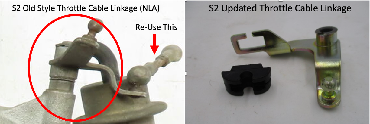

Note 4: Take note if your S2 intake manifold is from an 89, or 90/91. The throttle cable linkage was updated (I forget which year) The old version of the linkage is NLA, so you will need to purchase the new style (available online) if you buy a new throttle cable. This is not necessary if you buy the IM and throttle cable from the same car

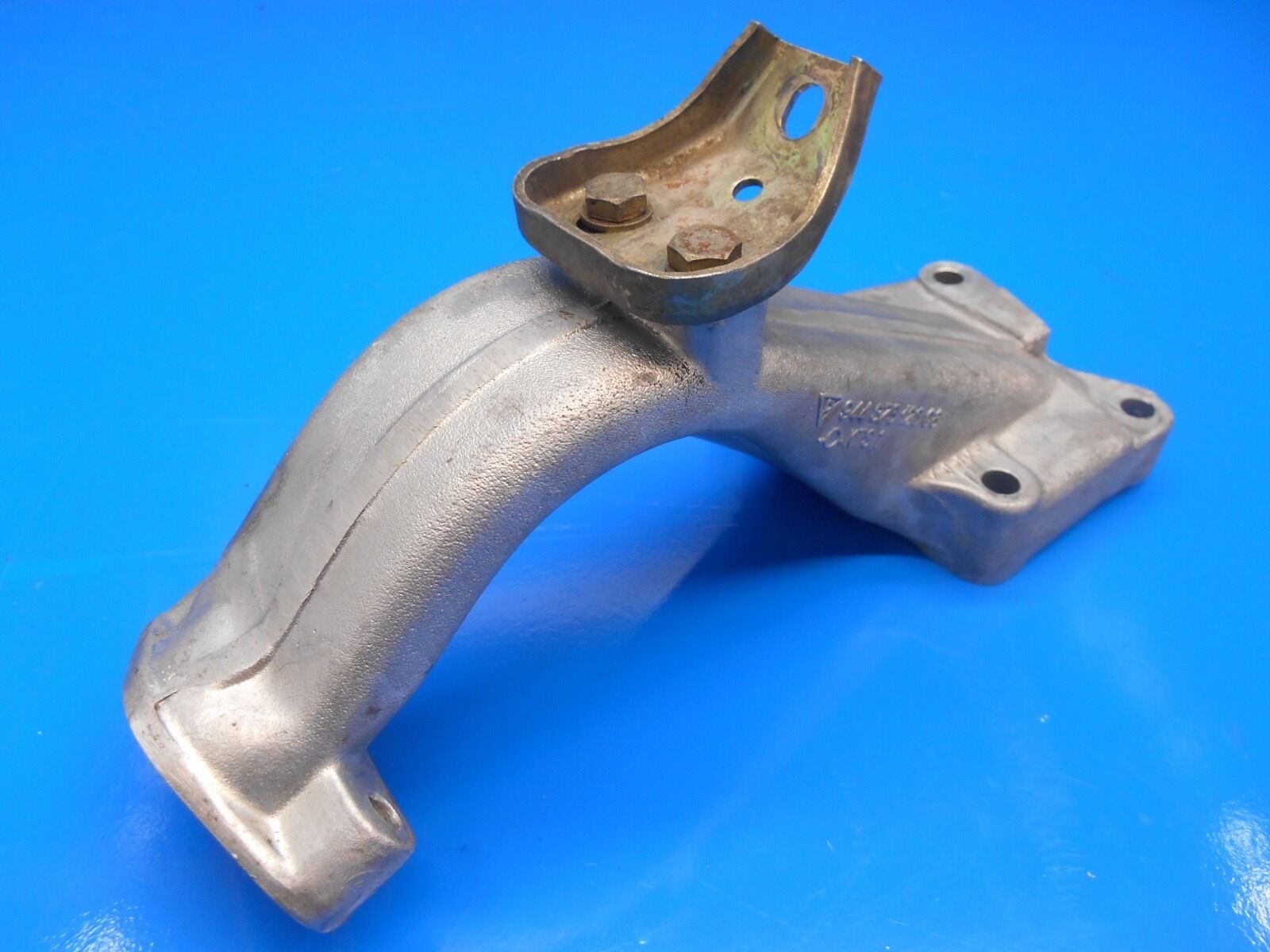

-S2 drivers side motor support arm - the S2 intake manifold is supported on the drivers side of the car by bolting to the arm. You could try to fab a bracket and drill/tap into your factory S arm if you are so inclined. Otherwise, it would only be supported by the allen bolts that mount to the head.
-S2 support bracket for the AFM "snorkel?" that keeps it from hitting the Headlight lifting bar.
S2 AFM Setup.png (192.73 KiB) Viewed 2751 times

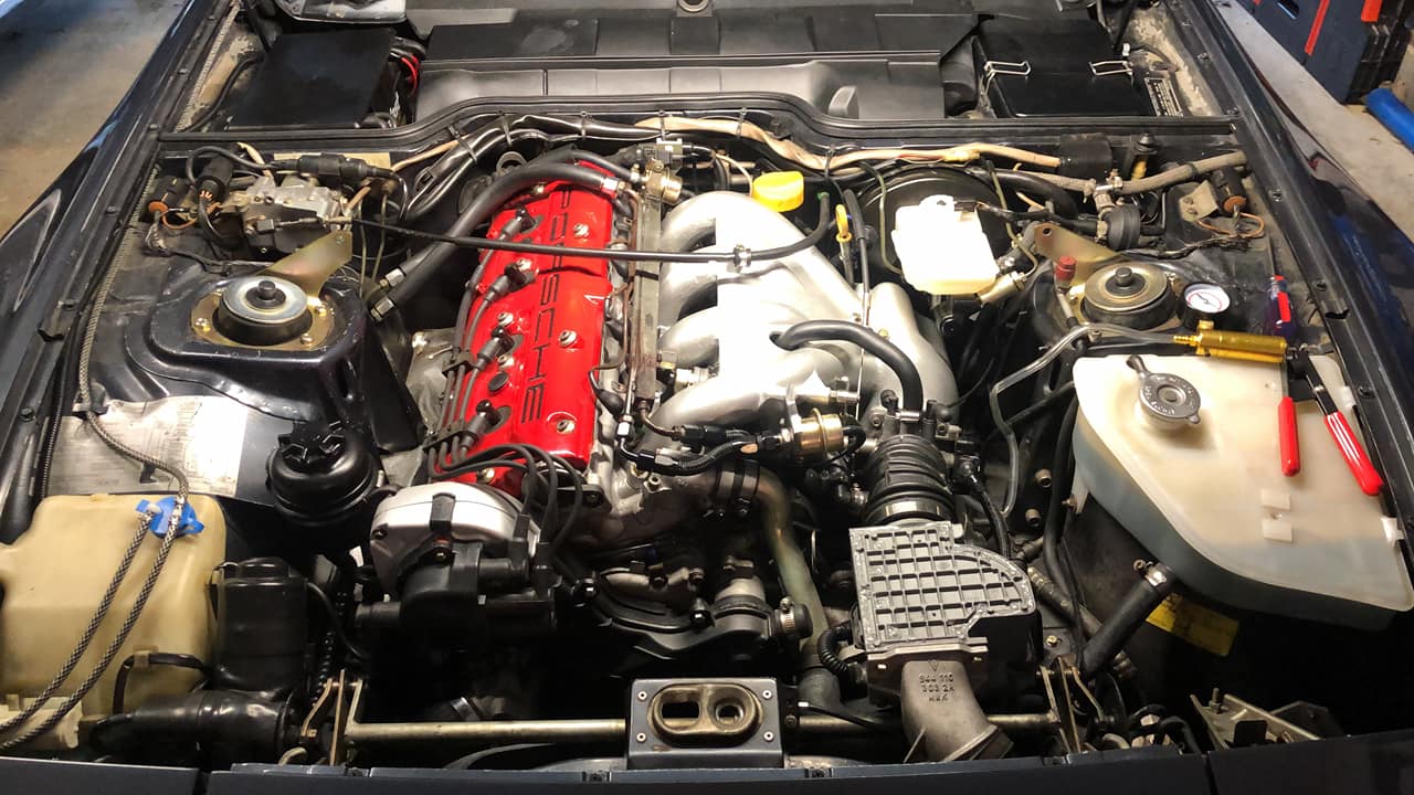

Before

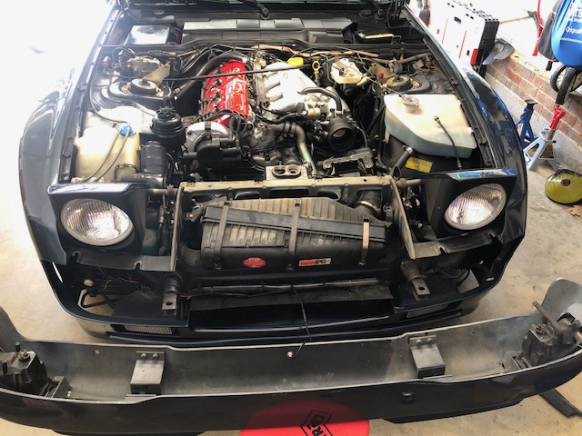

After

Does the S2 airbox really fit below the NA/S header panel?

Sure does! It’s about the same size as the intercooler on a 951.

Because the header panel is smaller on the NA/S I was never sure if either the 951 intercooler or S2 airbox would fit in there.

Good point - I didn't think of that. It was definitely a tight squeeze. Given the location, I would think an aftermarket cone filter would give better airflow anyway. Add a vented header panel and it should breathe pretty easy - sort of like a "Ram Air" effect, if it wasn't for the restrictive AFM.
