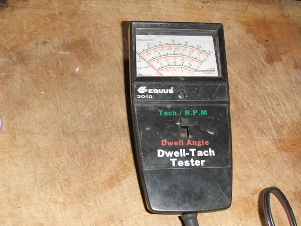

Most likely beats this old piece of **** I have just like the one below; when hooked to the coil, shows something under 700 rpm while tach is showing at least 900
To think I used take this instrument as gospel when adjusting the carbs on my old VWs
