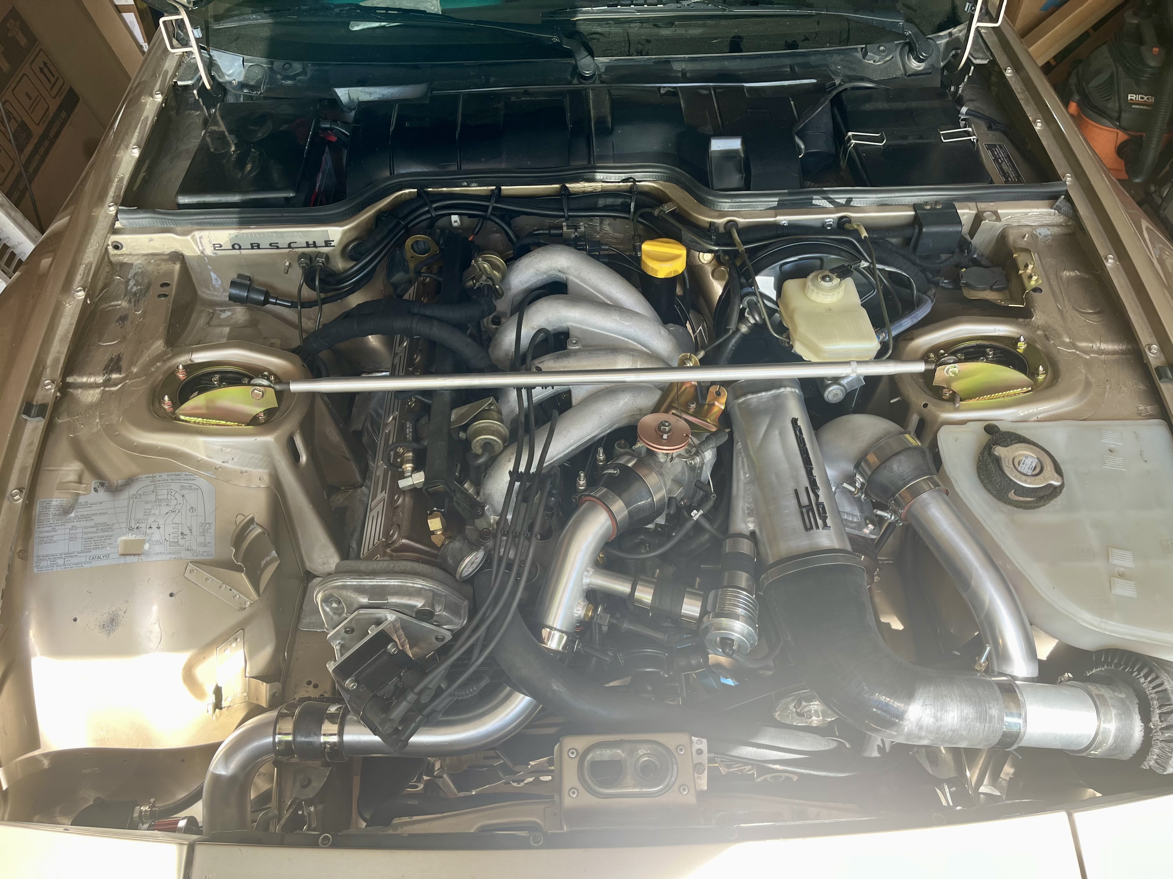

My goal was to go NO further than 250HP I haven’t had any Dyno Pulls yet, But I’m guessing that I’m around 225 to the wheels, I’ve upgraded the stock CV axle joints to take 400HP But as you mentioned it IS a project in motion EVERY day….. I’ll post some pictures when I get back from work….👍👍👏👏
