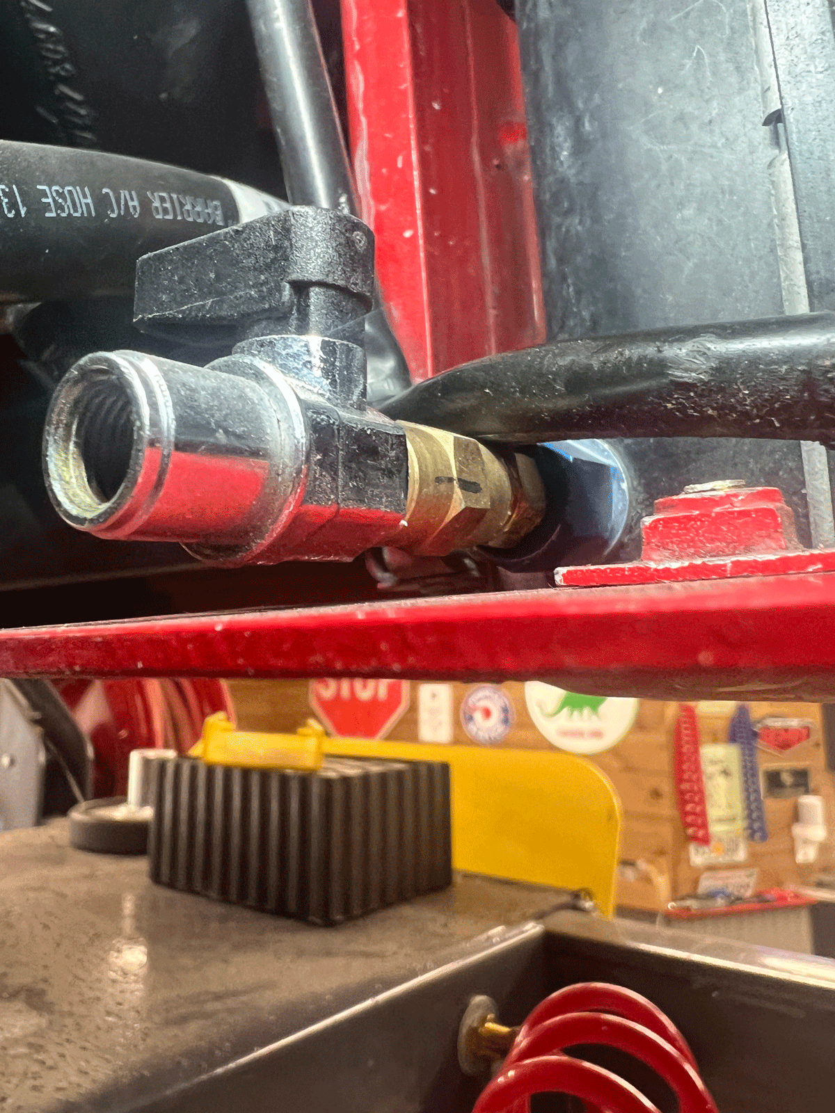

whalenlg wrote: Sat Jan 20, 2024 12:10 pm This Lindsey radiator drain hose has worked like a charm for me.
https://www.lindseyracing.com/LR/Parts/944RADDRAIN.html

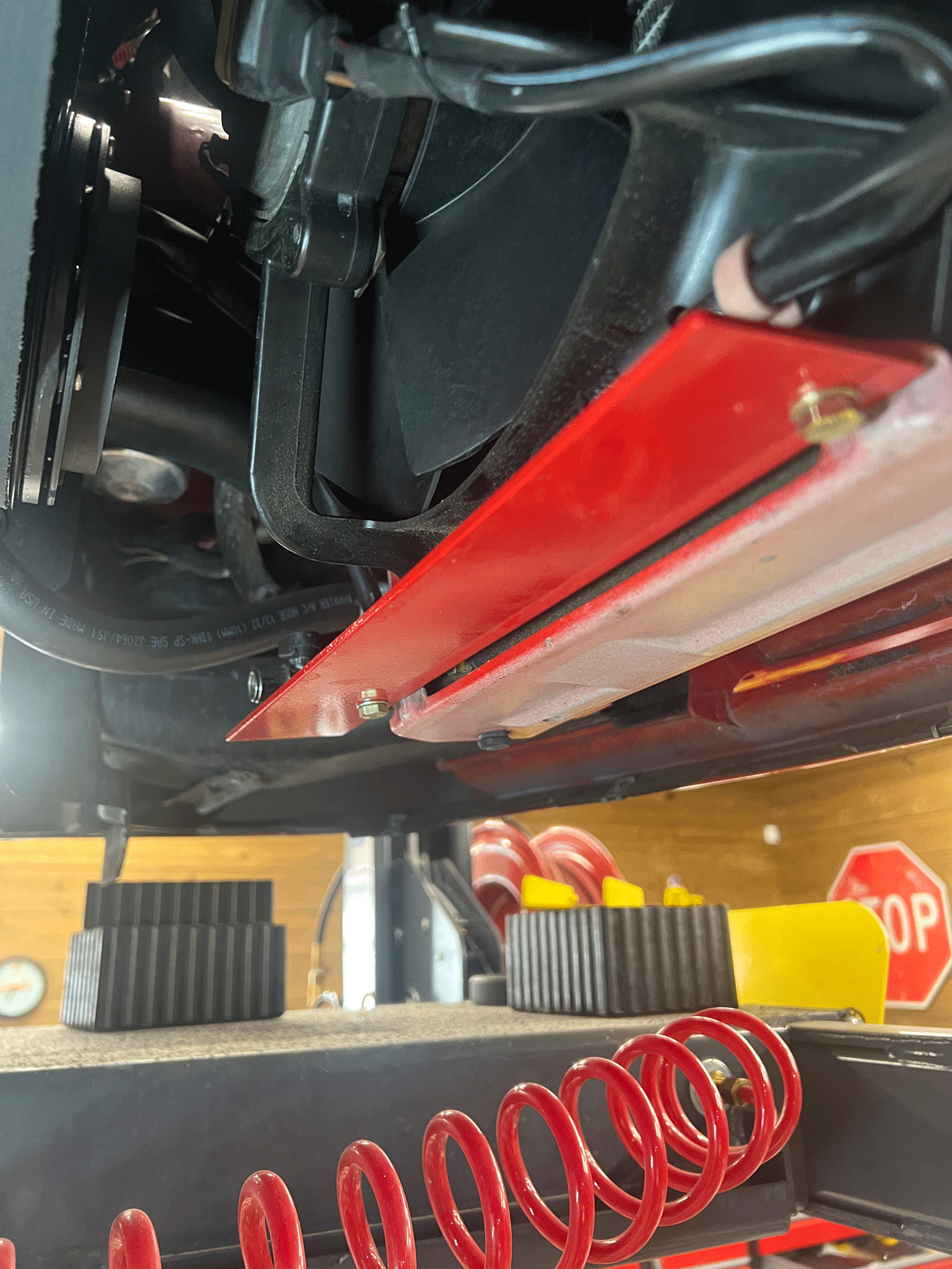

I did something similar, but wasn't thrilled about having the hose just sitting there. I ended up making my own two-part drain. The fitting and valve mount permanently to the radiator, and the hose screws on when I need to drain it. I added a little skid plate under it out of an abundance of caution. :)

Tom wrote: Sat Jan 20, 2024 12:28 pm
Hey Tom; Would you mind providing the details of what all the adapters are in your radiator drain assemblage. I can never figure plumbing size conventions and terminology for things like this... TIA! Luis
