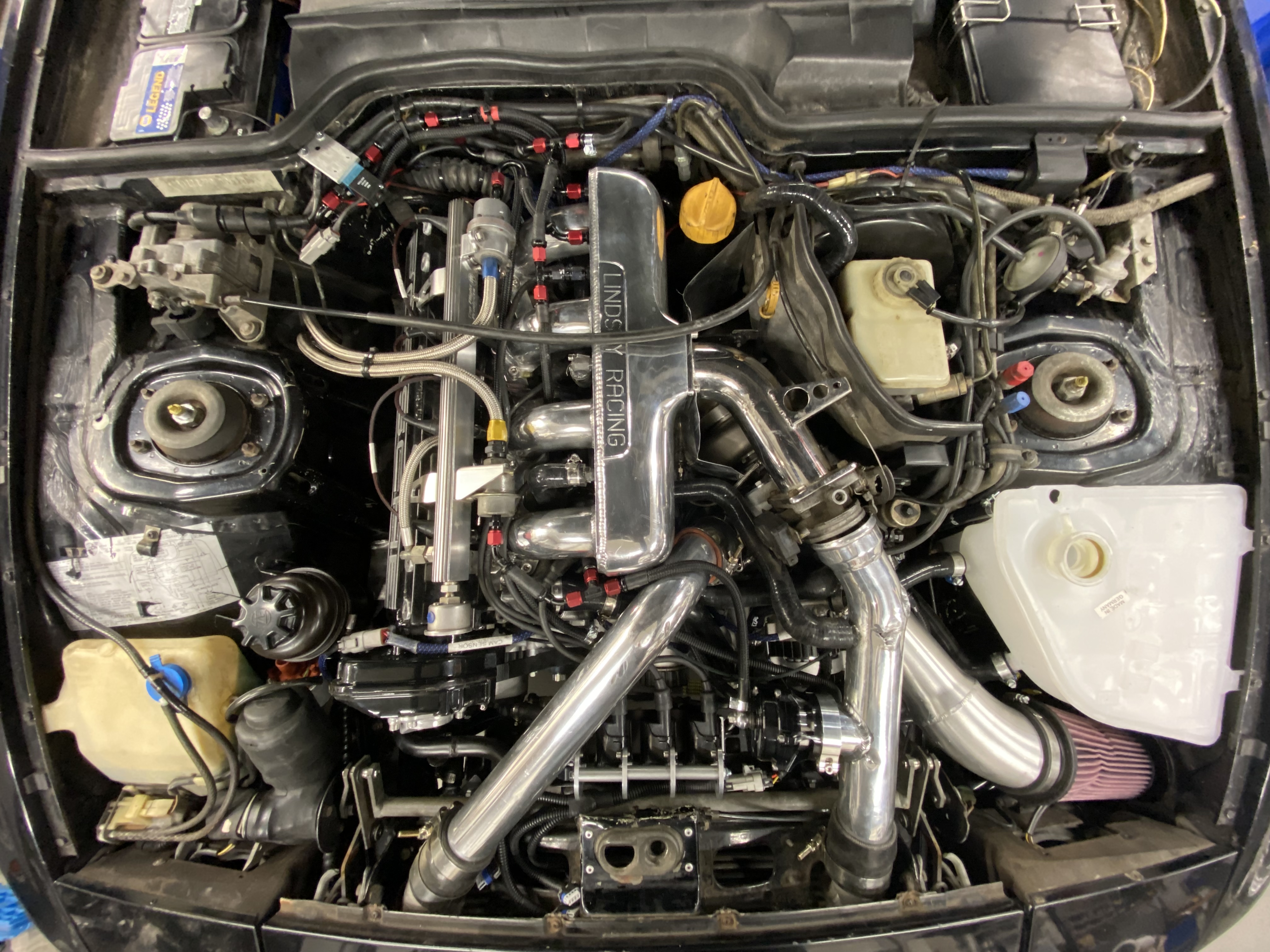

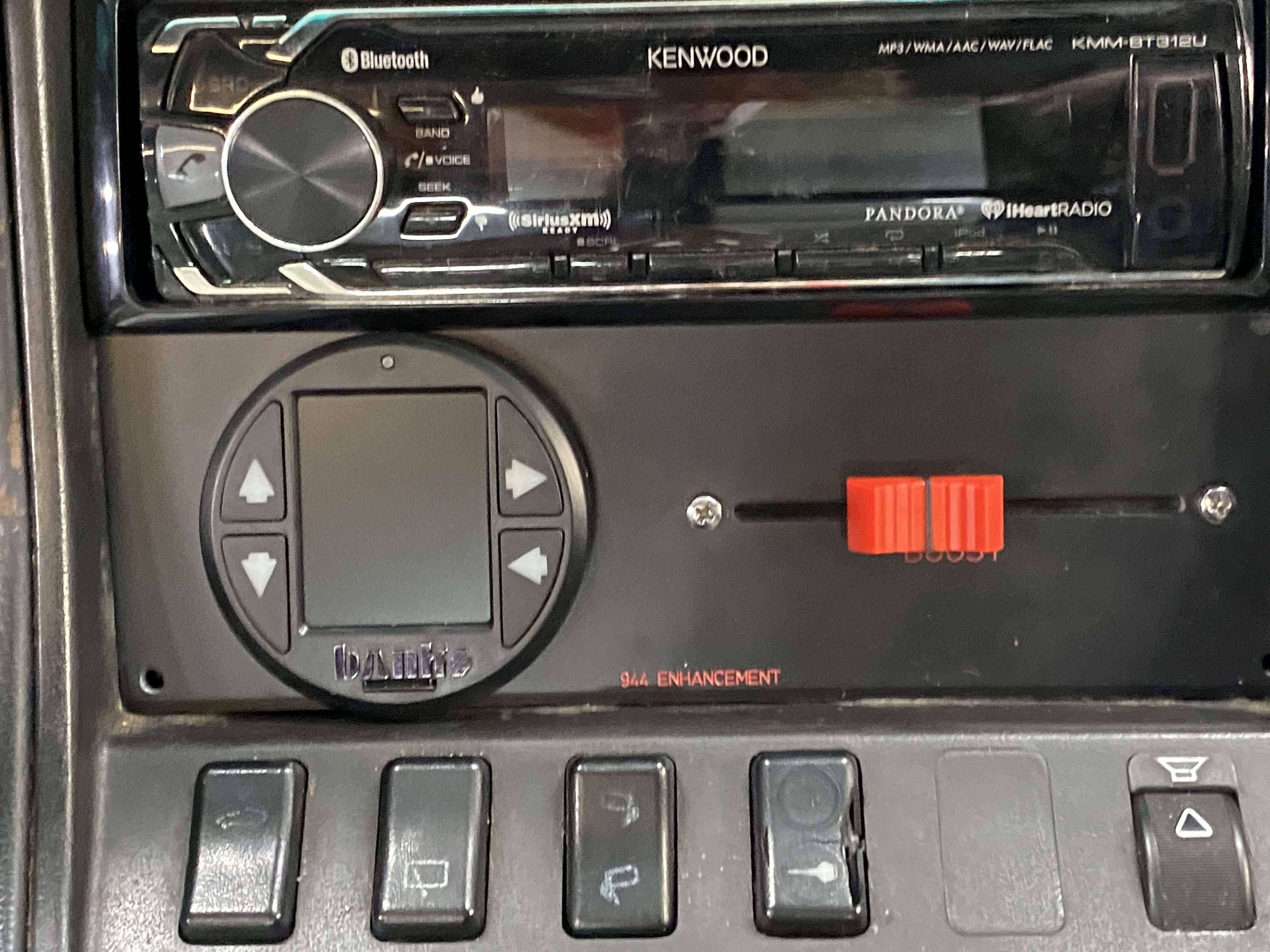

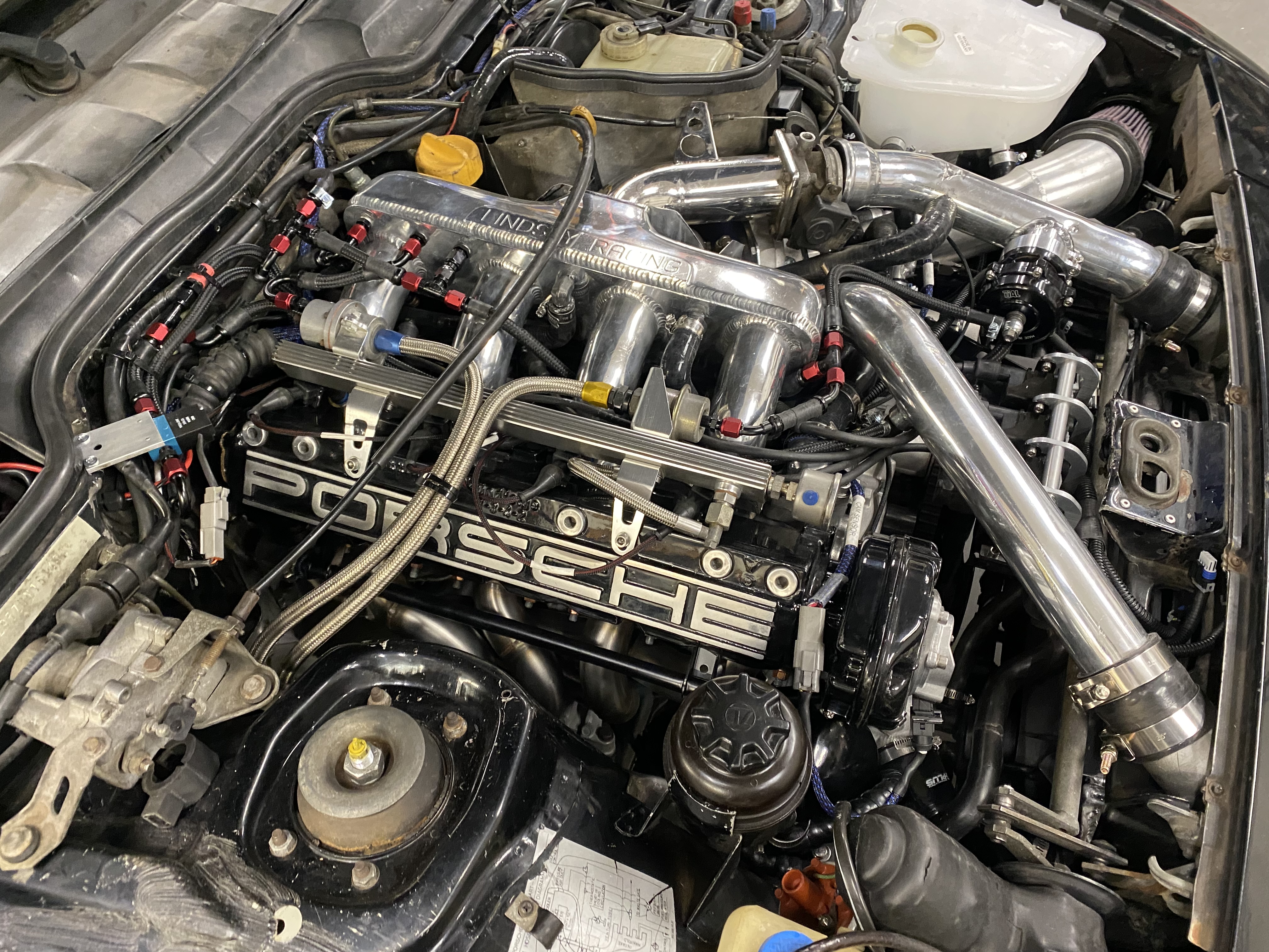

3.0 engine, nikasil with Mahle custom pistons, nice rods and fancy internals. Garret gtx series 2 turbo, 4 into 1 headers, link ecu, a bunch of Tial stuff and lots of plumbing. Trying a new boost control set up, seems like more fun than a round knob!

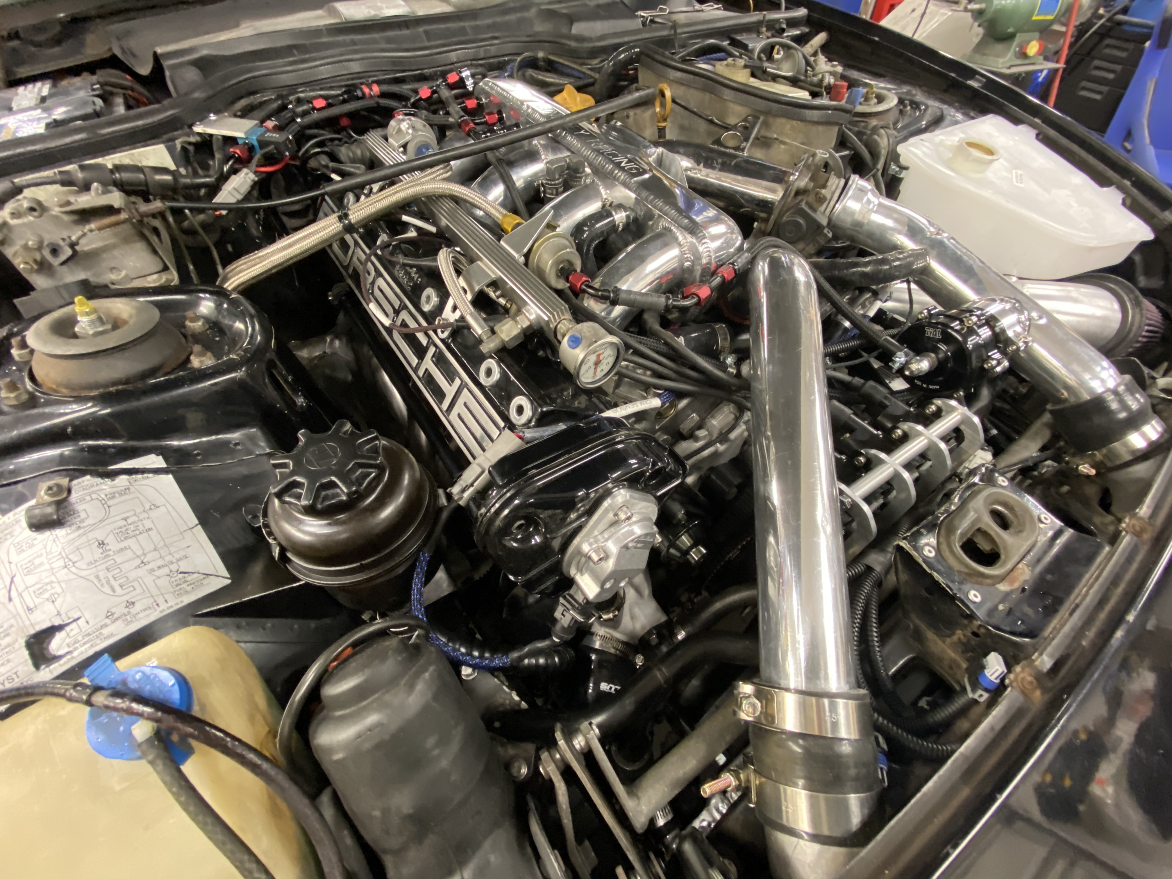

@chris white Tell me more about the cam sync adapter and the intake pipe.

AudiSport wrote: Mon Nov 01, 2021 7:45 am @chris white Tell me more about the cam sync adapter and the intake pipe.
Intake pipe came with the car, needs a little repair!
The cam sensor is an Audi unit with my own adapter plate and trigger wheel. Hall effect and looks pretty cool.
I wasn’t a huge fan of the Lindsey manifold (owner already had it) but after working with it the access to stuff around the turbo is really nice

chris white wrote: Mon Nov 01, 2021 8:19 am
Do you sell those adapters and do you have a crank trigger or using flywheel? I'll need to get this figured out soon.

Yes, I also have a front mount 60-2 crank trigger wheel, sensor bracket and sensor (hall effect) that I have been making for quite a while. works great, easy to get to.
shoot me an email ([email protected]) or call to discuss 315-636-8716

Wish I would have known about that cam synch kit when I was assembling my standalone system. That's a very clean, nice looking solution. I like that it uses an OEM sensor too.

The cam sensor orientation is interesting.

Darwin wrote: Mon Nov 01, 2021 3:34 pm The cam sensor orientation is interesting.
it will go 180 degrees if you want it. I just felt like pointing the wires down this time!
