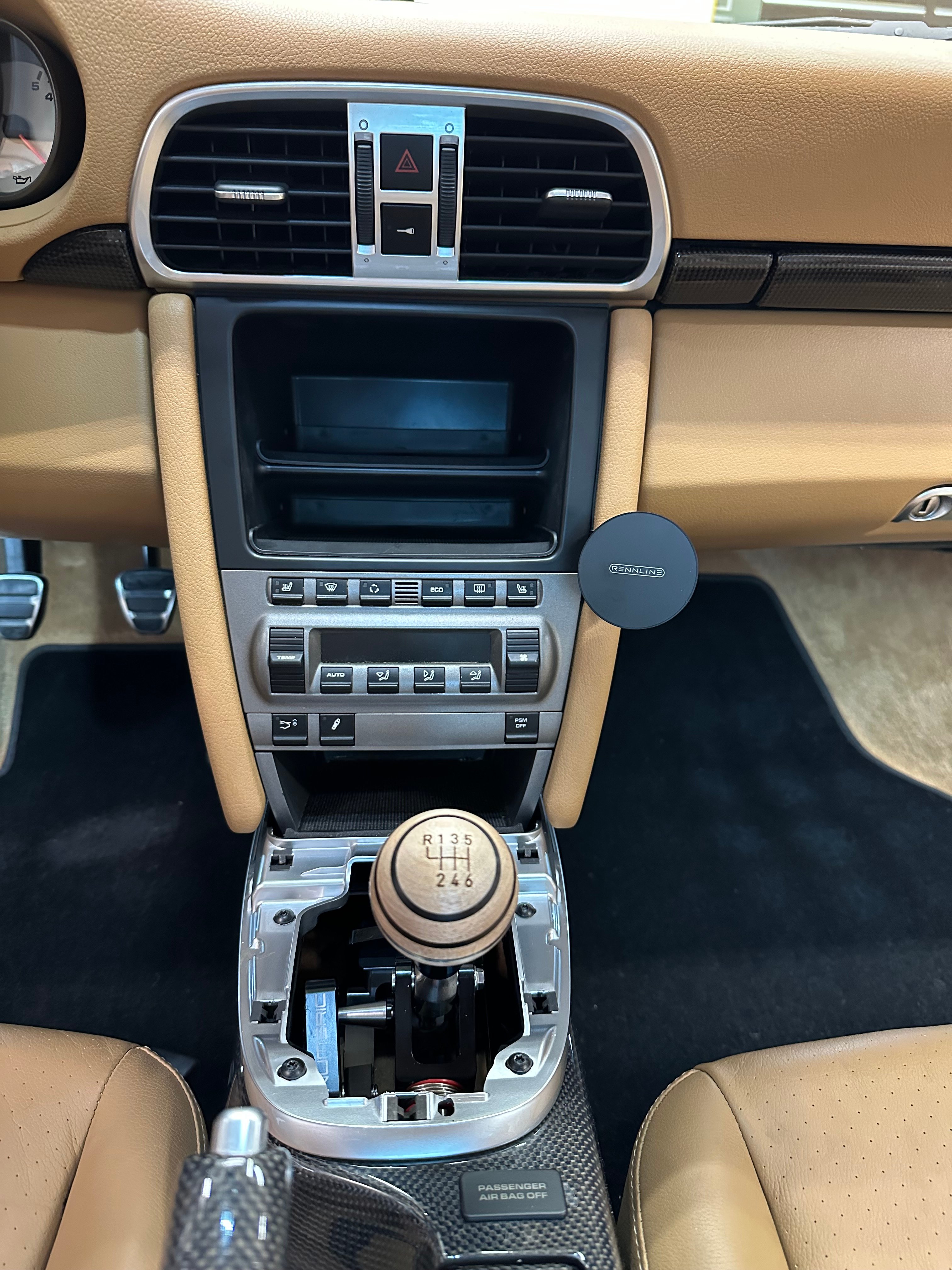

Maruscmn
Posts: 144
Has thanked: 246 times
Been thanked: 88 times
So far very happy with the shifter assembly alone! Added all the trim I want for now. Climate control in black en route. Need to code out the PCM. Love the new feel! Next up is test fitting surrounds....
