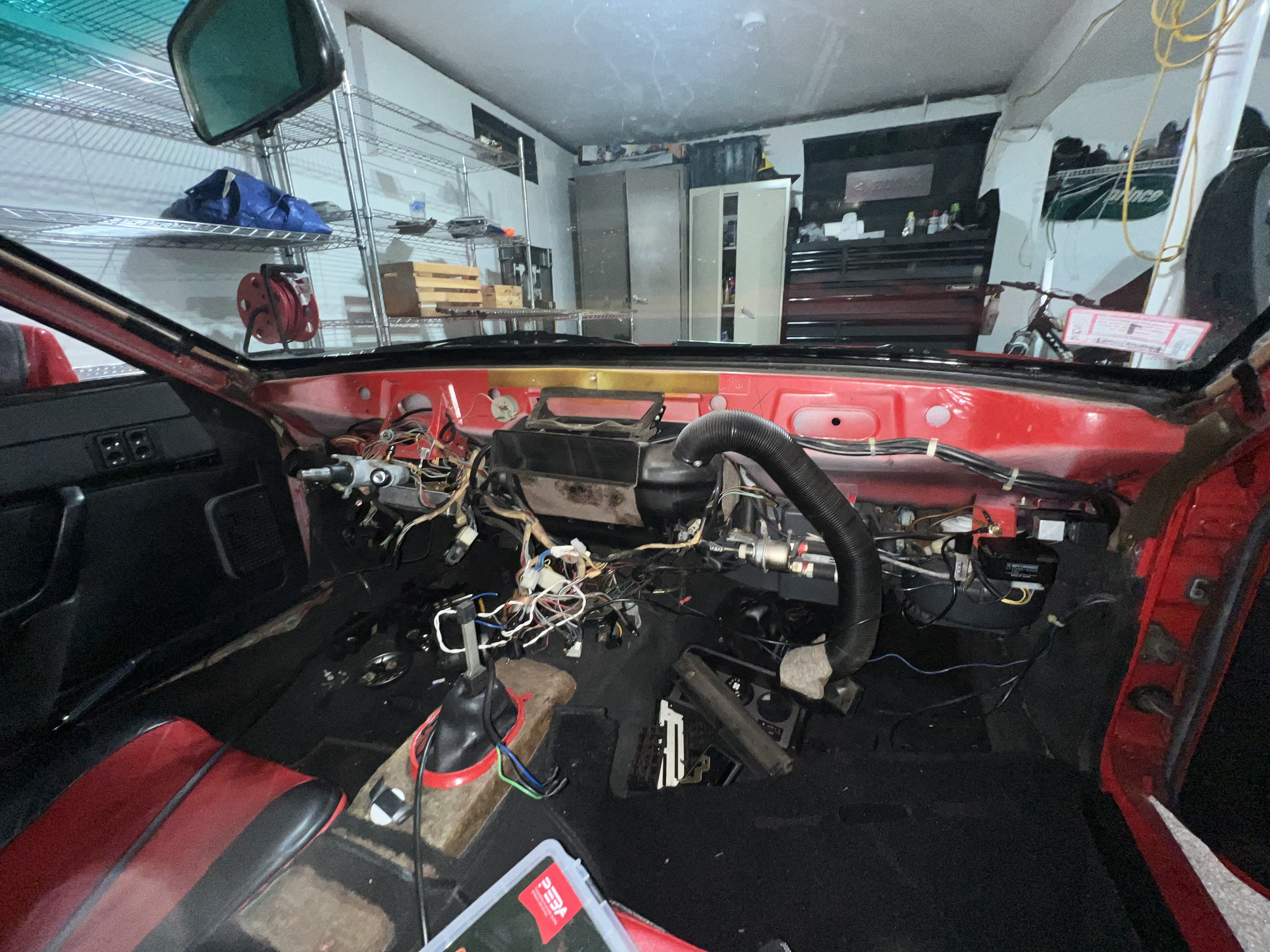

step 1: To start Remove the dash
Interior without dash.jpg (2.03 MiB) Viewed 1034 times

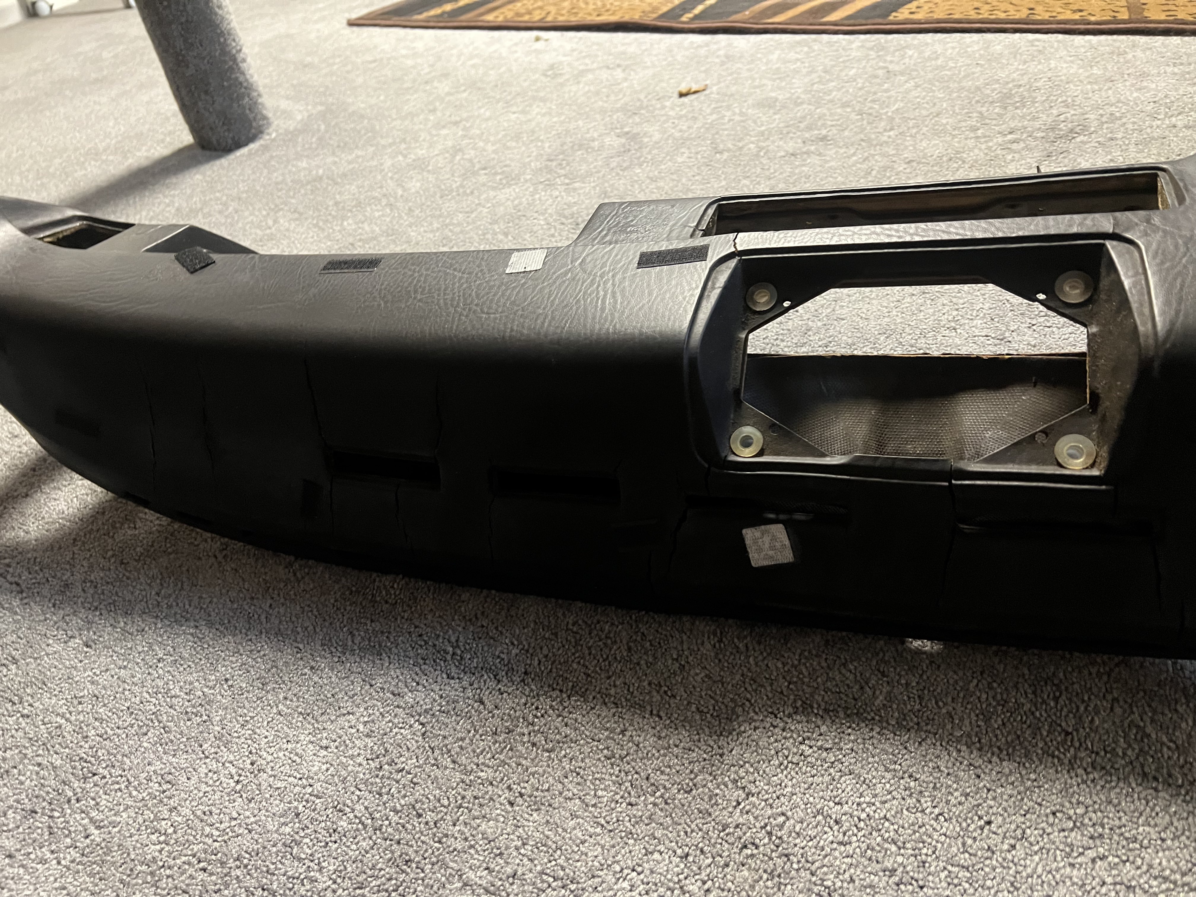

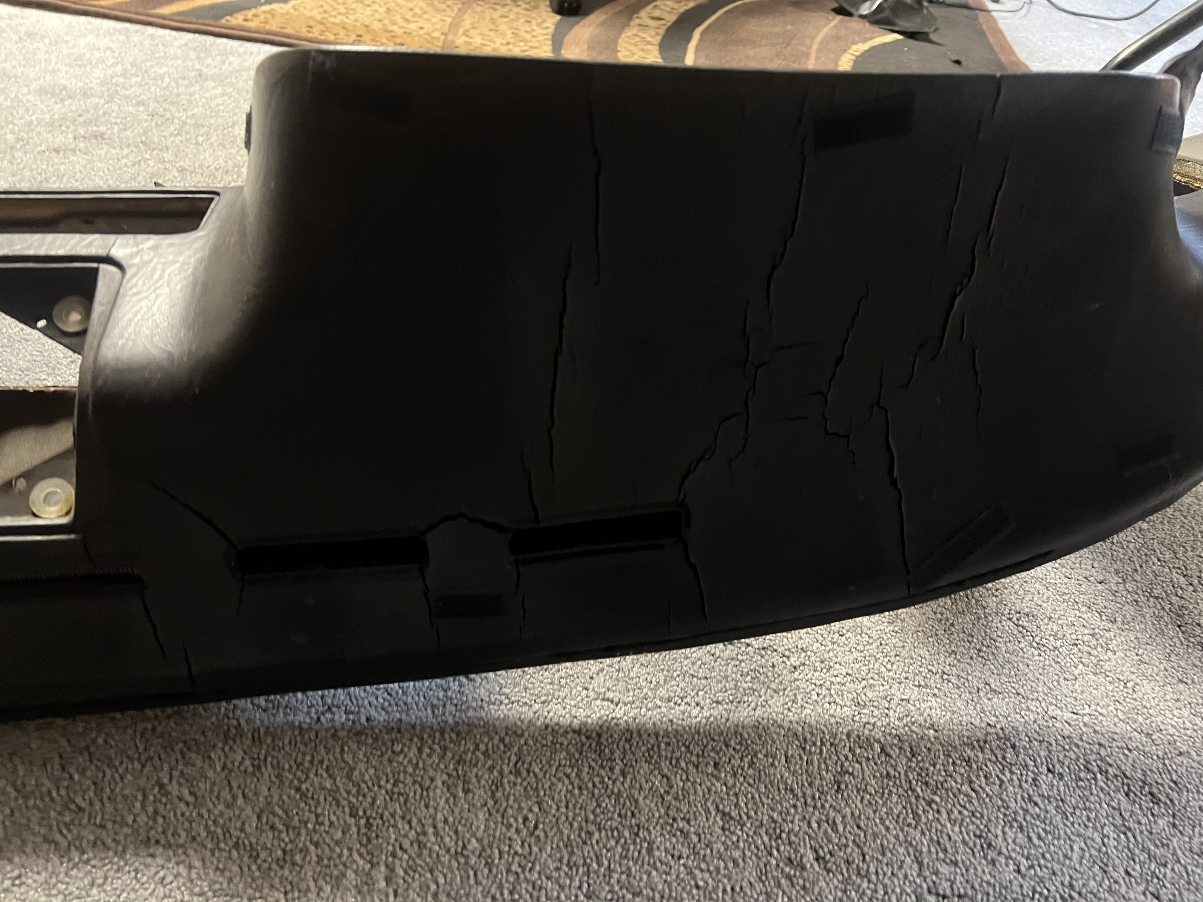

Step 2: Look at your current state of dash and take photos, more then me cause i didn't take enough
dash cracks2.jpg (1.5 MiB) Viewed 1034 times
Dash cracks.jpg (1.94 MiB) Viewed 1034 times

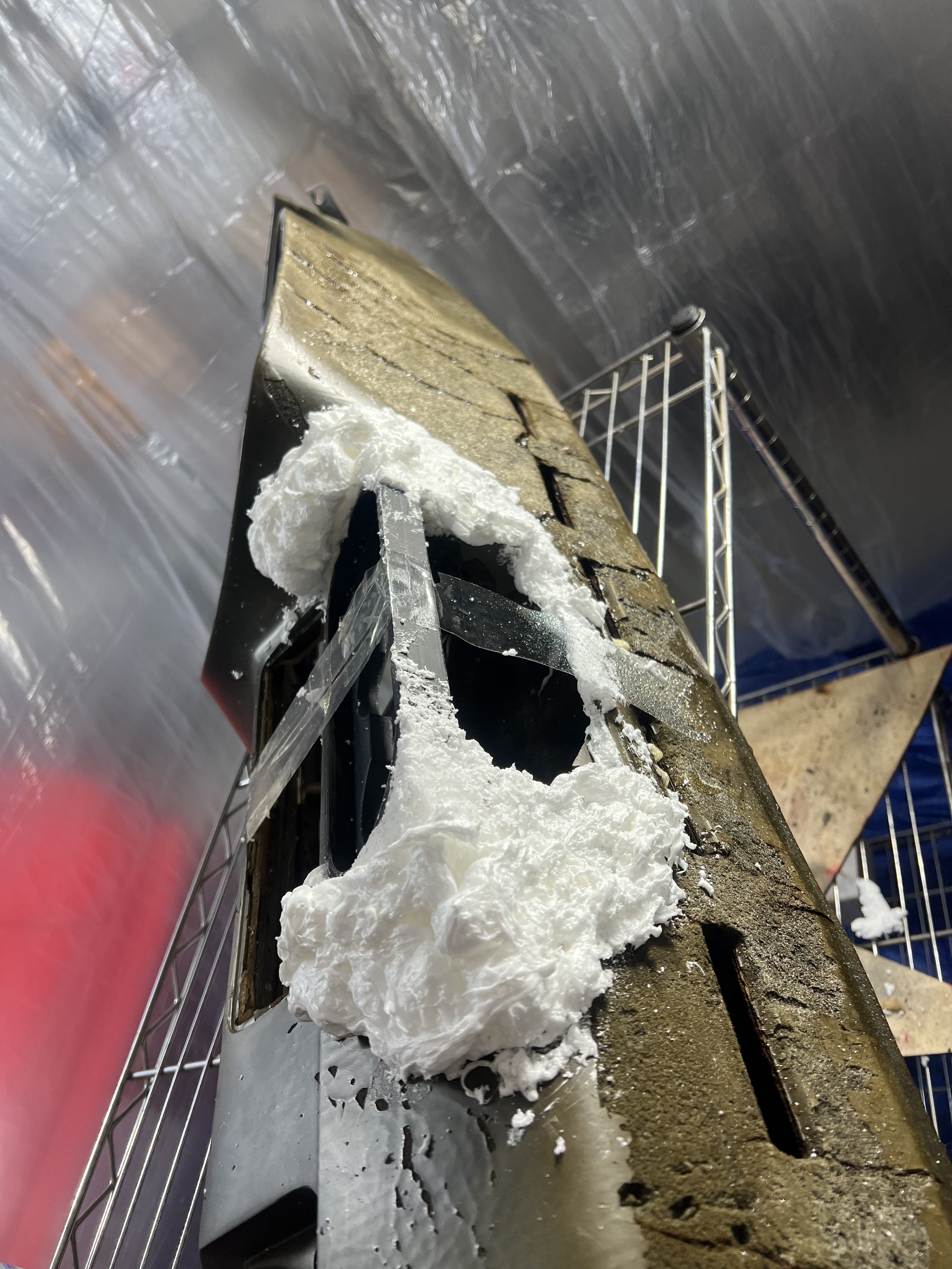

Step 3: (Mileage may vary on severity and what you are choosing to recover dash in, I choose to flock it.) Remove Old vinyl carefully. My dash was a mini mountain range and I knew I would have to fill and sand so Plain foam to add filler to was a better option.
Step 4: The Crack repair part, All cracks need to be widen and dug out so the glue can fill and adhere. What glue might You ask? Gorilla glue the original. The foam on the dash i assume is urethane and the glue is the same and it expands to fill cracks. It also sands really nice and is really strong once dried.

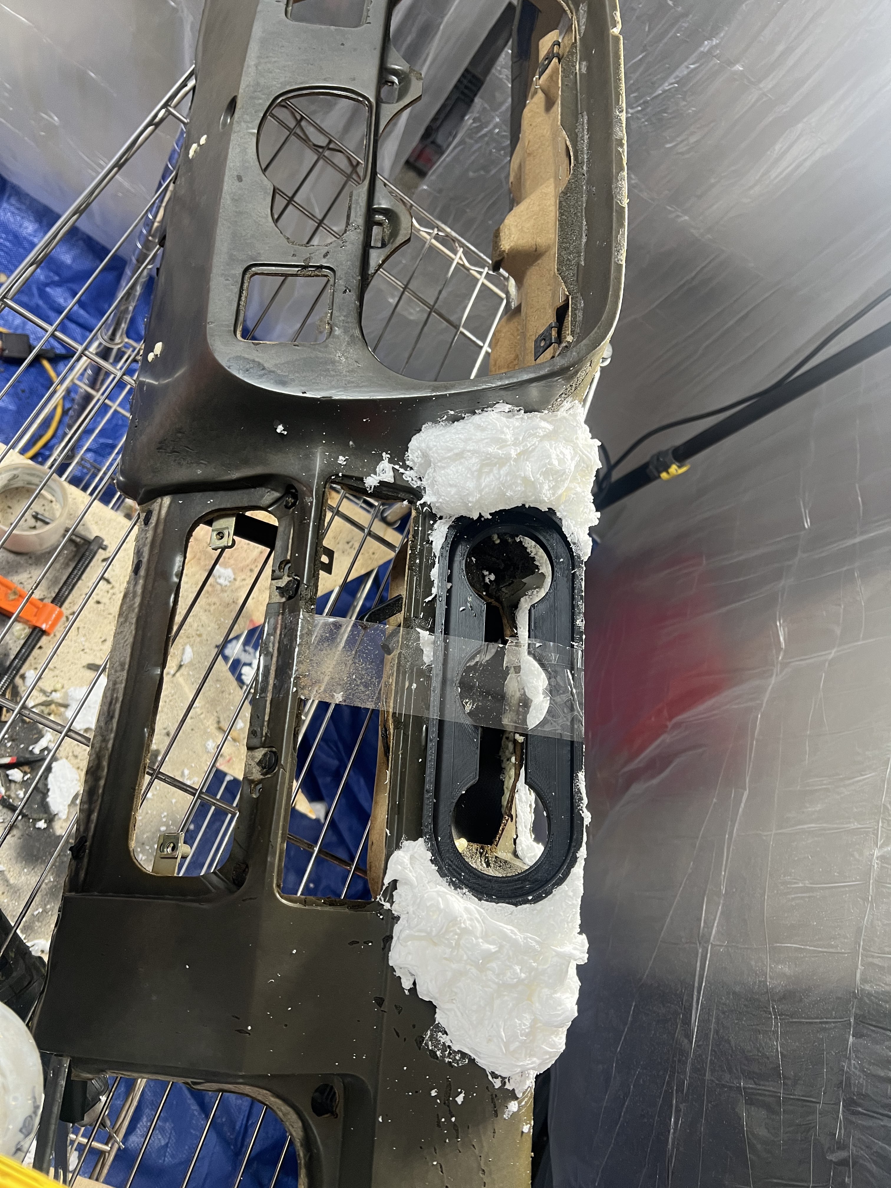

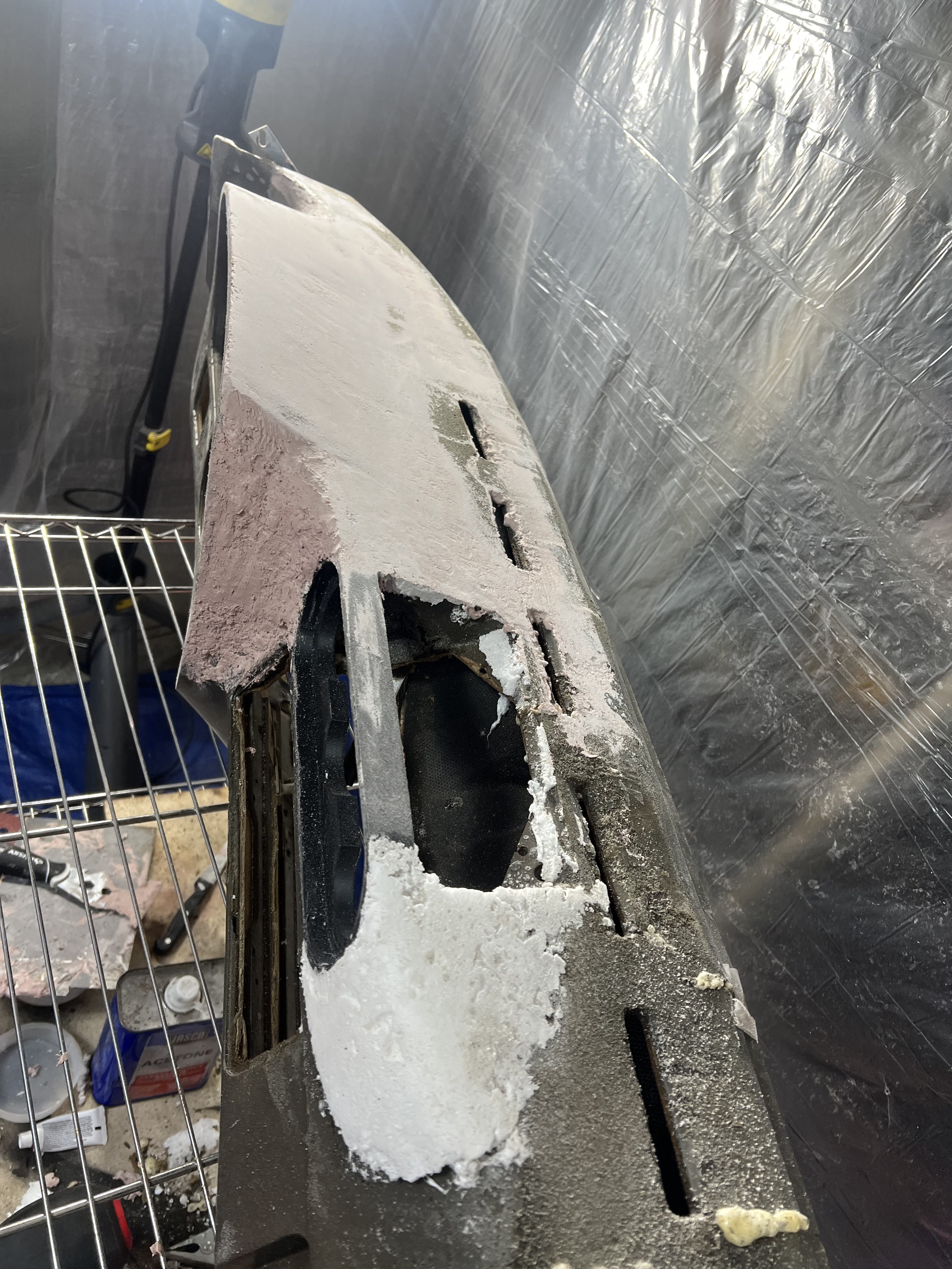

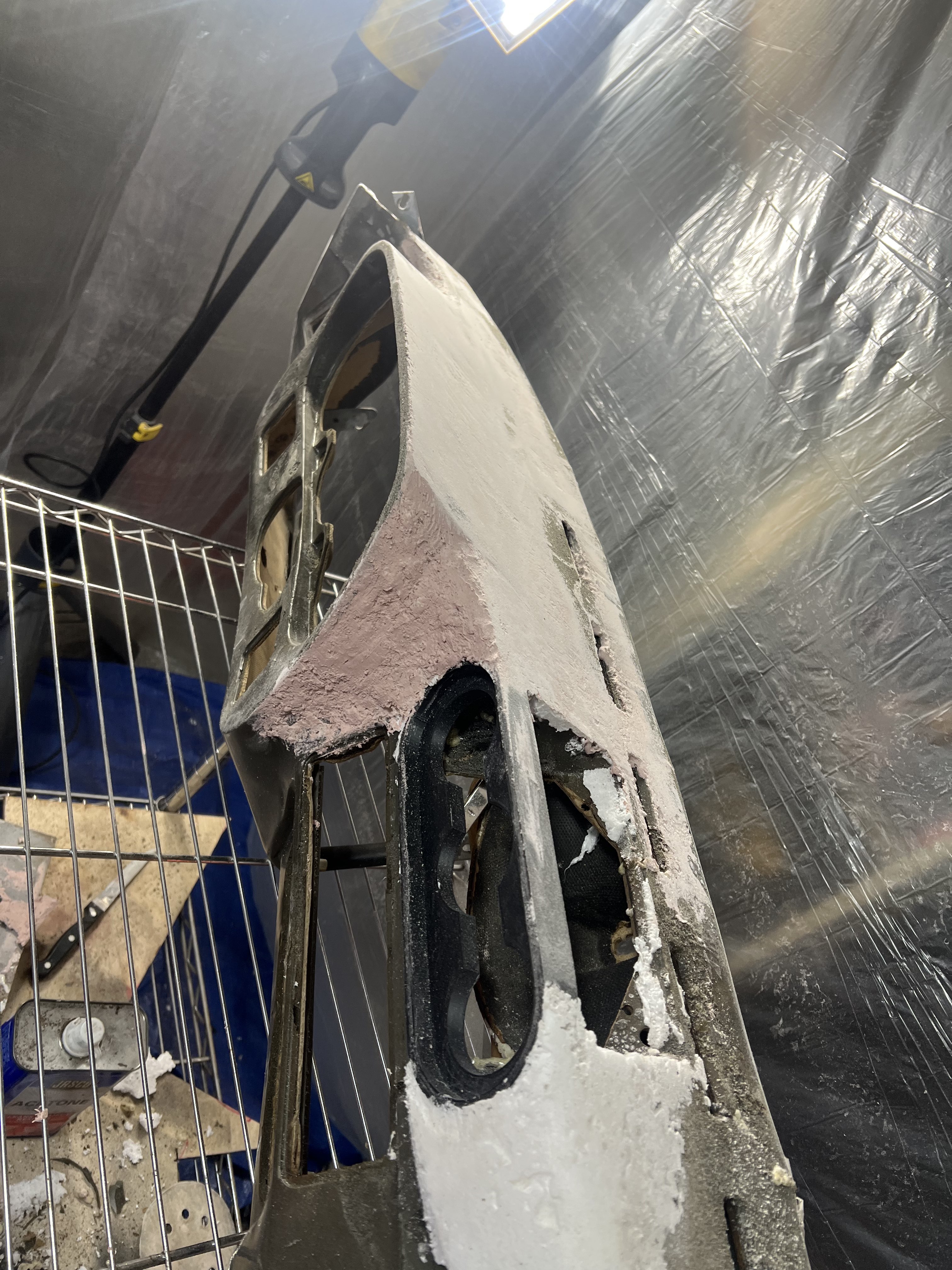

Step 4.5 (optional) I wanted to add 3 52mm gauges where the center speaker was. Didnt have a center speaker to begin with :lol: . I 3d Printed the holder in ABS then used some expanding foam to fill gaps. In this step getting the general shape is the goal, dont worry to much smoothness, we will fix that soon.
Dash with foam 2.jpg (2.15 MiB) Viewed 1034 times
Dash with foam.jpg (1.73 MiB) Viewed 1034 times

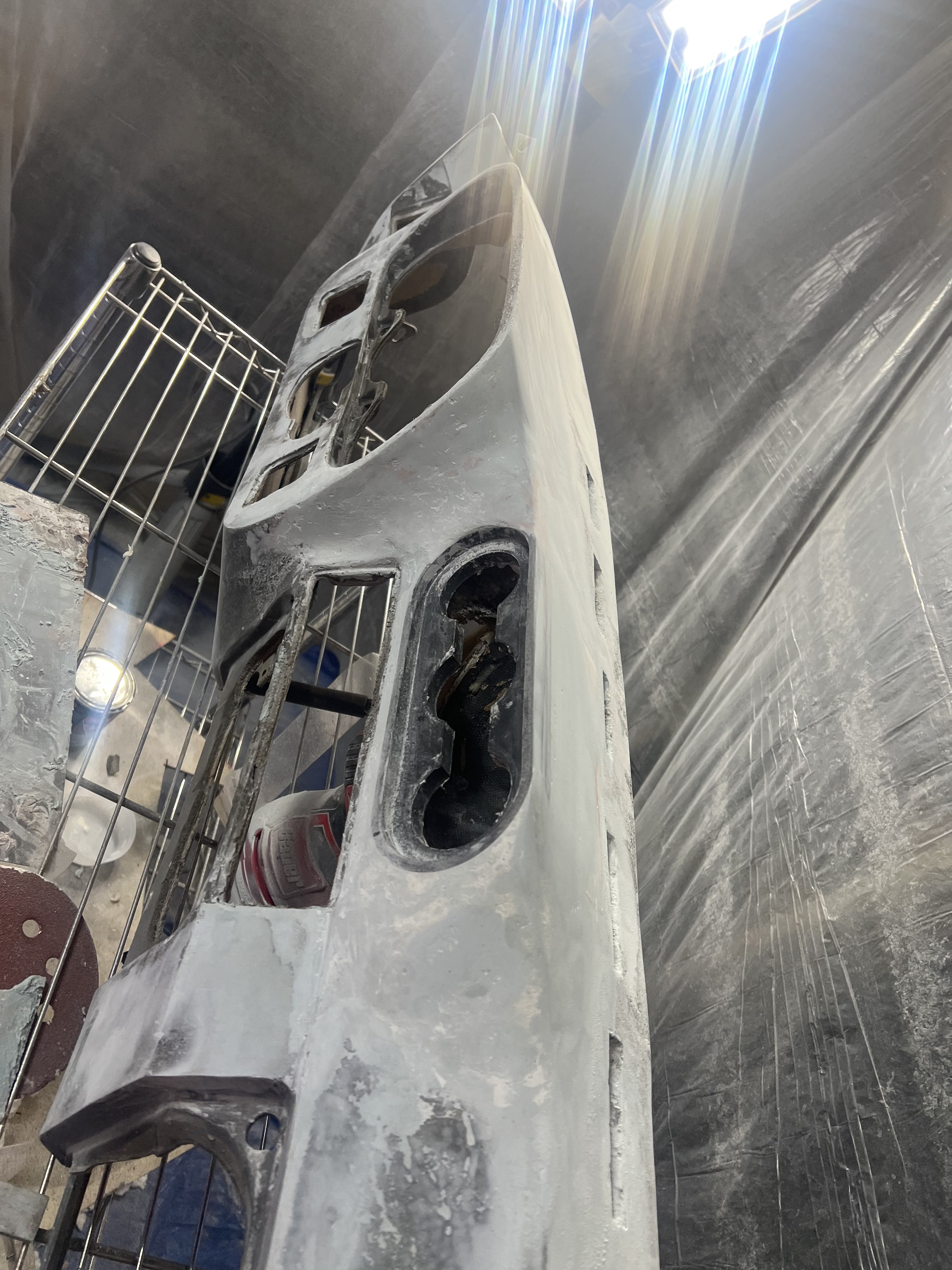

Step 5: Everything from this point on is going to get very messy and dusty. Get some drop cloths and or plastic sheets to cover or enclose the area around you are working.
Bondo time, Why bondo? Because I plan on covering the dash in flocking, The backing doesnt really need to be soft. If you were to recover the whole dash in vinyl, its recommended to use padded dash filler. That stuff is pricey but its got give and the pros use in in upholstery.
Bondo Applied2.jpg (1.87 MiB) Viewed 1034 times
Bondo Applied.jpg (2 MiB) Viewed 1034 times

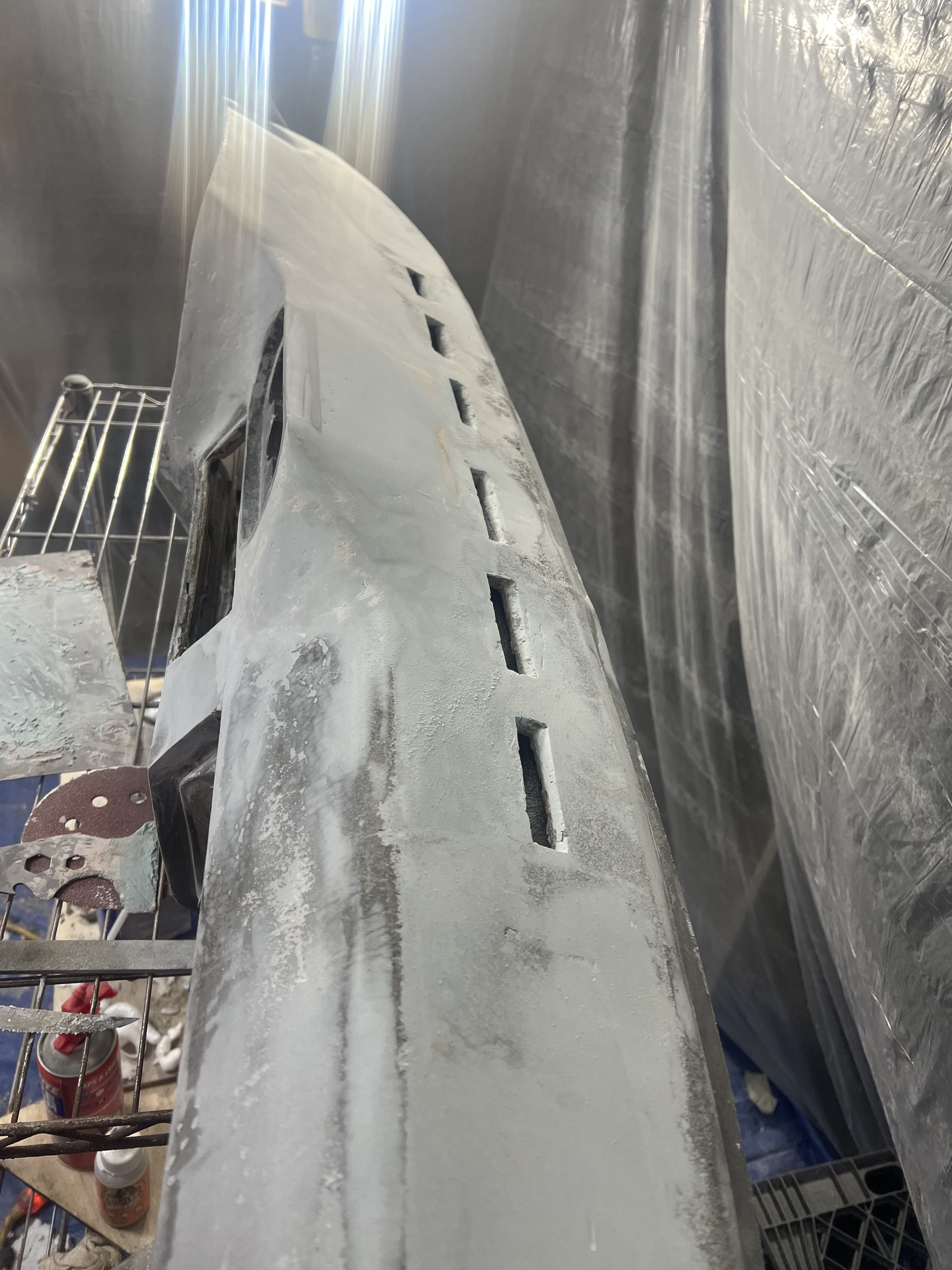

Step 6: Step 5 and 6 will most likely be repeated several times. Sanding :crazy: A cheap orbital sander from harbor freight and some 200 Grit pads. This step takes the longest and is messy
Sanded Bondo2.jpg (1.8 MiB) Viewed 1034 times
ItsSunnyD
Posts: 13
Joined: Wed Mar 22, 2023 10:59 am
Has thanked: 11 times
Been thanked: 10 times
Take your time with step 6 and really try and get things right
Sanded Bondo.jpg (1.81 MiB) Viewed 1030 times
Sanded Bondo3.jpg (1.5 MiB) Viewed 1030 times

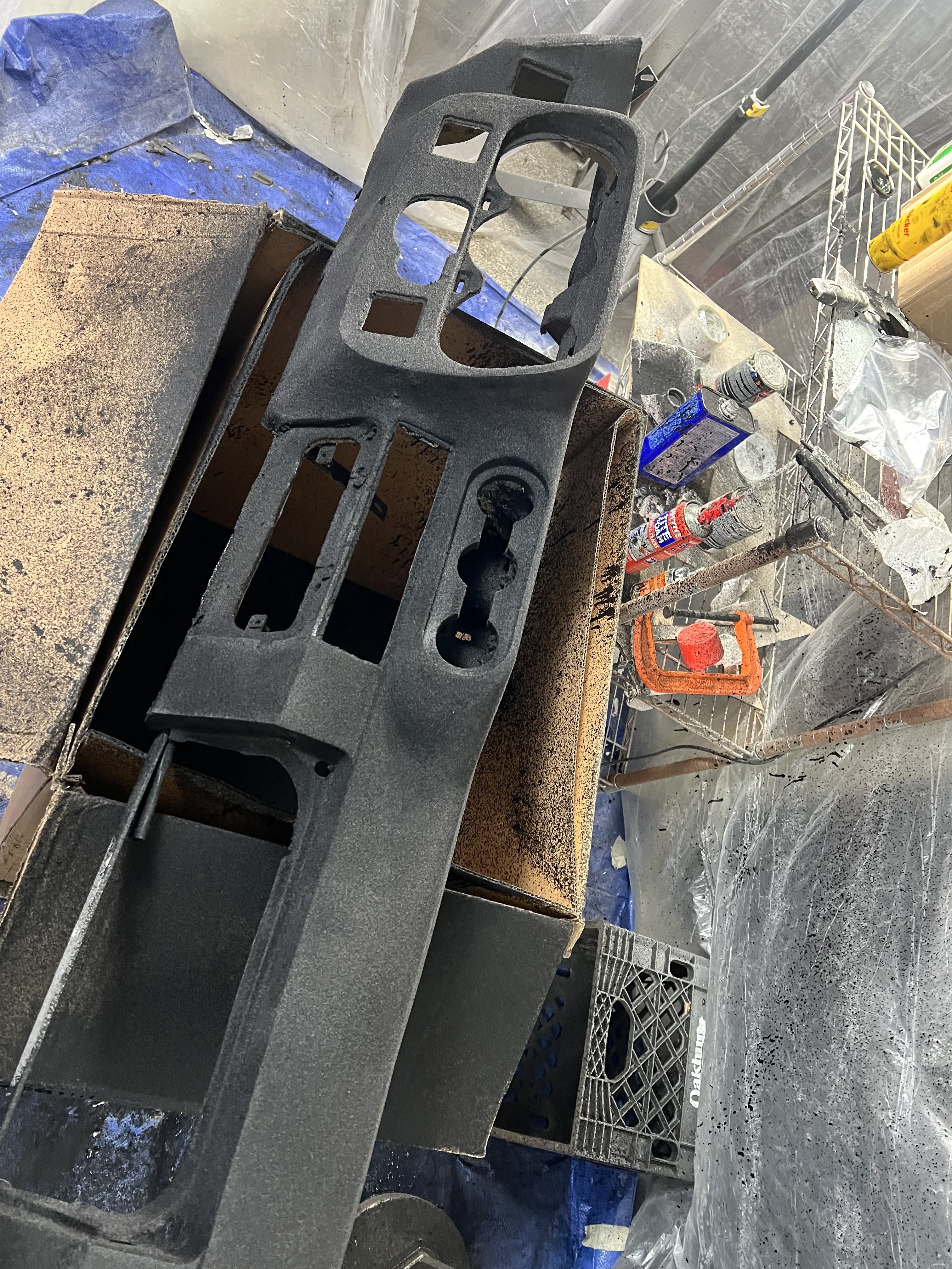

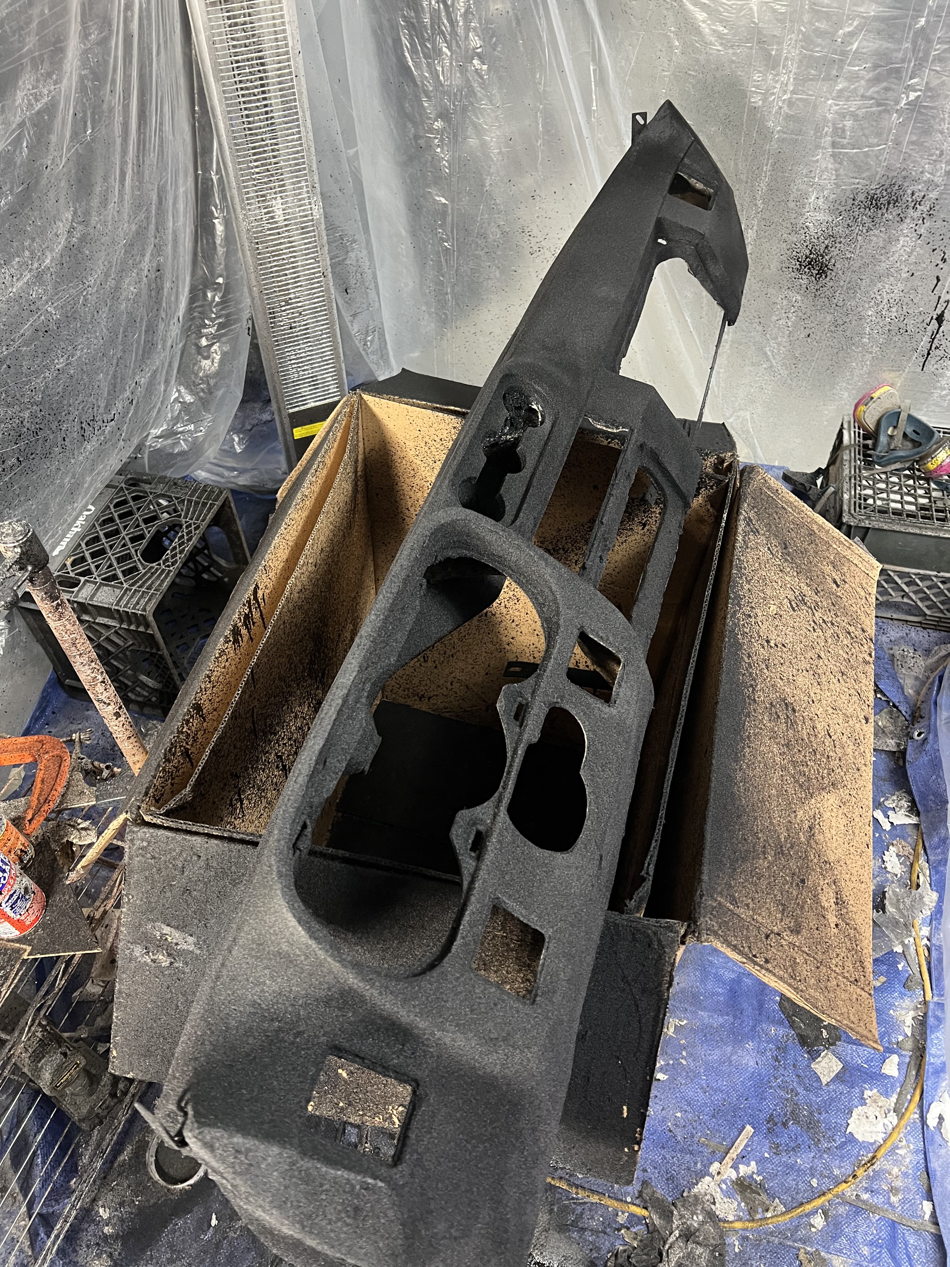

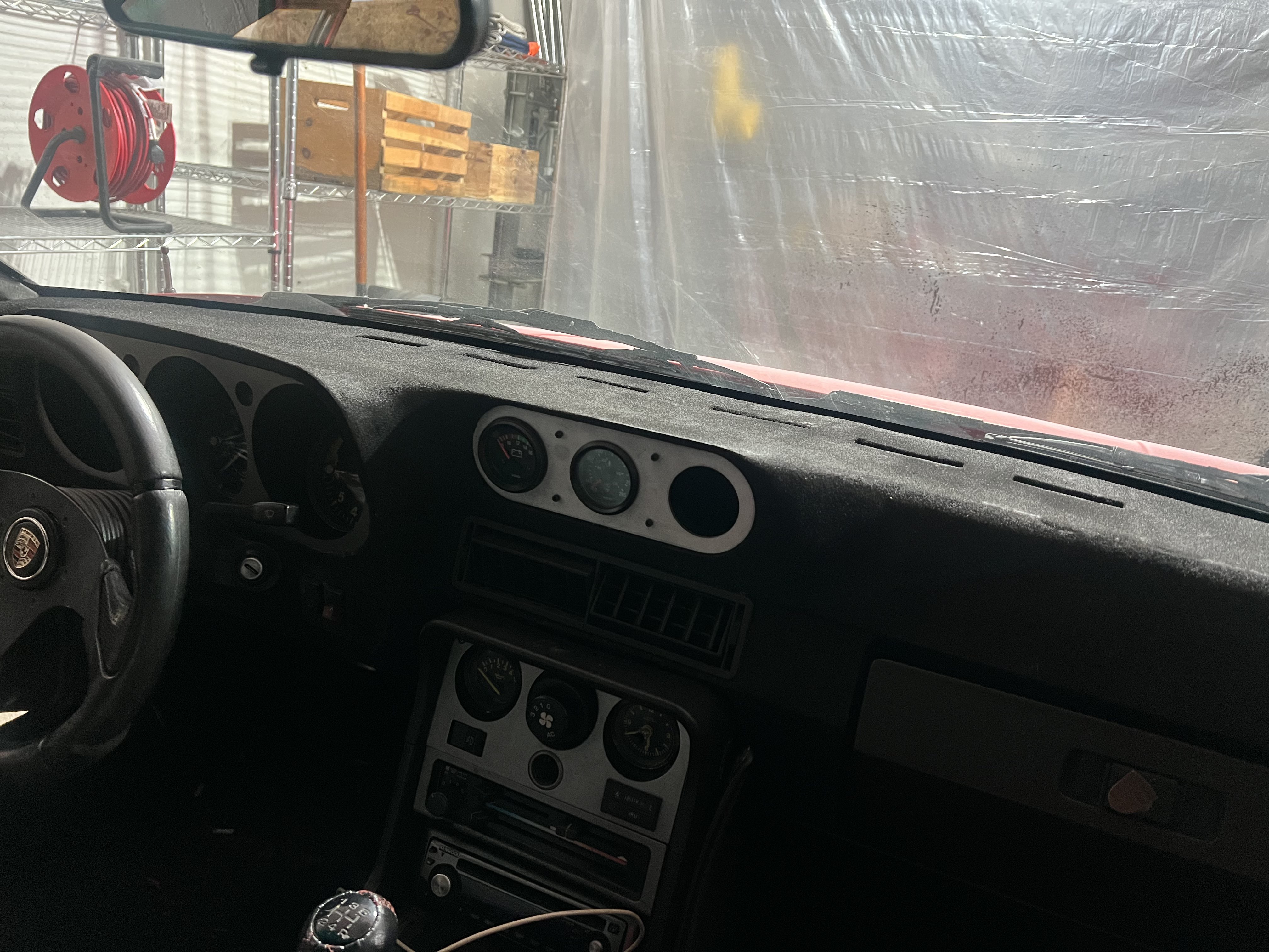

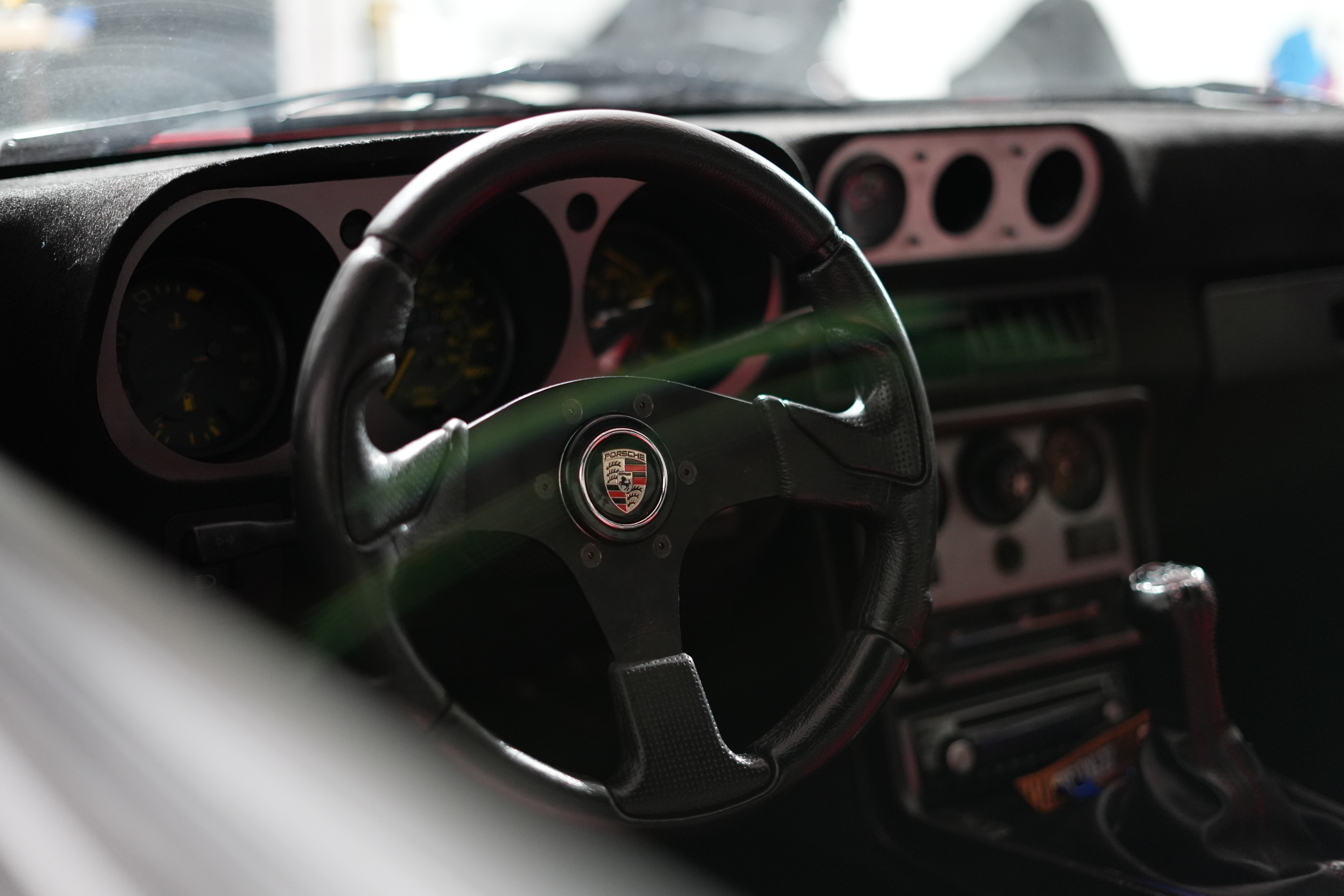

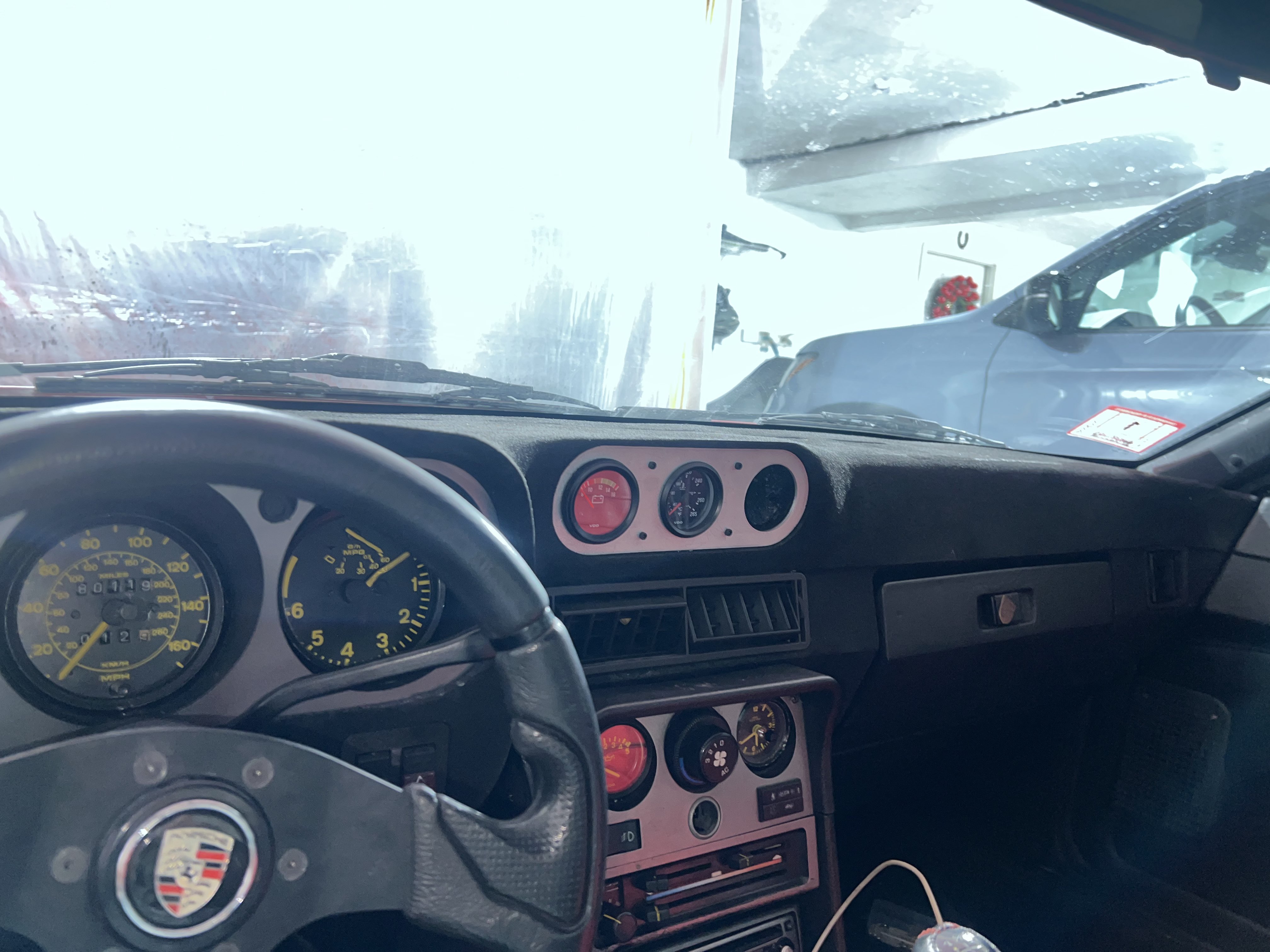

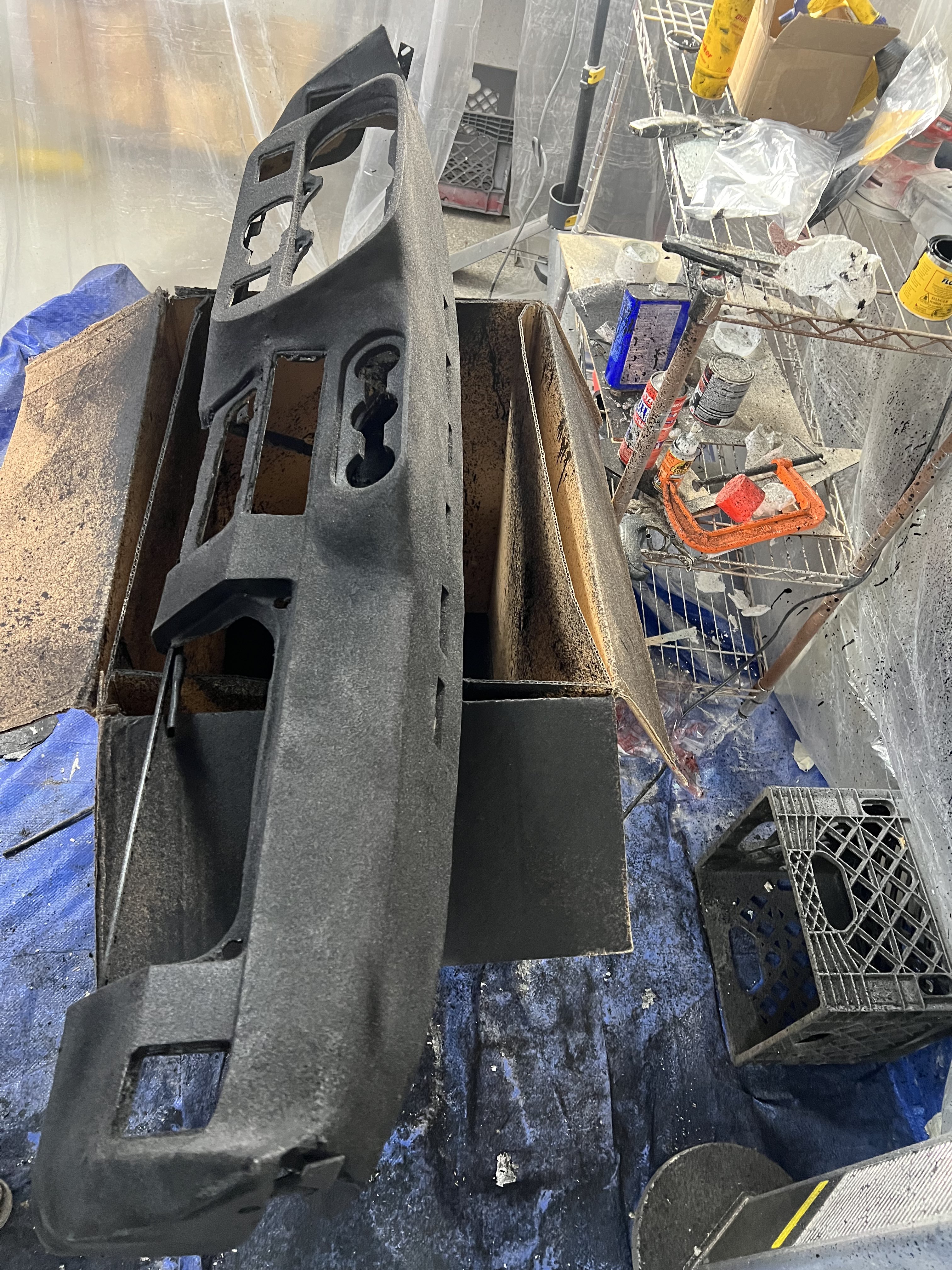

Step 7(Depends on your choice of covering ,I chose to flock it.) Covering the dash. I chose flocking, cheap and easier then most other options. Also it would reduce glare when auto crossing. Donut Media on youtube did a video on dash repair and did flocking as one of their repairs. I personally think it looks really good and its a lot cheaper and easier. For reference its like the green part of a pool table, velvet in texture. I used the name brand FLOCK IT, Awesome product and simple to use. The instructions on the application will be different depending on what brand but mine was as simple as Appling the glue then dusting on the fibers.
The End Result, There are imperfections. It didnt come out perfect but is way better then before. Just take your time, read and research and all of this becomes really easy.

The way you integrated those additional gauges is really seamless, fabulous work!
