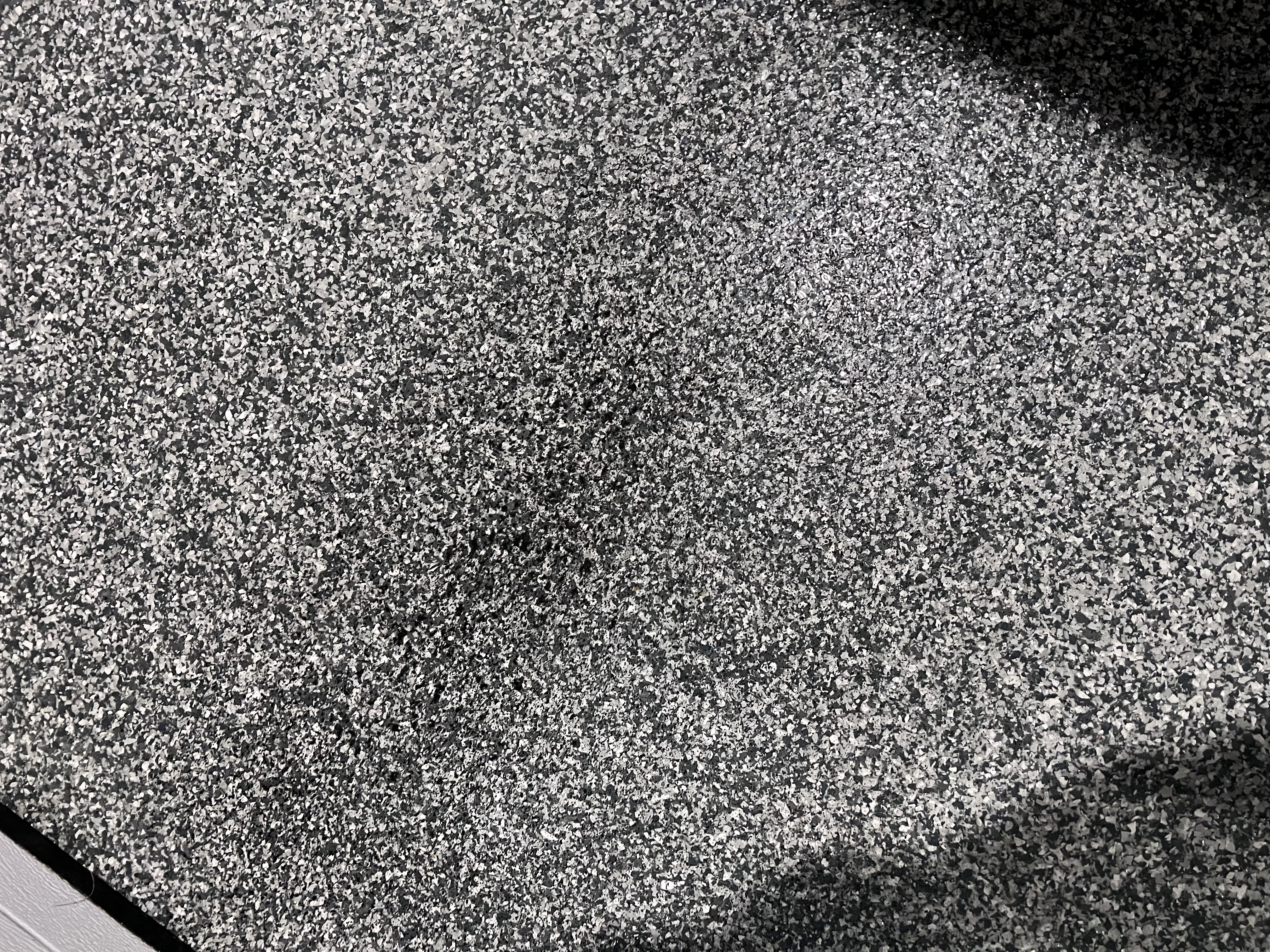

It’s done it since I got the car last June. Haven’t done anything to it other than basic maintenance and changed the exhaust to a Fabspeed cat bypass and Broadfoot catback. Attached picture shows about 5 seconds of warm up in the garage before I pull it out to let it warm up outside. It’s definitely wet droplets. I know I have a coolant leak at the headgasket, but it’s not mixing. Car runs good and mechanic scoped and did a compression test and everything was fine.
The slight coolant leak seeps along the head gasket back to front. Of course I’m just waiting to pull the head till I have everything to do the water pump, belts and turbo refresh.
