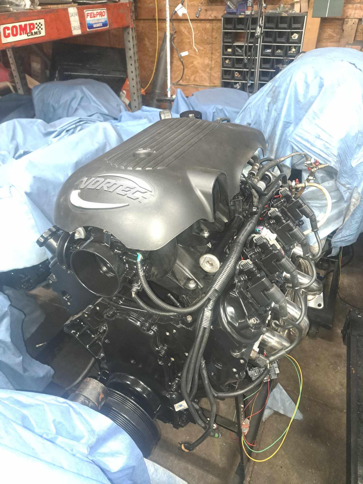

The swap is official! Bought this 5.3 pushing about 400ish today. It'll be shipped to me hopefully Monday.
Hearts pounding a bit, this will be a JOB for sure. Mechanically speaking I feel okay, wiring? we'll see.

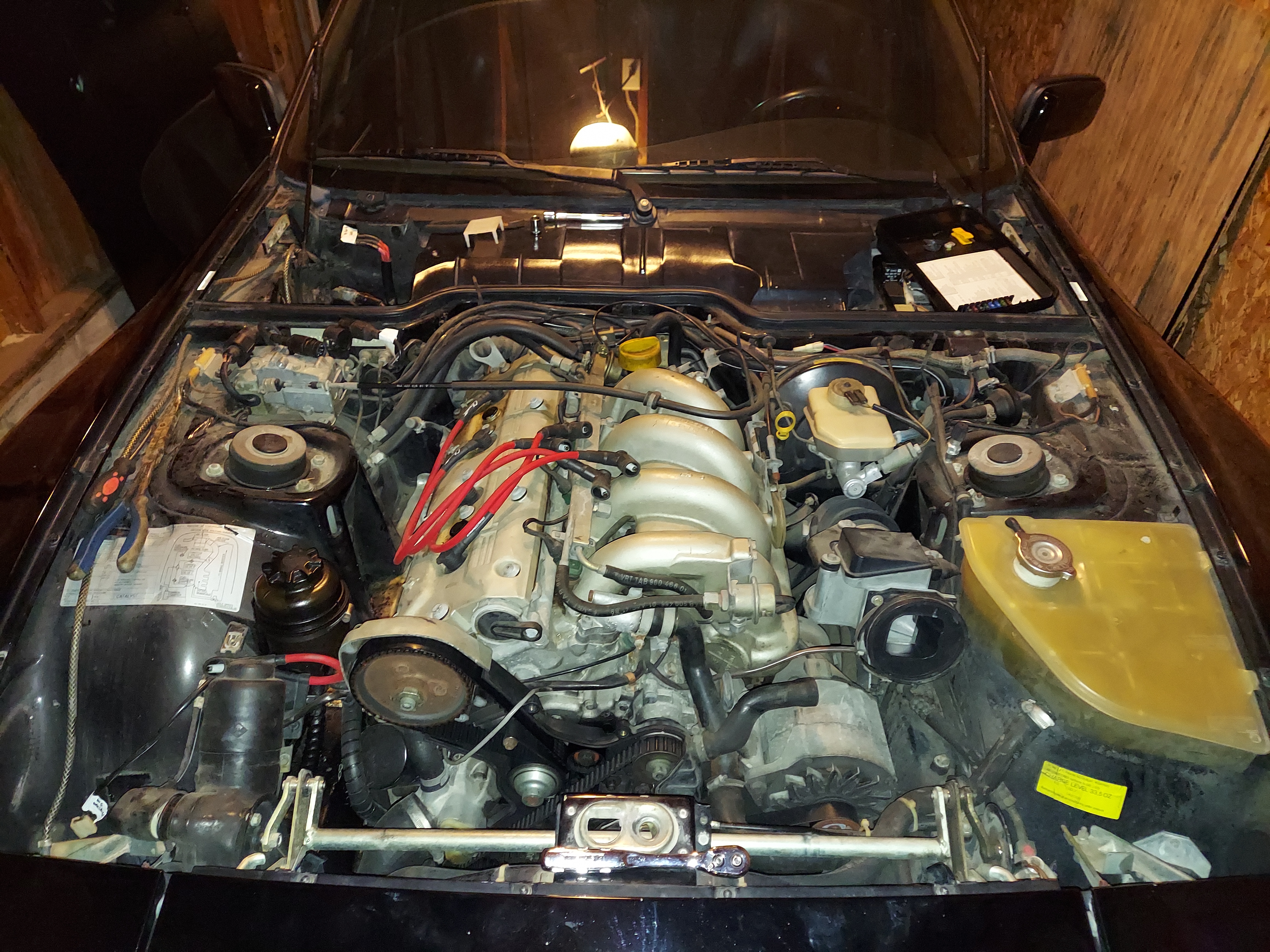

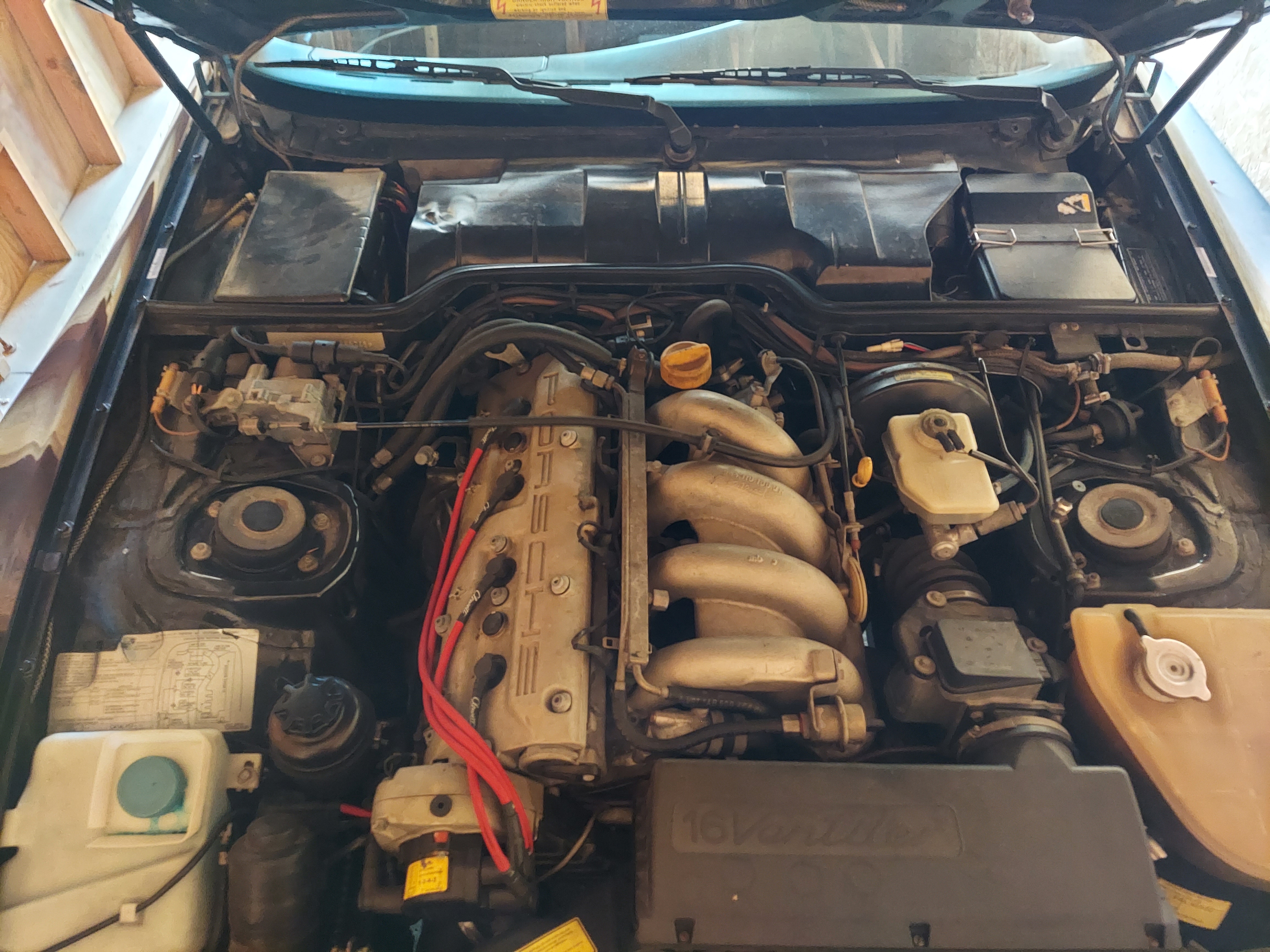

Well after each and every delay I can think of, I finally officially started the swap! I got a few hours in today so I took the hood off, pulled some wires, and started getting the front end stuff out. Any recommendations for getting things out would be appreciated.
I haven't bought any parts for the conversion yet. Got a guy across the street that has done the same swap on his 944 who has some parts for me, so I wanna see what I can save before I start beating my wallet up.
I gotta get moving, was hoping to have this done by now.
