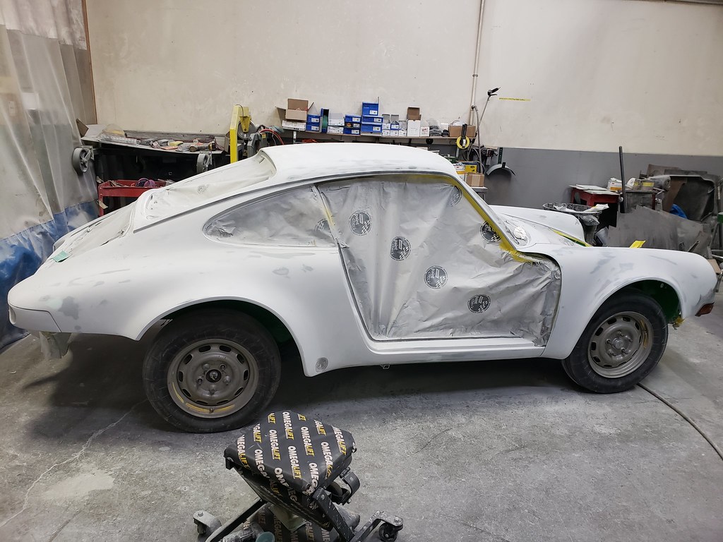

Looks like the late 951 used alloy wheels. The 944 N/A I owned all had the same steel wheels like the G-body. I use them for roll-around wheel during restoration.
