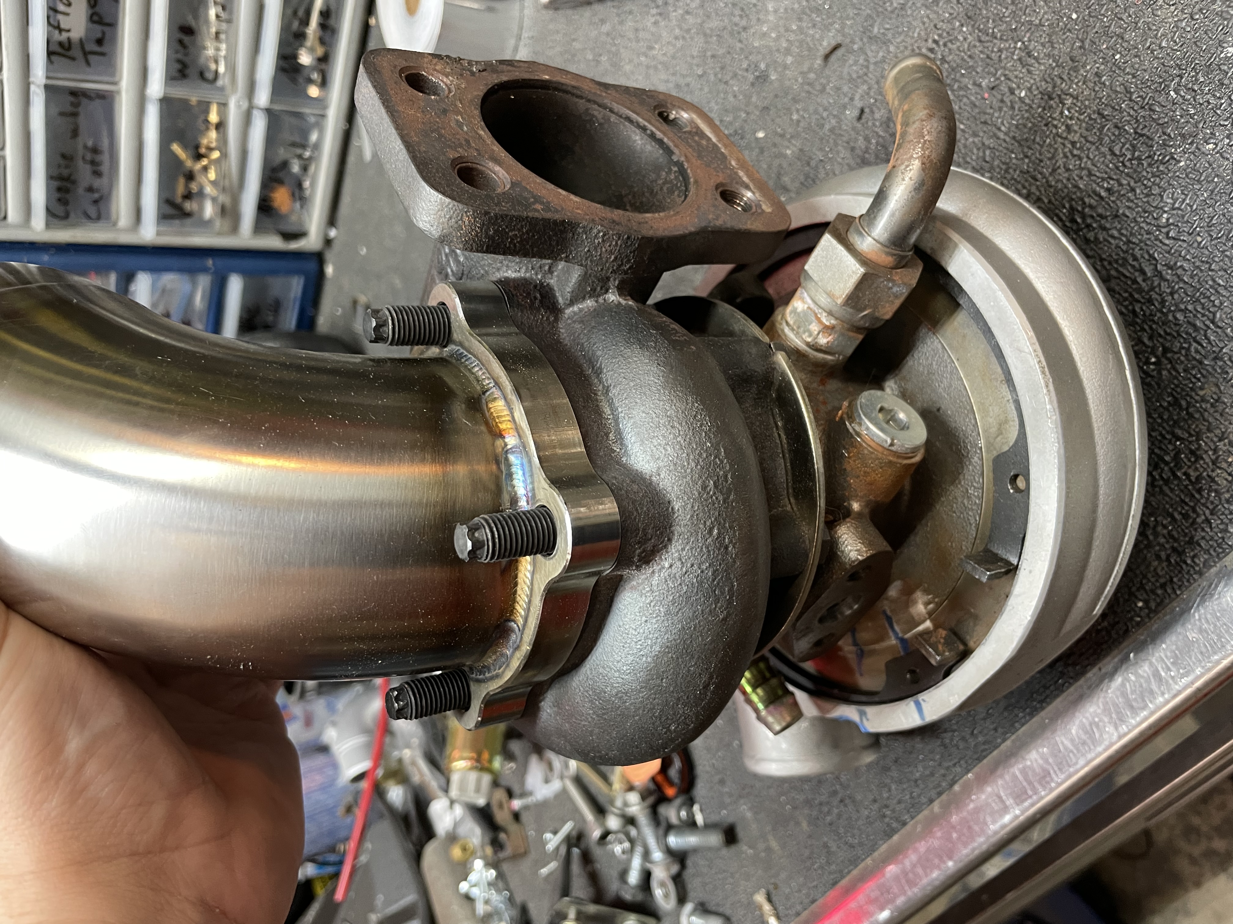

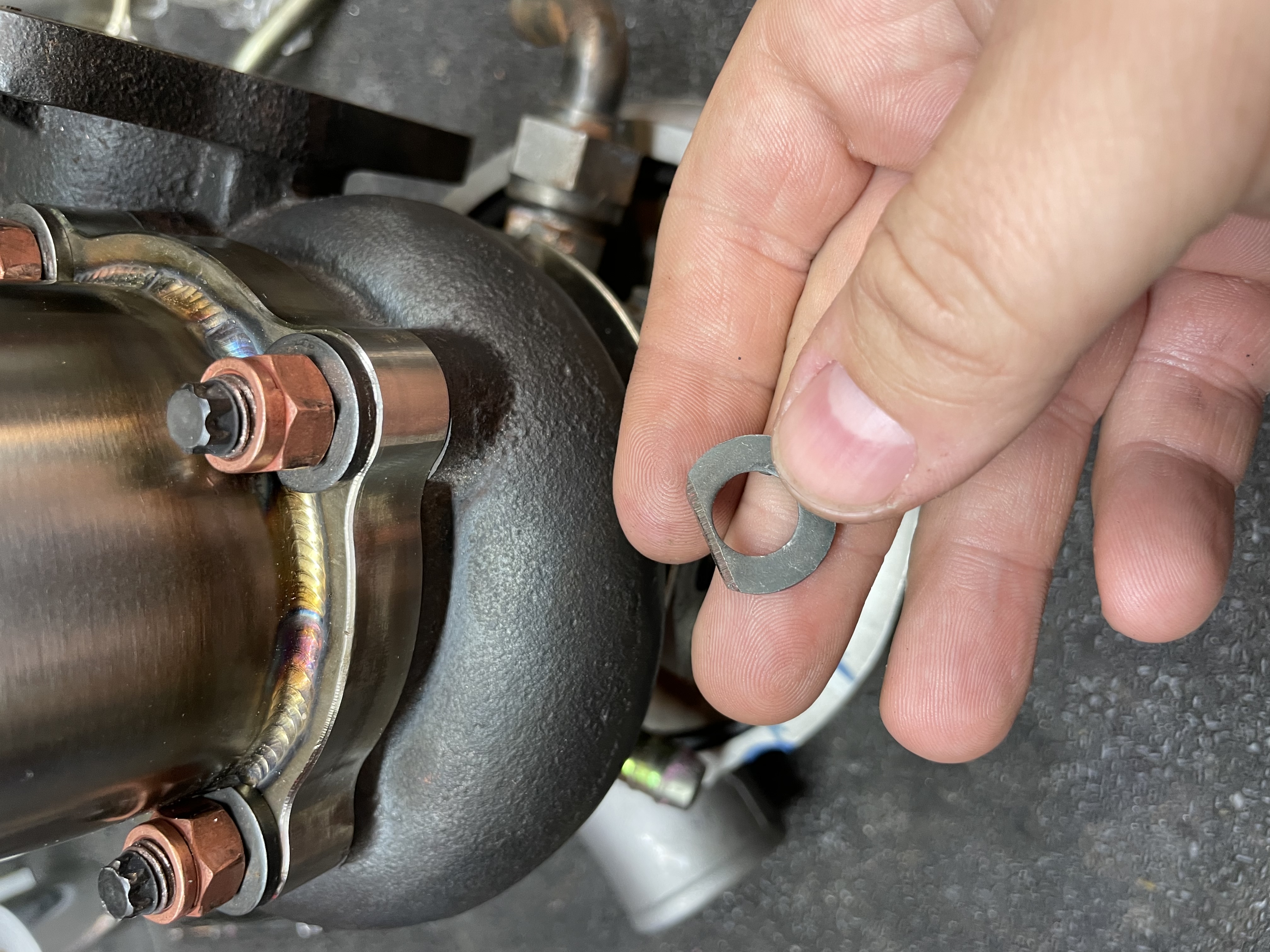

I have an old Speed Force Racing downpipe, which looks suspiciously identical to your Fabspeed. :roll: The first SFR "3-inch" downpipe I received had a hacked-in smaller section just like that Linsdey pipe, but they eventually fixed that. Big pipes leave less room for fasteners so assume that's a ham-fisted solution to that challenge. On my SFR (Fabspeed?) unit, I had to use round Allen-head bolts, and I had to grind a flat spot into the washers so they'd sit flat on the flange and not get hung up on the weld bead.
The M44 pipe looks great and shows a lot of thought and effort, but does that splice-on piece mean it does not bolt up to a factory cat pipe flange? That's wouldn't be all that practical for guys like me who need to go back and forth between cats and test pipes? I suppose you could get two splice pieces or move it around using clamps, but I can't imagine there's enough, if any, real world dyno difference to make it worthwhile? If you don't need to worry about the factory flange, then that one seems like a no brainer.

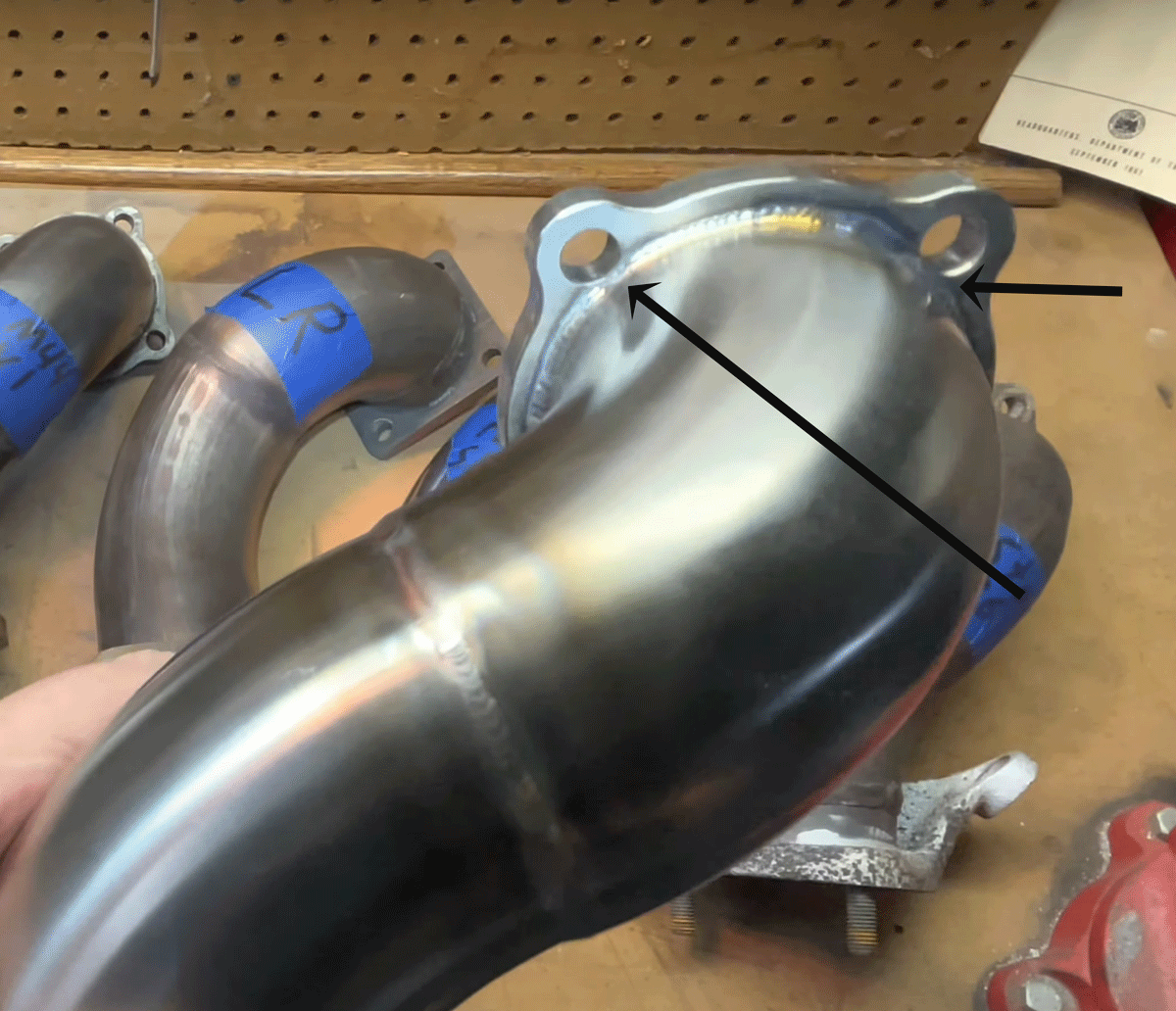

Have you tried using that new one yet? The holes 'look' too close to the pipe to use standard fasteners, or is that just an optical illusion from all the reflections, etc. See, for example, this still frame from your video....

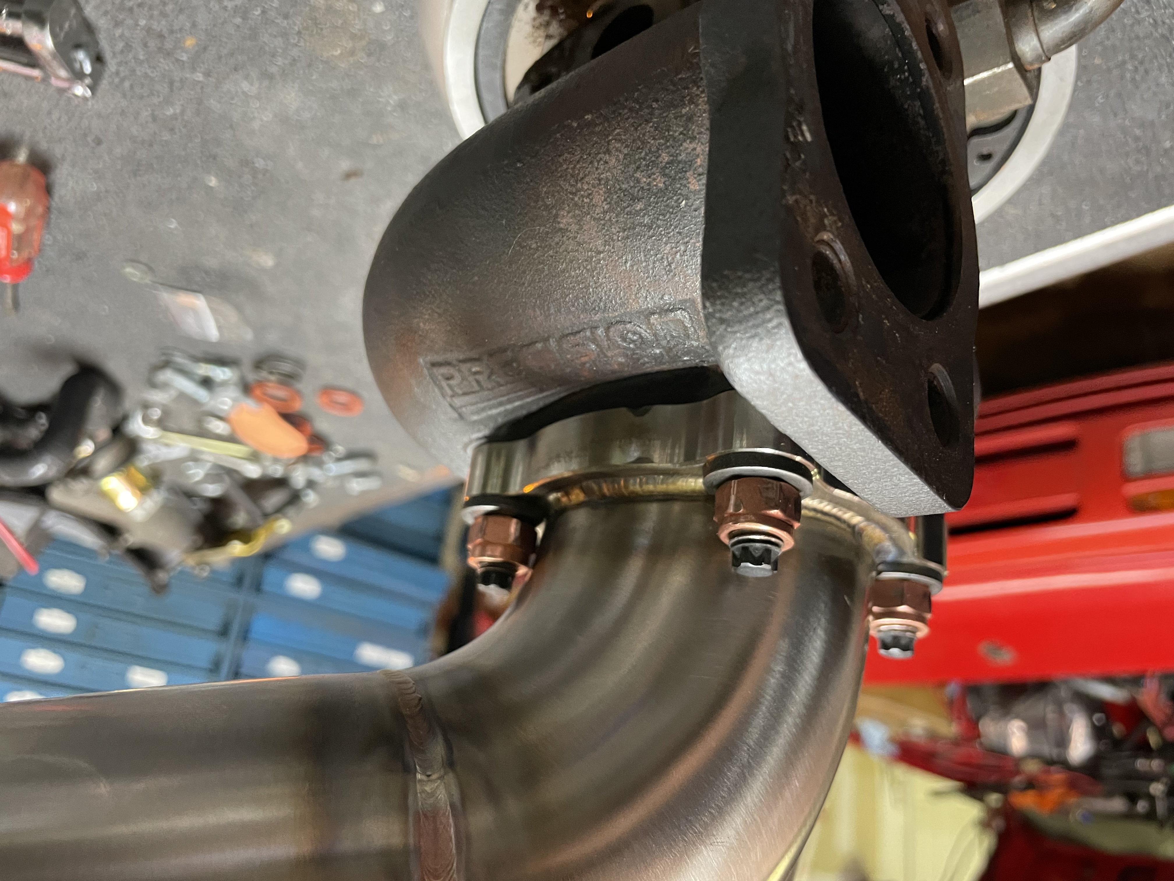

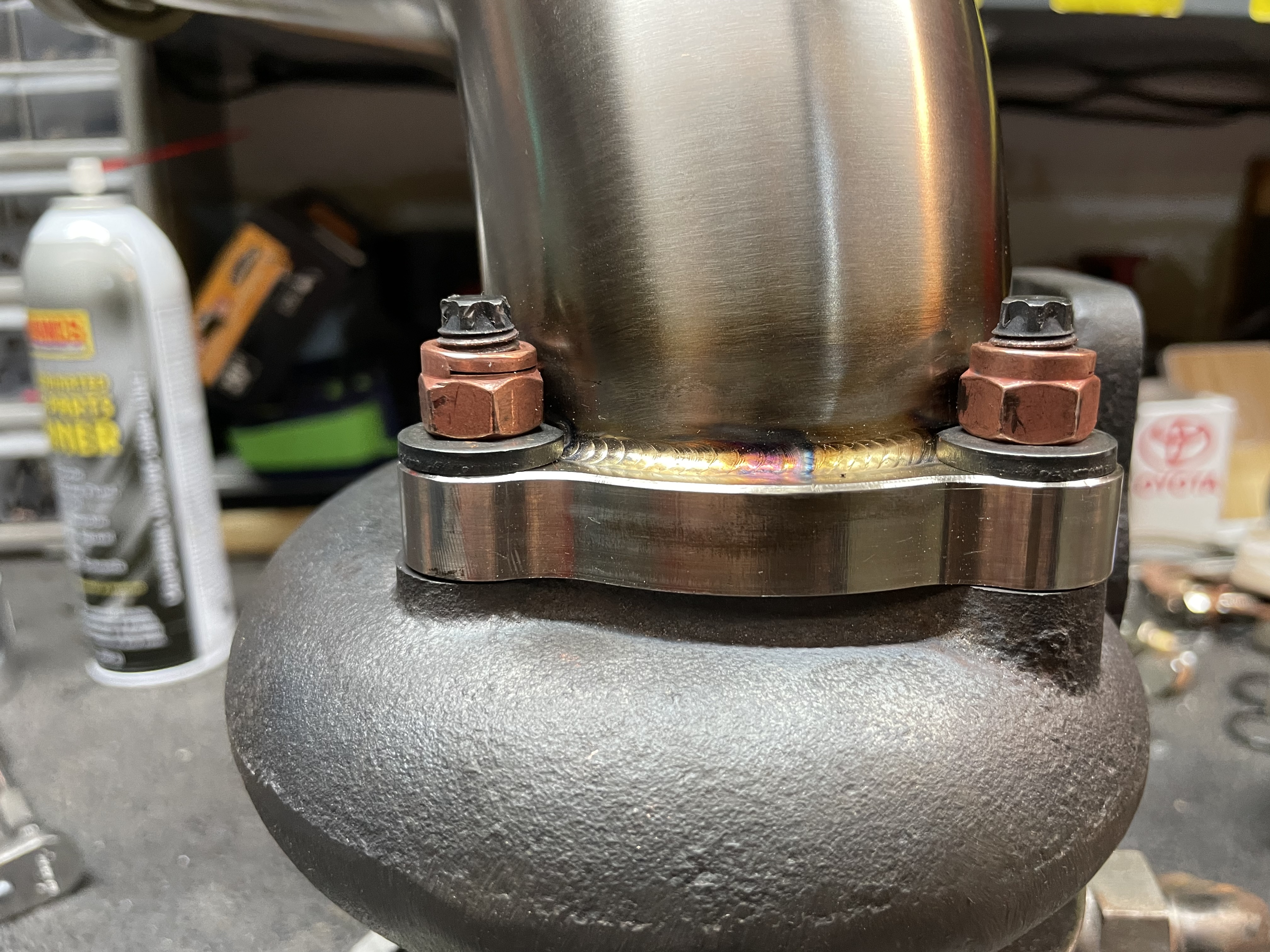

Fits perfect, it’s tight but you can bolt it up, washers and hardware are modified and supplied by M44 with the kit

Those washers are exactly what I did with my SFR downpipe.

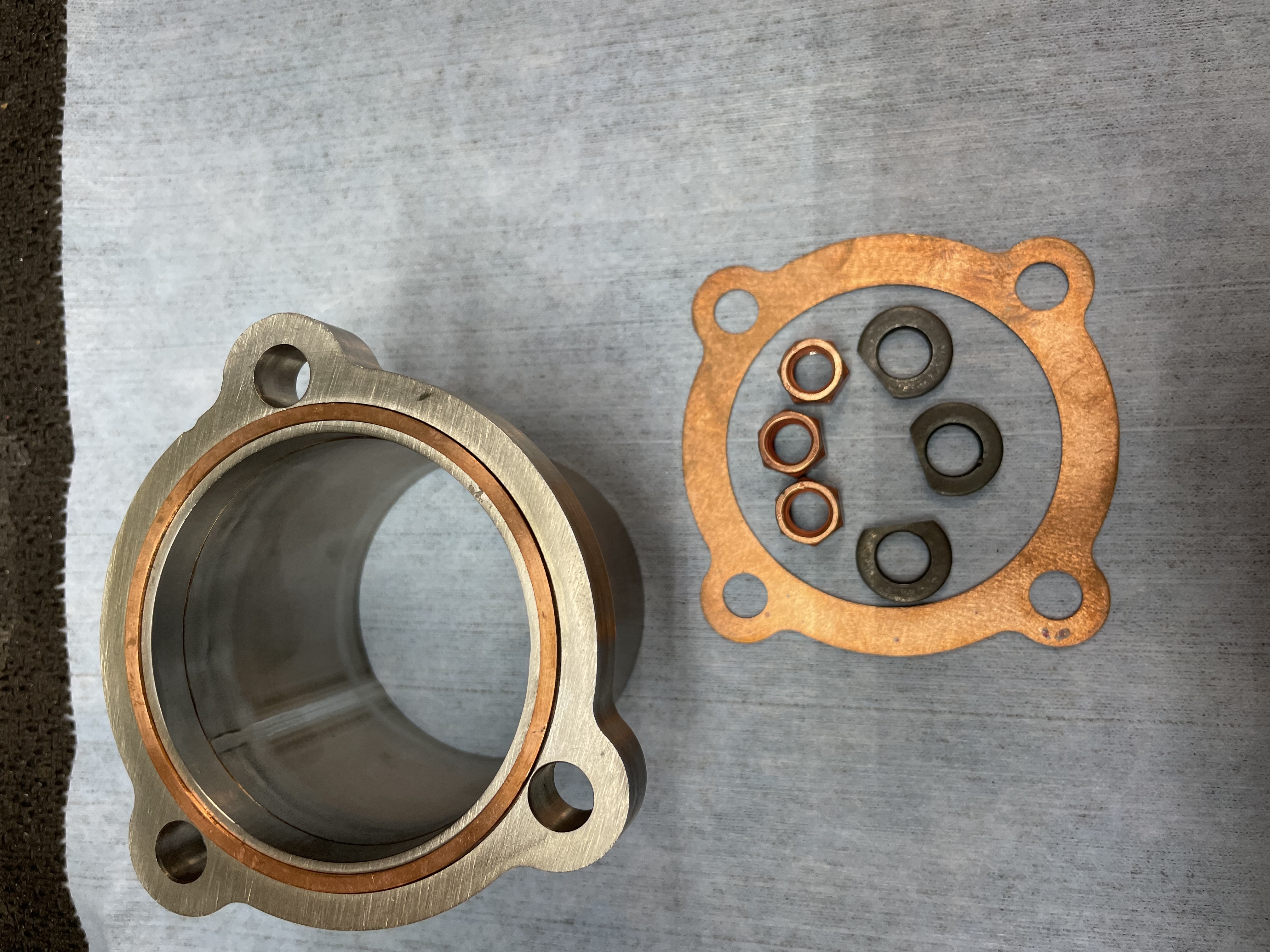

All nuts, washers and gaskets are included with the kit, here’s the rest of the hardware minus what I just used to install the pipe for your viewing pleasure
