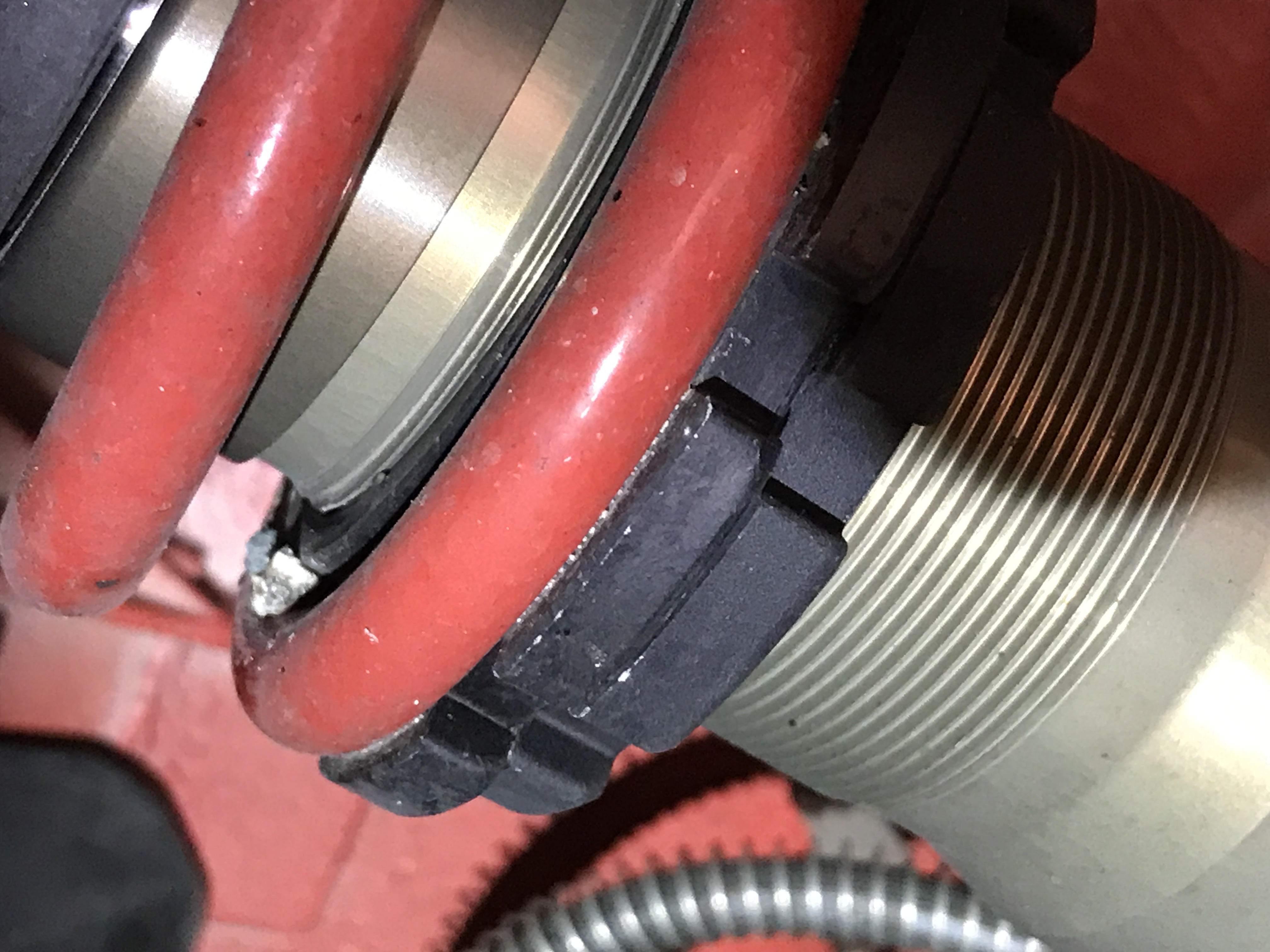

Had intermittent noises coming from the front suspension. 2021 718 Spyder. It sounded like someone striking a spring. It was driving me nuts!
Doinggg. Doinggg. Had it in a specialty shop. Nope cannot find the source. Other shop says, “ it’s a gt car the suspension makes noise. Oh well.

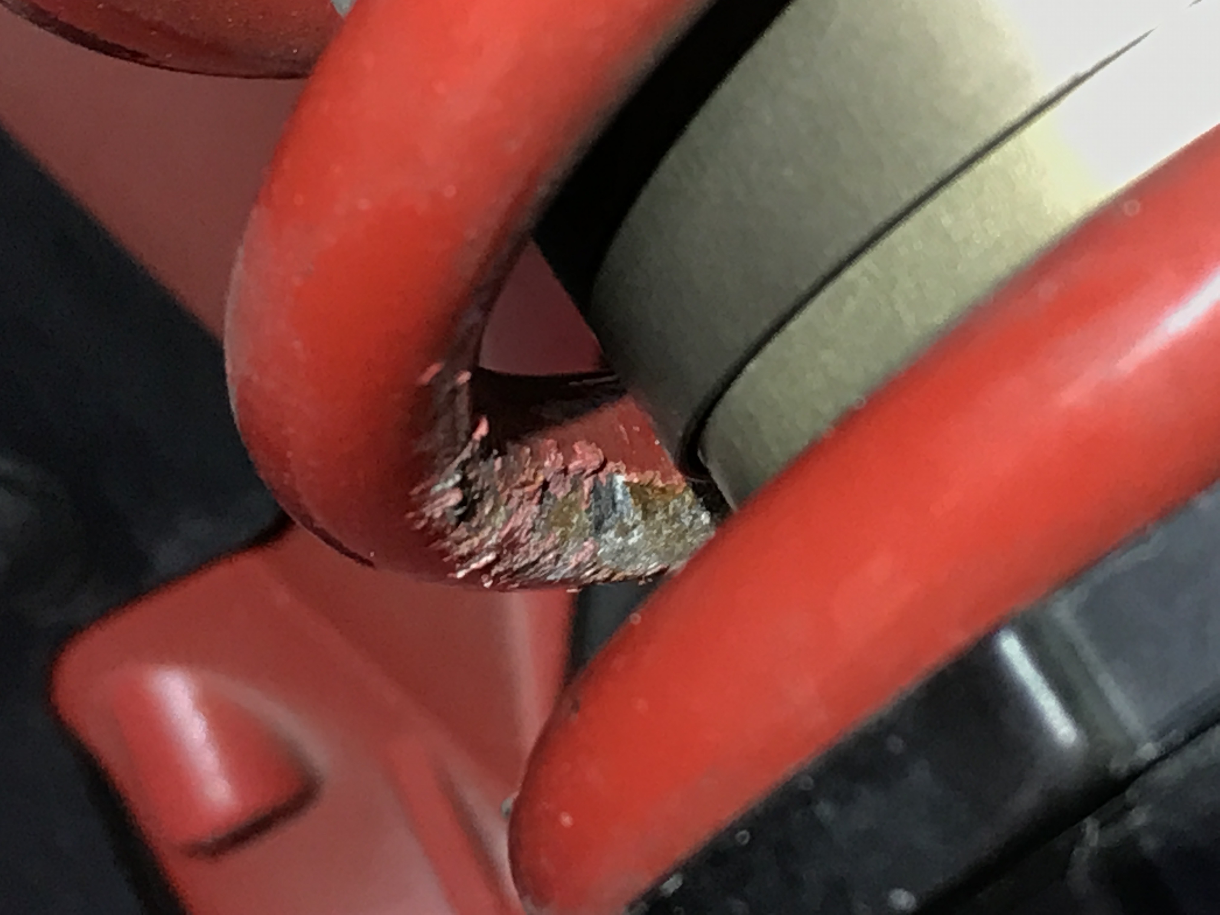

I Jack up the car and see what i found. Little rocks get embedded between the spring and bottom perch. Look what is is doing to the spring.
Noise from front suspension.

Interesting. Were you driving in gravel or possibly was there some kind of unusual track debris?

Not really anywhere especially dirty. It happens at totally random times. I was thinking it is the sticky tires throwing the rocks up. I drive on Pirelli trofeo R but the cup 2 where almost as bad.
