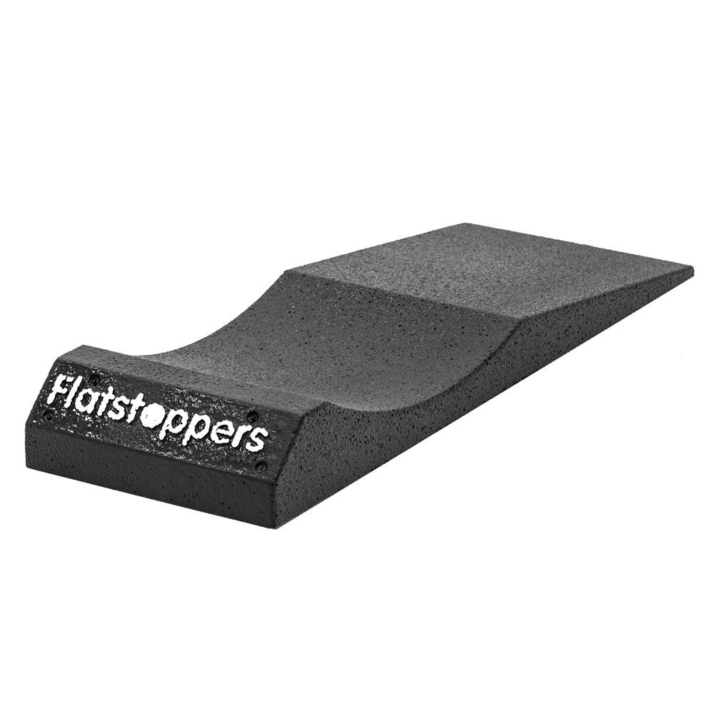

I got a set of these. They work (it seems) but hard to justify the price for what they are. Even in the dead of winter, I'd be more inclined to move the car in the garage a little every few weeks -- you wouldn't need to move more than half a foot to avoid flat-spotting....
