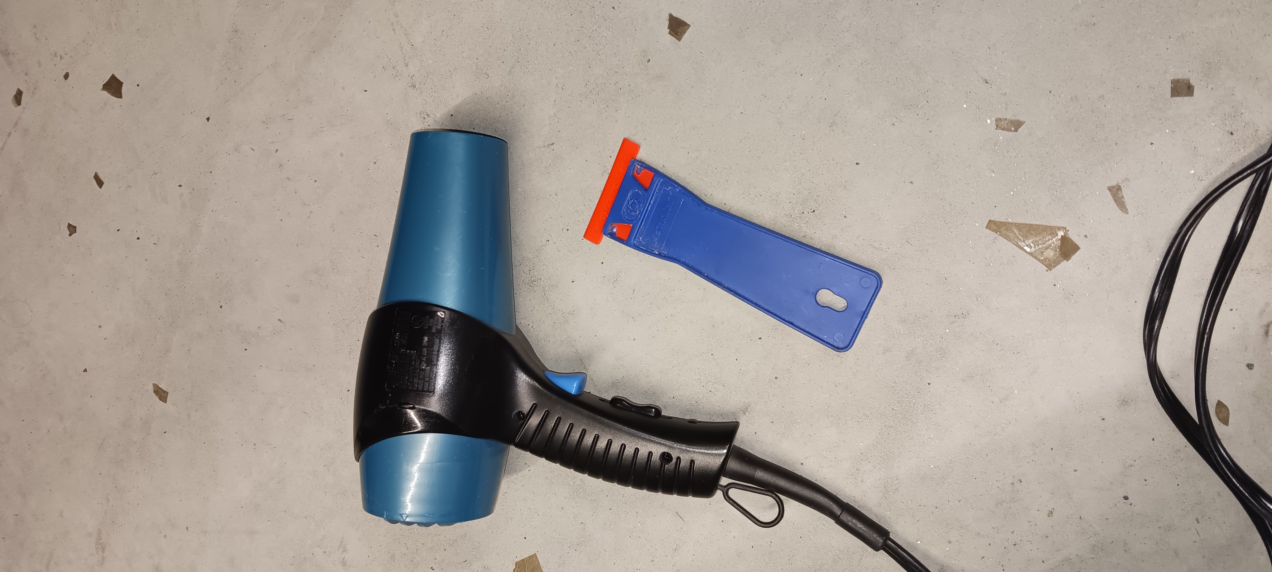

Hair dryer
Plastic razor blade scraper

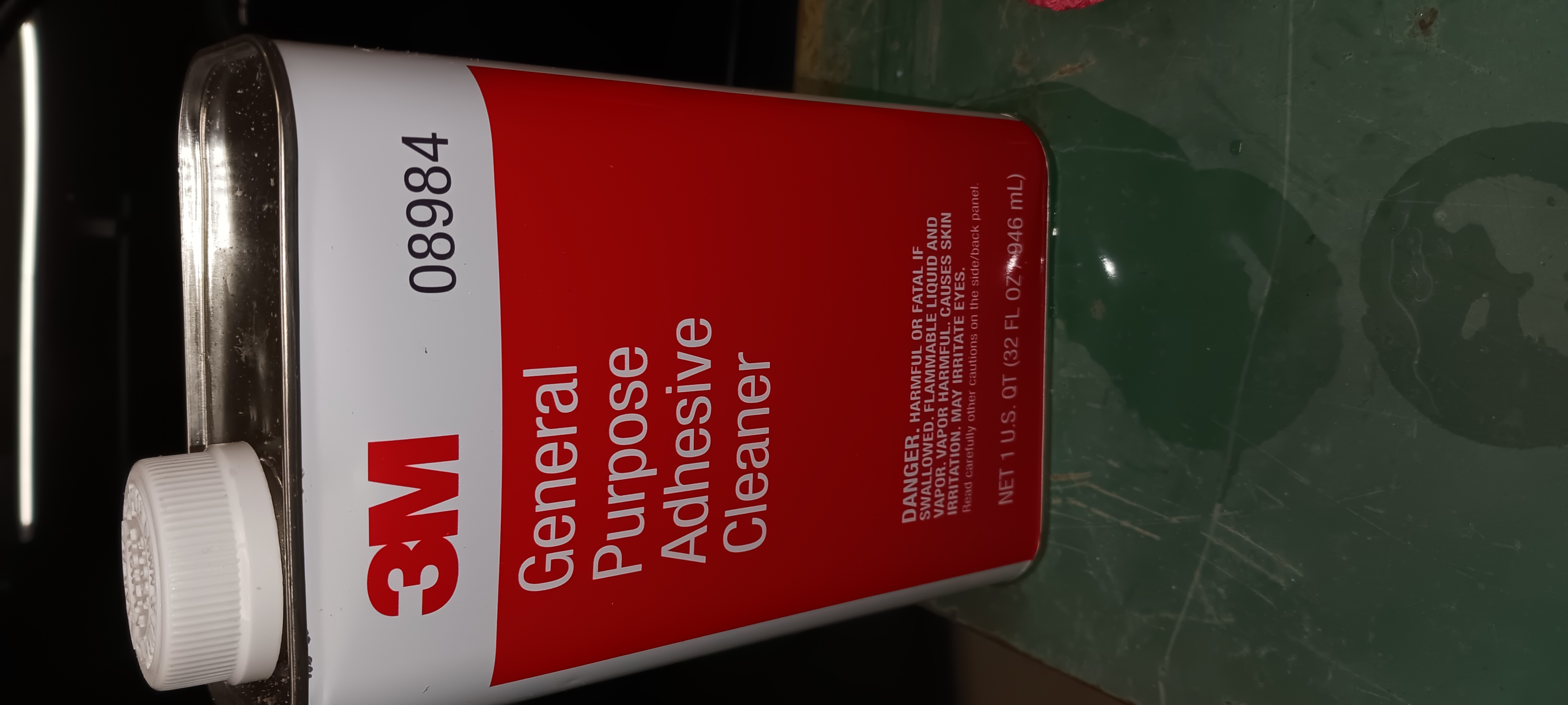

3M Adhesive Remover 08984

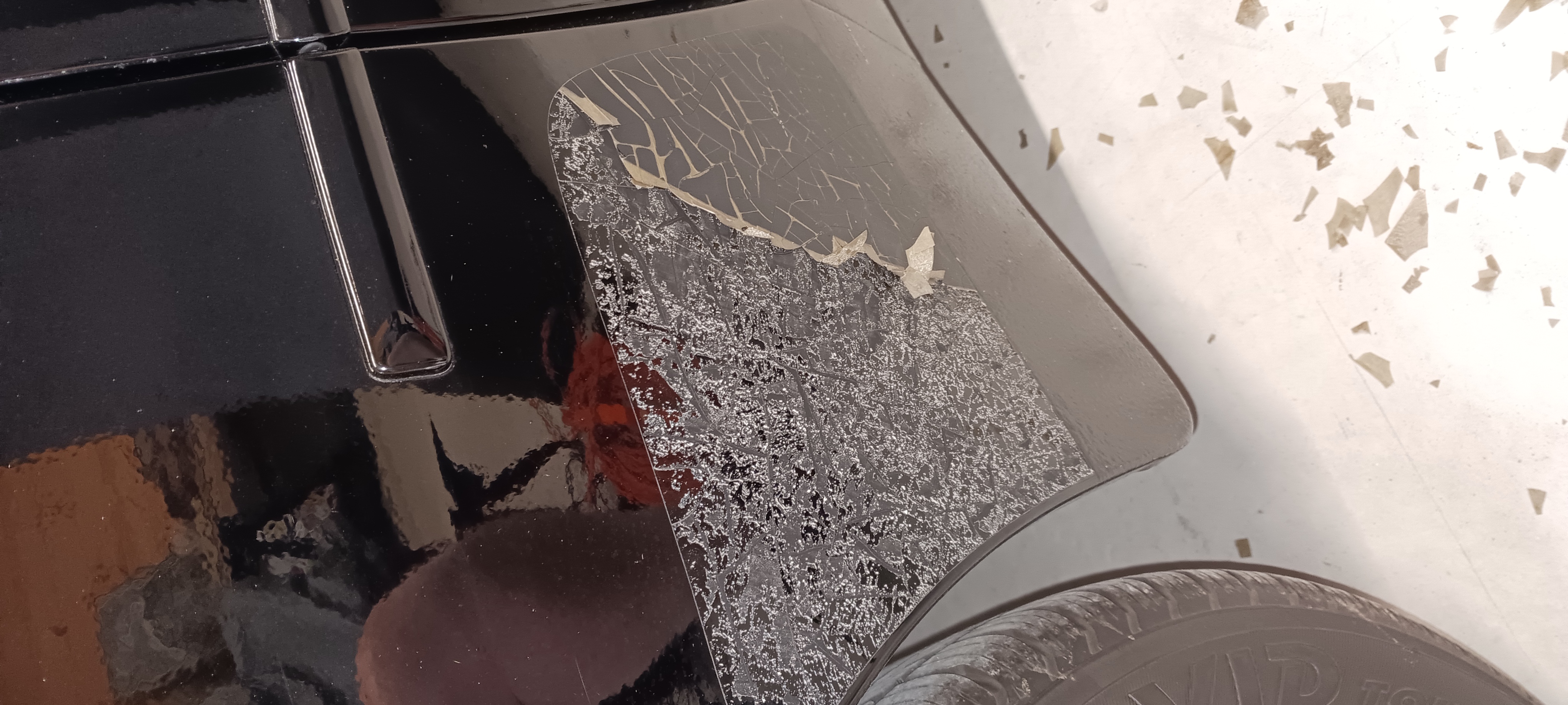

1. Using a hair dryer, I would warm up a section of the guard and slowly work the plastic razor blade under the edge of the guard, slowly peeling off one section at a time. Since the guards are all cracked, I would work off each of the cracked sections then move on to the next. This would leave 90% of the adhesive underneath.
2. Take a clean rag and dip it into the 3M adhesive remover and dab a section of the adhesive then carefully start scraping off the adhesive. You'll have to do a section 2 times and then go back an additional time or two to clean off any remaining adhesive...and there will be some.
To be completely honest, I was a bit concerned about the 3M adhesive remover on 40 year old single-stage lacquer, however the label does say "Will not dissolve or mar automotive paint that has been properly aged." I figured 40 year-old paint was properly aged. In any event, it worked well and as far as I can tell, did not mar or dissolve any of the paint.

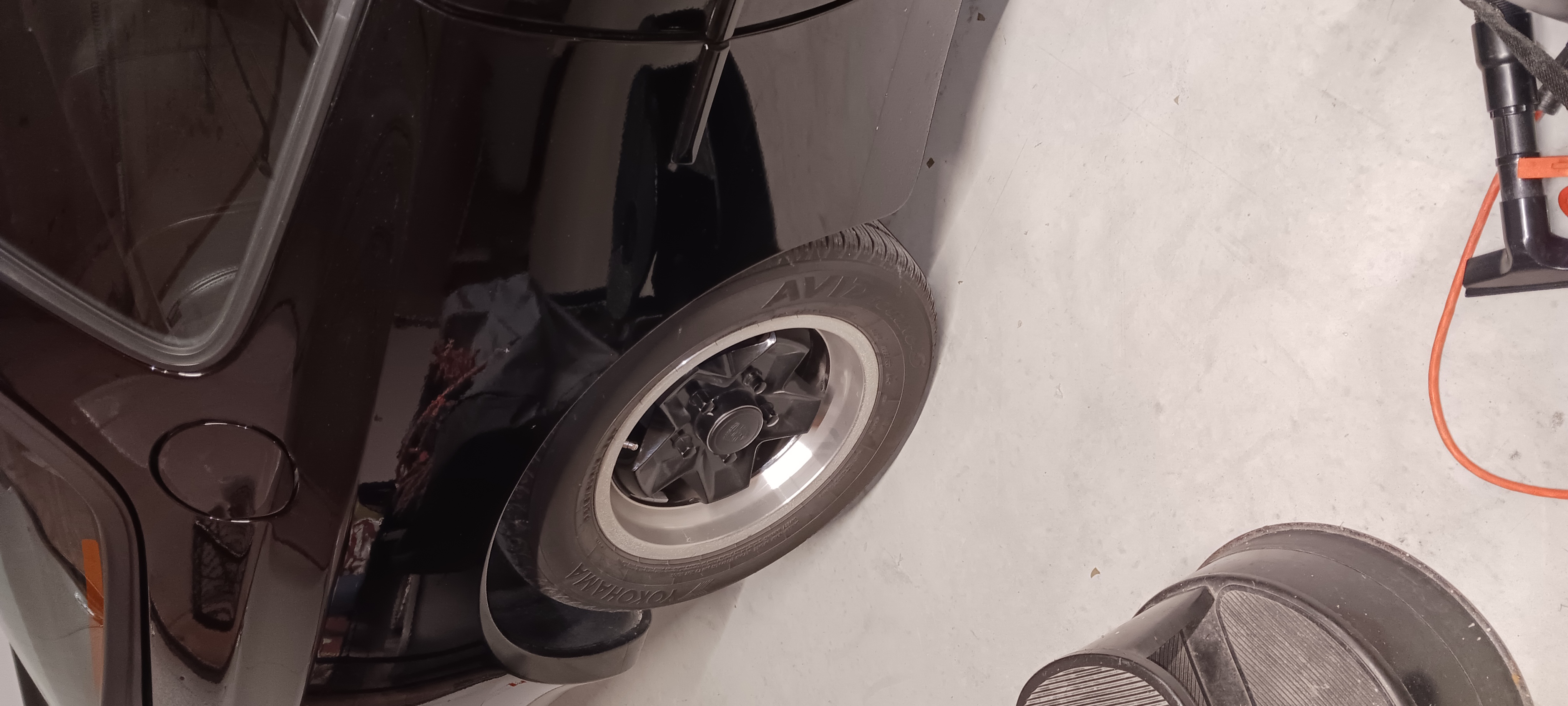

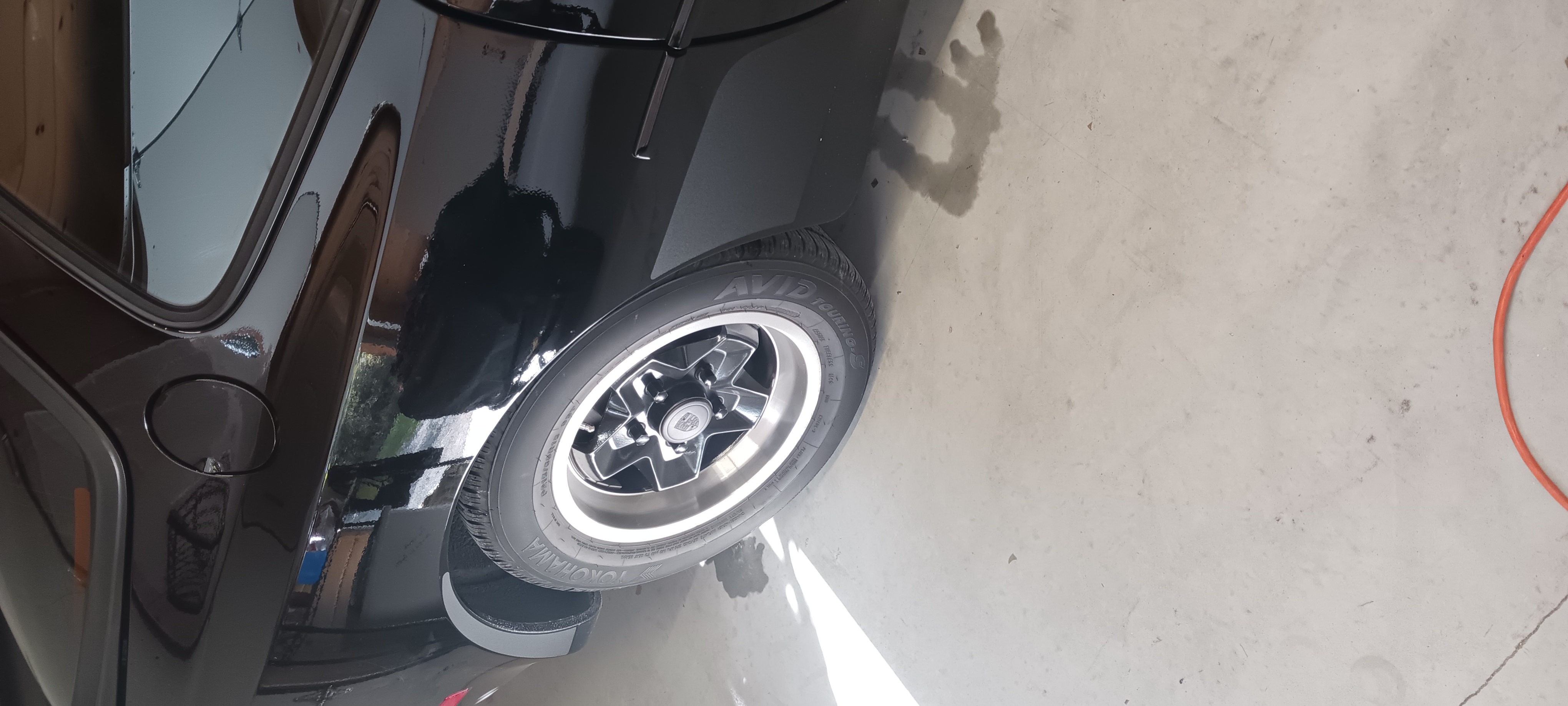

I can't emphasize enough this is a slow process. I started around 2:30 and finished around 6:30. I do plan to install new guards. If anyone is planning on doing this and you are in Southern New Hampshire, I have plenty of adhesive remover and a bunch of plastic razors. You are welcome to it.
Hair dryer and plastic razor scraper

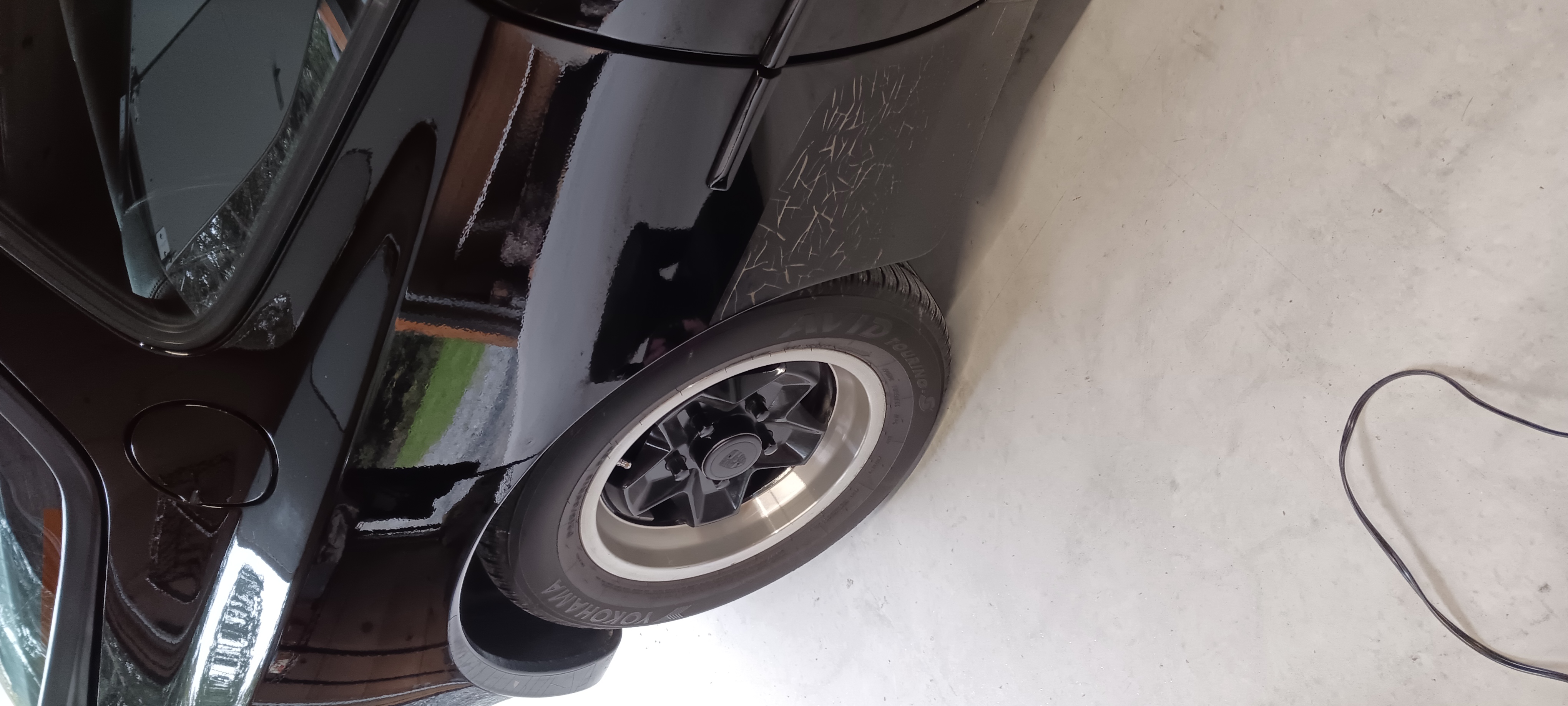

Old stone guards
Old stone guards
Scraping guard leaving adhesive

After a respray, my body shop out them on and their trick was to spray the area with soapy water 1st. Then slide them into the right position and use a plastic edge to squeeze out the water.
In a different car recently, I used meguiars quick detail spray instead of soapy water and got good results.

I used the soapy water method myself. Worked great.

I should also mention I used the squeegee to remove any excess water and bubbles under the new guards. The squeegee I purchased has a side with felt that allows you to put some pressure on the new guard without damaging it.
Could I get those pictures to be any larger? Sorry about that guys.
