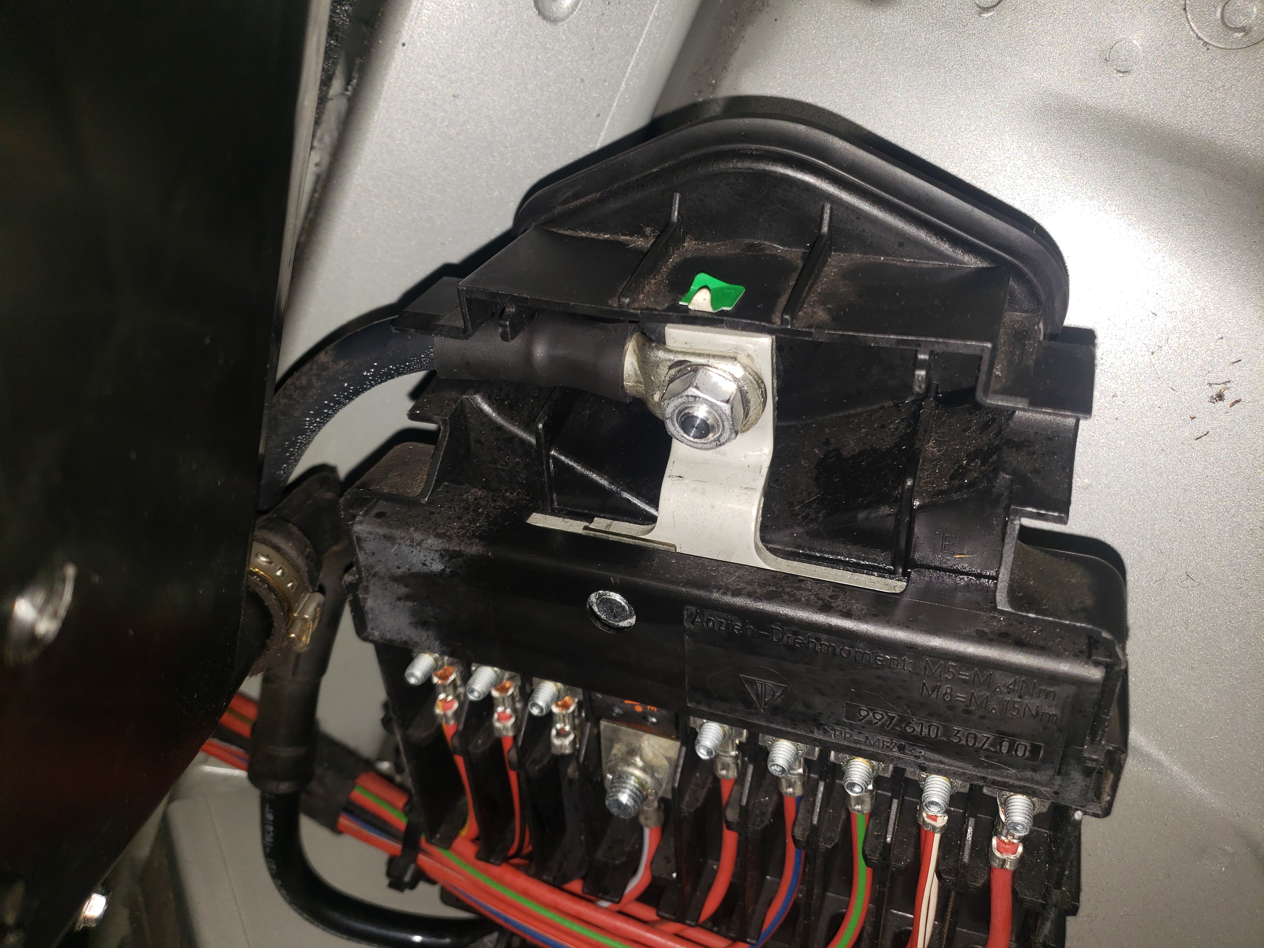

The distribution box is then able to be maneuvered down, though it takes some time and finesse. That, or some muscle and cursing. At any rate, what I think helps is to try to push it toward the center of the car as much as possible and then slide it down.
Once it's down far enough, the box is hinged at the bottom and you can open it, but there will be a green seal that you'll have to break. Once there you can undo a 13mm nut that is the power cable to the distributor or starter. After that, you can remove the post thing from the back of the distributor box via some wiggling; there's an o ring that will make it a snug fit.
That bolt/post thing is what I decided to replace. There's a TSB that indicates that corrosion on that part causes all kinds of issues with the car. It's what I was hoping was causing the generator warning shown above (TLDR: it wasn't and the issue still needs fixing). You can buy a repair kit for a lot of money, or get a 996 distributor box and remove the bolt thing from that (it's an older design, but threaded on both ends, and looks like what the newer repair kits from Porsche do). Being cheap (frugal, cough, frugal), I decided that I would go the path that others have suggested and tap the post. I did a poor job, and compounded it by trying to get fancy and put on an aluminum oxide coating to protect the new threads. It's...not good, and I didn't want to break out my electroplating setup, so I went with plan B.

Put that into the distributor box from the rear and snug it down with another aluminum nut. Just to give myself the best chance of success, I went through and used DeOxit and DeOxit Shield on the cable end and mounting flange in the box.
Maneuver the box back into position on the firewall and snug it down from the frunk area.

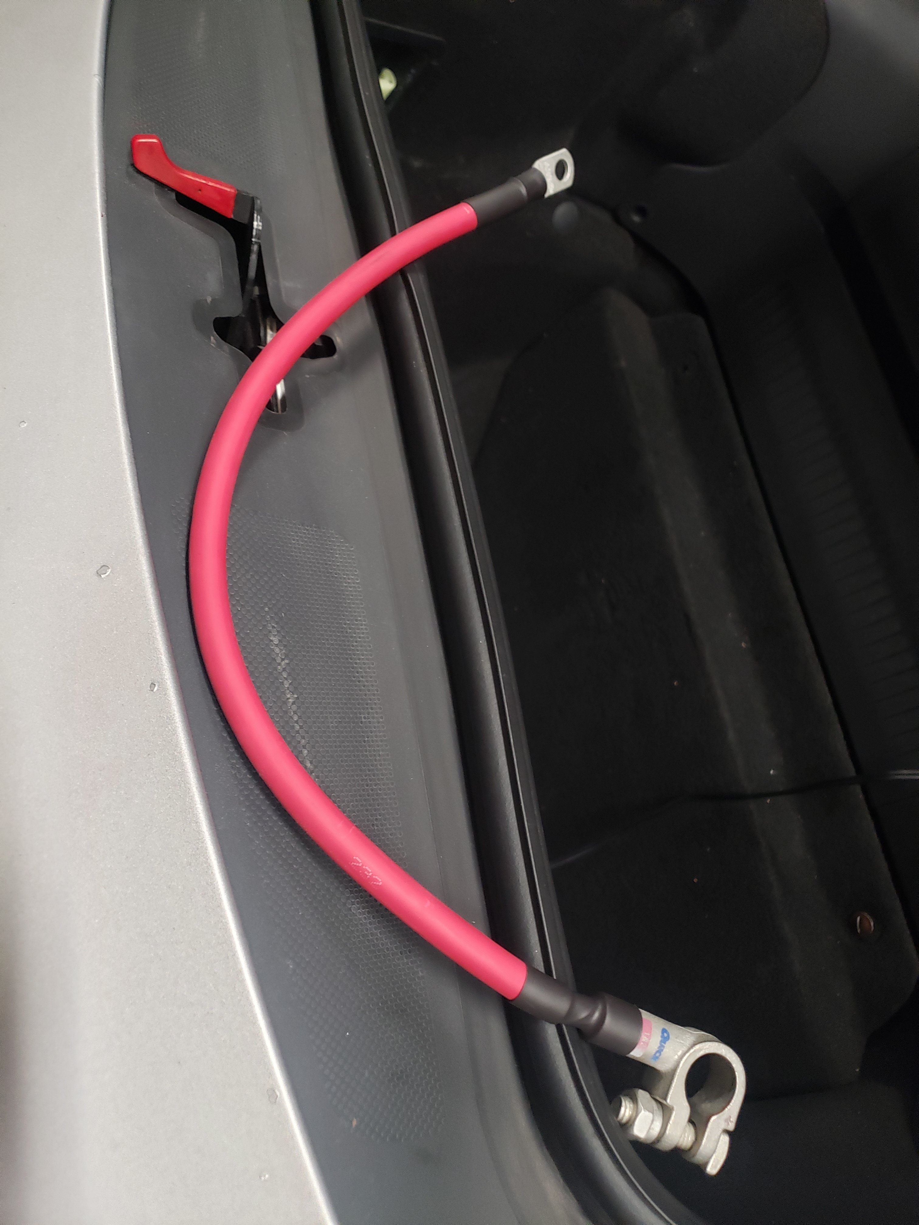

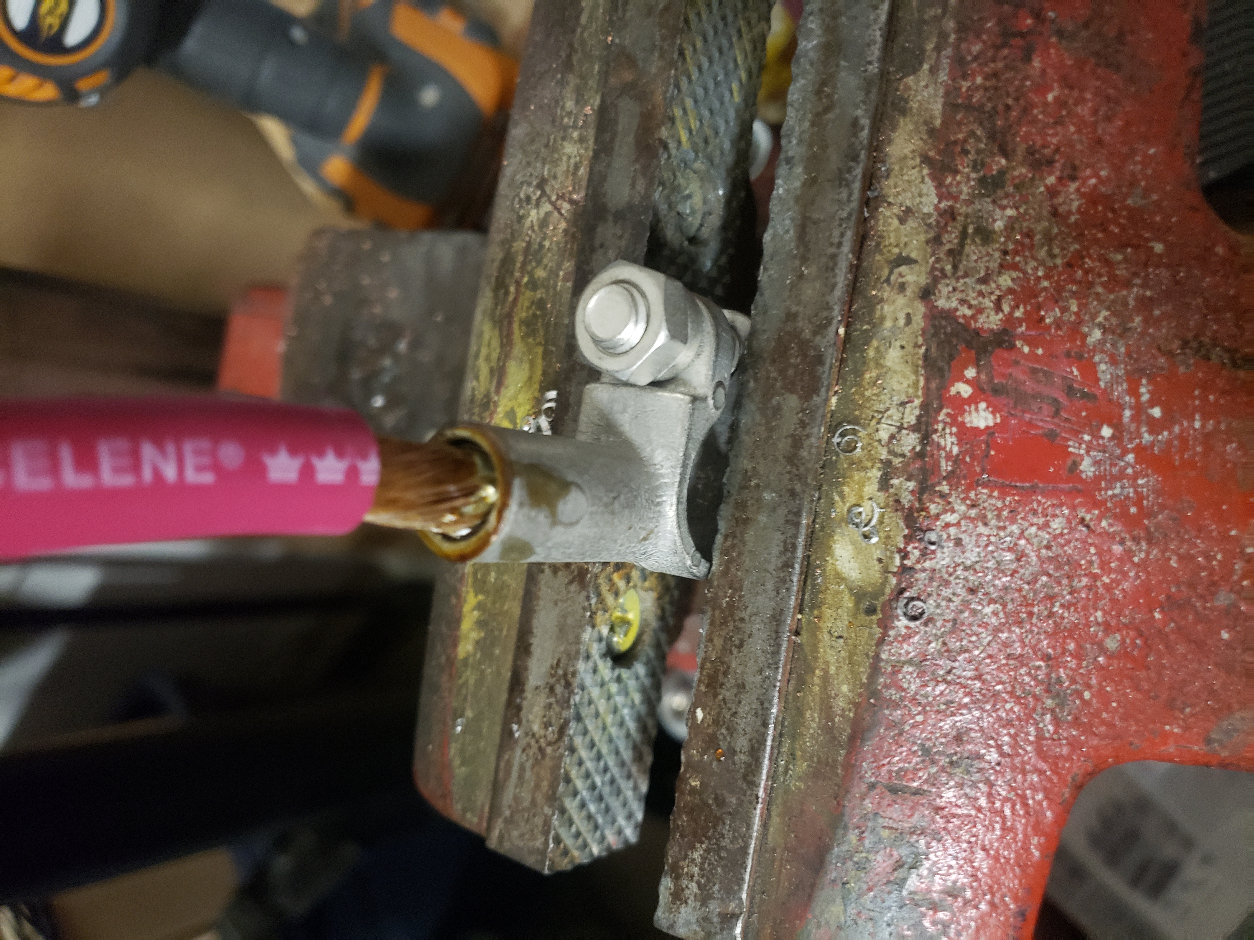

Meanwhile at the other end of the batcave, I started making new wires for the battery. For the main battery cable, I used a Fusion lug, where there's a big slug of solder that you put your wire into.
With a standard terminal on the other side, a new positive cable made from 2 gauge welding cable was complete.

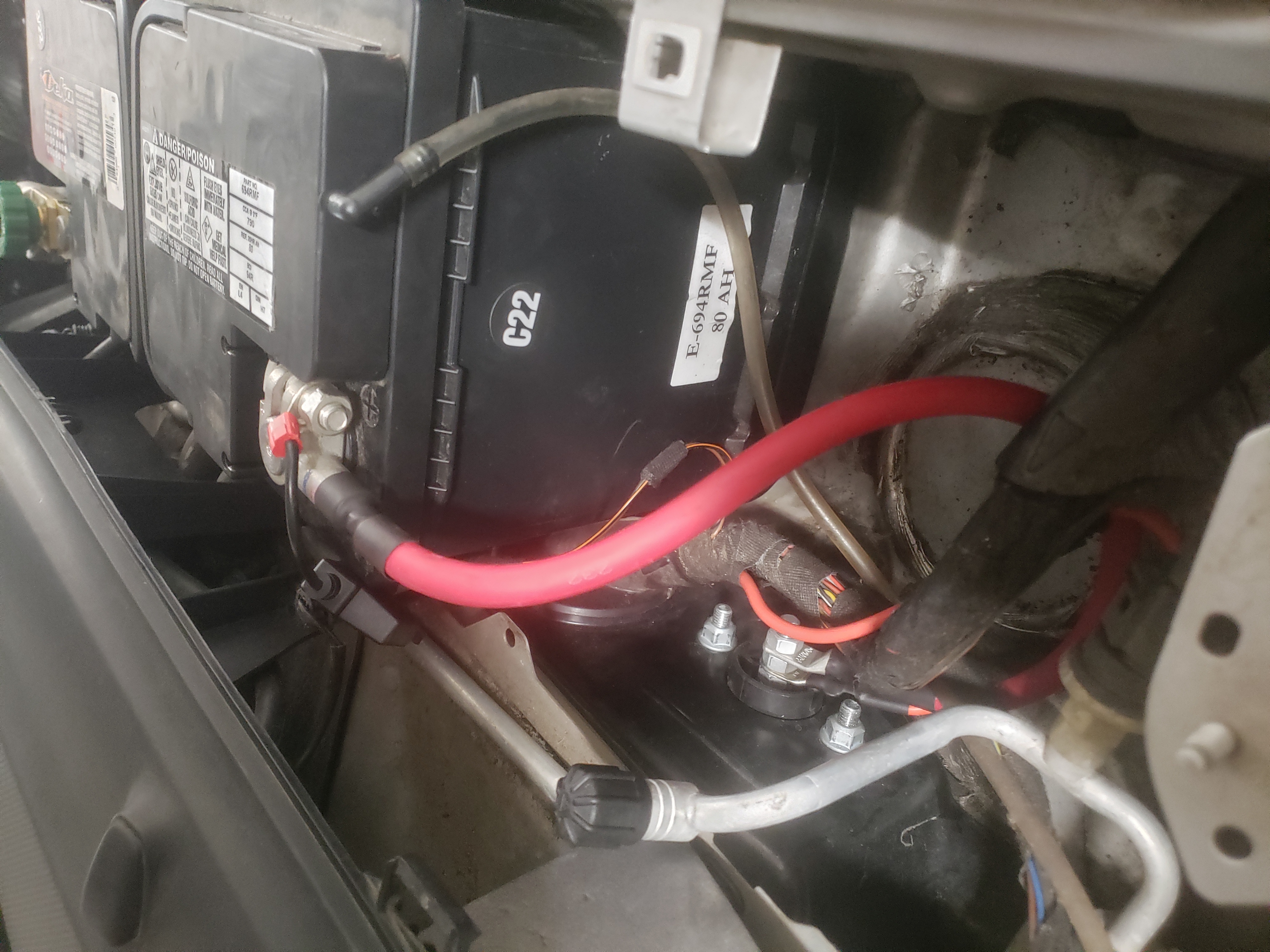

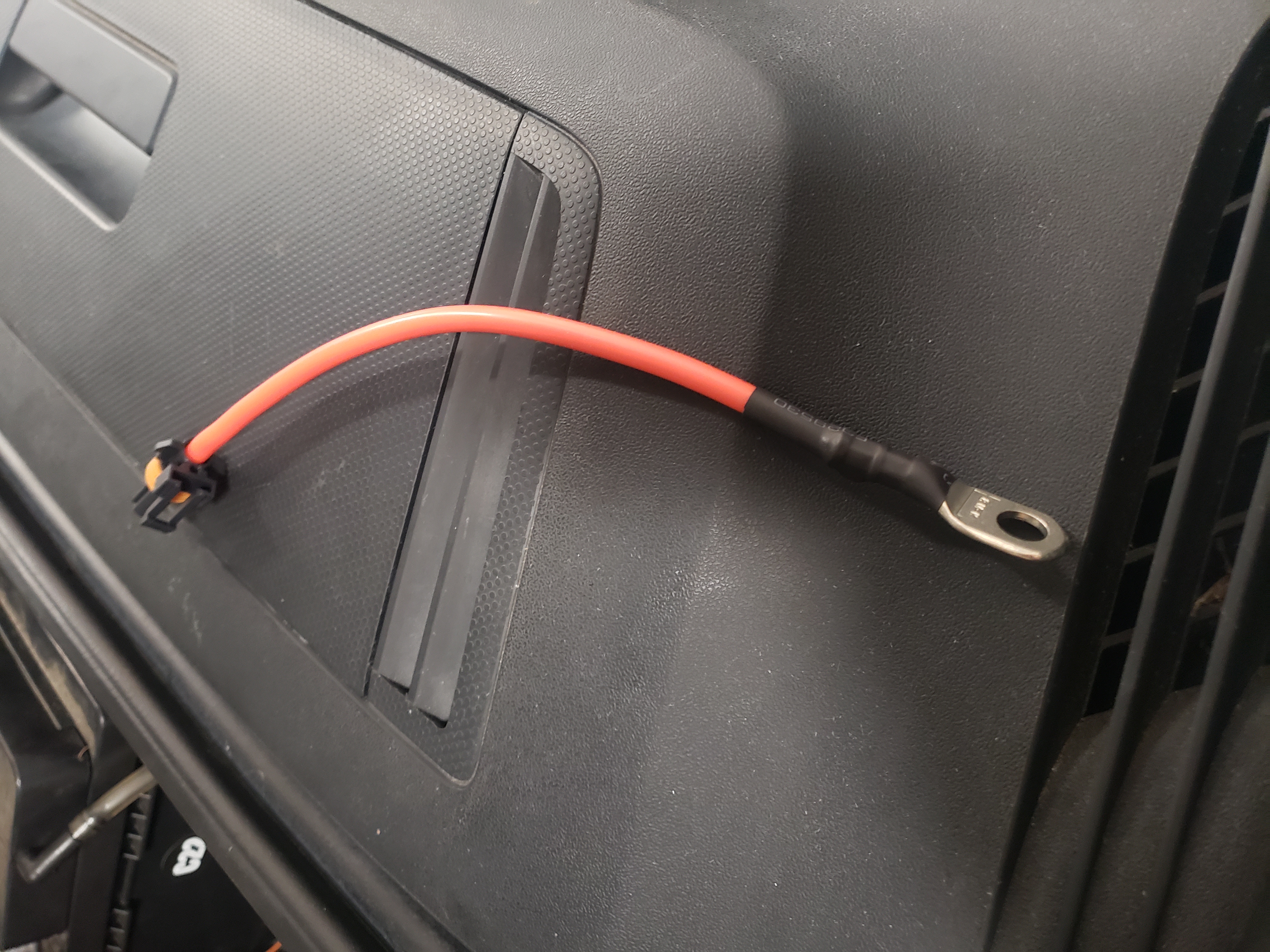

There's an different red wire that used to attach to the fancy positive battery lug. I changed that up a little so that it attaches directly to the battery distributor post and has a quick disconnect. I don't anticipate doing much quick disconnecting, but if I ever need to make a new wire, I'd rather not have to cut a soldered butt joint in the wiring.
Here's everything hooked up.

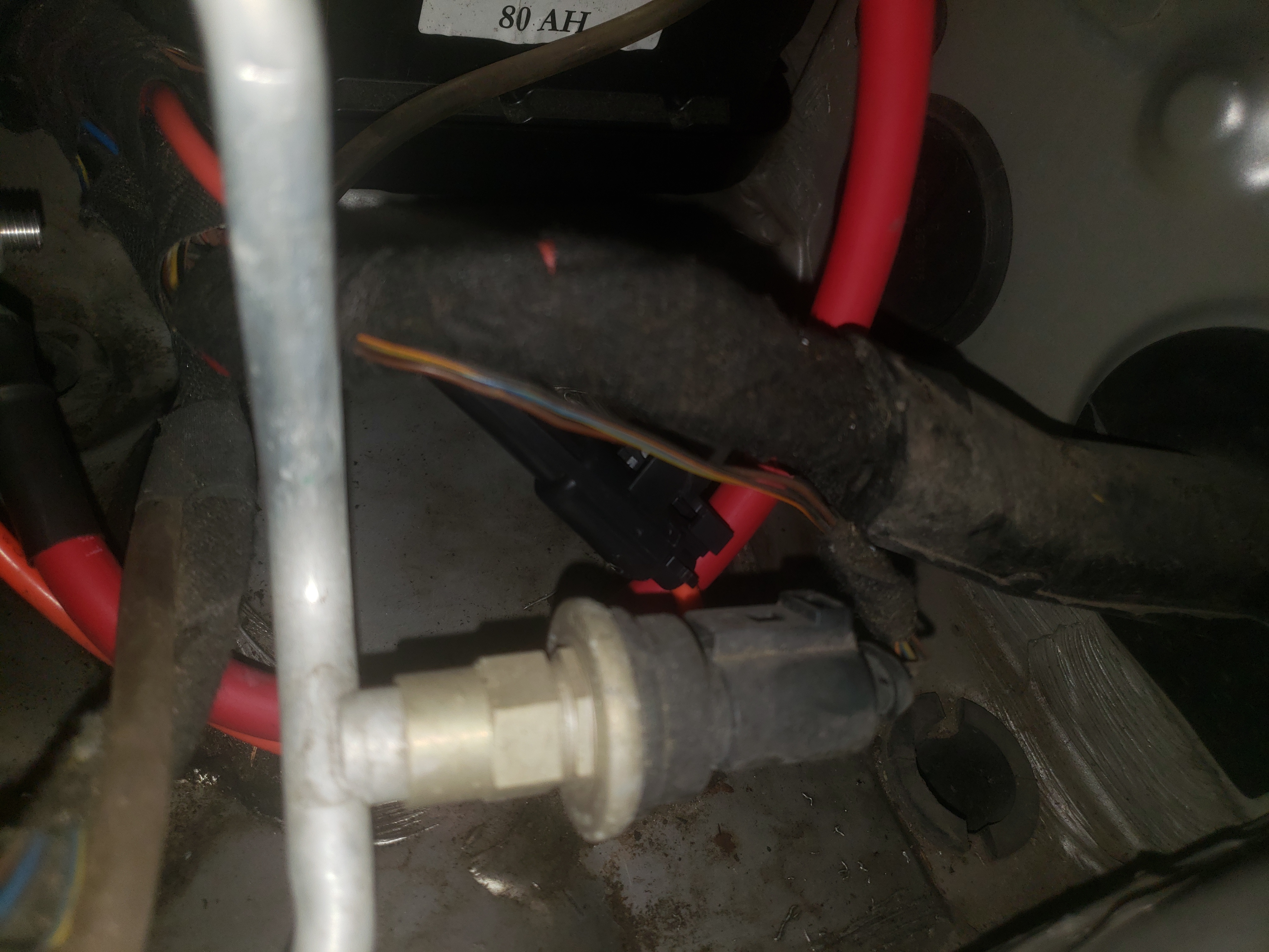

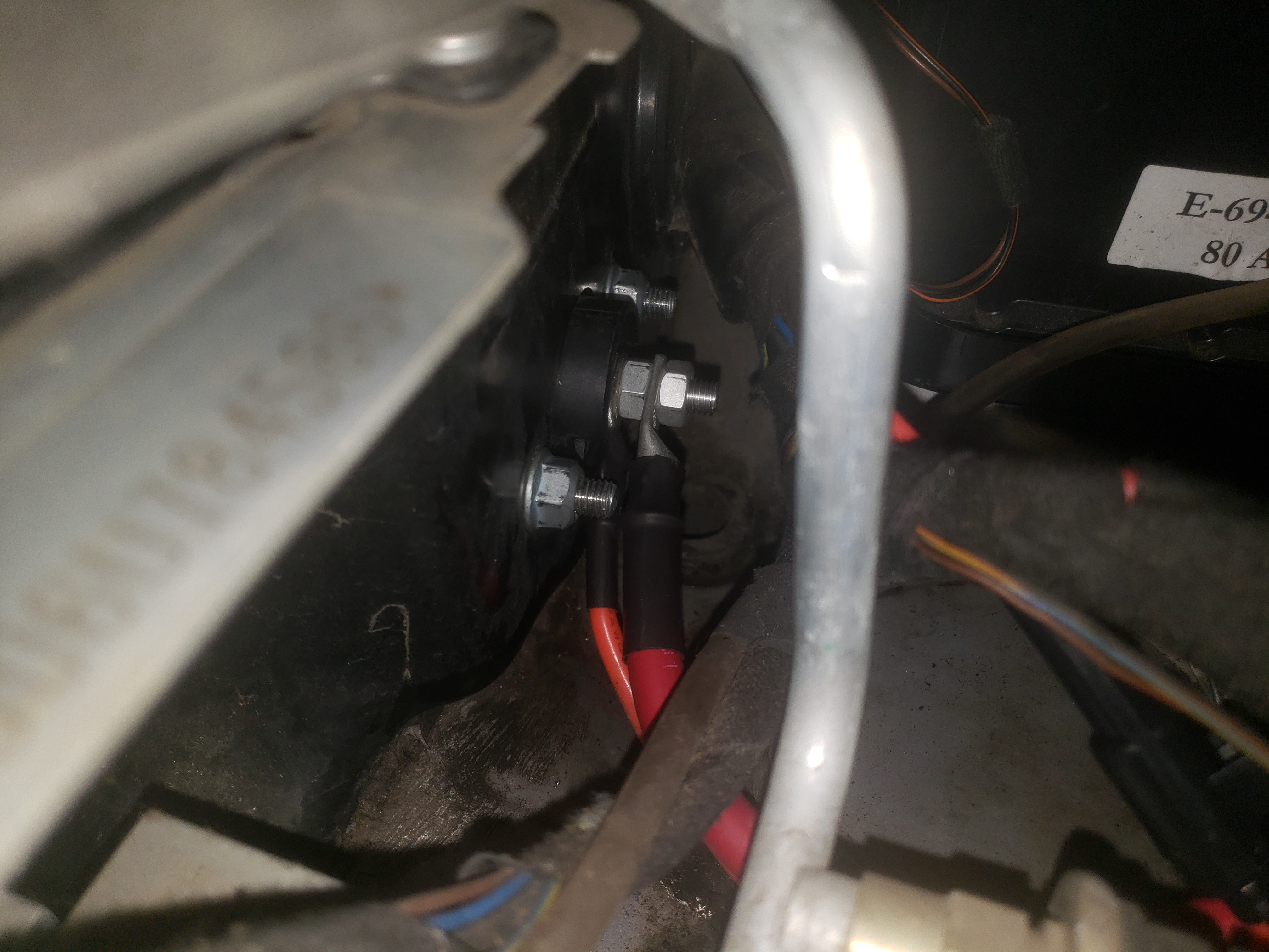

The connections at the firewall:
And finally, for now, a hard to distinguish photo of the additional red wire that now goes from the loom to the power distribution bolt.
