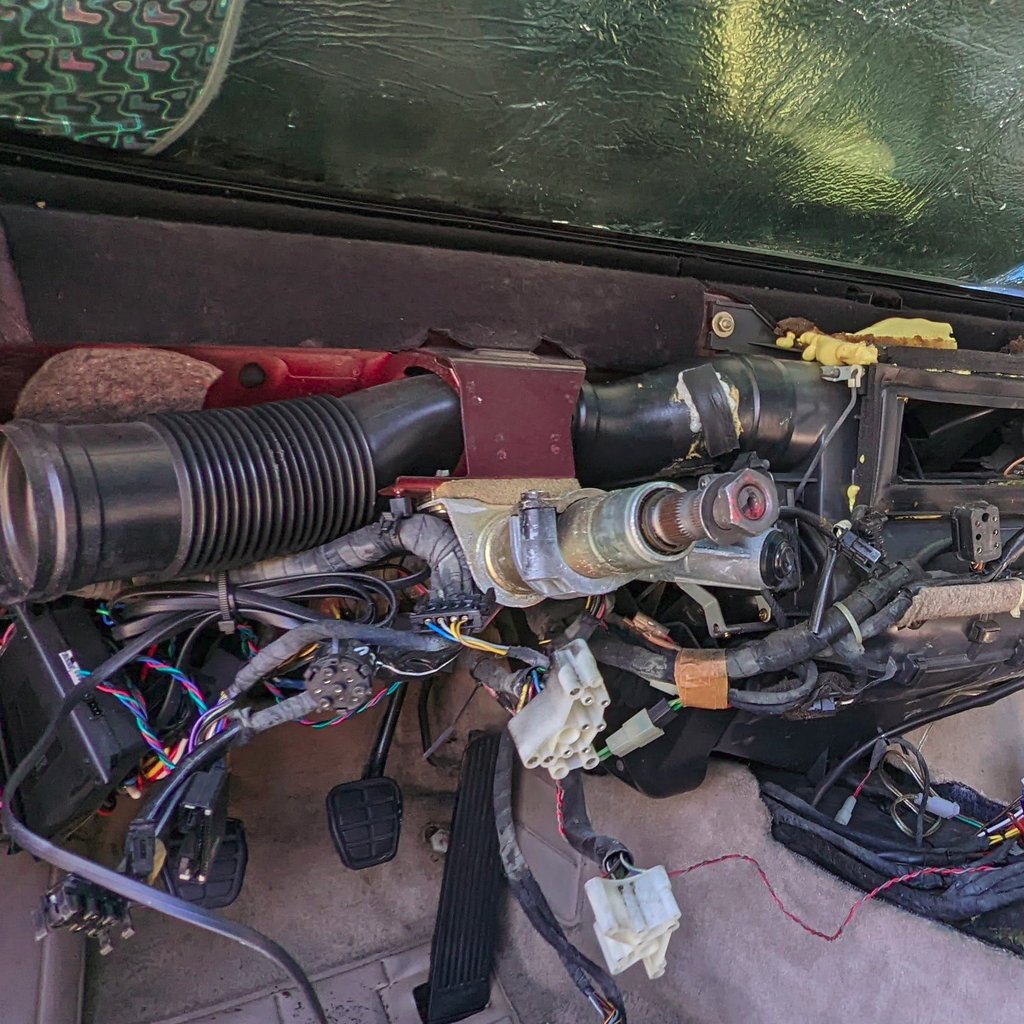

Took the wheel off and other accessories and yeah looks like that was the main issue. My steering column was missing that plastic bushing entirely and was just riding on the bearing. I'll be sure to get a new one and hopefully that fixes it!
