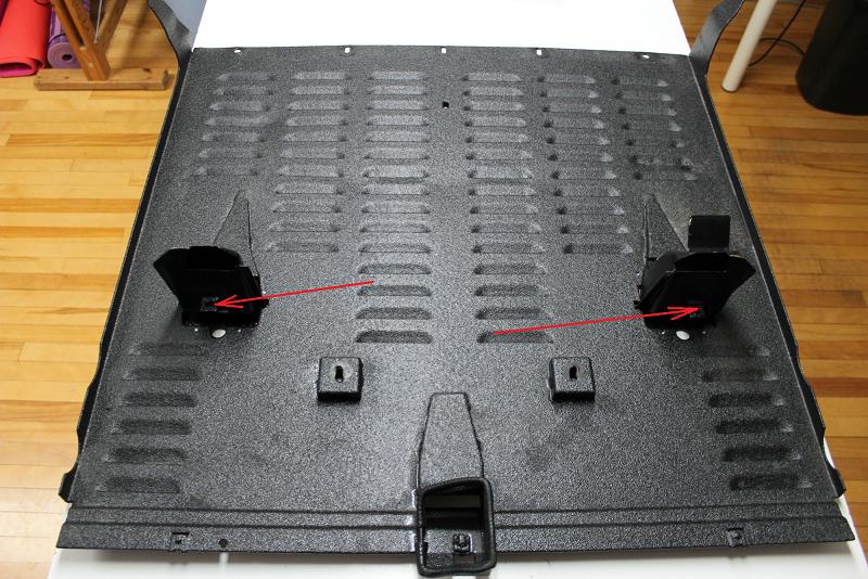

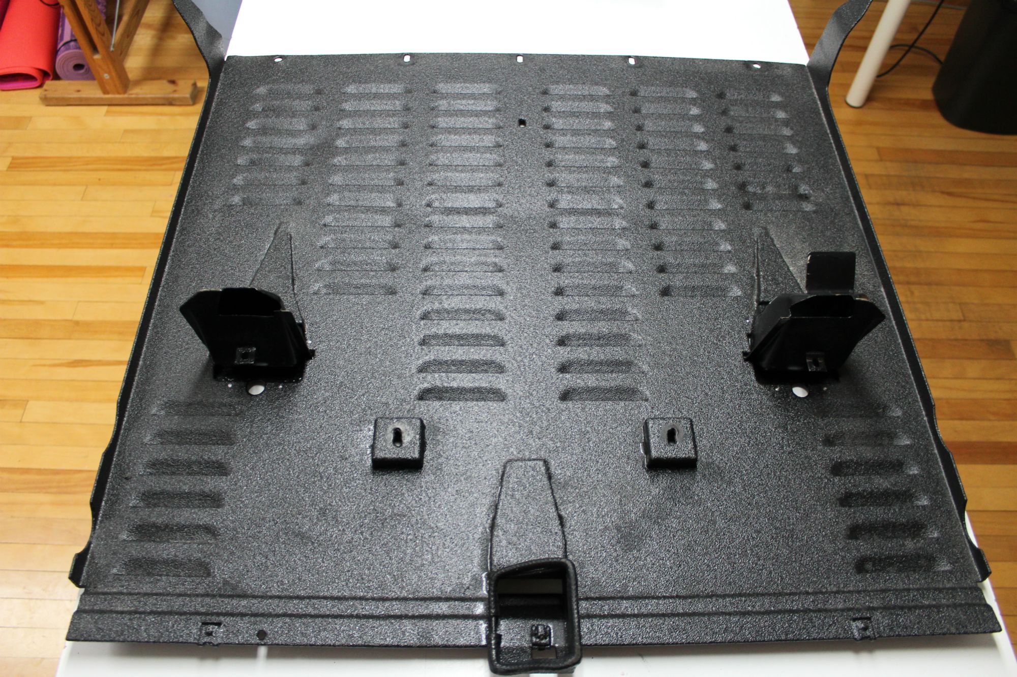

The two vents in question are the pieces standing up from the pan on either side in the picture. This is a pic of an aftermarket metal belly pan, with the original vents installed. Not enough detail in the picture to design, but maybe enough to share the concept.
The factory vents include mounting tabs that help hold the tray up in place, tabs highlighted in the second picture. Whether they are needed with a metal tray is questionable especially for cars limited to US highway speeds. The two square blocks allow a couple 6mm bolts to hold the tray up tight to the steering rack.
The centered duct at the bottom directs cooling air up to the starter motor, if any were wondering.
