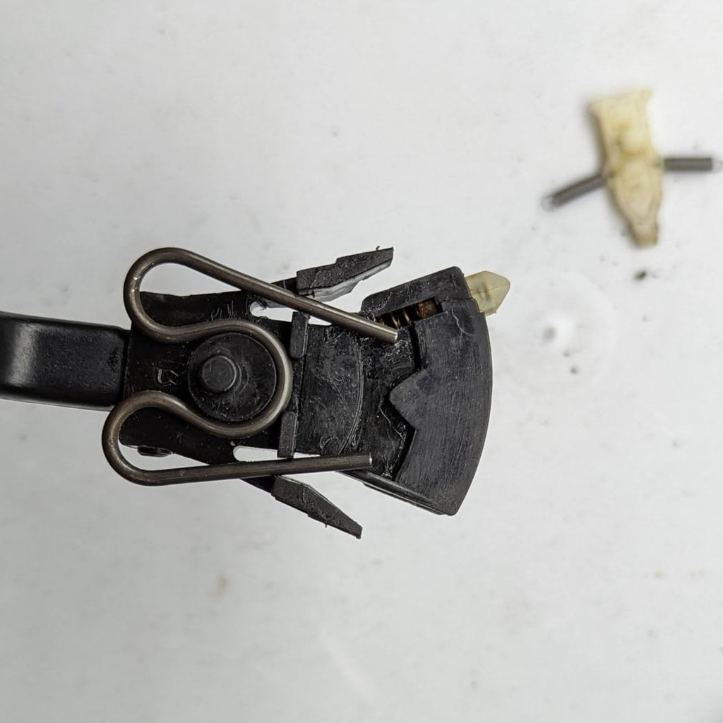

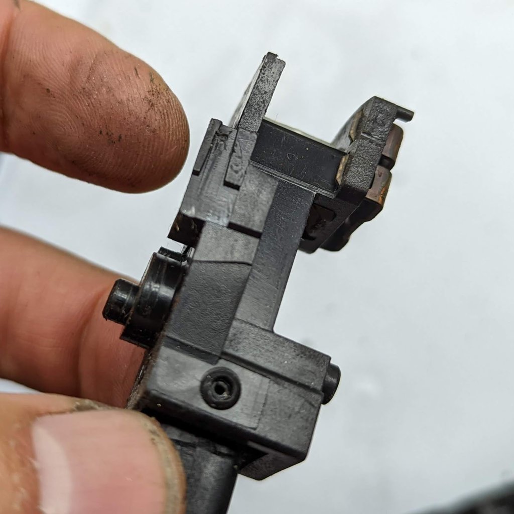

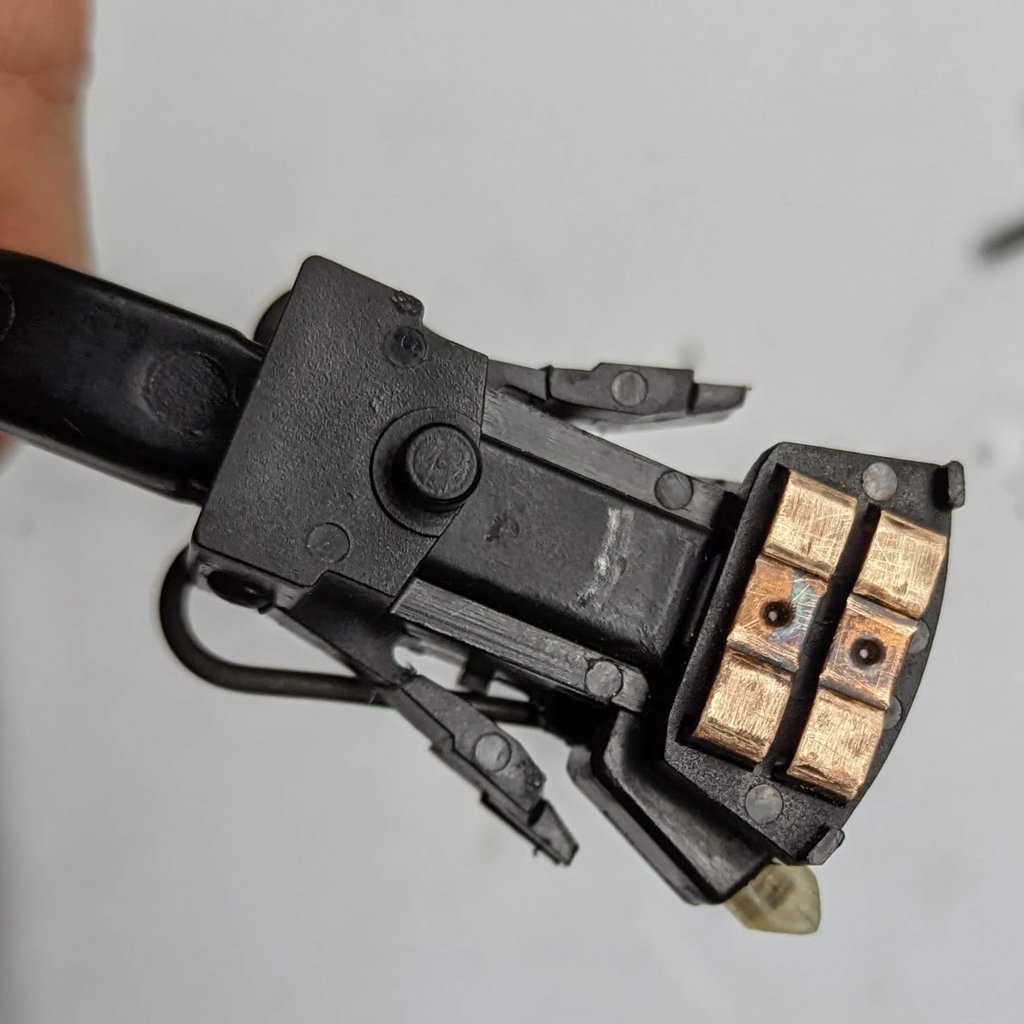

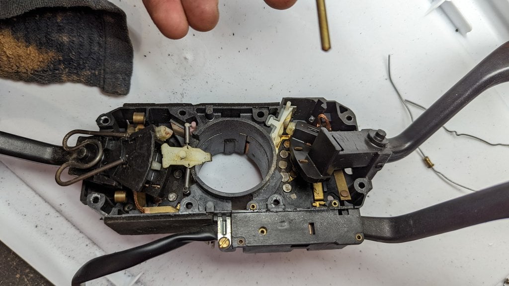

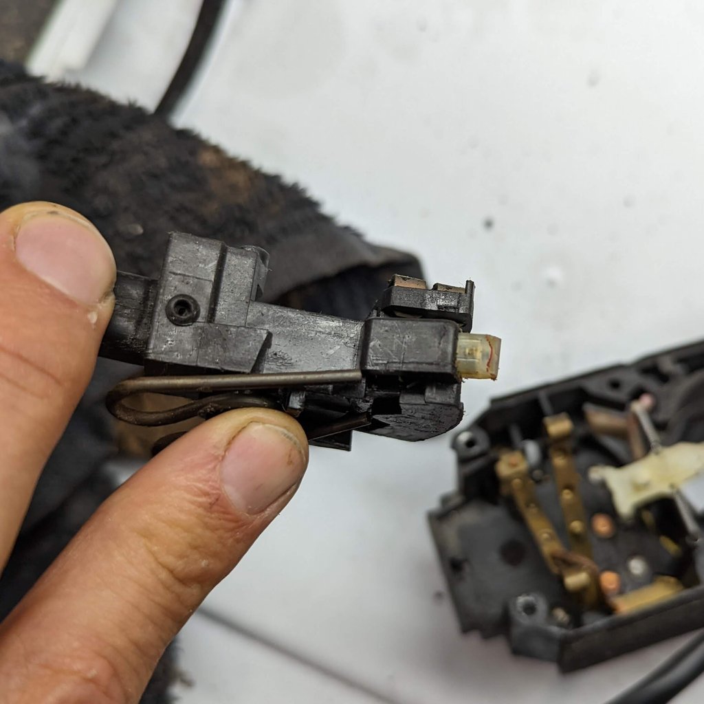

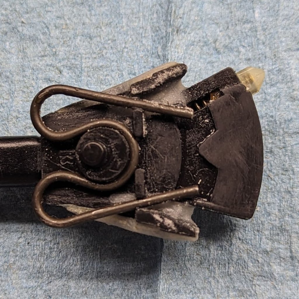

I'll do a full "What's Inside This" style post in the future. In the mean time, this is mine with the insides exposed. Turn signal stalk is in the foreground.
As you can see, one of the little wings was completely broken. I found it lodged inside the main body of the switch. The other was cracked and broke off when I looked at it funny.

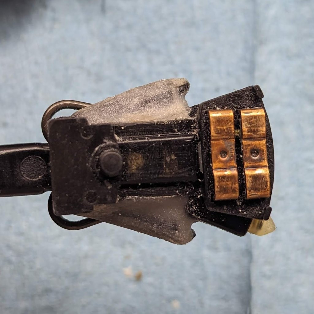

I crazy-glued the broken wings, then encased them in my favorite plastic repair product, described in This Post about the Snowflake Switch. However, the plastic used in the stalk is one of the types that remains chemically unaffected by that repair product. Thus my built up material is NOT integrated into the original plastic and would be easily broken free. Not ideal.

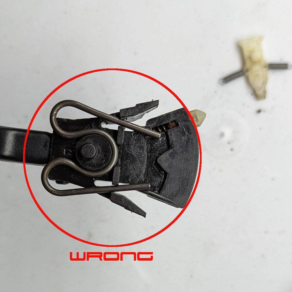

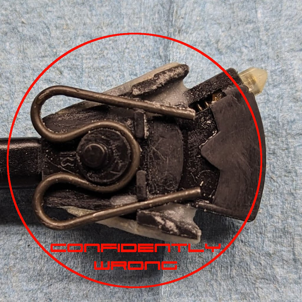

Edit: The following four photos show the main tension spring aligned wrong. The legs of the tension spring belong outside the little wings, not inside. This is addressed Further Below in the current thread.
This repair "works", with a caveat. Whenever I activate the left turn signal, I also end up activating the high beams. Joy. Didn't realize this until I drove the car at night on the Interstate. Whenever I'd change lanes, there were my high beams. Not in a deliberate "flash to pass" sense, but in a "dammit, I've gotta fix my repair" sense.
The clearances inside the switch body are minimal. When the signal stalk is in the left turn position, the built-up material on the upper most wing bumps into one of the spring loaded contact bars, I believe it's the one responsible for flash-to-pass, ironically. I can remove some of the material, of course, which will ultimately weaken the repair.

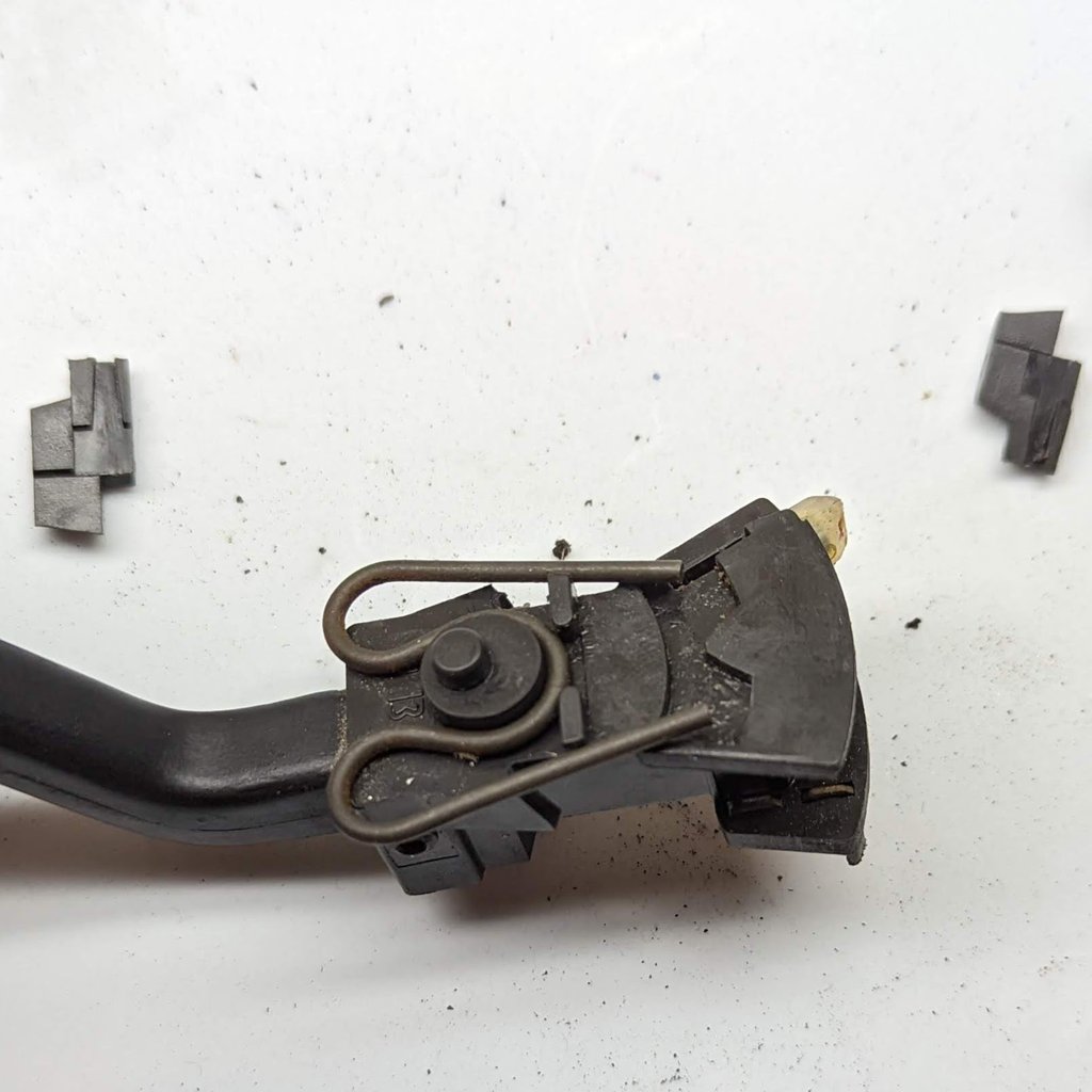

I hate to do this, but I have a post over on Rennlist, on the 928 forum, about what I did for this. Essentially, I replaced the broken plastic tab with a small aluminum piece. Others have gone the same route, and been able to use a small screw to anchor the metal tab to the stalk, but I felt that was a little risky, and that the (quite strong) spring would do enough of a job to keep things together appropriately. There are some good DIYs on the 928 forum about this issue.
So far, things are working well on that car with that repair.

@Aaron_N : Indeed, you have to drill out the rivets and then use screws to put things back together. It's not that bad, but it did make me pause.

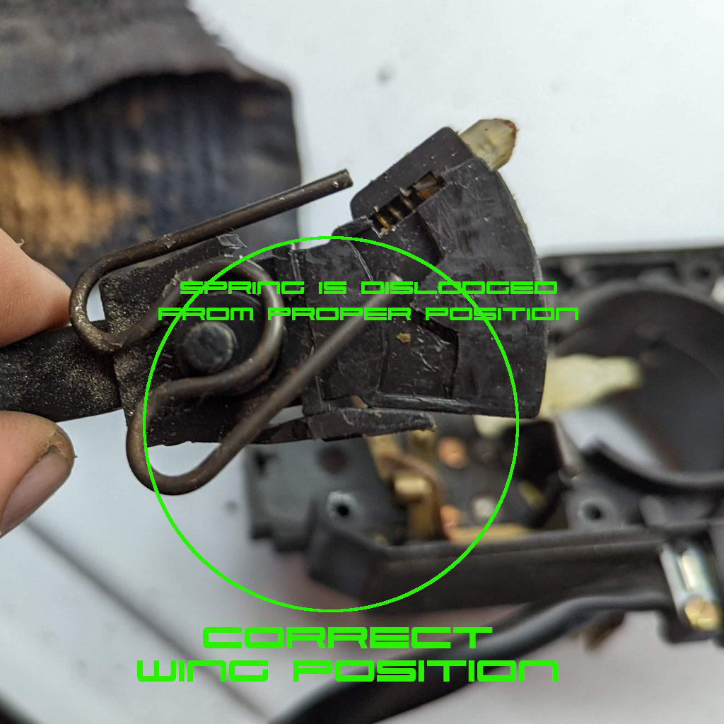

Ah ha and eureka! I found your post by searching the RL 928 forum for "turn signal stalk repair" (in quotes).Zirconocene wrote: Fri Aug 18, 2023 9:30 am I hate to do this, but I have a post over on Rennlist, on the 928 forum, about what I did for this. Essentially, I replaced the broken plastic tab with a small aluminum piece.
It seems I have not correctly interpreted how the quite strong spring is supposed to fit in relation to the "wings". When I disassembled my combination switch the first time, the turn signal stalk escaped and hit the workbench and dislodged that spring.
I made a guess as to how it must sit, reasoning that the little weak flimsy brittle plastic wings couldn't possibly sit inboard of the quite strong and uncompromising spring. Oops.
The first pic below was taken immediately upon first disassembly. The spring is already dislodged from its proper position due to the "boing factor" of the disassembly.
I know what i'm working on today.

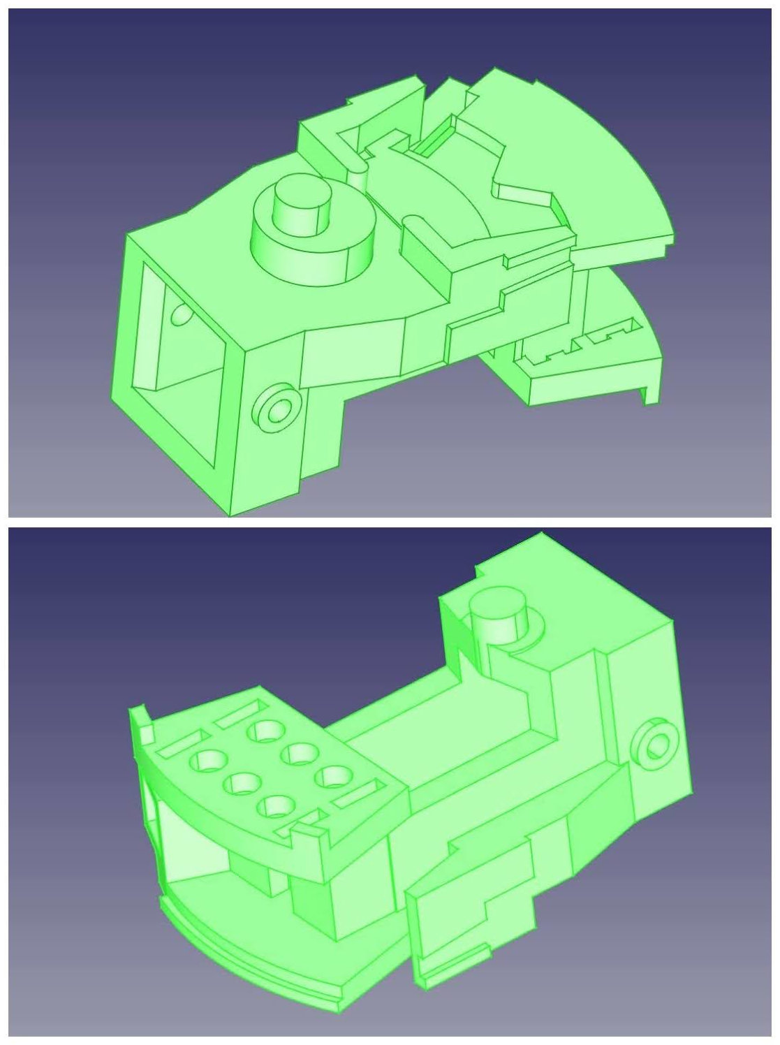

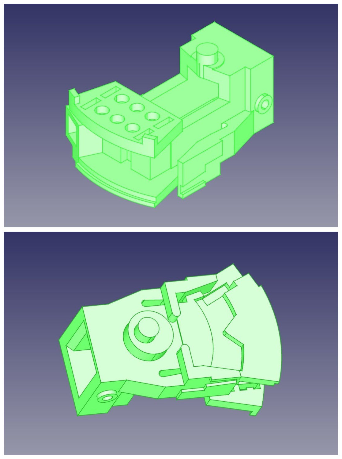

I've been working on a CAD model of the turn signal stalk plastic base click-o-matic contact tension spring contraption with wings (don't know what its real name is).
Floating Wings version
Well, kinda floating. There is some separation between the "wings" and the main body in the form of a narrow channel.
Integrated Wings version
Much chonkier attachment of wings to main body. Similar to the aluminum plate approach described by @Zirconocene in their previously-referenced RL post.
I don't know how suitable this would be for 3D printing. Lots of covered void spaces and overhangs. I don't have a 3D printer, and what little I know about it comes only from YouTubers talking about their experiences. I also don't know how to design models suitable for 3D printing.
This model is based on direct measurements of my probably-worn-and-who-knows-how-out-of-tolerance actual part. Plus, both of my "wings" were broken off, so I reattached them with crazy glue and made "best guesses" as to their alignment (by referencing other photos of disassembled column switch assemblies). I'm good with a vernier calipers, and even better with a digital one. Still, some of this stuff was tough to measure. I used a nice set of machinist's drill bits as pin gauges to determine tricky dimensions.
I'm using FreeCAD (v0.20.2). It has native Linux support, but it is kinda buggy and has a tendency to hork-up sketches and their extrusions based on previous geometry when editing that previous geometry changes the number of faces/edges. The software seems to renumber faces/edges internally and doesn't update dependencies with the new numbers, as best I can tell. It's a real pain to clean up the dependencies.
However, if people are interested, I'd be willing to post the STL files.
