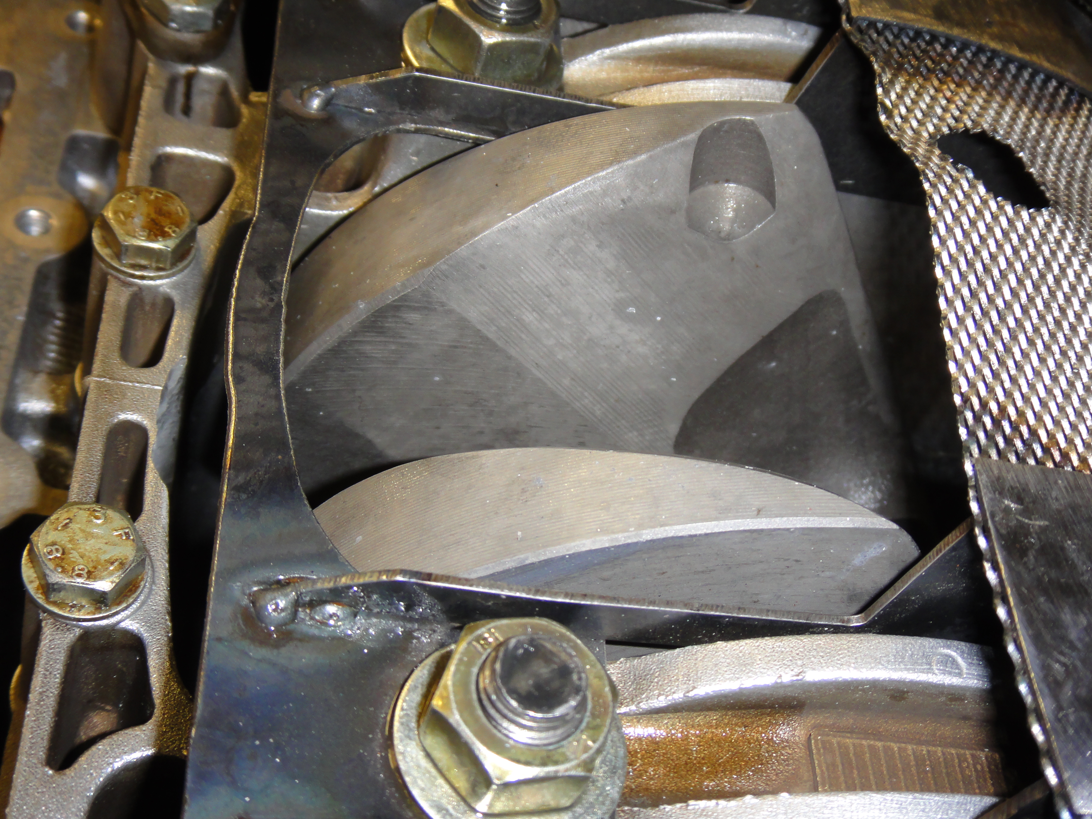

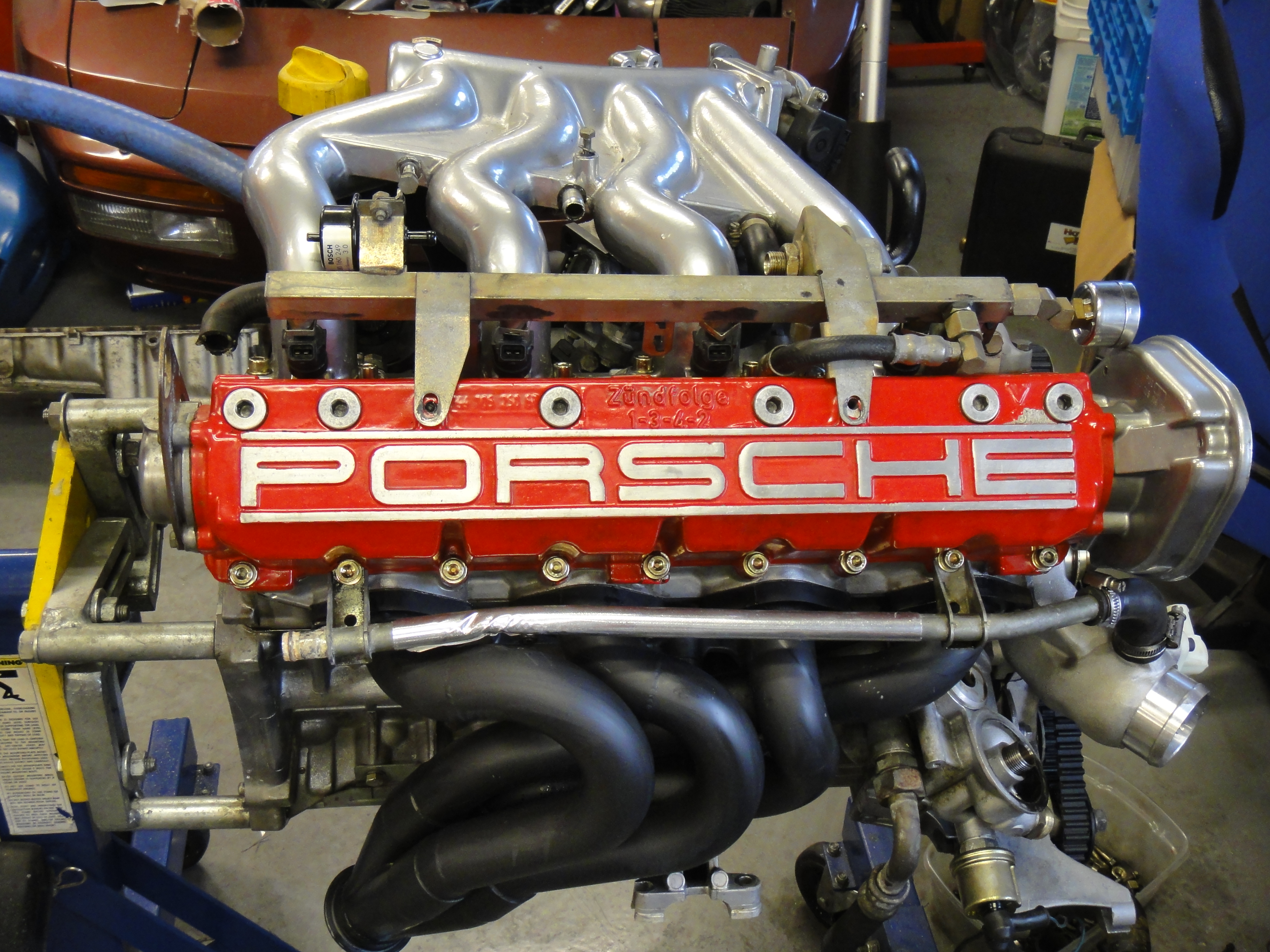

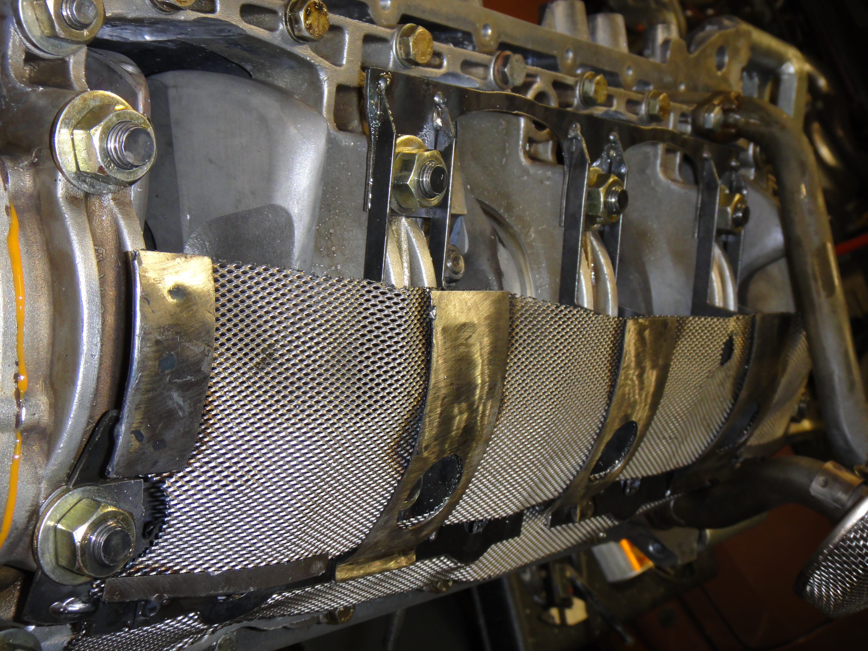

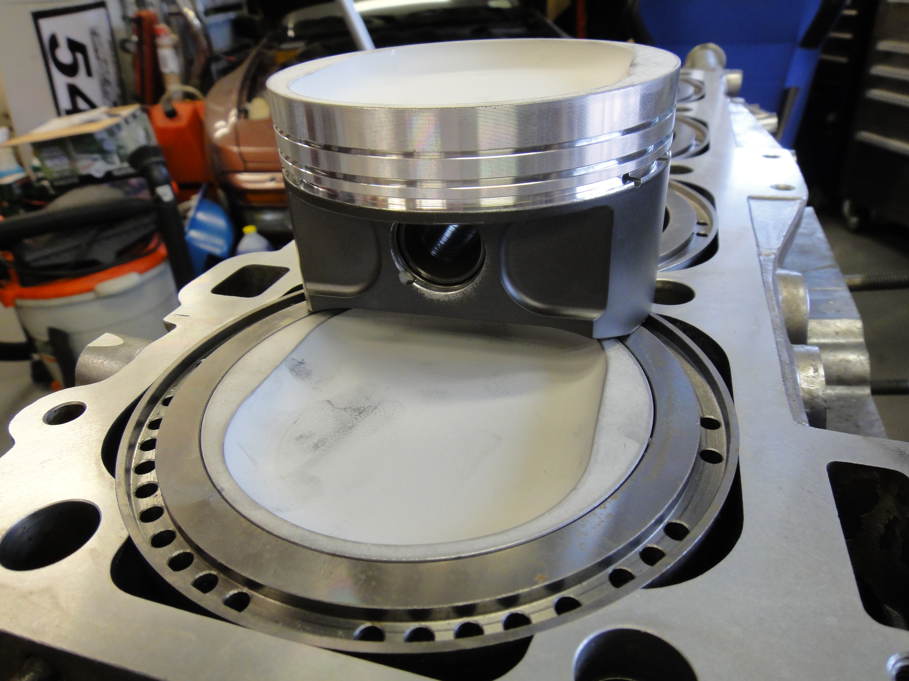

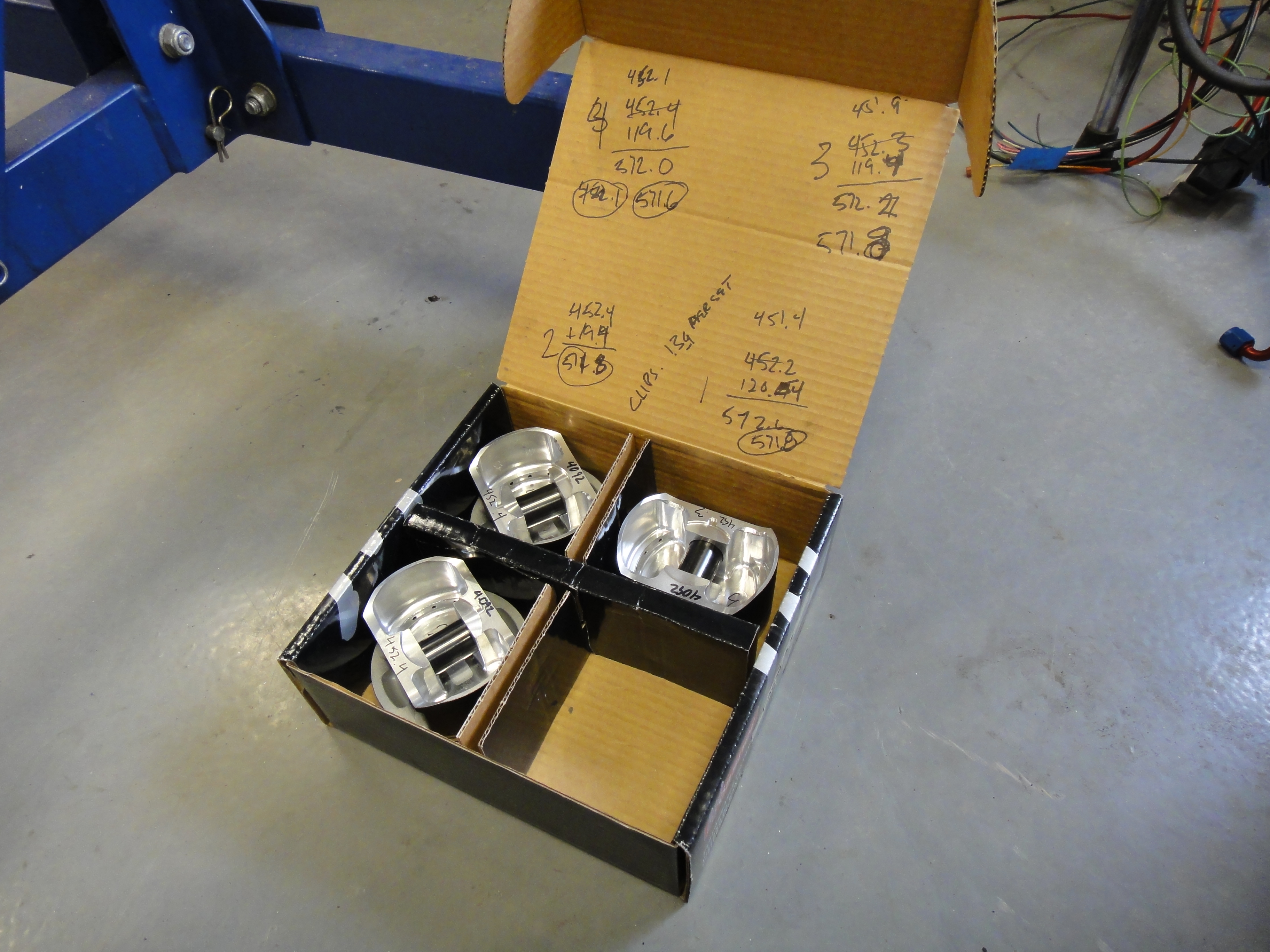

Your engine is a 3 liter with Darton MID sleeves, Wossner custom pistons, lightened crank, Aluminum flywheel, Windage Tray, haltech Sport 1000, bigger injectors, Prosport gauges, eboost 2 boost controller. Looks like a Spec clutch. Way back then it also had Evans Coolant - which can run very high temps and not fail - but it also tends to run hotter. That may not be in there any more, it was a long time ago!
220 is not really bad, it would be nice to be cooler but that wont do any damage. If the hoses were 30 years old that might be an issues but all the hoses were replaced during the build.
