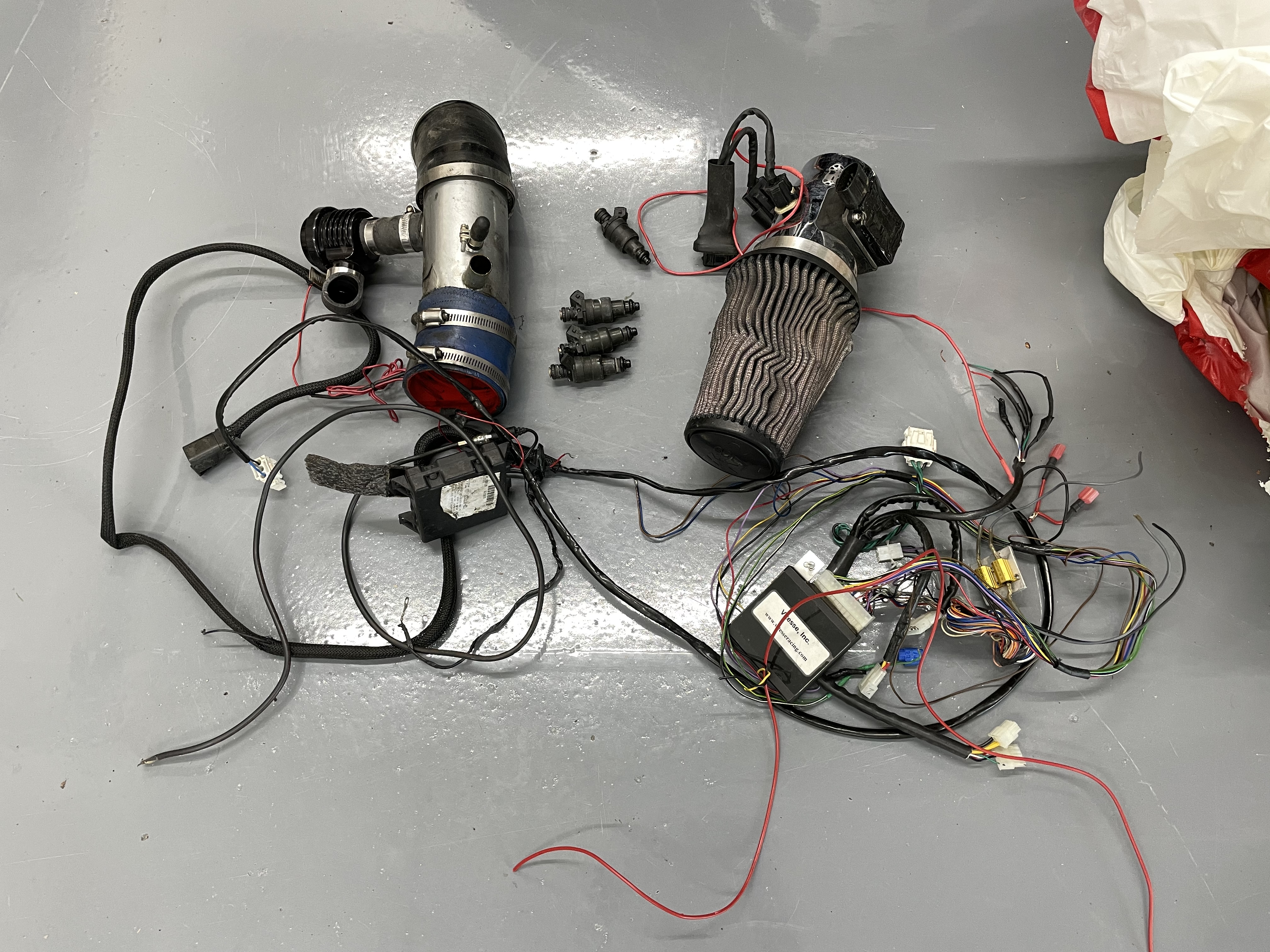

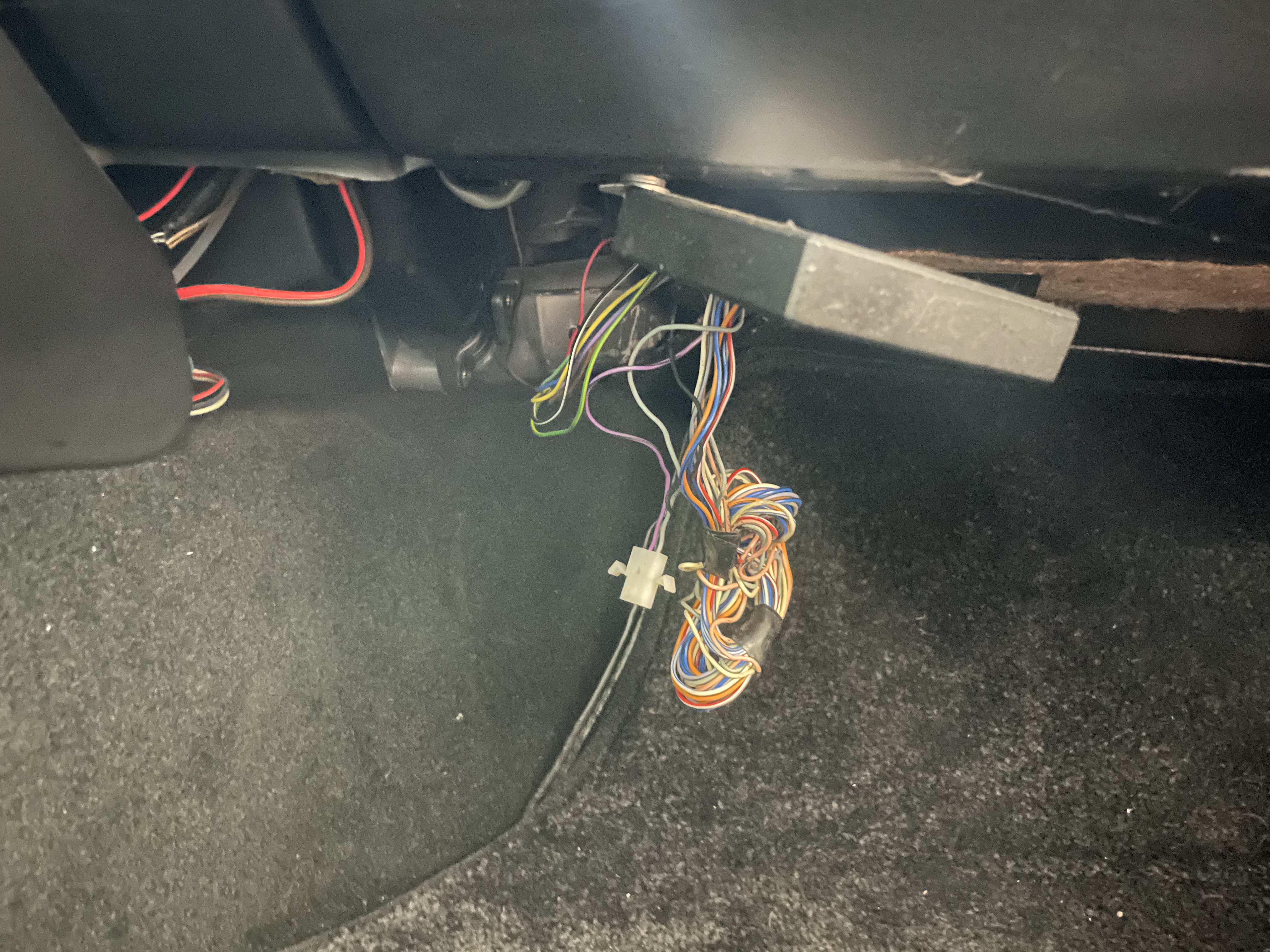

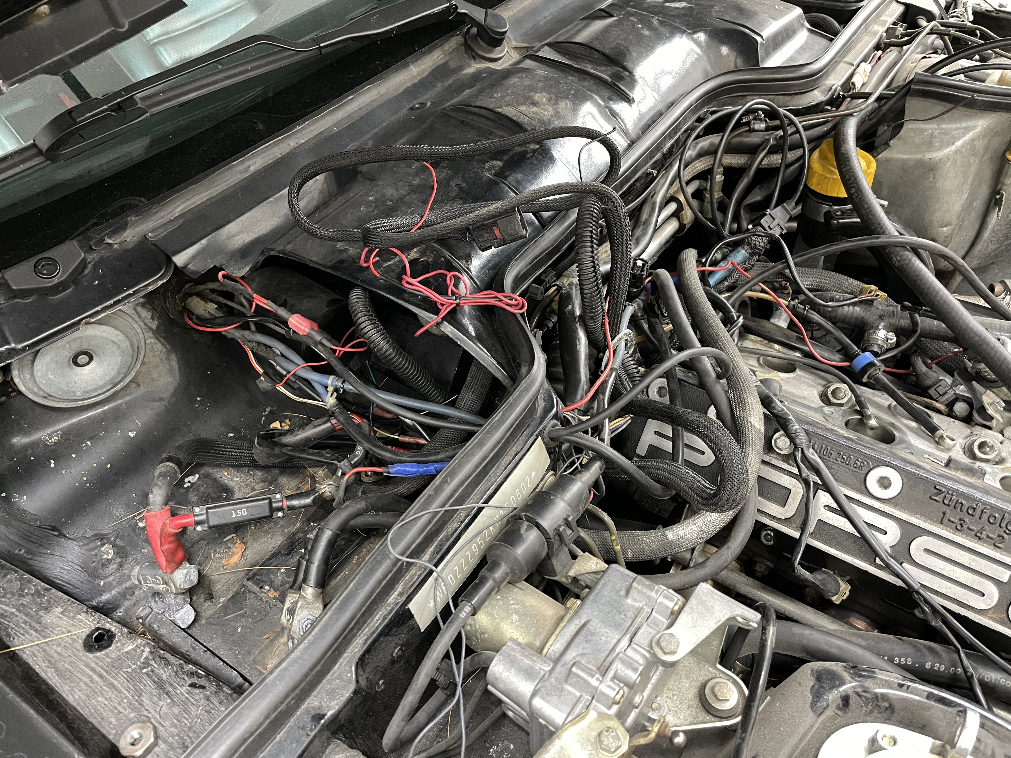

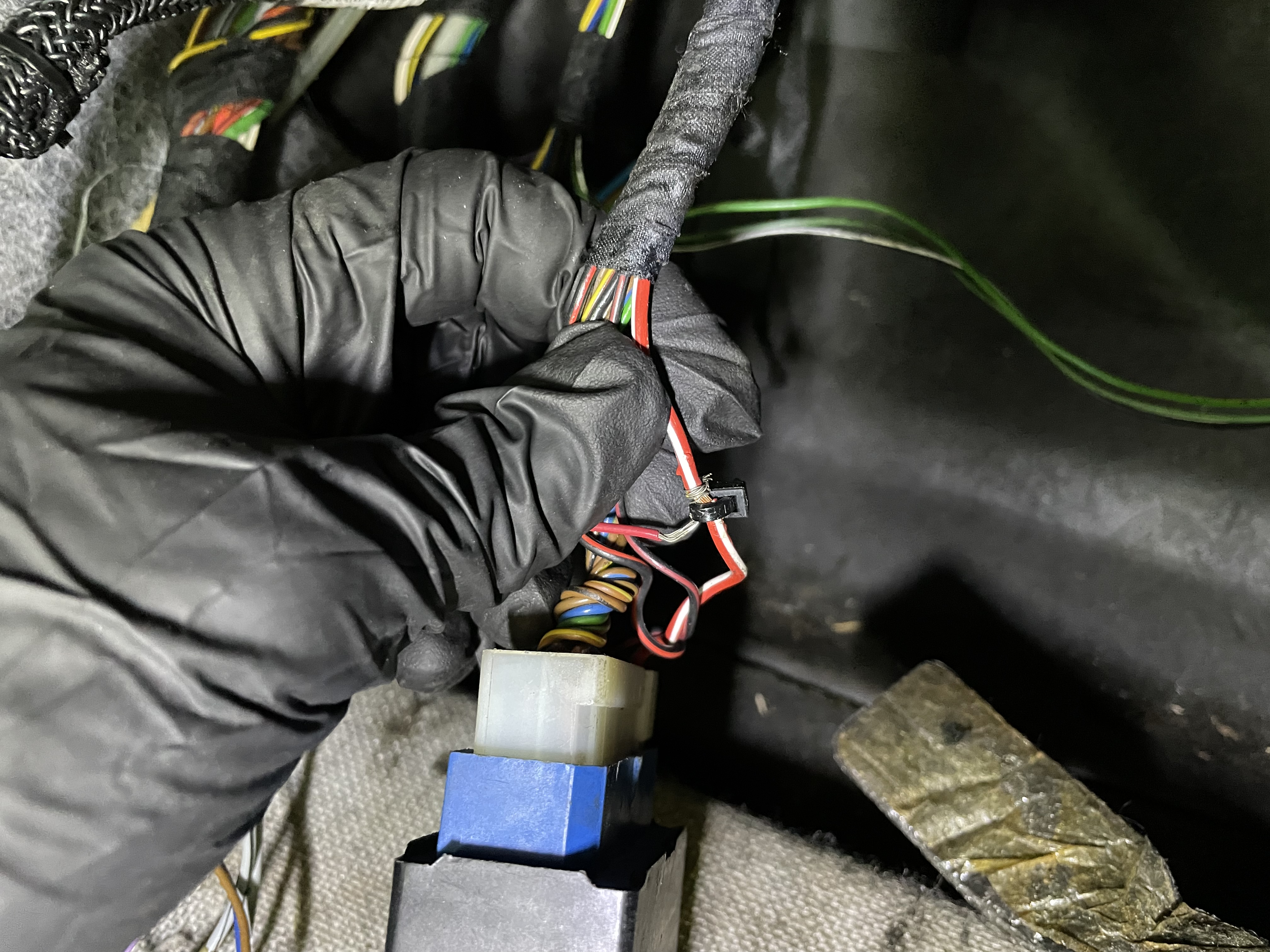

Trying to remove the cam box to replace the head gasket. But someone over torqued the bolts so I’m trying to not strip them.
Also been stripping out the vitesse stage 2 system. Tons of hacks on the install so… going a different route and starting over.

What are you planning to do going forward?AudiSport wrote: Wed Sep 22, 2021 4:10 pm Trying to remove the cam box to replace the head gasket. But someone over torqued the bolts so I’m trying to not strip them.

I have a voodoo turbo I bought in 2018 for my other Turbo (red) that is a basket case and needs a lot more done. So I'm moving parts to my black one I just bought last year. I'll be doing a standalone system along with the turbo and some other improvements as I go. Right now the main focus is get the head off. Blew the HG a month ago. Have a new SCE gasket and ARP bolts to go in. Then sell the Vitesse system and get the new ECU and build a harness.Darwin wrote: Wed Sep 22, 2021 5:48 pmWhat are you planning to do going forward?AudiSport wrote: Wed Sep 22, 2021 4:10 pm Trying to remove the cam box to replace the head gasket. But someone over torqued the bolts so I’m trying to not strip them.

Looks like some quality vintage parts that were installed by a caveman. Can't quite say I've ever seen anyone make a wire connection using a zip-tie.
Did it even run? Also looks like some LR patch cables in there and old Iceshark battery cables.... The latest Vitesse MAFs/software run like a sewing machine without much effort (when not installed like that) but I 100% get why you'd want to start over with a new harness, which in turn opens up the choice of ECU to whatever suits your fancy. Sounds like you have some work ahead, but very much looking forward to hearing how things progress.
