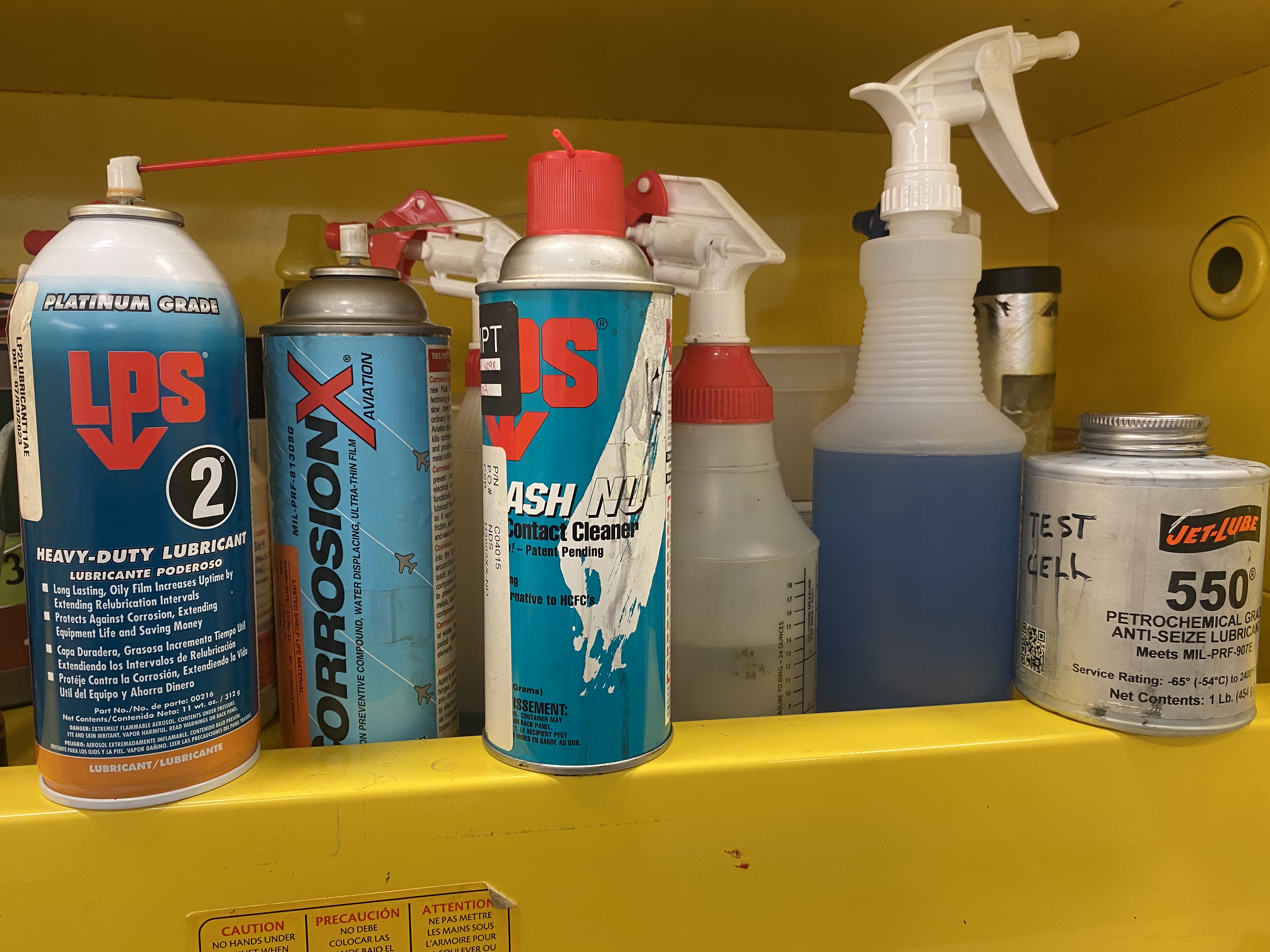

If you can find a can of this No Flash contact cleaner it’s the best thing I have ever used to clean out a throttlebody.
Blasted the bearings spotless and that was looking through a magnification scope at my work.

Thanks Gruhsy!
